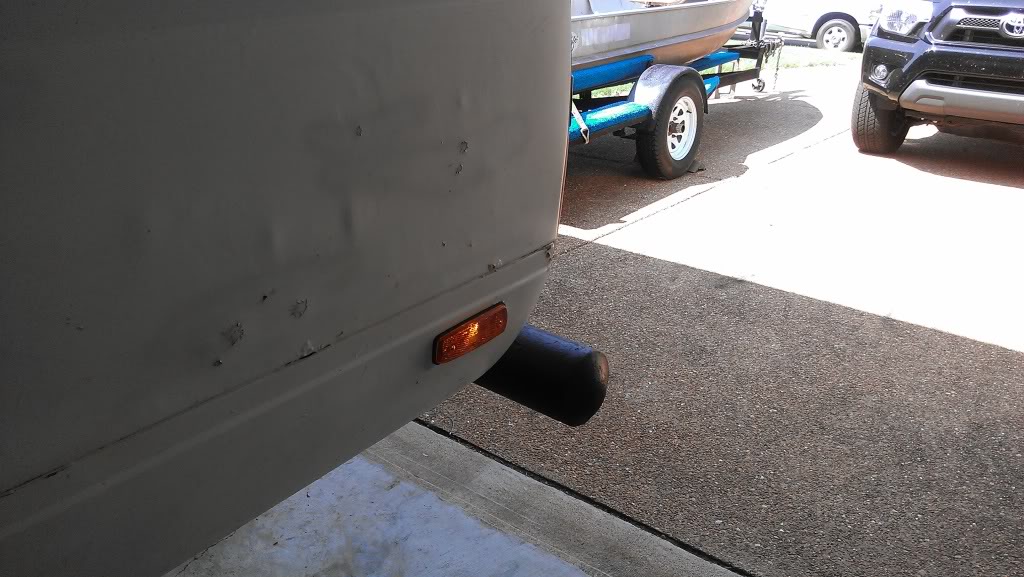

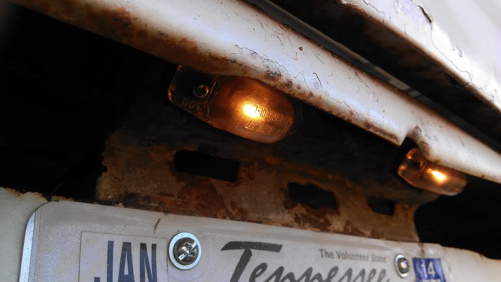

I put my rear side marker lights on this morning and put the license plate lights back on finally. I know they are suppose to be red but I am missing one of my red covers so orange will have to do for now. If anyone has a red cover PM me.

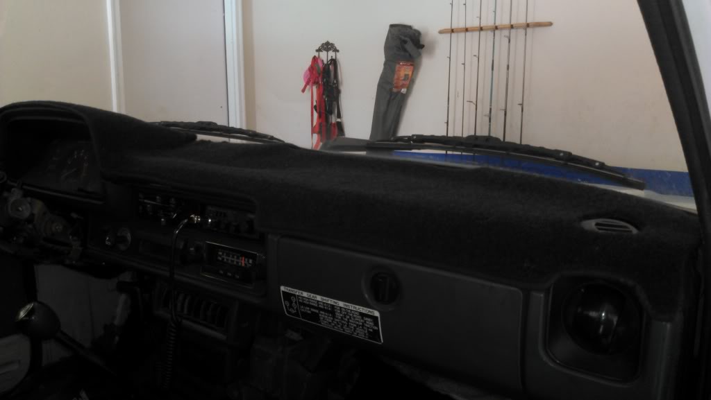

Put my dash cover on too

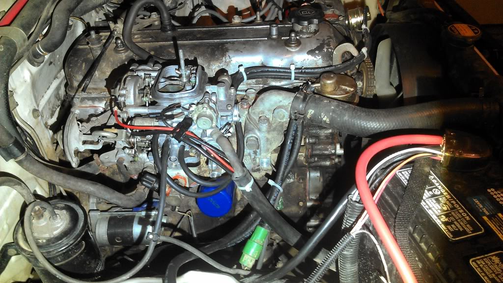

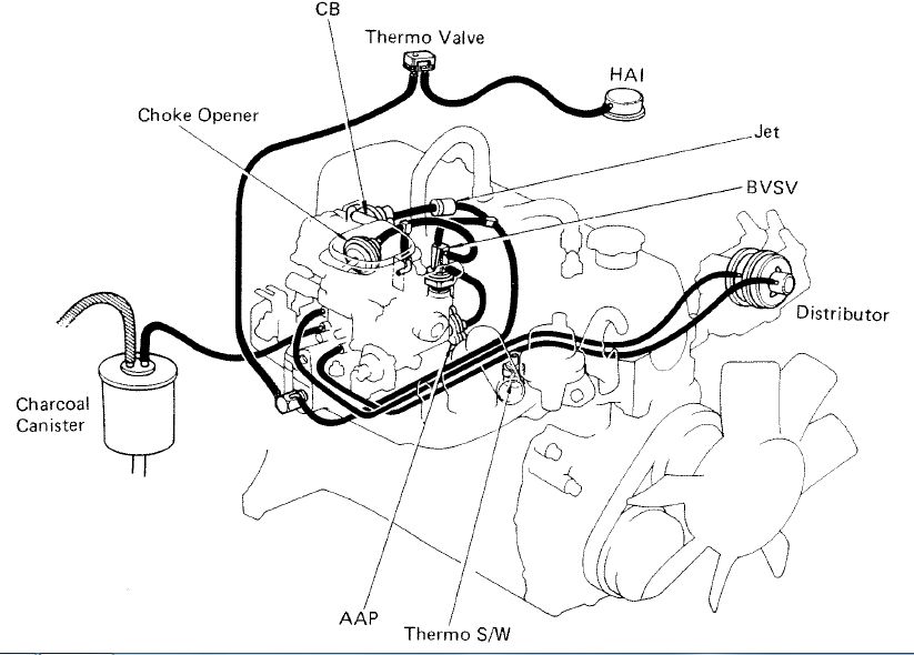

Ok had a little success tonight with the carb. I started researching on the different ports on the vacuum advance and I decided to try hooking it back up. I used this diagram for the vacuum lines:
Its a nice drawing that only shows the vacuum advance, choke setup, and the charcoal canisters. I used this to hook the advance closest to the valve cover back up. This corrected my weird timing issues as I figured it might. With this hooked up my timing was around 12 degrees which I took to 5. Also hooked up the charcoal canisters back to the carb as well.
I did all that and went for a test drive and I seemed to gain most of that lost acceleration back that I mentioned a few posts up. 3rd and 4th gear do pull a little better like they did after the carb rebuild and before the desmog. Now I'm back to where I want to be. I also reset the mixture idle screw back to the factory location and the exhaust doesn't smell rich so I going to leave it alone. It also is still idling smooth around 750 - 800 rpm.
Also looking at that vacuum diagram I see how to hook the choke system back up properly. I need to buy another BVSV (broke the plastic on mine taking it off) and another one of those Jet things. Don't think mine is working, seems clogged up. Not sure where to get that other than the dealer. Once I get both of those parts I will hook the choke system back up before the winter time comes which will make me very happy!
I also pulled out the big black plug from the desmog kit in the middle of the manifold and put the piece back in that has all the ports. I need one of those ports for the choke system.
This the engine right now:
Not as clean as a weber setup but its not too bad I think. I can live with it.

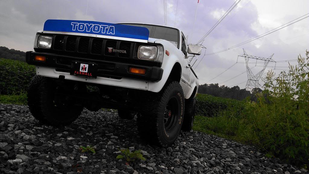

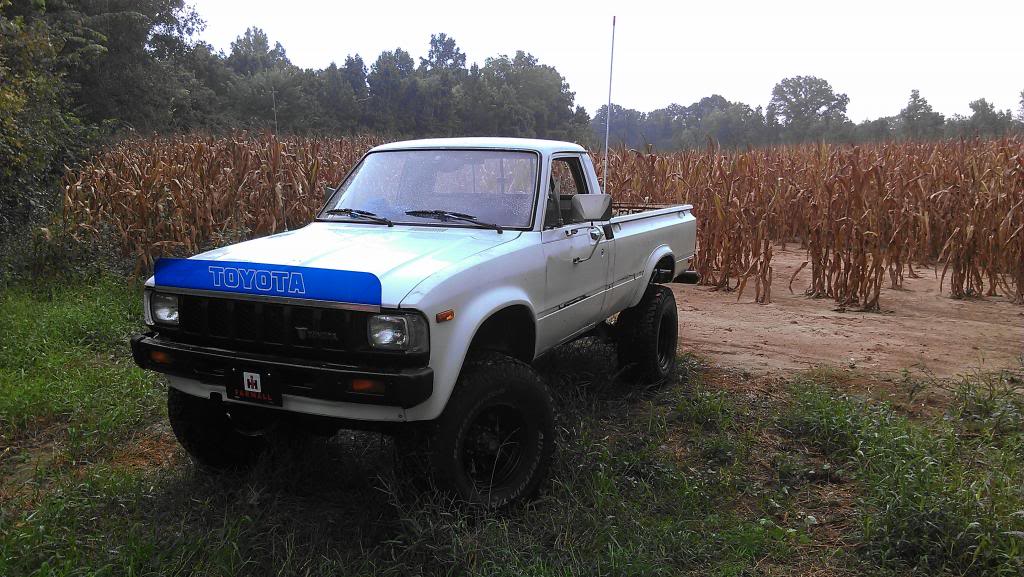

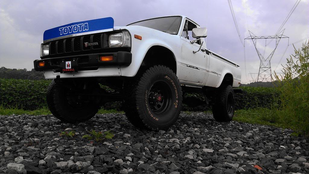

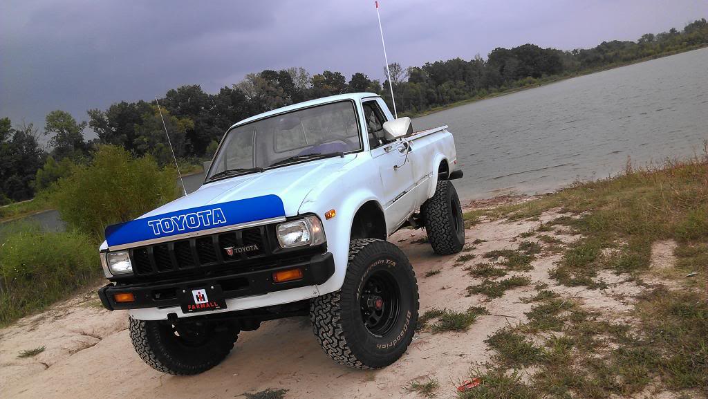

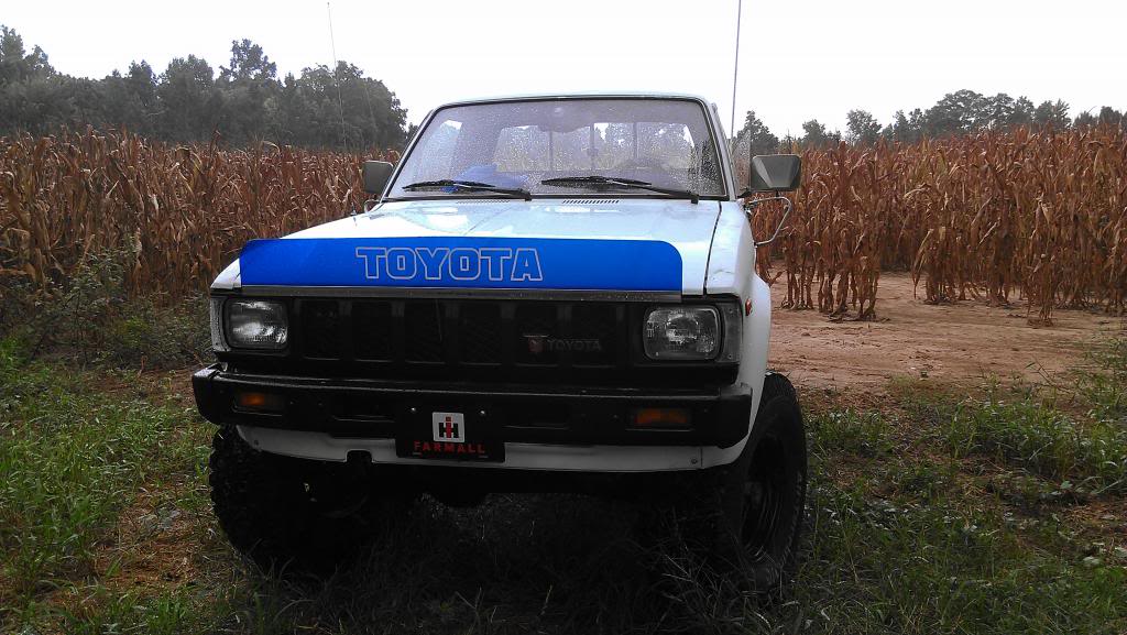

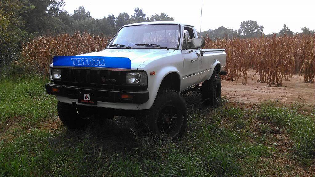

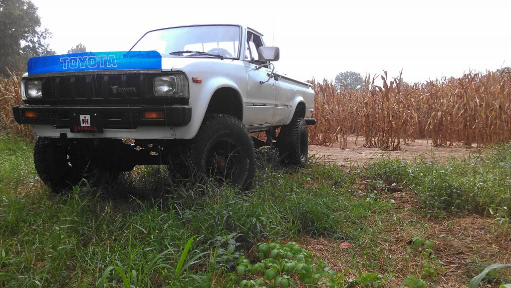

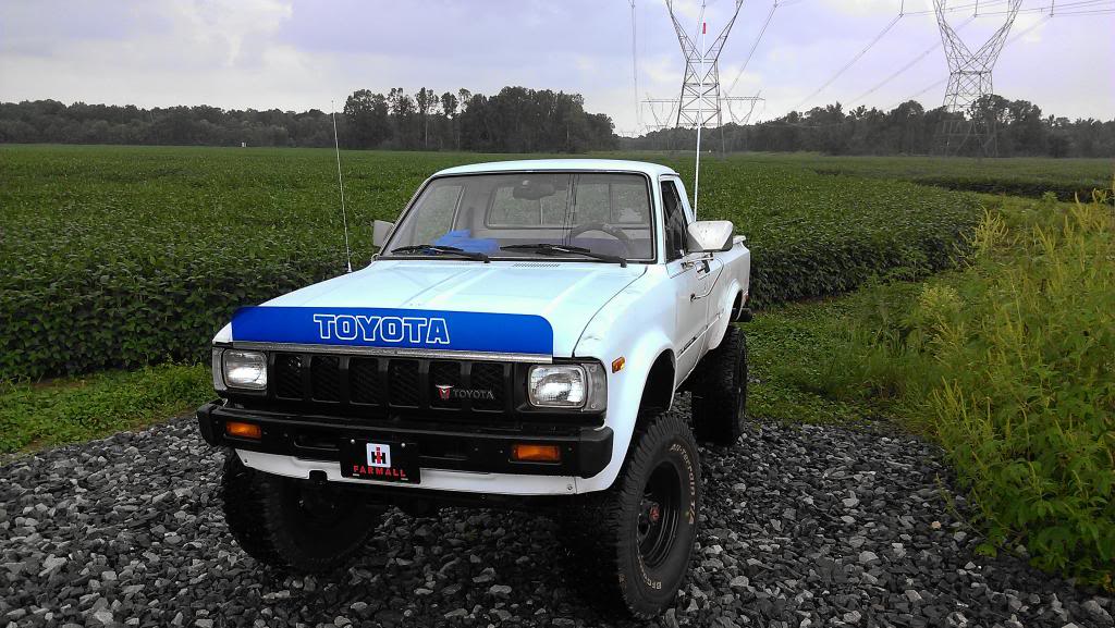

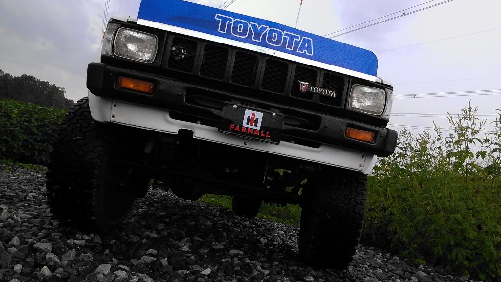

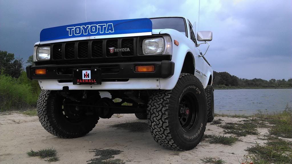

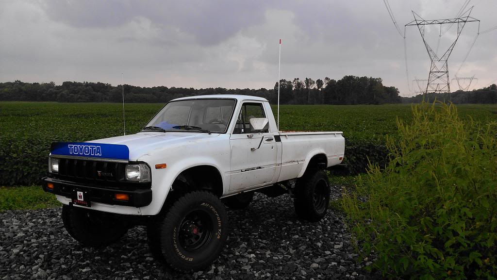

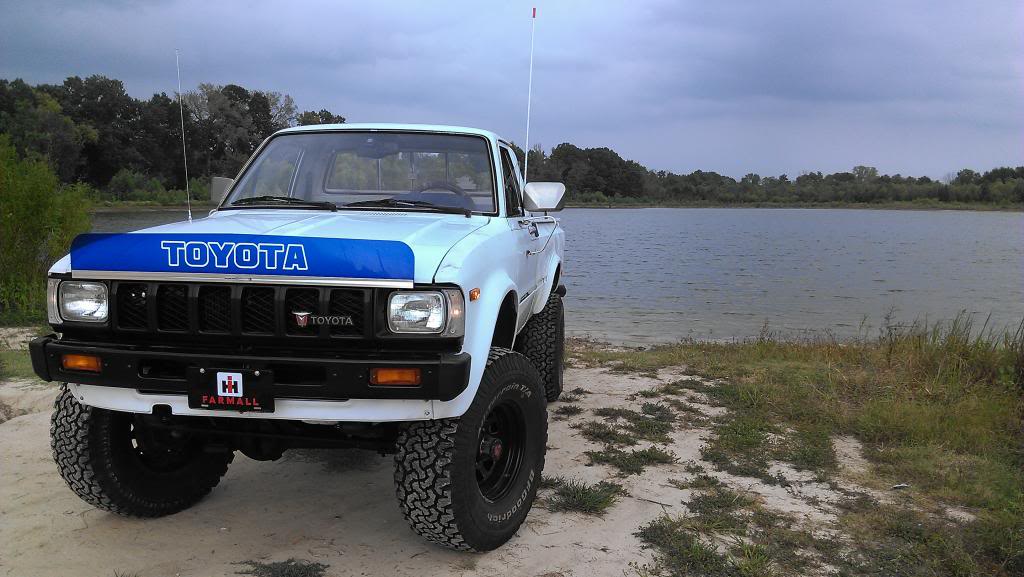

Went out and took a bunch of pictures today.

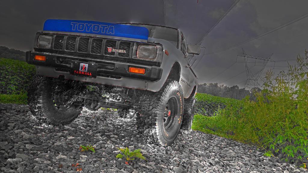

This one I edited with an app

Man, that's a sweet ride. Good shots and angles too btw.
What size are those tires and rims? 3" lift?
Hey.. I need another bugshield bracket to mount mine. MIssing one.

Its a 3" lift with 33x12.5" tires on 15" rims. I think my bug shield has 4 brackets on it. You probably will have to figure something out on it. Also saw your post where you need a shifter knob. I am probably willing to part with mine. I figured out a way to fix my Mack bull dog shifter and I'm also wanting to get one of these

Love the second to last pix of the rig with. The water there.
Love that Mack knob too! Lol... sheild looks good, nice old school touch.

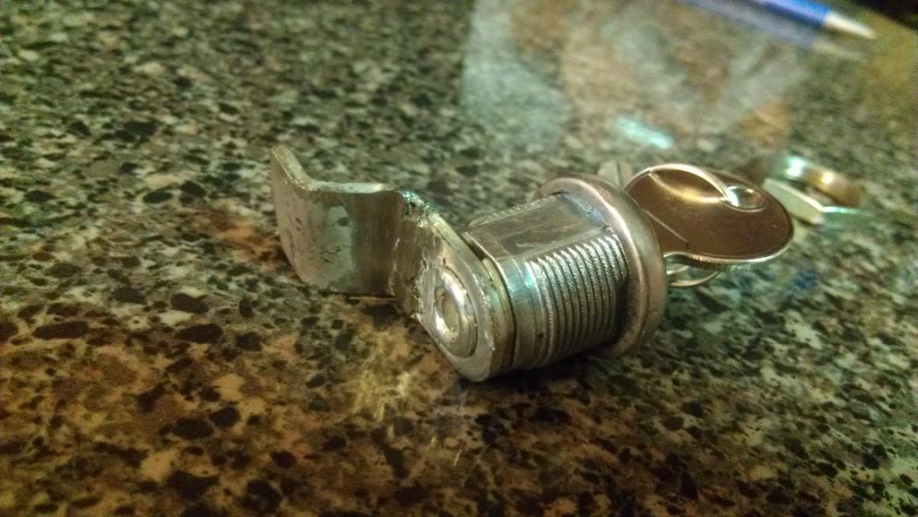

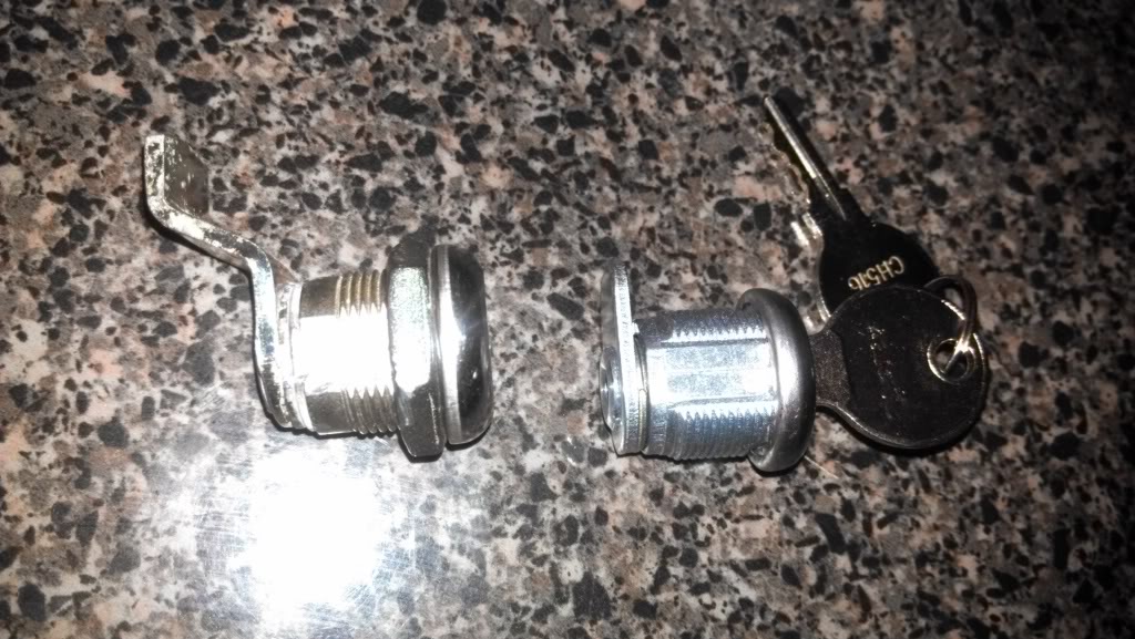

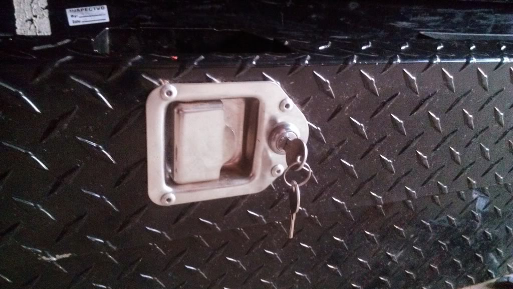

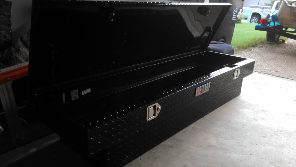

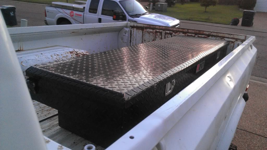

I forgot to put up a picture of my old tool box I got back today. A friend had it for a while but wasn't using it so I got it back.
Problem is he lost the keys. Don't want to store anything in it without being able to lock it of course. So I went to tractor supply Monday just looking around and they had a replacement lock for $10. I thought it was a pretty good deal so i bought it. Well the new lock doesn't have the right bracket on the end of it and that's the only style they make.
I found a replacement key online and they wanted $10 for it but I wasn't gonna pay that much for one key. So I looked at the locks and said "let me play you the song of my people" so two cuts later, a couple of welds and a little grinding the new lock now works.
Stuck it in the back for now:
