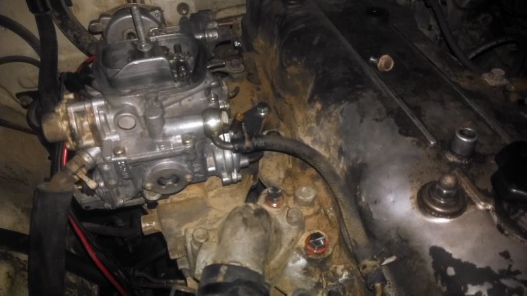

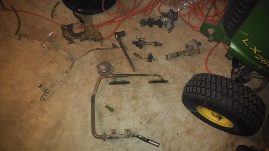

Worked on desmogging my engine tonight. Figured out my truck is the federal/canada 4x4 emissions setup. Here is all the parts I have off so far:

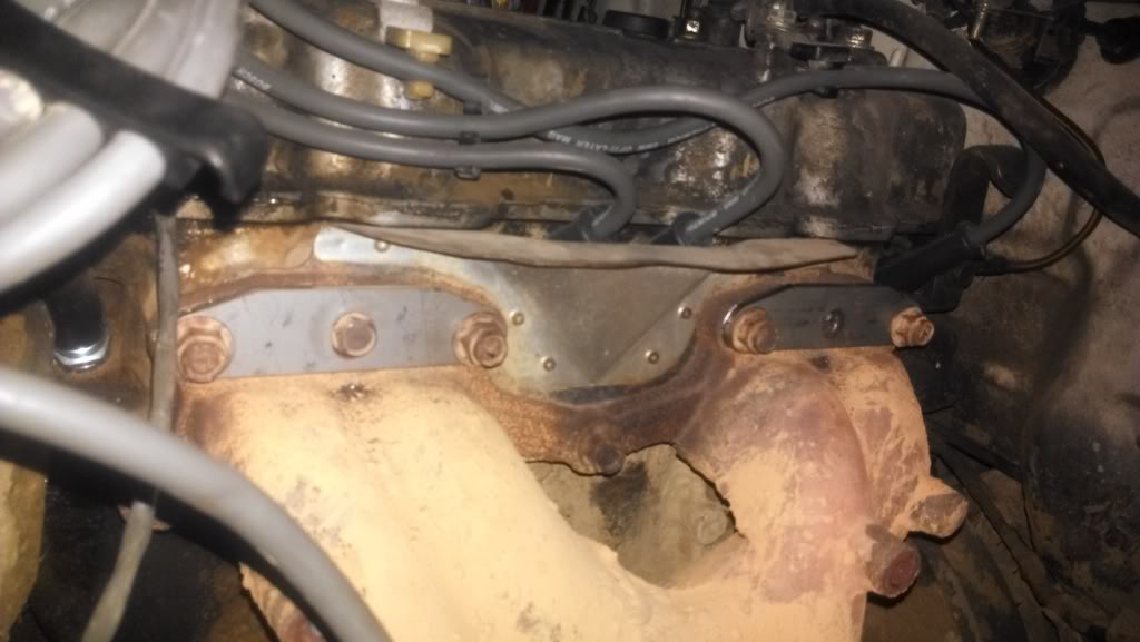

And here is the exhaust side. I broke the middle bolt on the right block off plate when I was screwing it back in. Is it ok or what? Do the middle holes even go anywhere?

Im not sure I should have ordered the kit from LCE now that I have most of it complete. I think it would have been cheaper to order what I needed individually since I'm keeping the heater function. So now I have the pro water block off set I'm not using.
The only part I have left is that egr cross over plate on the back. Looks like it will be a PITA so I'm saving it for in the morning when its daylight and a little cooler. I also have to buy a little bit of vacuum hose to run the advance, some fuel hose to go the pump since I'm not keeping the hard lines for either of them, and a breather filter for the pcv valve. Then put all the vacuum caps on the carb and fire it up. Probably going to to one charcoal canister too.
If I did anything wrong someone tell me before I fire it up lol.

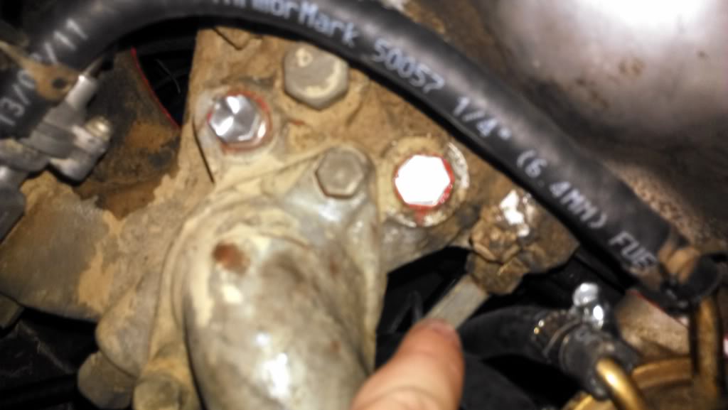

Anyone know what this sensor is I'm pointing to in this pic? Its to the left of the fuel pump.

Temperature sensor...At least that's what it looks like to me..But then again I have always run mechanical gauges on mine and that is where I put the lead on the Yota intakes.
It is the sending unit for your temperature gauge in the cluster.
