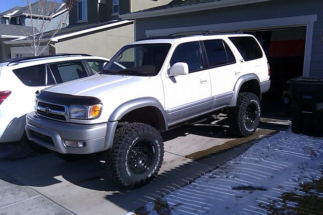

Well I ended up getting BF Goodrich KM2's 33x10.5. Here is some pics. I'm happy I got the 33's instead of the 31's. I just replaced the worn out coils last week. Much better.

So this is stock height or is it lifted with those new coils???

It's stock height. The coils just took it back to factory height in the back.

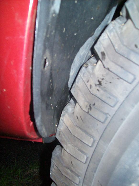

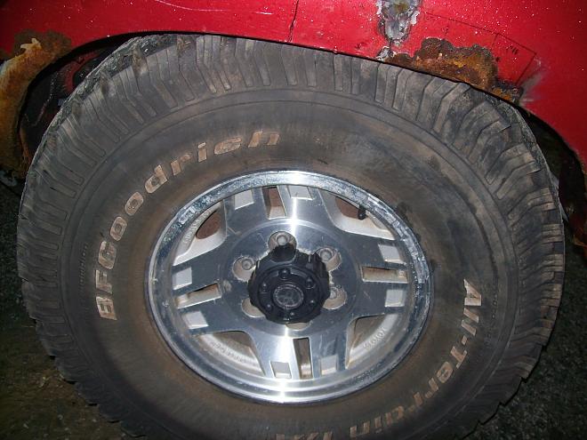

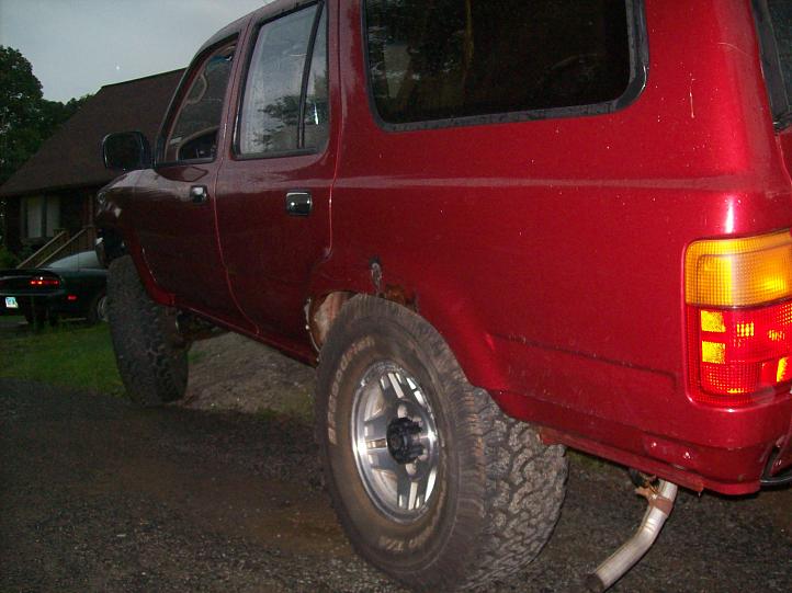

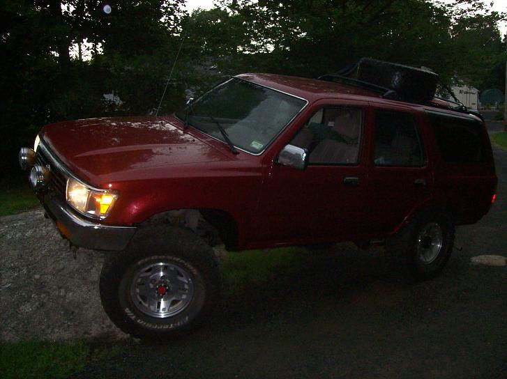

Just wanted to share some pics of my (recently sold) stock height '94 4runner which I fit 33x12.50x15's onto with stock rims. Only had the most minor rubbing on the plastic inner fender well and only on the drivers side. Trimmed that very slightly and ziptied it in place and problem solved. I had already removed the front valance for a better approach angle. Also that was on the stock rims (15x7?) and I ran them with no problem for a good 15K miles.

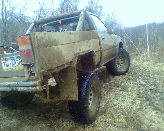

i have the torsion bars cranked up and shackle extenders in the rear and even when flexing i dont have have any clearance problems with my 33x12.50's.from what i have found it all depends how much offset ur wheel have. the more offset the more clearance problems ur going to encounter.
