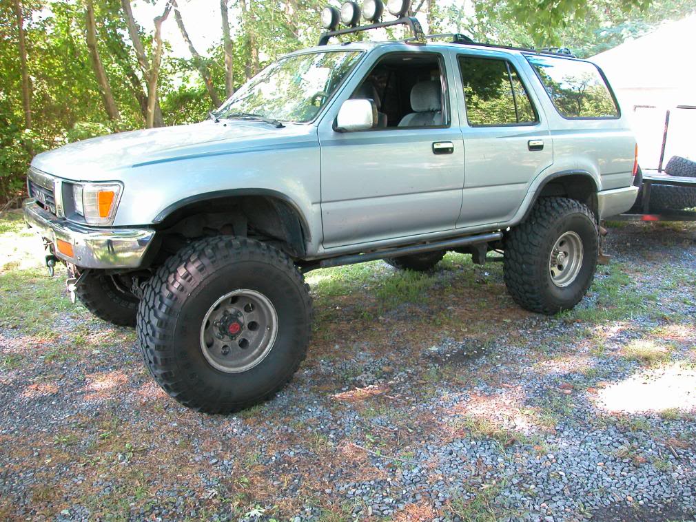

i put a 4" lift kit on my 91 pickup, wondering wat the biggest size tire i can run right now n still have a comfortable ride since its my daily thanks
I run 35 x 12.5 x 15's (rims have 3.75 back spacing you will need min 3.75 bs on the rim to clear the A arms)with a little pinch weld trimming on the Pro Comp Stage II.
I am sure you know if you go to that size of tire you need to regear 5.29's (thats what I run)or 5.71's
