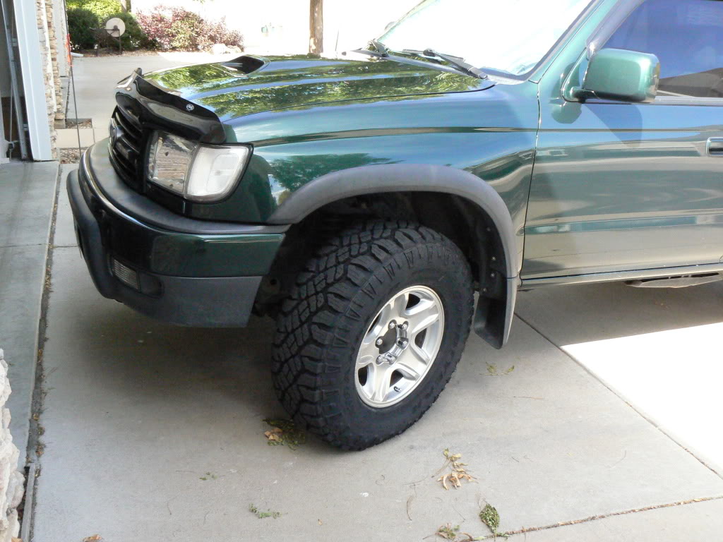

I just got a set of the Duratracs after an enjoyable 4 years on my Nittos but I wanted something a little more agressive looking so hopefully these will treat me the same.
