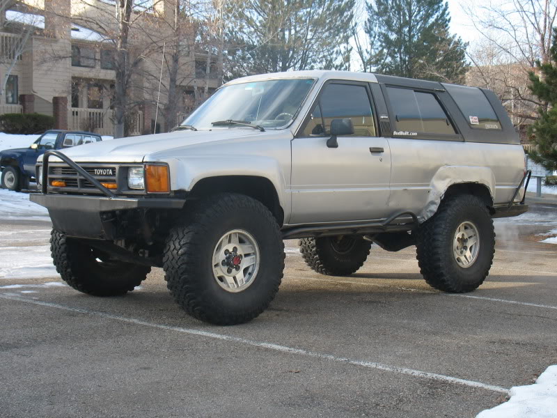

35's at stock front height. Lots of fender trimming inside and some work to the A-arms to work with stock alloys.

But yeah, when I first put on the 35's, I could fit em, but they rubbed a bit at full lock, and a lot when flexed. I cut a bunch out, now they fit great at full lock and full flex.

AxleIke, your truck looks good with 35's. They actually dont look to big to be on a stock height truck.

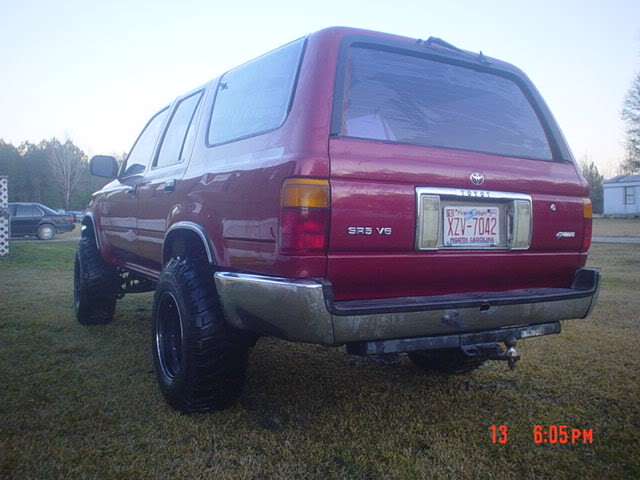

31 10.50's but their on 15x10 wheels with 0 offset. The same tires were on 15x8 wheels with +35 offset and they rubbed like crazy.

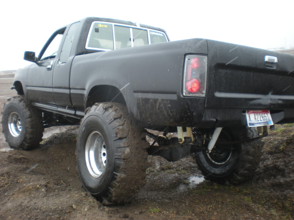

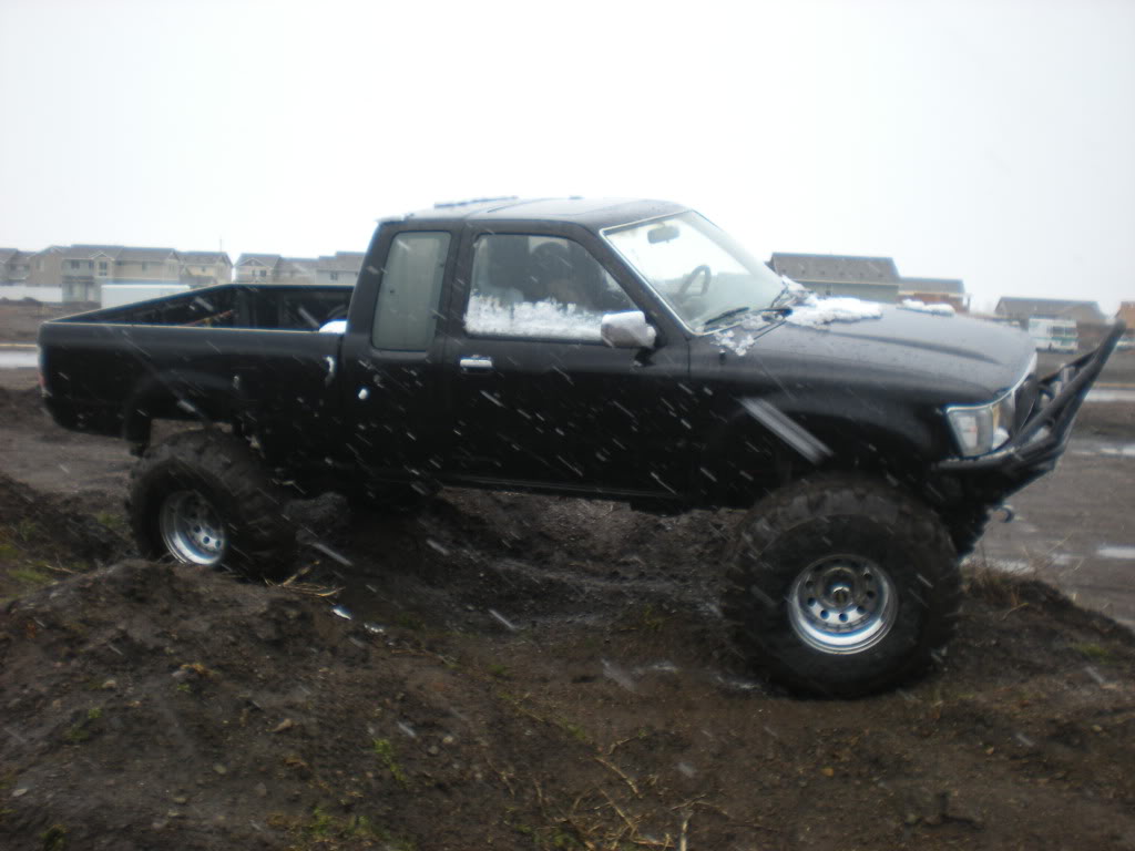

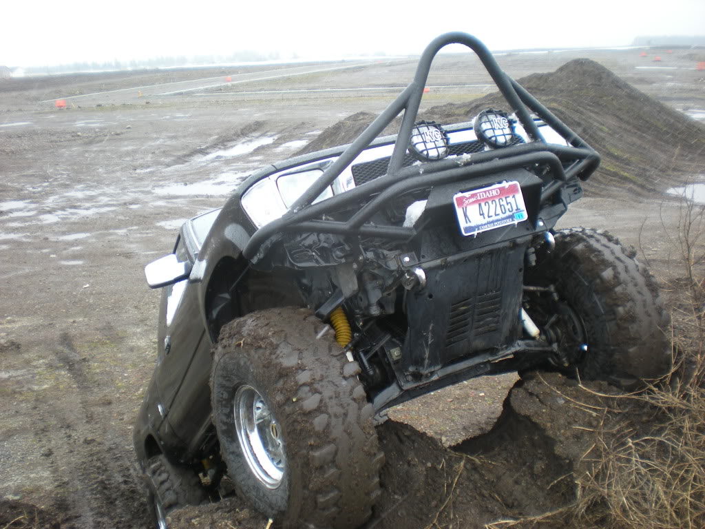

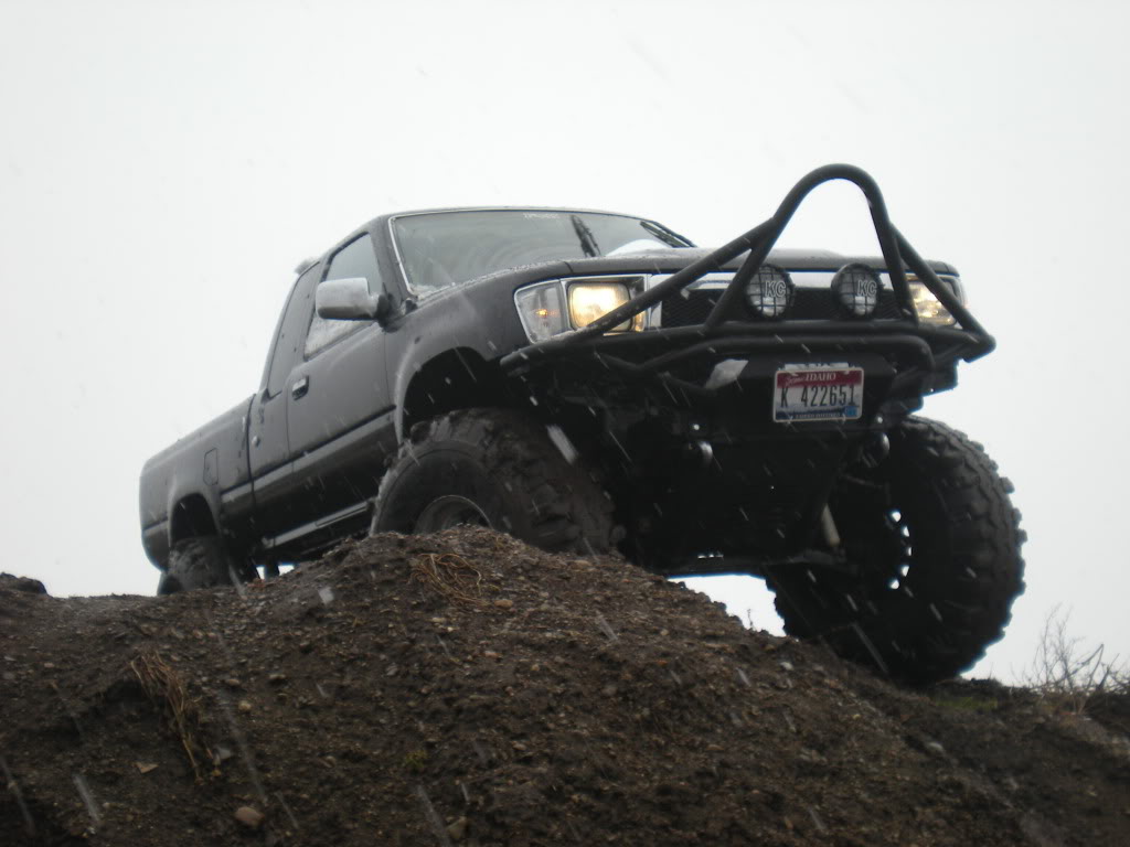

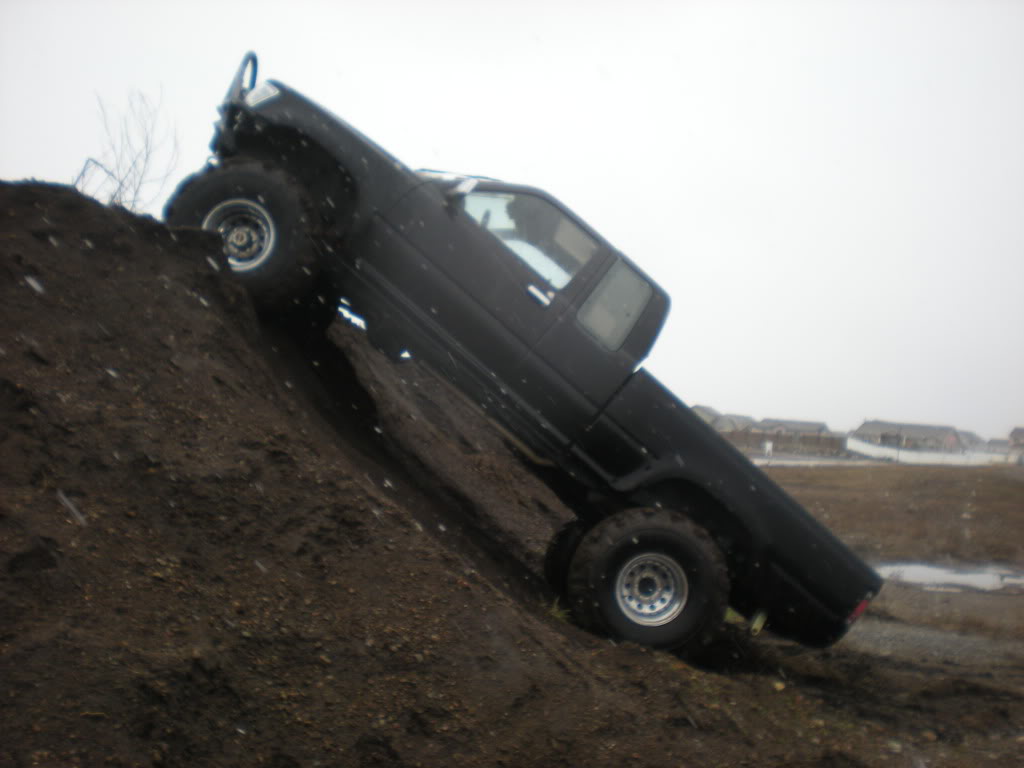

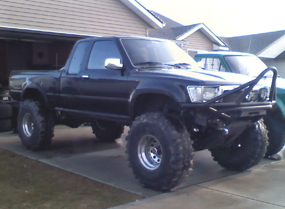

38's with a 5" ifs lift, no fender trimming what so ever.

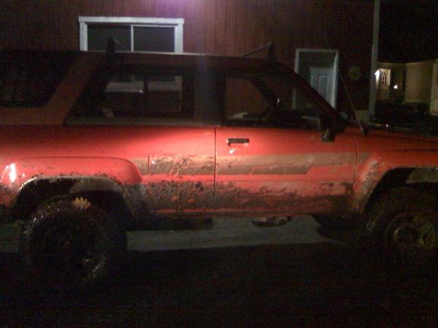

what will my 1986 4runner fit under it with a 4" rough country lift on stock rims? i Know rough country says 33x12.5's but everyone on hear says you can clear 33's with alittle triming. So im thinking i must be able to clear 35's!
Look at the top of the page. Mine is on 35's and has no lift. You'll be able to fit 35's just fine.
