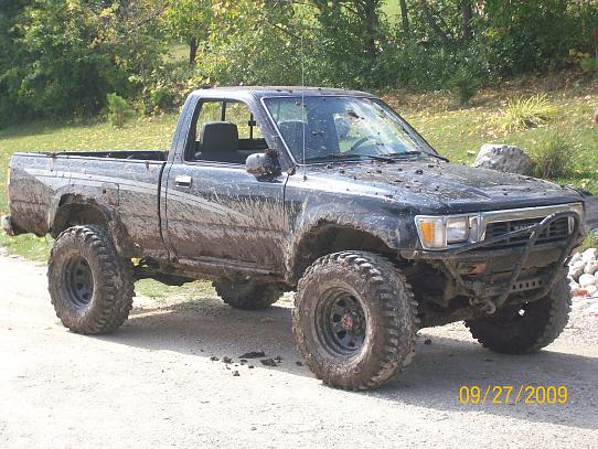

100 percent off road with 33x12.5 no rub... is say run it.
Attached Thumbnails The OFFICIAL IFS "What size tire will fit" thread-100_1786.jpg
