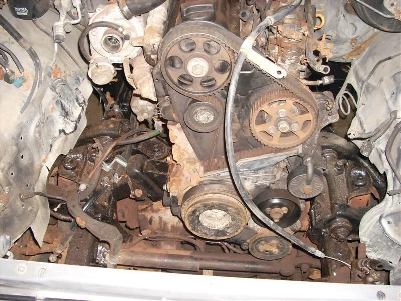

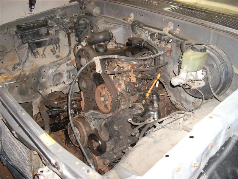

Well I got the body on today. Ran into a problem though, the firewall hits the back of the engine. There is a coolent outlet for the heater on the back of the head, I removed it but it still hits. I am hoping I can block that outlet and drop the engine down an inch or so. What a pain this is going to be. I am going to have to cut my mounts off and remwld them lower in the frame. This is what you get when you do it without the body on.
I tryed jacking the body but I got 3 hockey pucks under each mount and it is still not clearing (3inchs of lift). At lease the body is on and I can start woking on everything else as well.

Well that's annoying flash...
You can't really cut anything out of the fire wall either because the heater/AC stuff is right behind there tight to the wall as well...
but if you were to try you might be able to steal at least an inch or so there since there is about an inch and half free space between the heater box and the back of the dash/radio though you would probably need to fab a little new duct work [maybe]...

okay I rewelded my mounts so that the engine is as low as it will go without hitting the oil pan on the diff. I left just enough room to get the drain plug out. With 2 inches of body lift I have between 1/4 and 1/2 inch clearance between the vavle cover and the firewall. i didn't want to lift the body but i see no other way to get it in there.
If I was to do it again and for anyone else who is going to do this swap, I would move the engine and trans/t-case forward about 2 inches. The engine is so short that you would still have lots of room at the front but would give you some room to play with at the back.
I have to make a little plug for the back of the head so that I can redirect the coolent out of the side as the regular outlet hits the firewall.
Next I have to hook the rad up, do some wiring, and run the fuel filter and lines so that I can fire her up. Soon very soon.......
