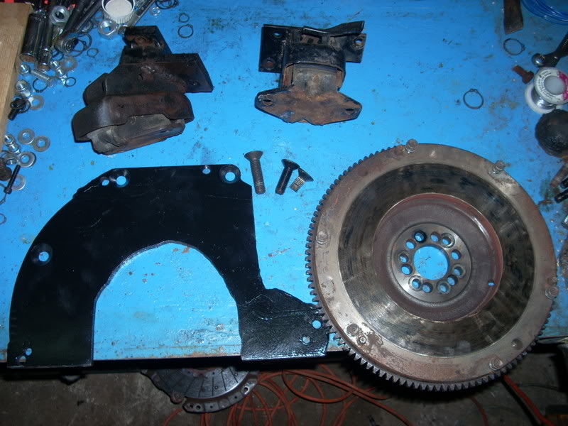

I will ship it all to you in Niagara falls for $250 CAN.
