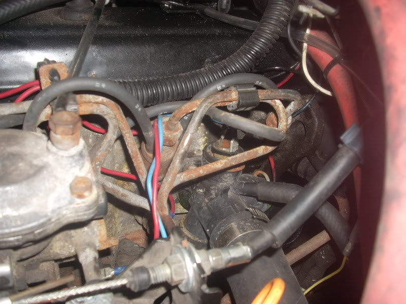

After reading your thread, I to plan on doing this conversion. I have a 1993 4cyl 4x4 extra cab and I just picked up a 1997 TD Jetta for this project.I had a few questions:
1- Did you use the VW accelerator pedal or cable?
2- For the power steering lines, did you get new ones made or did you modify the vw ones?
3- What kind of mods if any did you do to the injection pump?
Oh ya, Excellent work!, I found your thread to be very informative.

I cut the Toyota cable down and just used it. You can see in this picture a bit. I used the end off the VW that attaches to the pump then made a collar with some set screws that hold the 2 cables together.
I went to a hydraulic place and had them make me a hose for the steering. I used the bottom bango fitting that came on the VW then a compresion fitting to a new hose. If you plan right (I didn't) you may be able to use the toyota presure line and just get a compression fitting to the steel VW line.
As for mods I put on a EGT guage for starters. Make sure you do this because it is easy to get hot, also easier to put the probe in before the engine is in. I then changed the aneroid pin to a 1.6 and cranked in the max fuel screw about 1 turn. I also backed the wastegate off to allow for about 14psi peak boost.
YOu have to watch it with the max fuel screw. At first I had it where if I floored it or was climbing a hill I could fly right past 1400F EGT which is bad. You won't know this without a guage.
