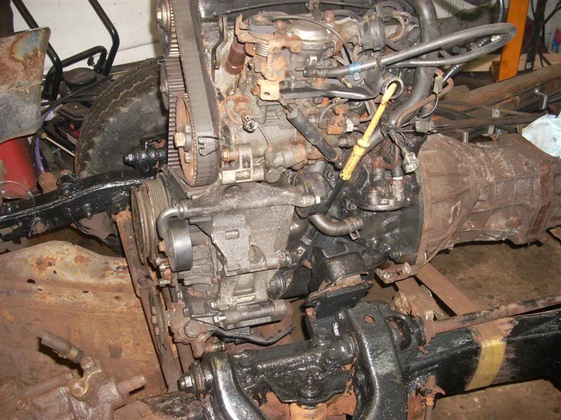

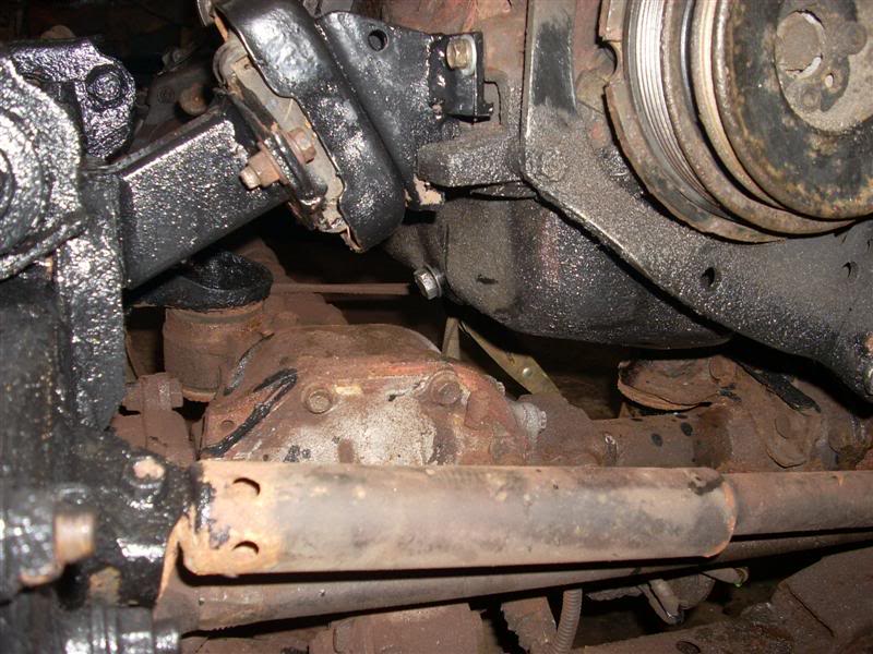

Well I got the engine in today. I had to put the VW trans back on to find TDC. The germans build good stuff but man what a stupid setup that is. The pointer for TDC is on the trans so if you have the engine on a stand you are screwed. I put the trans back on and scribed a mark on teh front pully so I can find it if I have to.
I was worried about the clearance under the pan but it worked out good.
I checked the pan gasket and it was okay but there is still oil getting out on the one side of the engine. I think it is just blowby so I will wait and see how bad it is when it is running.

how did you figure out the clutch set up for this one i dont think i saw it in your right up but man looks real good but tiny lol going to be a gas sipper thats for sure

Well I mounted the Toyota fly wheel on the VW crank, then just use the regular Toyota clutch assembly. The only other thing is the pilot bushing in the VW crank.
