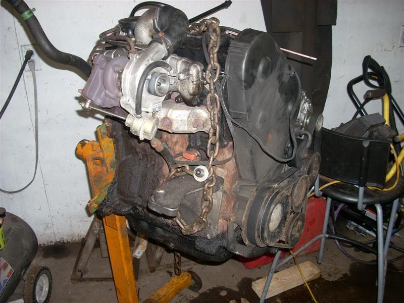

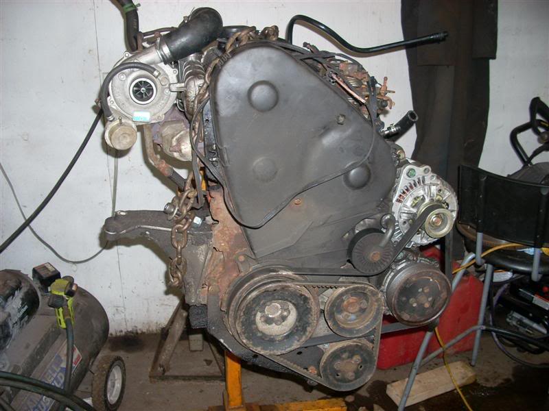

My 1.9 is not a TDI (direct injection) it is an IDI (indirect injection). This means that the explosion takes place in a pre combustion chamber inside the head, not on top of the piston. The force gets pushed through a cup to the cylinder area. This is how most diesels work until recently.
TDI's, the injectors are right on top of the cylinder and the combustion takes place there like a gas engine. This requires higher fuel pressure and electronic control of the pump.
My injection pump is a standard mechanical style pump with no electrics to make it work, all mechanical. All VW engines (that I know of) up until the TDI was introduced in 95? where like this.
If you go with a TDI you will have to get the computer, wire harness, ignition switch (imobalizer<sp> in the key, no run without the key). Big pain in the ass. You will get more power and better milage though.
This install is NOT easier then a V6 Toyota swap. There is a lot of clearance issues. If you read Zookies thread he mentions that the diesel vibrates a lot with the auto when you put it in gear. Also the torque converter will not take advantage of the diesel torque at low RPM. You will have to make very good mounts for the auto. I am using the stock 22re's.
The 1.9 that I am using was not sold in the US only in Canada. The US was TDI in 95 (from the 1.6 TD idi engine) but Canada still had TD (IDI) 1.9 until 98, engine code AAZ.
Here is the engine on the stand.

The POR15 goes on good. It is very thin and runny so it covers very good. When it dries it gets thick. Cool stuff. It goes a long way. You are sopose to do 2 coats. I did one and I can see some rust dots in it as it comes through. I am going to do 2 coats this time. This stuff would be perfect for the floor of the cab. Put on thick and it would last a long time.
