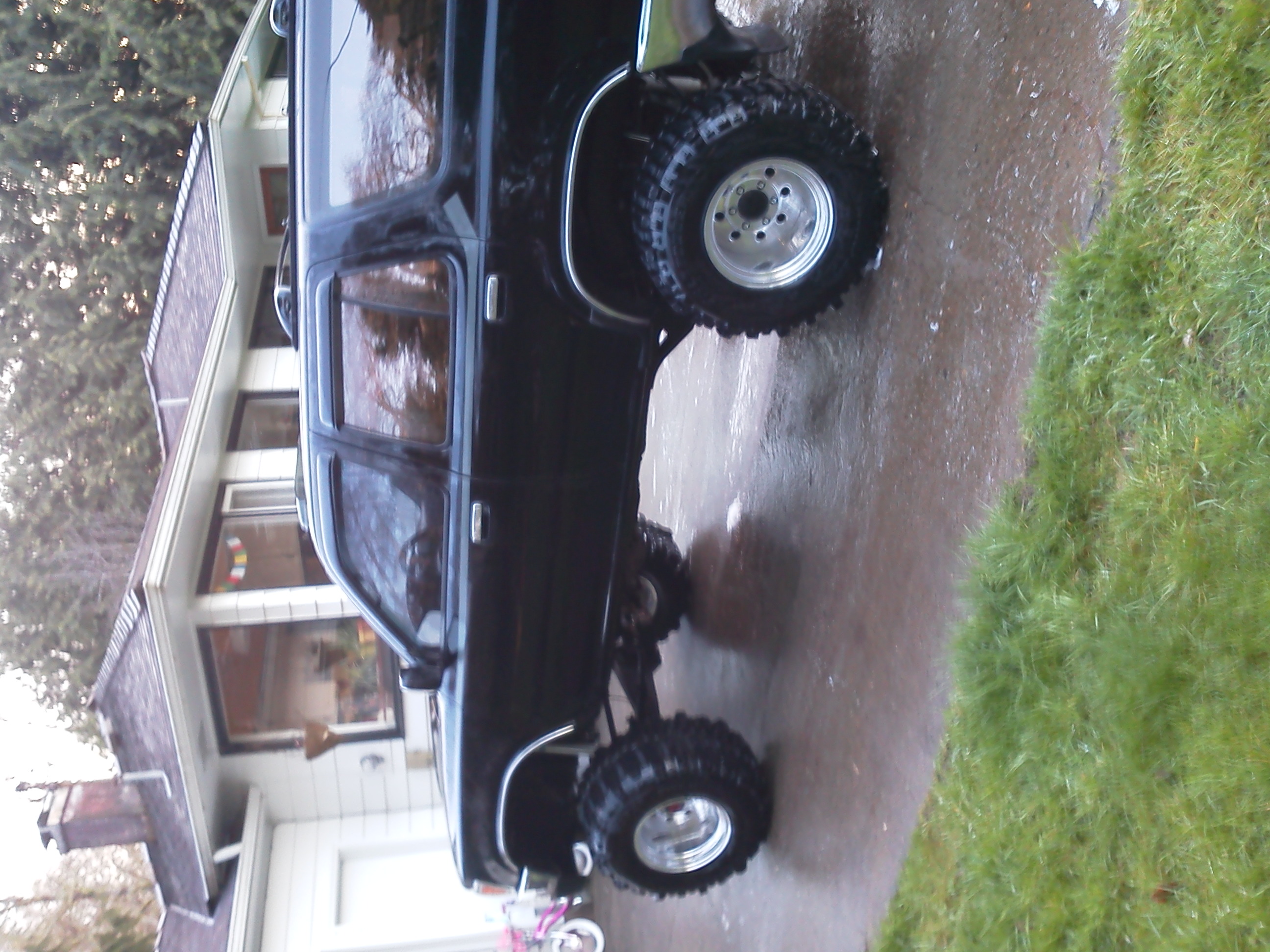

om617 swap ina 4 runner
? m617 for you hardcore swappers. im putting a om617 in a 94 four runner just wondering if i need any vacuum stuff or special parts to save before getting rid of the six leaker. ill post some pics of my runner so you guys can pick it apart. 3 in sas trail gear swap with 33x14.5 boggers with weld super single 13 wides. . o and sorry for bustin in on the thread. been doin a lot of work on my motor and talkin with alot of people about performance on the om617. a guy (dieselmakin from germany) seems that i am going to get an m pump and send it over to get hopped up through him. he does amazing work the the guy is a beast with pumps.

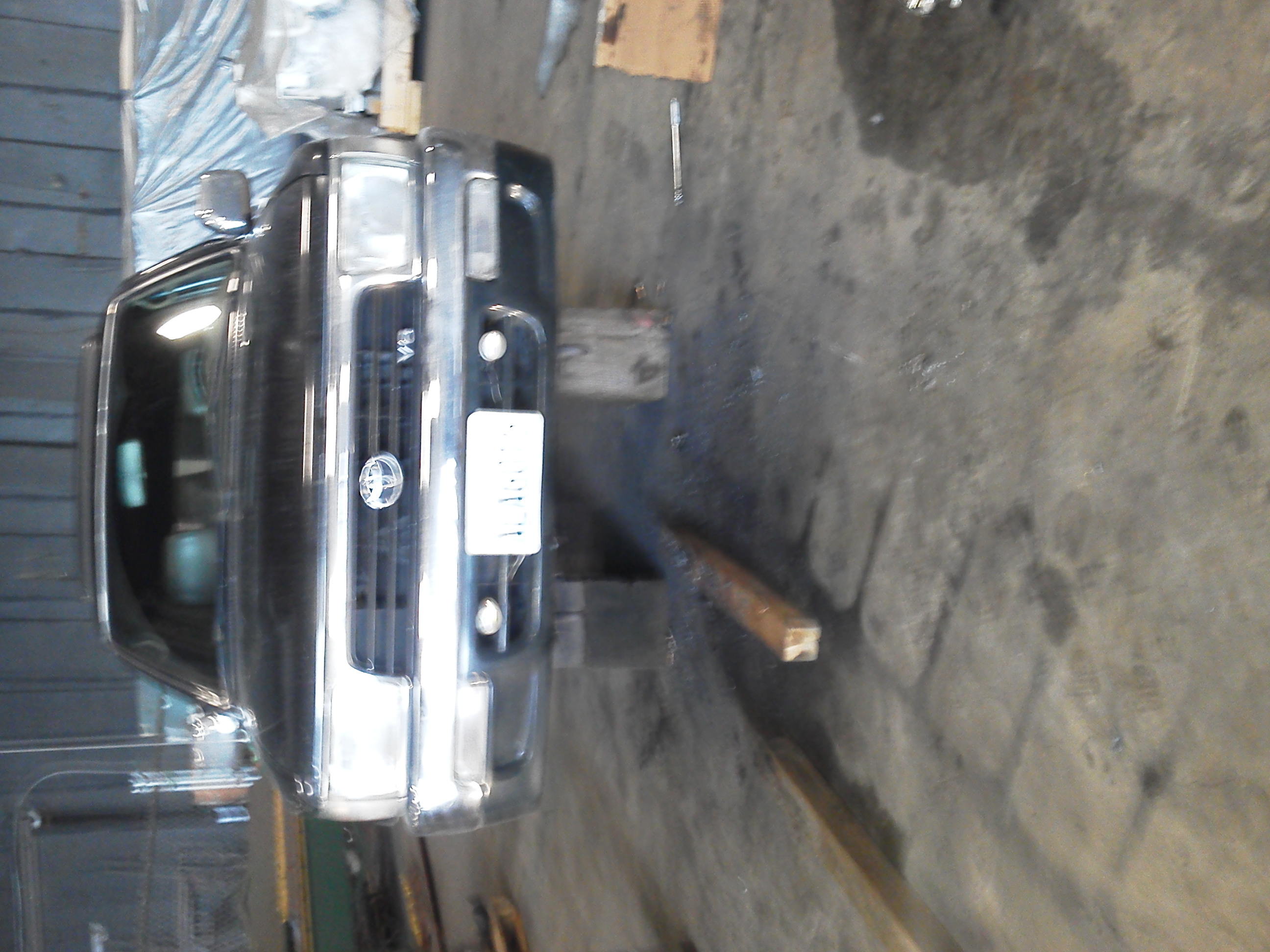

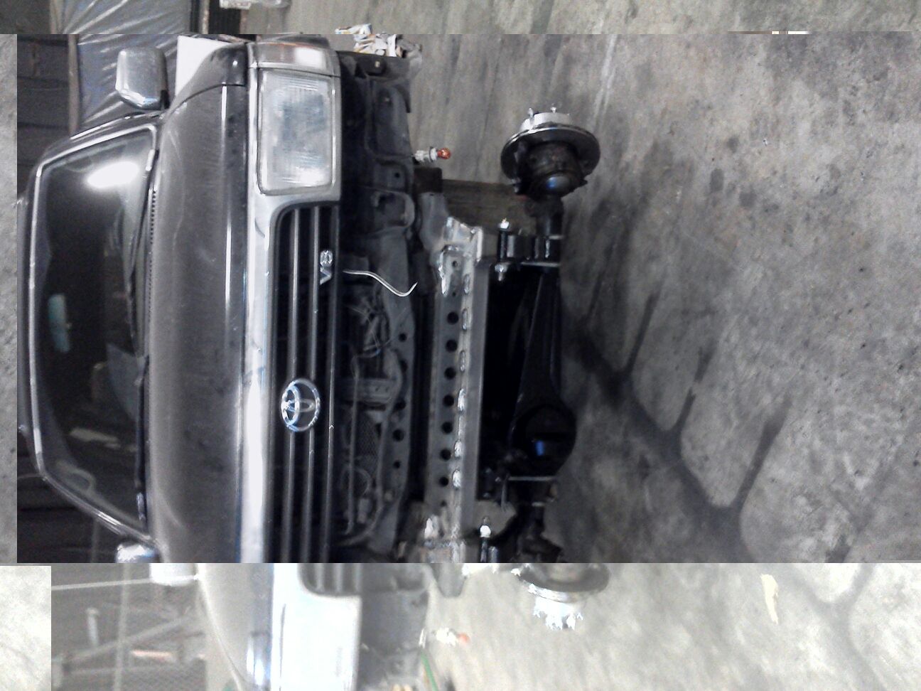

the four runner sas swap
Attached Thumbnails Project: 86 p/u sas/om617 diesel swap-img_20130306_134704.jpg   Project: 86 p/u sas/om617 diesel swap-img_20130322_185832.jpg   Project: 86 p/u sas/om617 diesel swap-part_1367385289539.jpeg

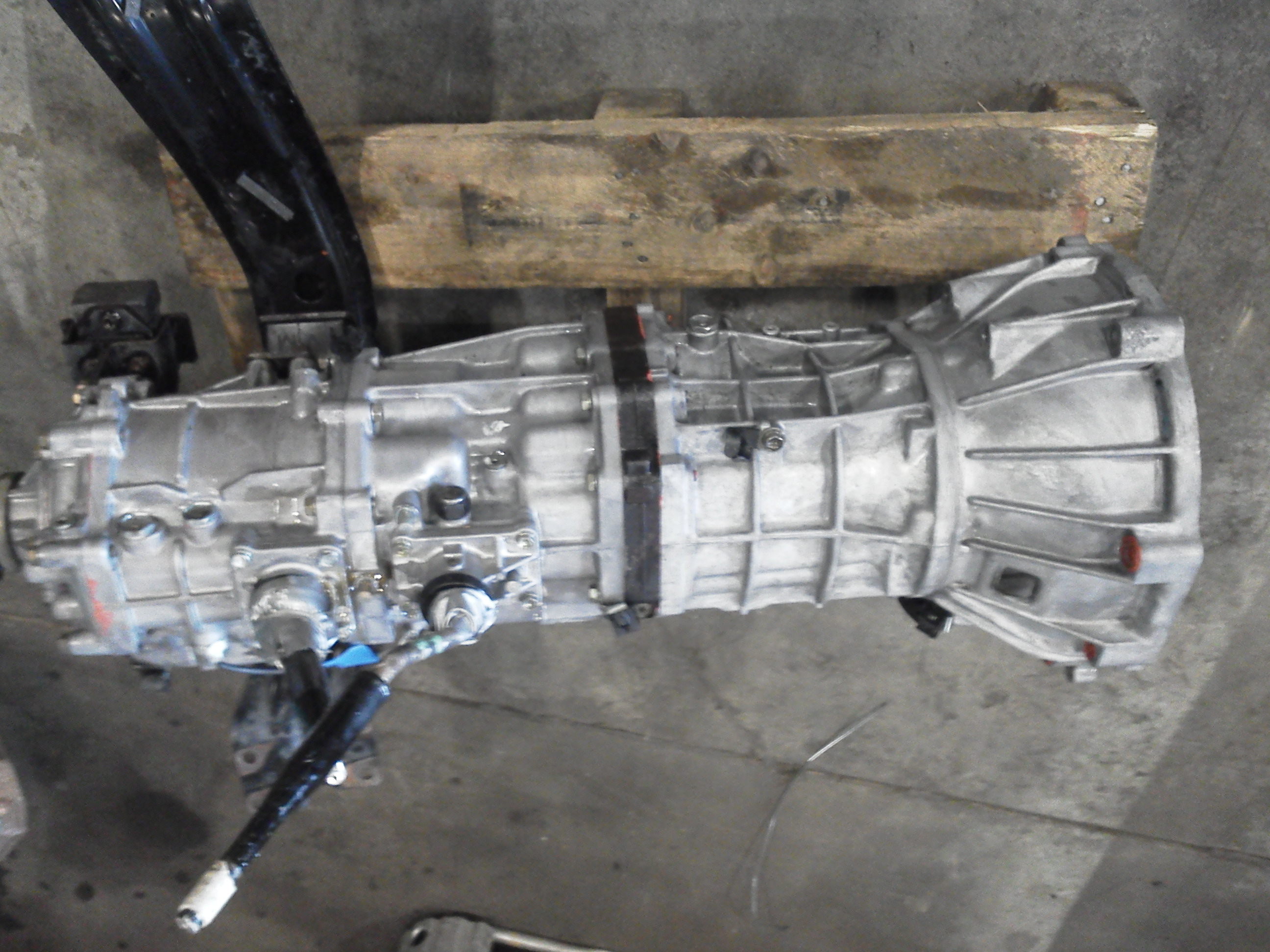

random pics
Attached Thumbnails Project: 86 p/u sas/om617 diesel swap-img_20130307_181820.jpg   Project: 86 p/u sas/om617 diesel swap-img_20130427_162714.jpg
