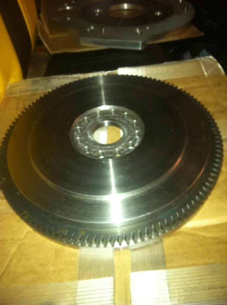

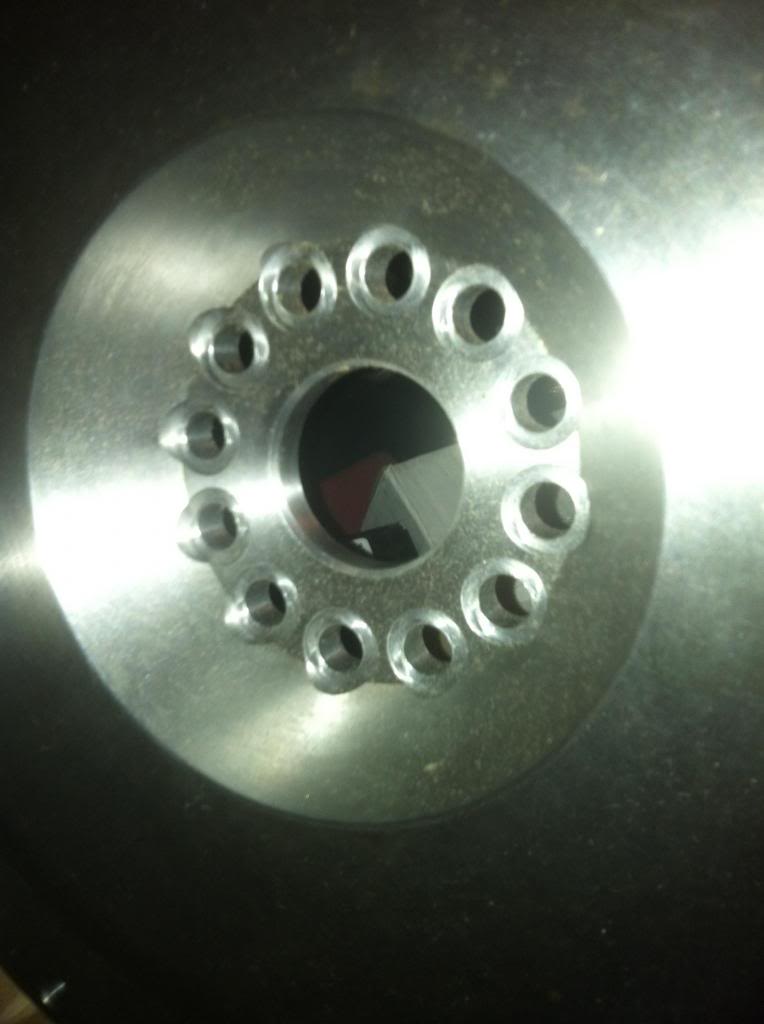

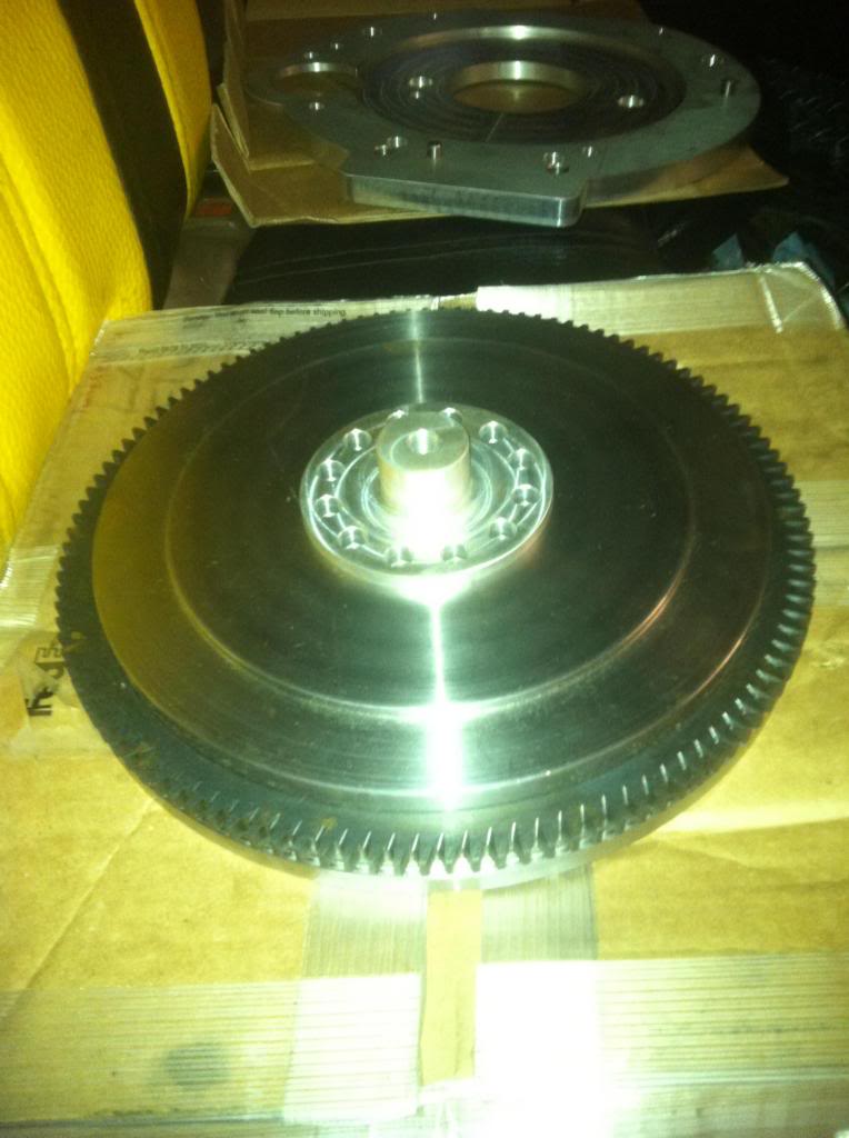

Finally got the flywheel 2 months after I ordered it. Luke gave me the run around on it until I demanded it. It still came too late and put me in a huge bind. For that, I was very disappointed (and angry). Here are some shots of the flywheel:
The 35# flywheel has made a worlds difference. The new Dual Comp LC Engineering clutch grabs SO GOOD, but IT RATTLES LIKE A CAN FULL OF NUTS AND BOLTS!!!! I am very disappointed. The centerforce was also noisy; I thought I was getting away from that. Next time, I will simply get a stock Aisin replacement.
The 4.7:1 T-Case is sweet, too! For anyone searching for gearing information, I would recommend calculating the regear for the stock 22R motor. I calculated the car, which came with 3.03 gears and 24" tires. The regear for 37's should have been 4.56. I went up and went to 4.88 just to give it more oompf for all that extra tire mass. I should have went 5.29, however.
I can't comment on power or mileage yet, as my EGR tube cracked, and I can't make full boost. My egt's are soaring and it's a huge pain. I'm going to just weld the manifold shut when I take it off to install an intercooler.
I never thought about it, but you could just weld the EGR valve shut, or make a gasket for the intake manifold out of a pop can to just block the EGR.
