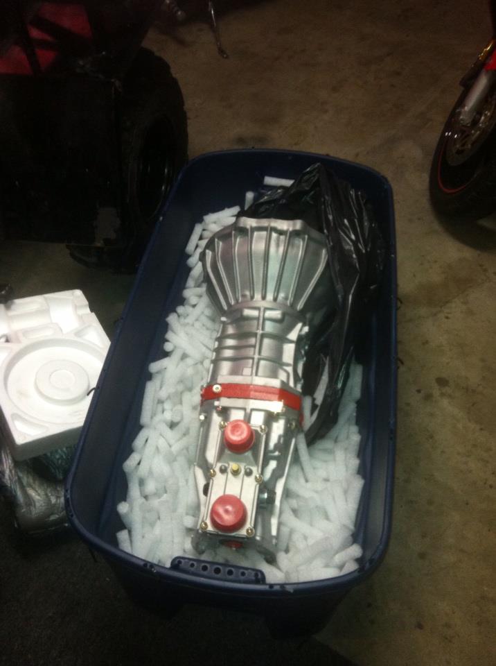

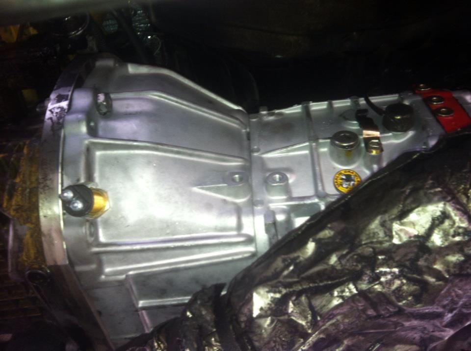

Tranny is in.

You can see my Dakota Digital flywheel sensor for my tachometer in the 2nd pic. I have another bellhousing the I used as a test piece before I cut up my Marlin bellhousing, and the test one turned out better. I'll sell it to anyone that wants it; just PM me.
The tranny went in smoothly. One BS fact that I discovered is that the older T-cases have LONGER SHIFT FORKS!!! Wasted 2 brand new seals and an hour of time sprucing up my G54 t-case. Had to then go back and spruce up the crappy W56 t-case... I still hear some weird rattling noises, but now I'm not so sure that they aren't engine noises instead of tranny noises. Tranny works good and shifts tight, though.

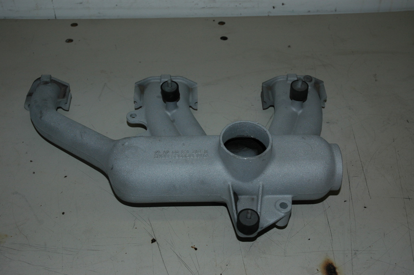

Look up an intake from a none turbo om617 I believe this is an easy swap? May not be but I seem to remember people doing this to intercool.
For me I would take the stock turbo off and cut and weld to need.
Attached Thumbnails Project: 86 p/u sas/om617 diesel swap-om617noneturbo.jpg
