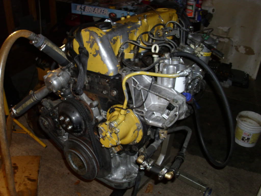

Lol, thanks for the compliment! I hope it is louder than any other merc out there, cus that's exactly what I want. I'll be running a straight 3" pipe up to a 4 or 5" stack when all's said and done.

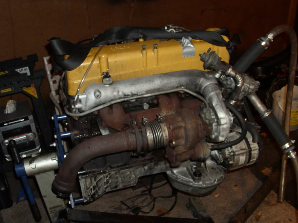

Sooo, some interesting things for today. Went to fire it up at 7:30am this morn with 25 degrees outside. Wouldn't start. Used a quick whiff of ether and she fired right up. Then I figured out the glow plugs as mentioned above. Now it fires like a champ. Fired it 2 more times cold today. Worked excellent. Now to the fun part...
On the start up at about 2pm, the oil cooler vinyl line kinked, built up pressure, shot off the vinyl tube, and then lubricated my garage with 2 gallons of oil.
Actually that's not funny. Anyways, I shut it down right away, so hopefully no harm done. I used some of the stock hydraulic line from the oil cooler to splice in this time (I'll get a pic up later). Now it is a straight |_| instead of a V or a U. Only problem is I can't watch the oil flow. I'll be cleaning for a while tomorrow....
Last update, I went and bought some new oil, and some antifreeze. Fired the engine up, let it get warm, circulated a 2 gal bucket of water through and dumped the bucket, twice. Then I put the gal of coolant in the bucket and tried to get it to circulate through. So now hopefully I can quit worrying about it freezing over night (cus I hadn't thought of that till today).
Gonna need to figure out a better temporary exhaust system if anyones got any ideas

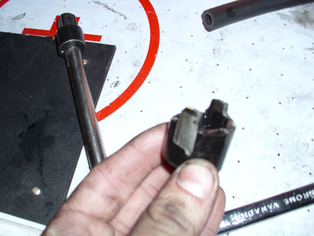

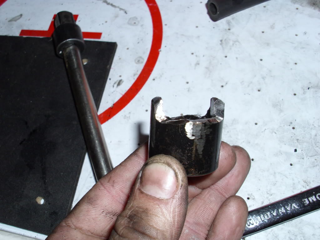

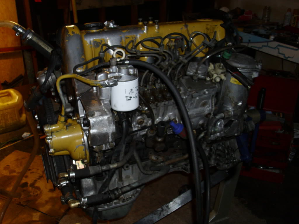

Here's my update for today. I made this collar socket for the prechamber collar. Got a $2 socket at the pawn shop, instead of buying mercedes' $90 version.
I adjusted cyl 2's valves, they were the only tight ones in the engine, so I thought that'd solve the compression issue. It didn't. So I pulled the collar out and cleaned it. There was a lot of crud in there. I tightened it back down and I went from 120psi cold to 130psi cold. Then I pilled the injector hole from the heat shield to the top, twice, with some 15-40w oil and my compression went up to 200psi. I don't know if this means my rings are shot or if maybe I just blew out the head gasket on that cylinder. I'm hoping for the latter. Only problem is I don't have $200 for new rings. As good as the engine ran, I think I'll just go with it. Should have checked this engine's compression the day I bought it. I got a new head gasket coming from peachparts.
Assembled the engine, sealed it off, and used the rest of the afternoon to rid my engine of filth!
I can see my oil filter housing and my crankcase!!!
Also ran a LOT of water through all the coolant hoses and tried to completely flush out the engine.

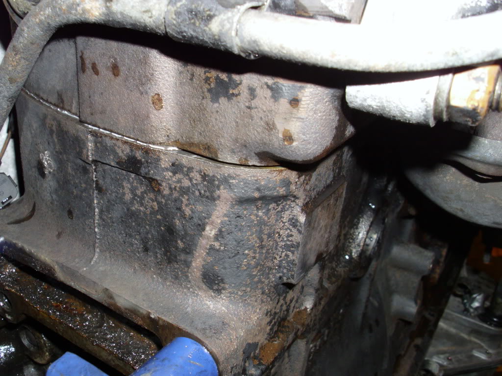

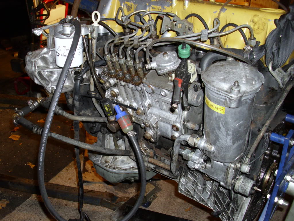

Here's the corner where what I believe is oil, was leaking out of the head gasket. Is this common?

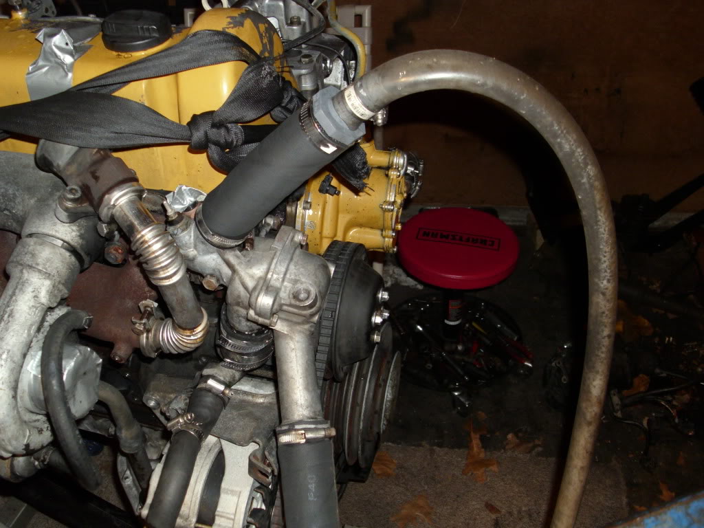

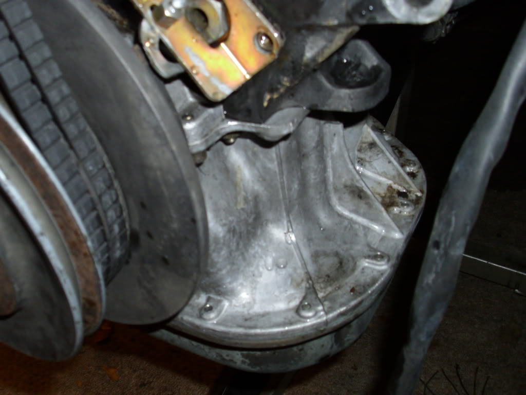

And here's my coolant setup.
What I'd like to know, is do I have to have water filled in the top right hose to the point where I can see it in the tube? Otherwise I'm going to assume my thermostat failed.
And last but not least, does anyone know if the #2 cyl is the first to go out, like the 4th cyl in the 22r is?
I think tomorrow I'm going to get an adapter for my compression tester fitting so I can hook it up to my air compressor and put some air pressure in it to see where it leaks out of.
