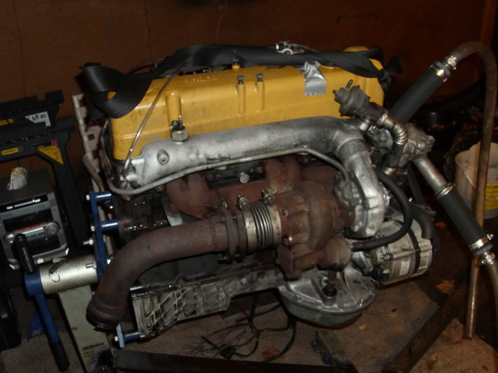

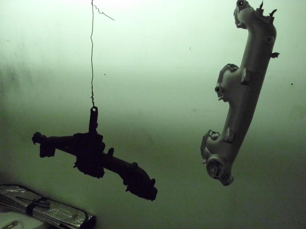

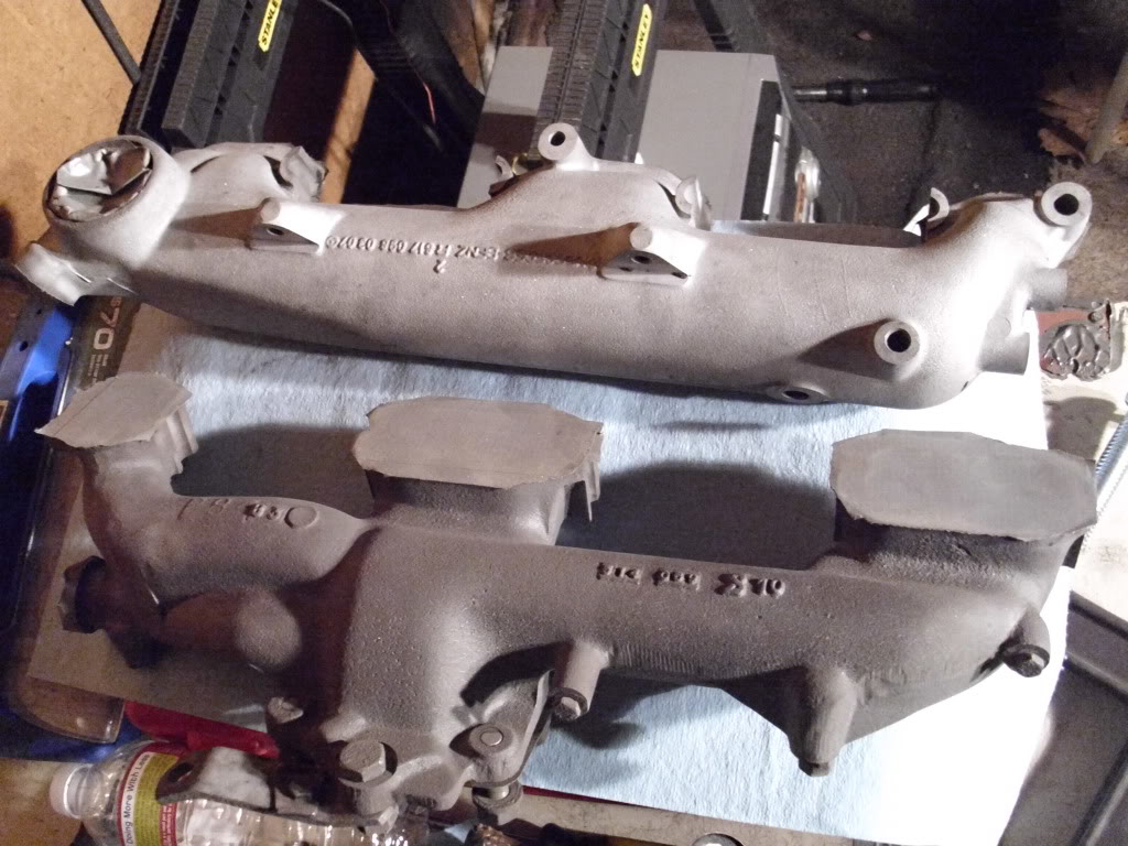

Now the fun part. I borrowed my buddies sand blaster. That's the good thing about being in college and meeting different people with similar interests; you get to borrow a lot of cool things, like a power washer and engine hoist and sand blaster. I blasted my manifolds and hit them with cermaic "very high temperature" coating paint I got at O'Reillys.
Before:
Blasted:
Painted:
On my 2 good cylinders, there was no air from the exhaust or intake ports of the head. There was a lot out of cyl. 2, and some in 4 and 5. So I hope this is great news. Hopefully all I have to do is lap and polish my valves and I'll be good as new. Must just be a lot of soot and crap on the valve seats from the valves being ran TIGHT for so long. Hoping this is a simple afternoon job in my garage.
I'm going to look into getting my head acid dipped so clean all the crud out of it. The ports are HIDEOUS!
Before:
Blasted:
Painted:

On a positive note, I got just about everything on the engine sand blasted minus oil and fuel lines. Got everything painted tonite except the IP. Hopefully it doesn't all fall off as expensive and time consuming as it was. Thinin about throwing my manifolds in the oven since the can gives baking instructions.

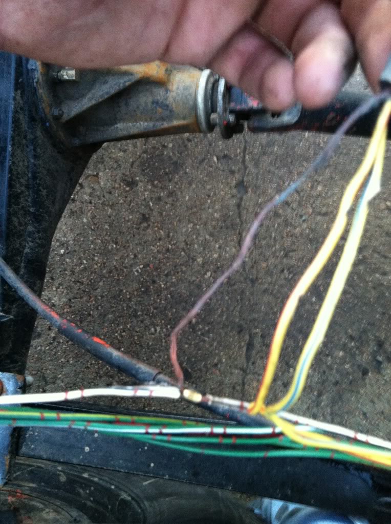

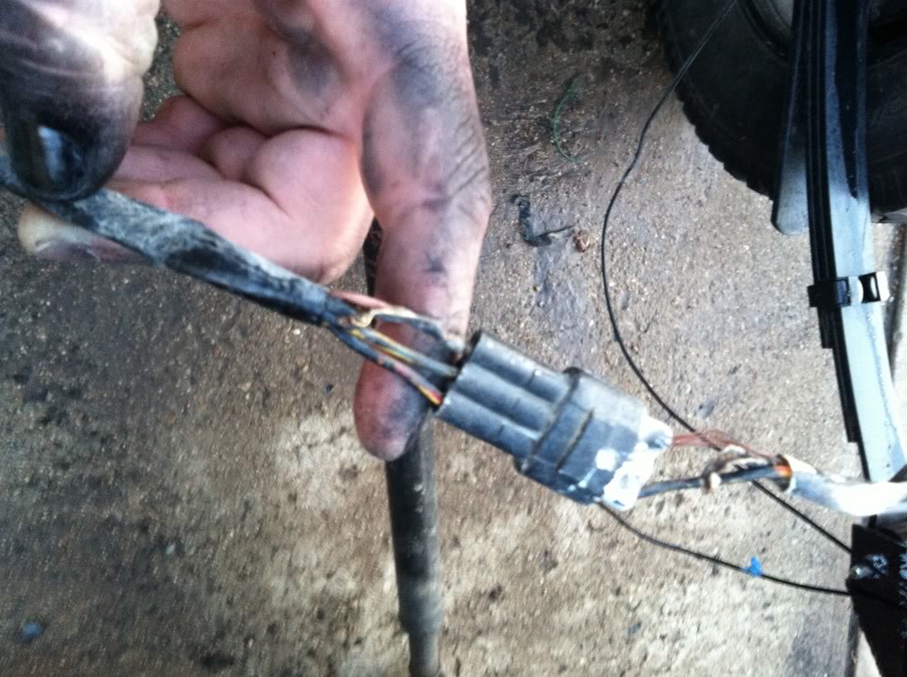

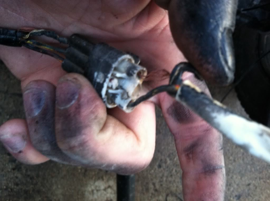

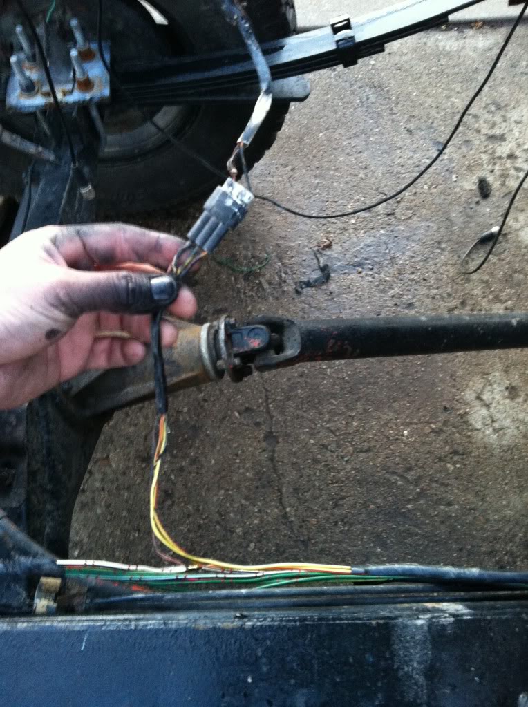

Came to a little problem. My gas tank doesn't appear to have a lift pump, but it has 3 lines going into it. A feed line, a return line, and what the heck is the 3rd one? My fuel level sender also has some issues. One wire is spliced into the tail light harness. Perhaps it's a ground? There's 3 wires to the pig tail but only 2 come out of it. I'd like to know what the 3rd wire is as well. I'd also like to know why this wire melted!
