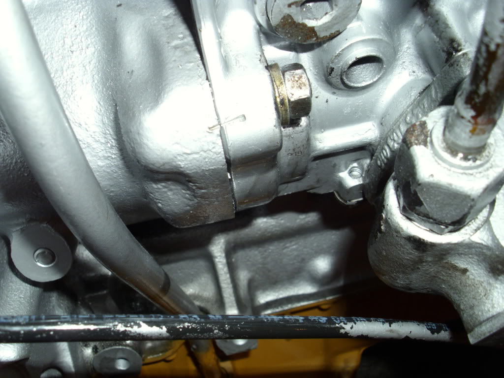

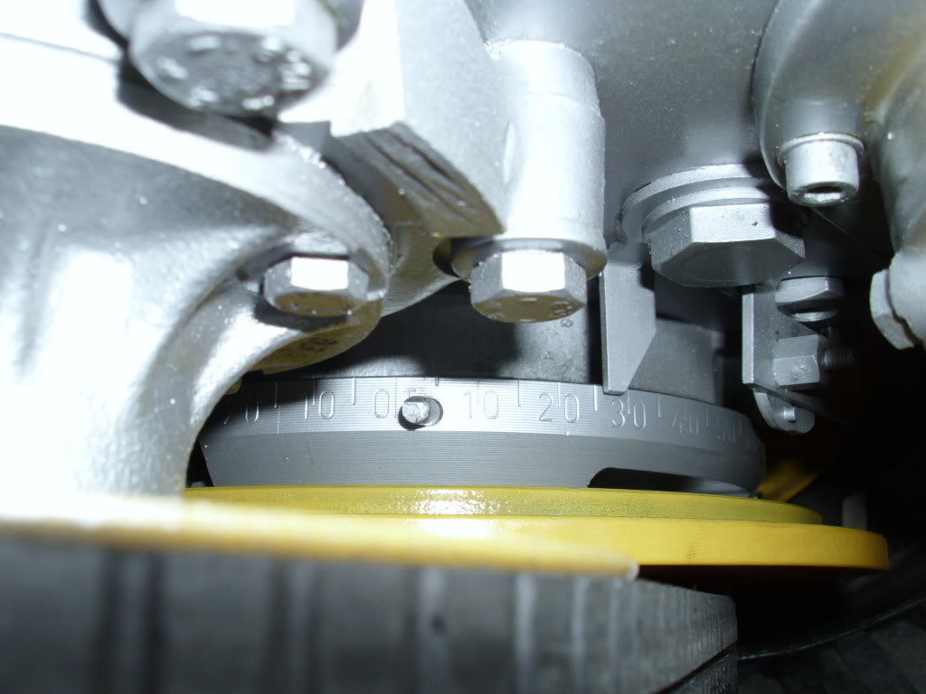

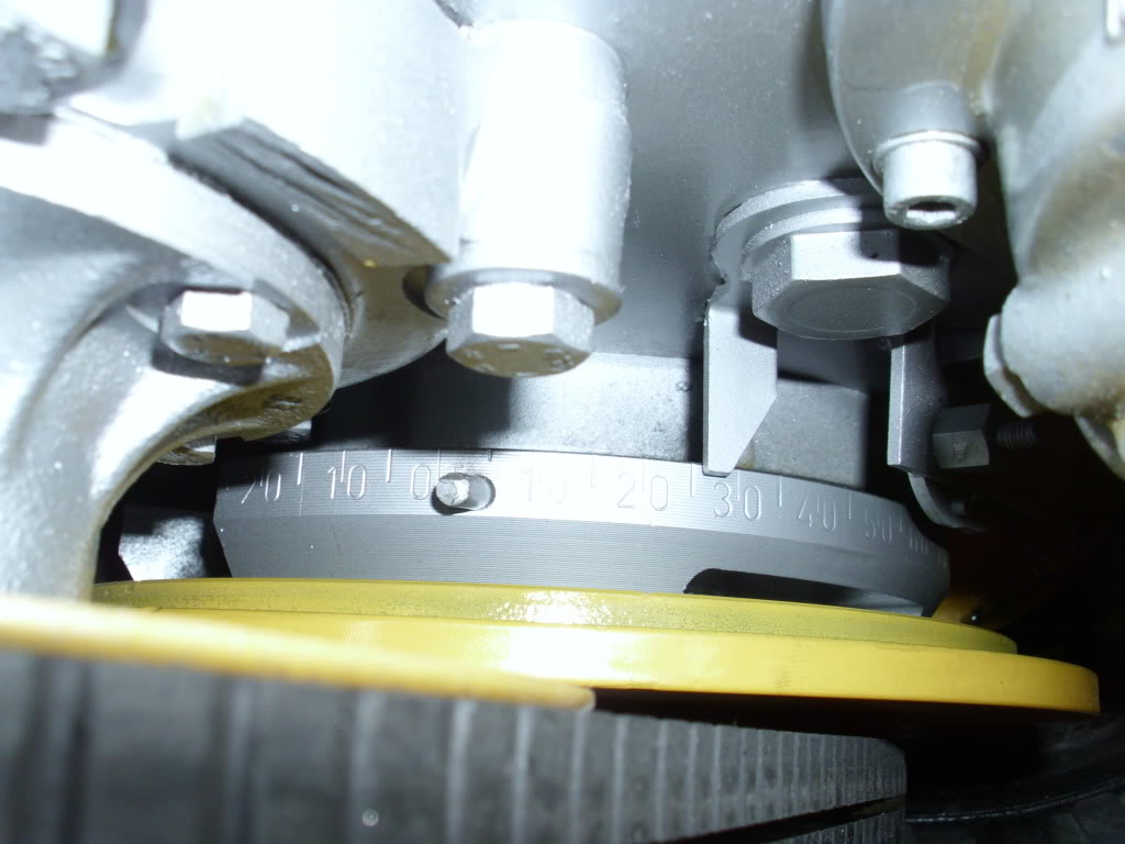

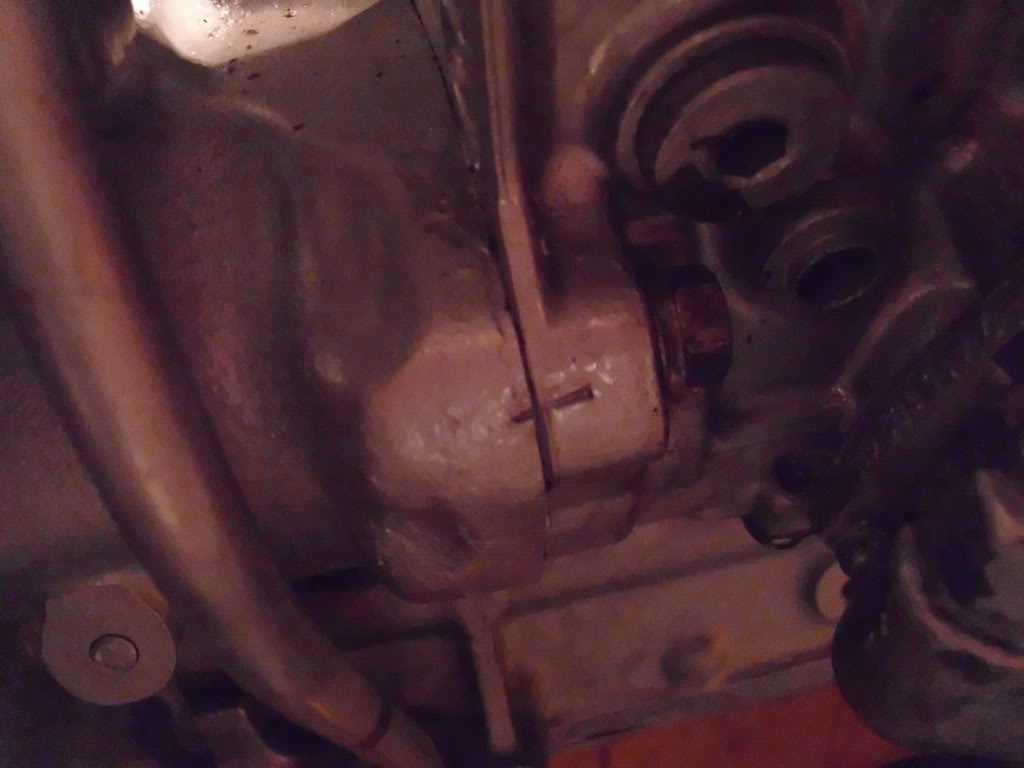

Okay, urgent question here. I'd like to get this verified by tomorrow evening so I can get this sucker fired up!! I tried setting the IP timing to 26 BTDC. Does this look like 26 degrees and does this look like the correct set up for timing? I can still adjust it now. I haven't put the new IP gasket on yet as I want to only put it on once, and I can't put the oil filter housing back on till the IP is back on for good.
If you move your head around your screen, you can get rid of the glare on the 1st picture and see the numbers perfectly.

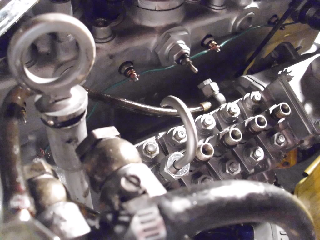

Okay, I pulled the IP back off and applied the new gasket. No leaks so far. The top of this picture is actually the left side of the IP, the top of the IP is the right side. Confusing I know, but the best I could without help. My IP timing scribe mark is pointing at the top left screw in the IP. Hopefully I don't need to be 3 teeth off. The drip timer said it was in time.
Waiting on the oil thermostat, so I'll have to rip the filter housing back off once again, but I wanted to get the engine running and do the comp test and get the tranny on this weekend. Doing the rest tomorrow. Here's the vid of it running. Let me know what you think. It kind of stuttered about mid throttle at first, but felt fine once it warmed up. I just don't want to have to mess with timing anymore. Maybe it's the ALDA that's making it respond so much differently than a month ago. IT ROLLS COAL NOW!! WOOO!!!!
