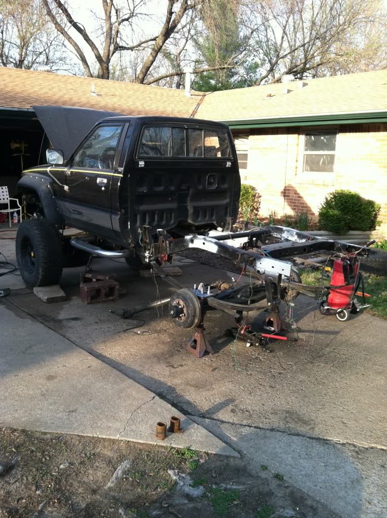

Back from spring break and hittin this sucker hard so I can hopefully have a running truck by April 14th!!! I can figure out the power steering and A/C later. I might just use the stock merc alternator for now, and now I'm thinking I'm pry gonna use a GM alt instead of the yota one.
I didn't really throw a lot of updates up because stuff wasn't progressing very fast, but I took the bed off before break and today I filled in a bunch of unnecessary holes with the welder and ground them down, then sand blasted all rusty spots, finished welding my chevy spring hangers (SOOOO much better with the bed and gas tank off!), removed my ZUK mod hangers and old bump stop remnants and started my rear shock tower. Also sand blasted some of the engine bay, removed the LSPV from the brakes but left that extra line there in case I want it back. Self-etch primered everything. Now to give this stuff it's due, I was sand blasting my spring perches so I could finish welding them, and the rustoleum came right off but I could barely get that primer off. GOOD STUFF!! Also finished welding my shock towers. Helluva lot easier with no engine in there
The to do list this week assuming all my parts get here and the machine shop has my head done finally is:

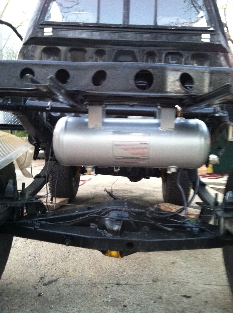

One more fun thing that came today was my On Board Air kit. Looks friggin sweet. I removed my spare tire carrier and put some mounts for the air tank there. Should fit real snug, and I can put another 2 gal tank behind it if I ever want to. Could actually probably go 5 gal.

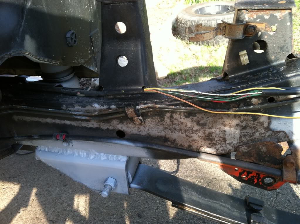

Frame by gas tank. Not bad, caught it just in time. Moving gas tank over 2" approx. to avoid this from rusting thru

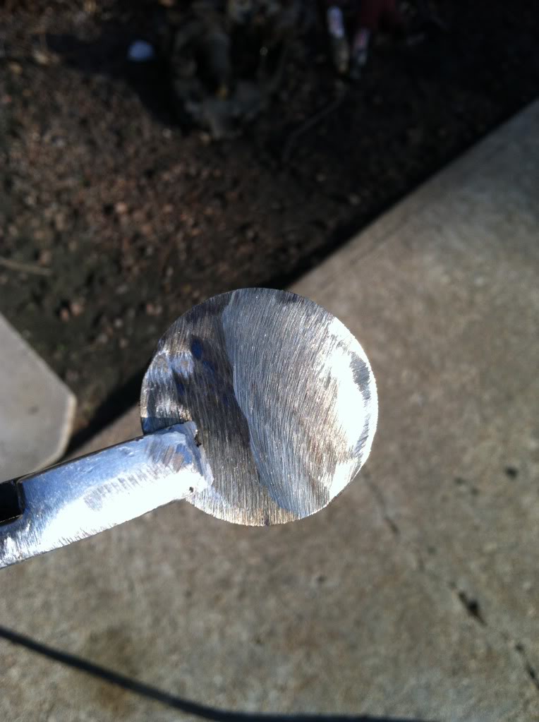

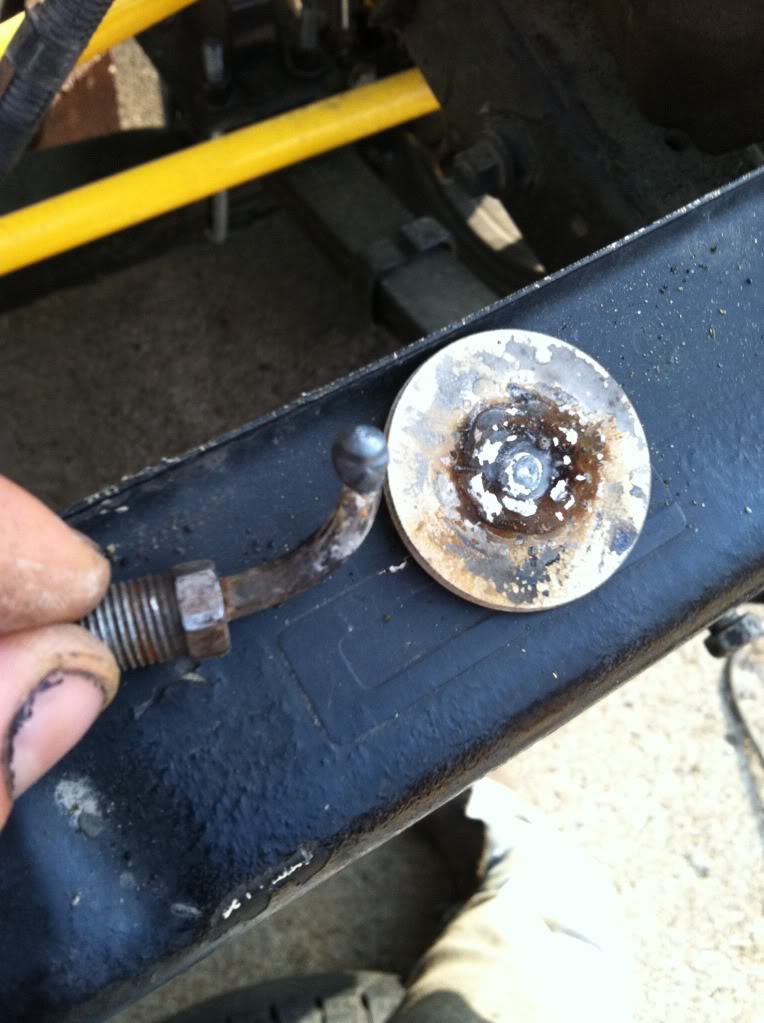

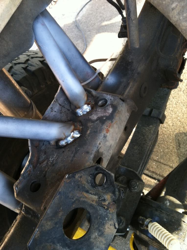

Used a spare brake line to block the LSPV line. Just hit it with about 8 tack welds. Also made an EGR blocker for the exh manifold. Welded a washer then ground down.

LSPV FINALLY GONE!

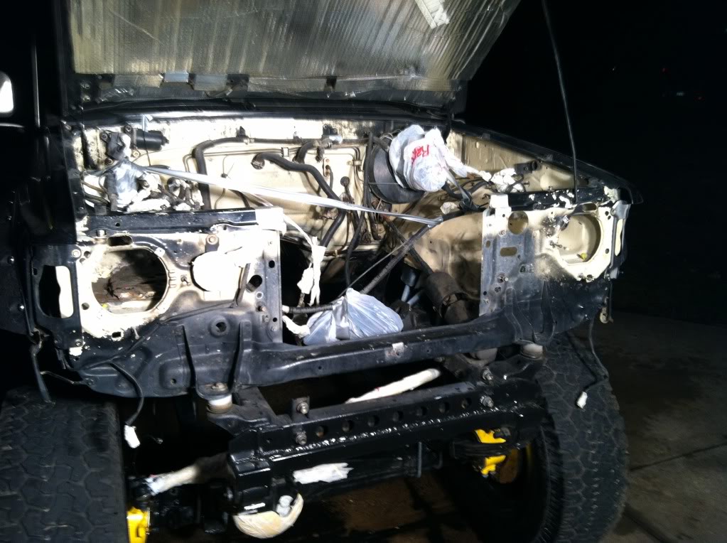

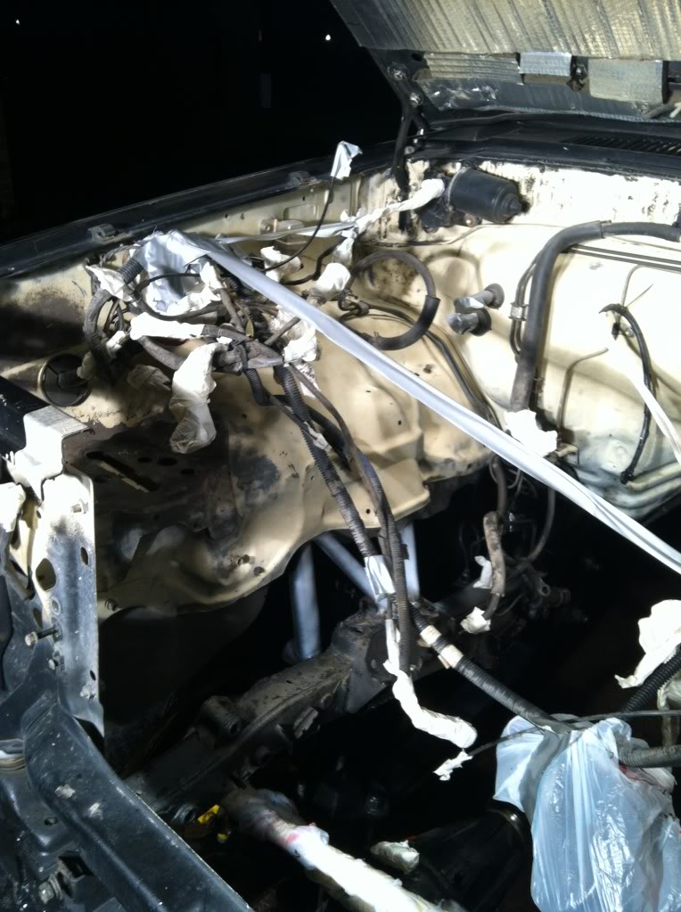

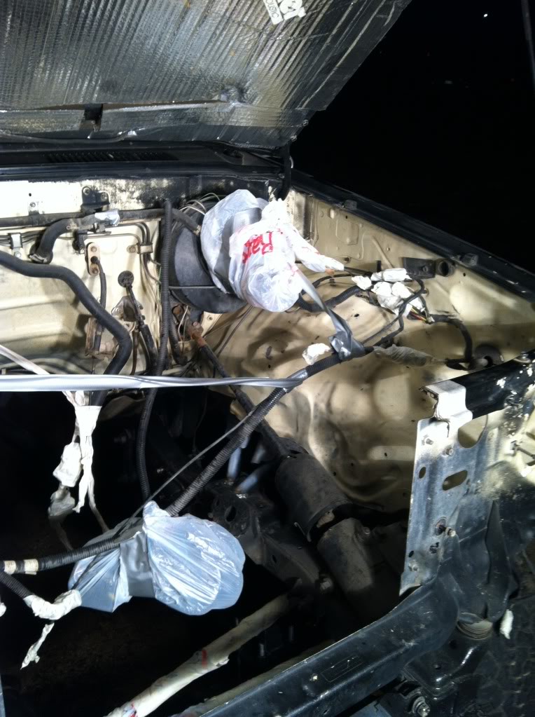

Got the engine bay sand blasted today. Worked like a charm. Then got everything taped up and pulled off the fenders as much as possible. Don't have enough money for new toyota zip tie things. Plan to get the POR-15 shot on tomorrow. The head is done at the shop as of today, just need to install prechambers and valve stem seals and it should get put on the block on Friday. Motor should go in the truck sometime shortly after Saturday if all goes right

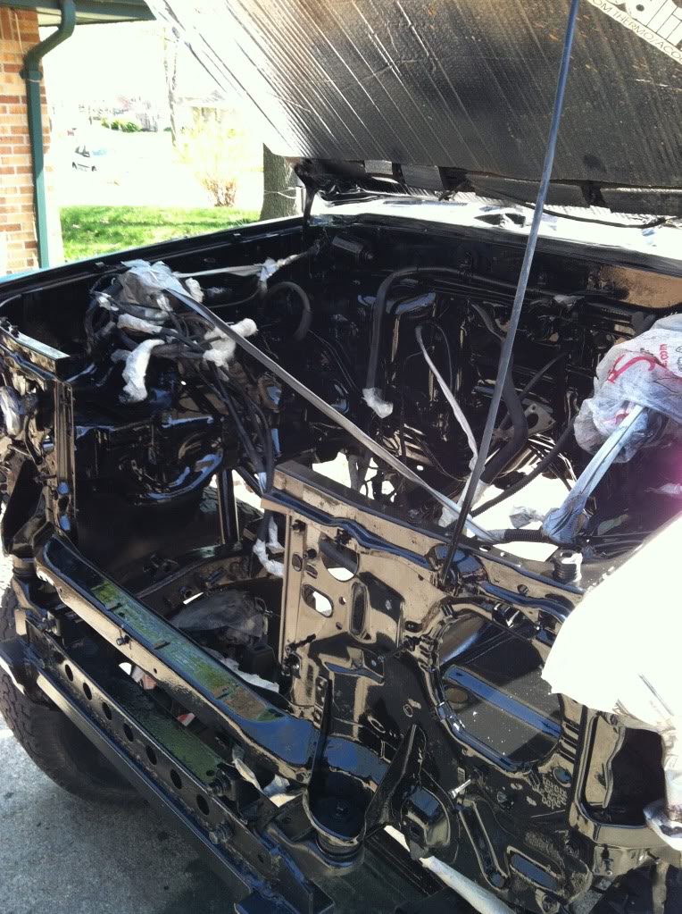

On a side note, I got the POR-15 shot today. Looks great! RiddaRunner, did you by chance paint stuff that's out in the direct sunlight most of the time? They specifically state that you have to top coat any POR-15 that'll be left in the sun light. And I'm not worried about it either way, because I didn't sand blast down to metal, just enough to remove all the dirt and grime and scuff up the paint. I did a '69 camaro engine bay back in high school and that took me 2 or 3 days to hand scuff. Not doin that again lol
Also gotta give a shout out to Peach Parts for AMAZING service. Roy is probably sick of listening to me but has answered every question I've had, and my order from Tuesday was at my door before 11am this morning, so my head got finished at the shop today! Now I just have to find a darned Merc-Dealer that will answer their phone to send me some stealer-only parts.

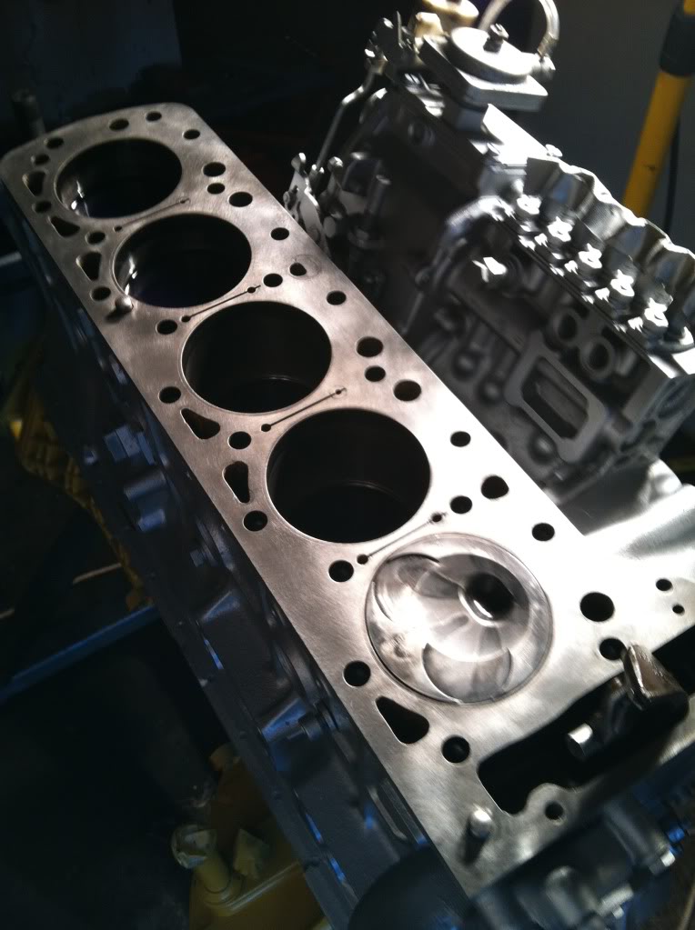

Here's everything I did this weekend:
Bead blasted the prechambers. They went in very easily.

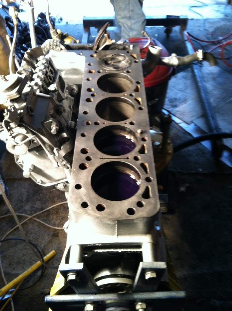

Cleaned block with a plastic rotary tool attachment for removing gasket material. It's oil-soluble which is a major plus. $10 at NAPA.
Blew out the cylinders with compressed air, vacuumed everything from the block that I could, then filled the cylinders with a little Marvel.

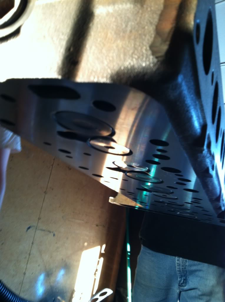

Head surfaced .010"

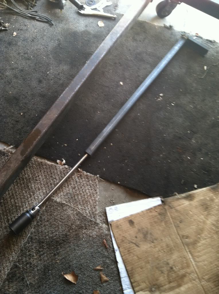

Used a 1' breaker bar with a 3' cheater bar to get the block heater out! The new one didn't go in much easier despite the fact I cleaned the threads and applied anti-sieze.

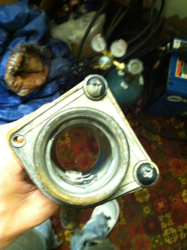

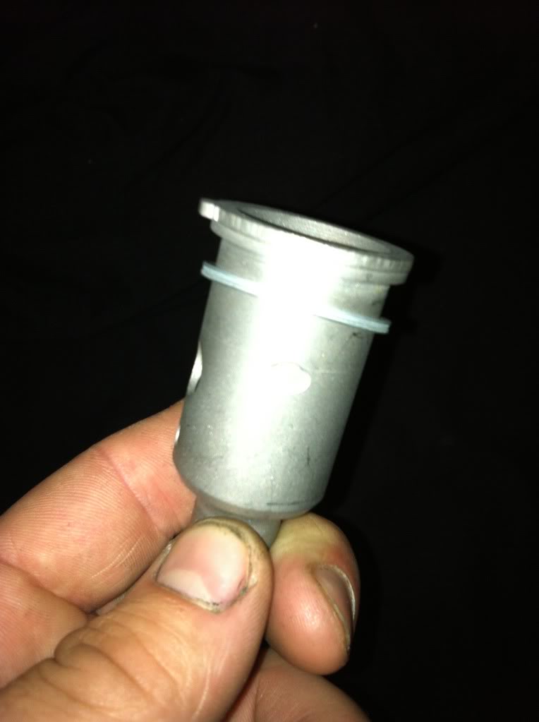

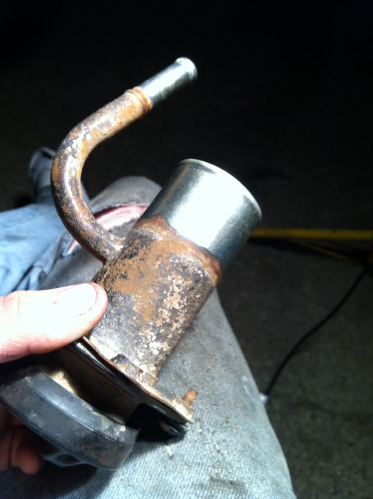

Removed the gas nozzle spring. Hit it out with a pry bar and hammer. Ripped a hole out where one of the spot welds was, so I just welded it back shut. It's amazing how clean the tube is where it was in the rubber filler neck!!
The reason I believe that wire melted was because when I first got the truck, didn't know much about electricity, and replaced the brake light fuse with a much higher amperage fuse. The lights shorted out, and they shared the ground with the fuel level sender, so that ground wire got extremely hot before the fuse blew again. I put the correct fuse back in, and soldered a new ground wire on that attaches directly to the frame to avoid this happening again.

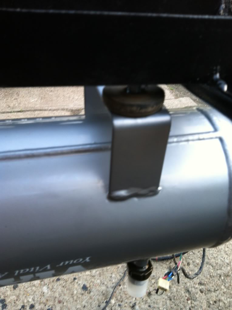

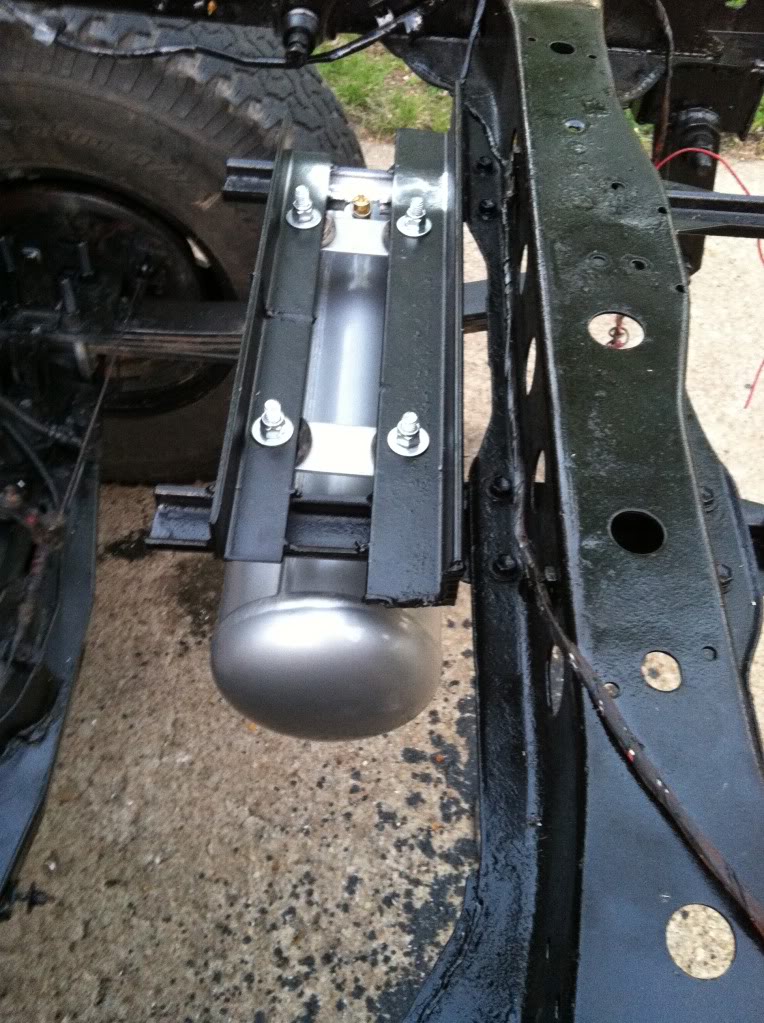

Used my stock body mount bushings for my OBA tank. The bolts and rubber isolators that came with the VIAIR kit were pathetic.
Used 3/8" bolts and lock nuts

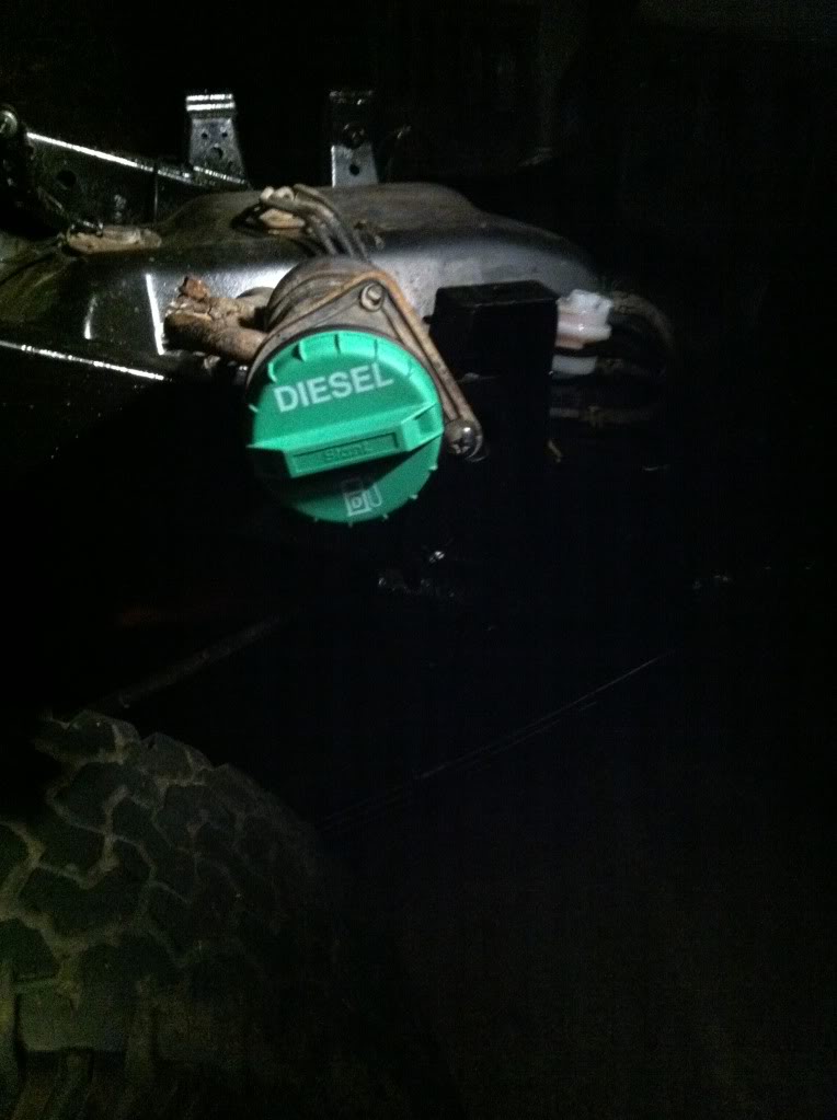

Sweet looking engine work Joe... keep up the good work... liking that green fuel cap... in case you pull up to a we serve pump right?...
or was that in case you forget?
Old Apr 1, 2012 | 11:15 PM
  #199
pyrojoe22's Avatar
Joined: Jan 2010
Posts: 610
From: Nebraska
haha for my mom actually

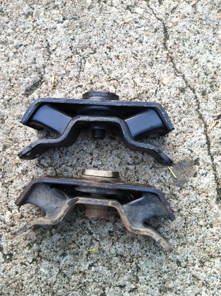

First I ordered a 1986 22R 4x4 Manual Tranny mount from Rock Auto and got this dinky little thing (I'll get a picture later and edit this post). It was wrong. Then I ordered a 1986 Toyota Pickup Diesel 4x4 Manual Tranny mount and here's what I got
Bolted it up and looks identical. Now I got a DIESEL tranny mount!
Just an FYI for you guys ordering new tranny mounts. Look at the pics on Rock Auto before you buy. Their pics ARE accurate, I just didn't look.
