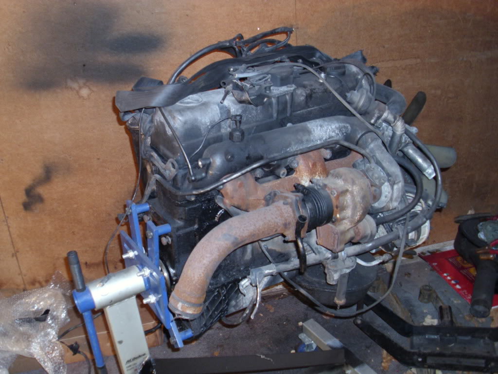

Here is my OM617 purchased for $150 at half price on Labor Day weekend at Pick-N-Pull

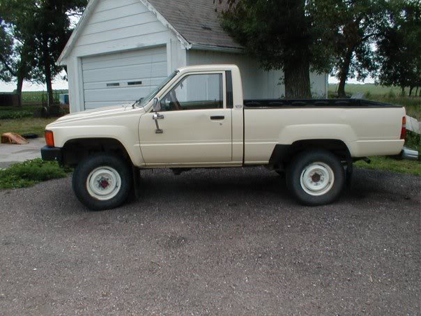

Here is the truck when I bought it

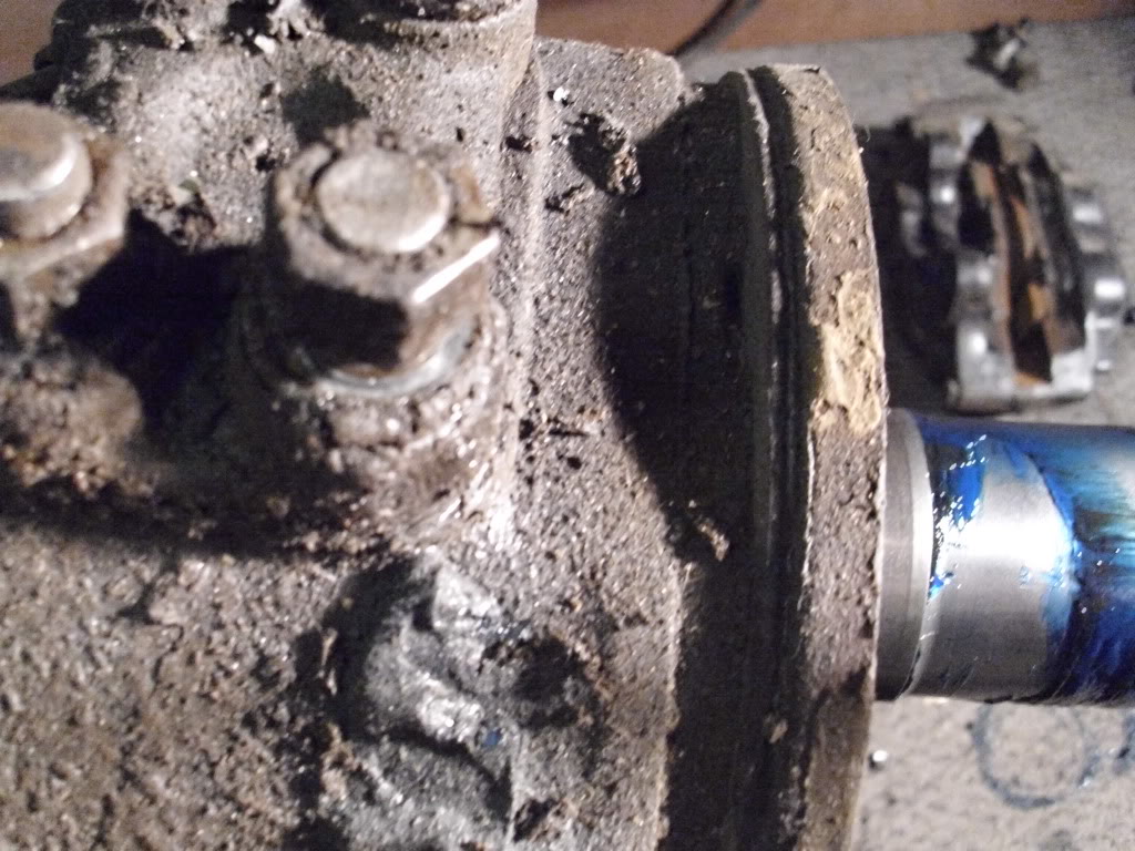

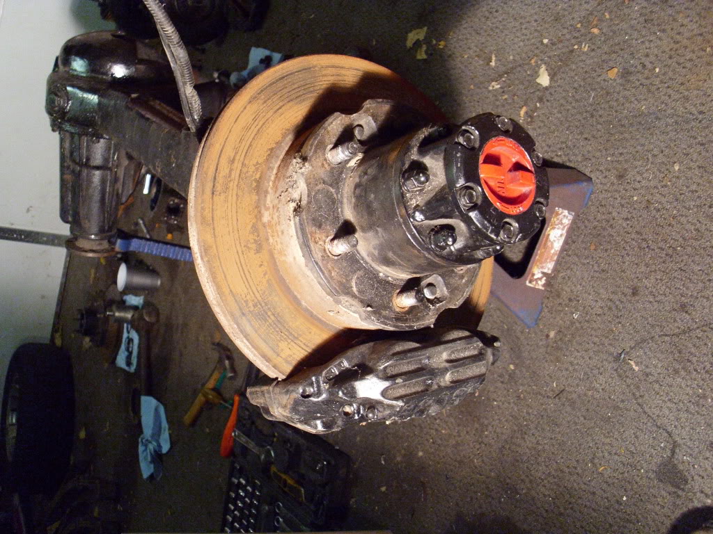

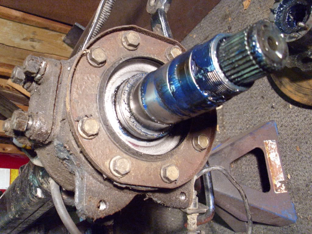

I don't have a picture of the axle complete when I bought it, but here are some step by step pictures of me taking the axle apart

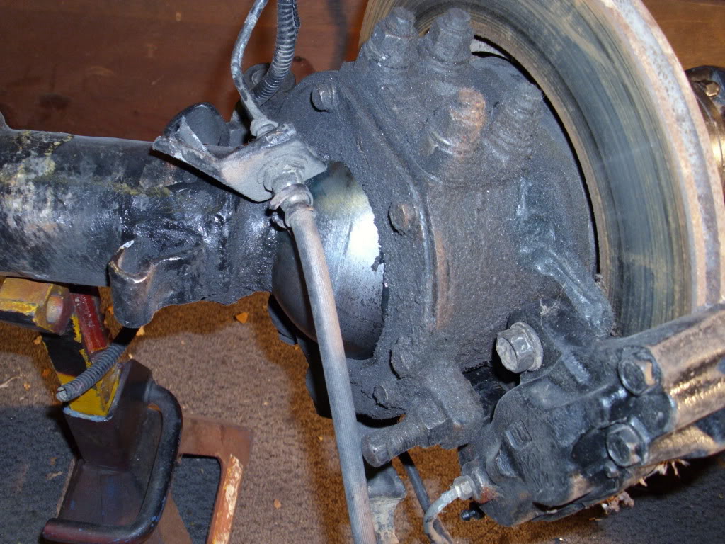

Image of the order of the 3 items on the back side of the knuckle

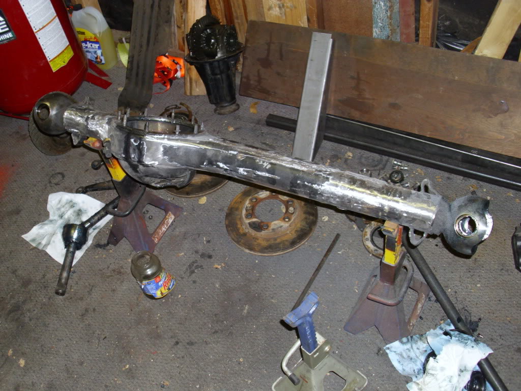

Then I started to rip apart the axle, and sand down EVERY part I could find, using an air powered die grinder from Harbor Freight ($6) and a wire wheel on a corded drill

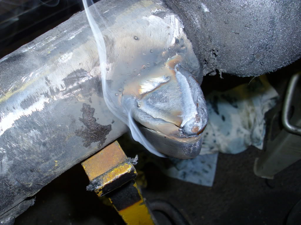

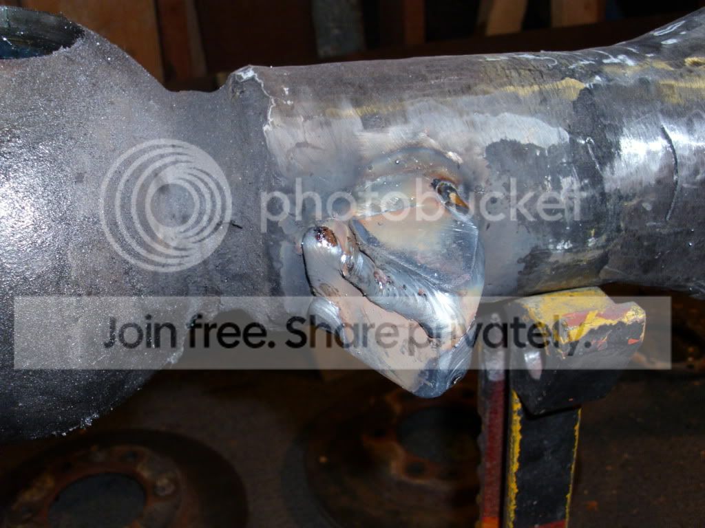

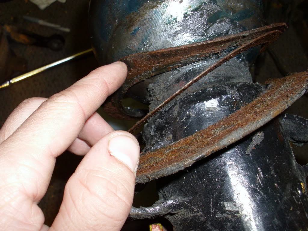

The steering tabs were completely caved in (except 1) from the previous owner's full hydro steering. I'm cutting small pieces of 1/4" steel to make new steering stops out of. On top, I'm welding on the tabs that came with the Creeper gusset kit from Trail-Gear.
The only good steering stop
My own fabbed tab

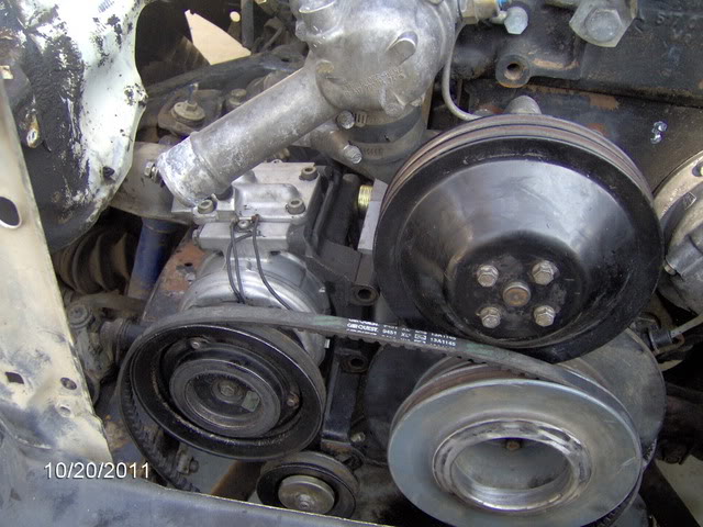

When you swap the a/c and alt locations, I'm guessing a bit of fab work to make new brackets?
Old Nov 21, 2011 | 06:28 AM
dmarsh4x4's Avatar
Joined: Jul 2011
Posts: 91
From: West Texas

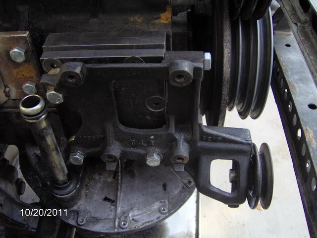

pyrojoe, I used my stock Toyota A/C compressor where the Mercedes alternator was.
I made an adapter plate and used the stock Toyota compressor mount
I ditched the stock Mercedes P/S pump and mounting bracket and put my alt. there. I will get some pict's today and post on my build thread.
