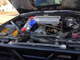

Got my Subaru WRX intercooler on this weekend. It. Is. AMAZING!! Once I get the leaks found and fixed, it'll be even better. But for right now, my egt's haven't gotten over 1000 where they used to easily go past 1200 degrees F. When I stop driving, my egt's used to be about 450; now they're never over 400. Turbo lag is noticeable, but the power rush that comes with the spool up is amazing. The water temp is also running cooler down. I hate welding aluminum, and I'm not sure if my welds are air tight. I could really use an older NA intake manifold to make things fit better. Haven't burned a tank of fuel yet, but economy looks to be much improved.

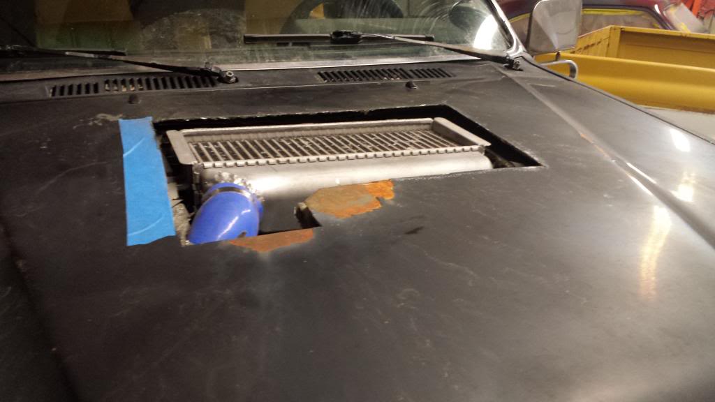

My intercooler set up. (Will edit this post with better pics later). I used a simple concept when doing the silicon boots: Black = neutral intake air. Red = hot boosted air. Blue = cool aftercooler air.
Cut out the main damage from this summer's vandalism.

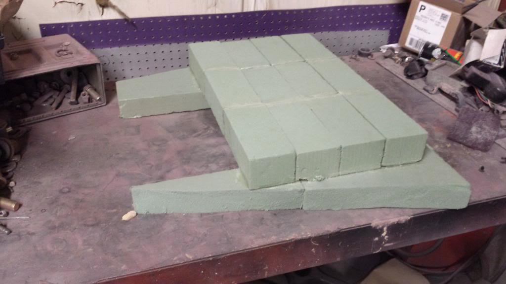

Taping up for straight cuts

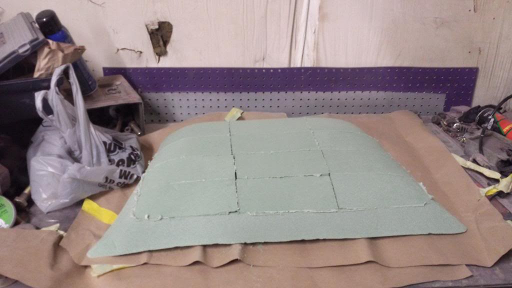

Foam glued up with loctite adhesive
Foam shaped and sanded smooth

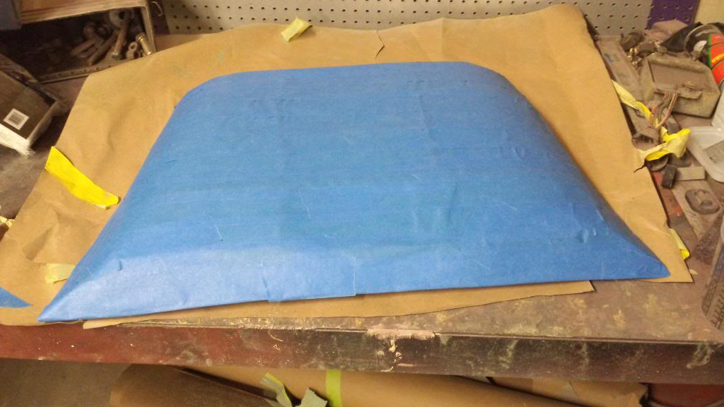

Foam taped up with painters tape

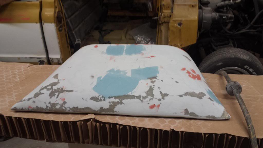

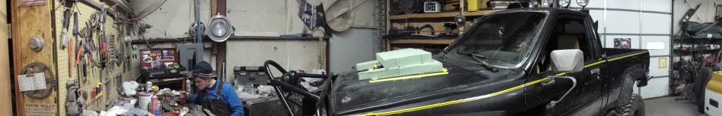

Hood body work done
Scoop body filled

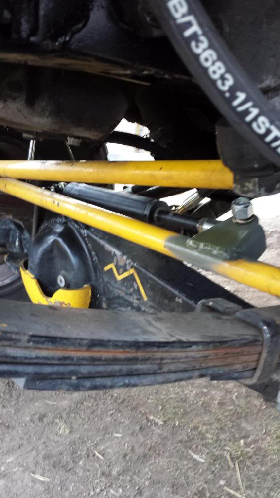

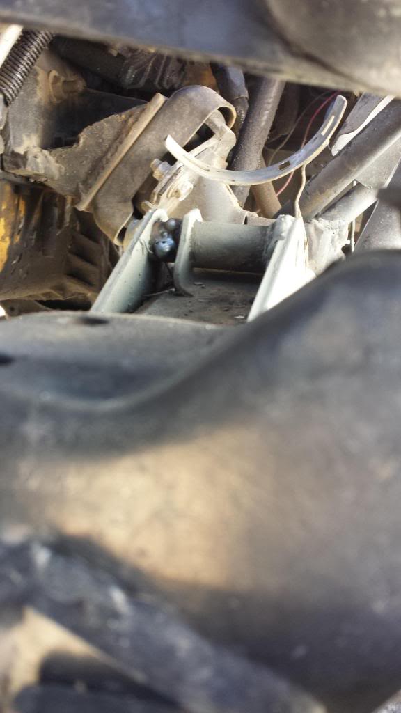

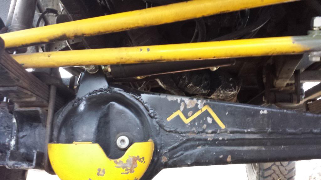

Steering brace welded on. I didn't move the box AT ALL. I don't know how I would even move it. The drag link sits with about 1/8" to 1/4" clearance on all sides at maximum droop/stuff.

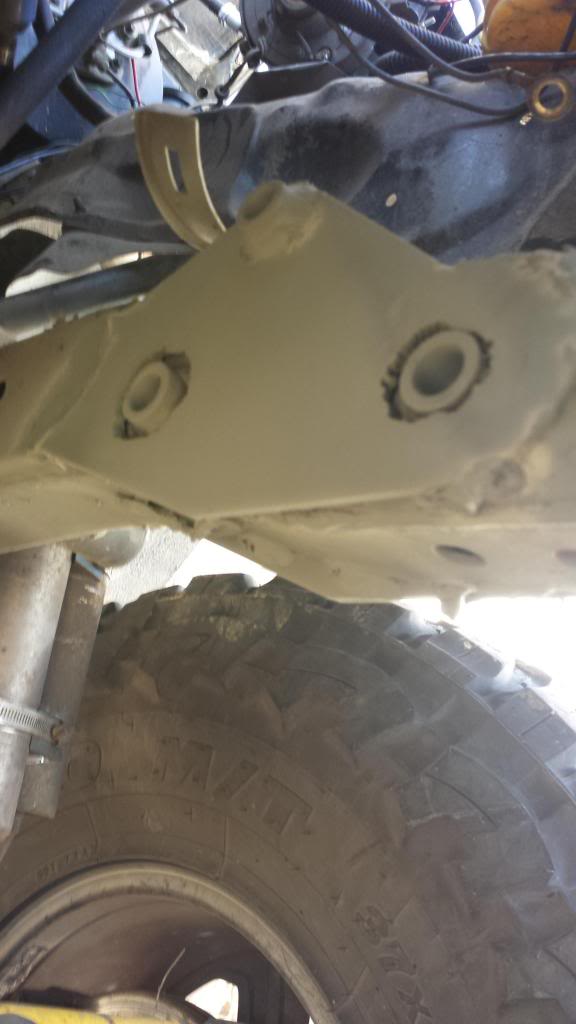

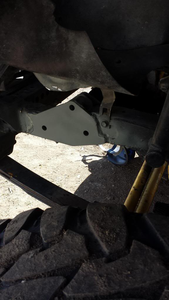

Cut out the inside brace and welded a piece of the supplied DOM to the brace and to the top stock IFS mount so the box is clamping the DOM and not the frame.

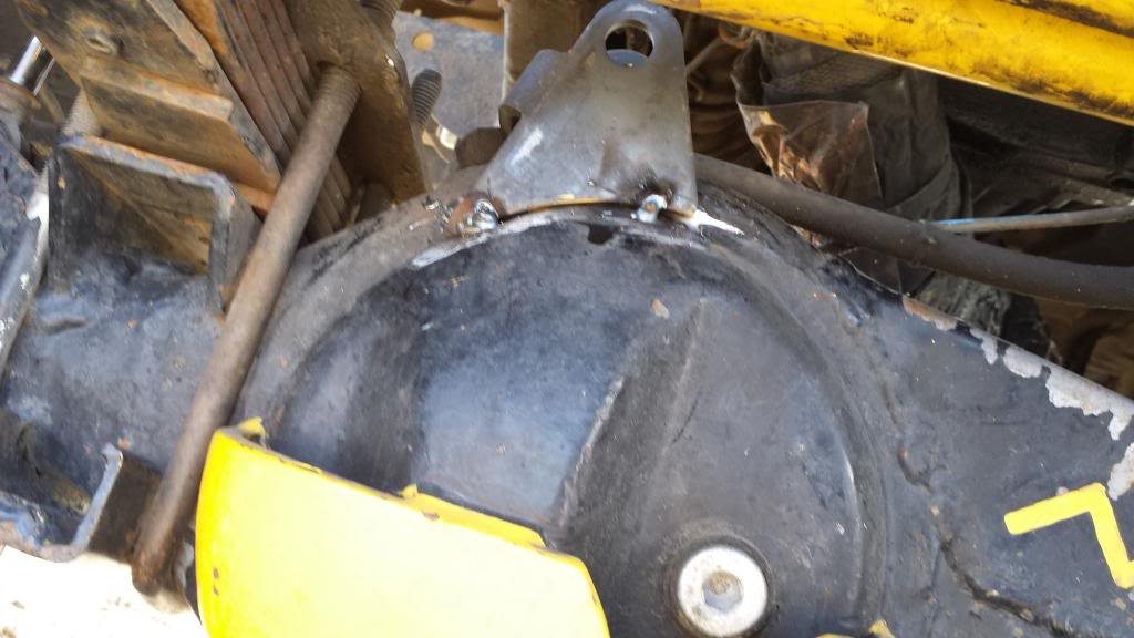

Got to fight 30 mph winds while trying to weld on this stuff on. Got to love being to poor to have a shop. This bracket didn't fit worth a crap.

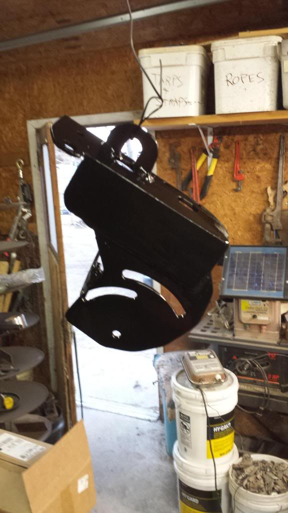

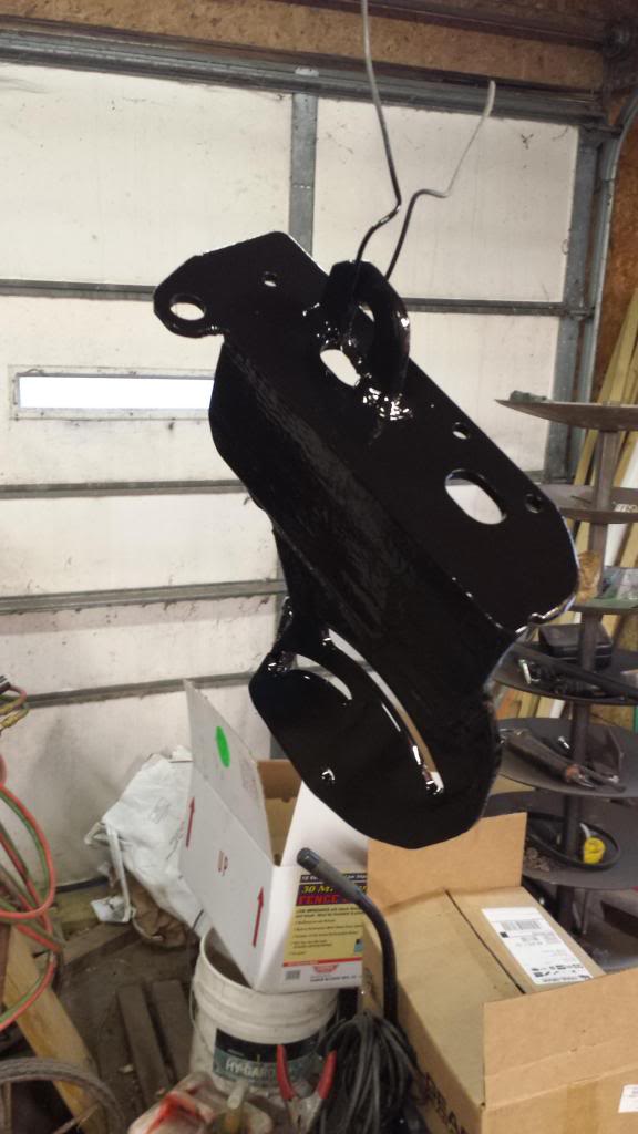

My custom, partially CNC plasma cut bracket. My plan will be to model this up on CAD and have the entire thing laser cut and cnc bent. Then you can just buy them. It is for the Trail Gear power steering pump.

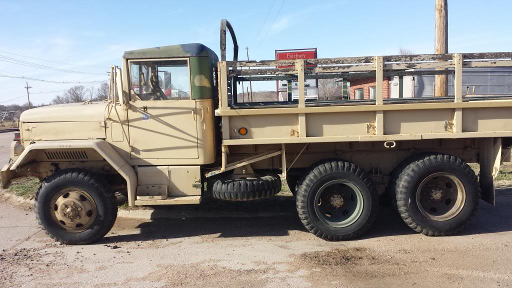

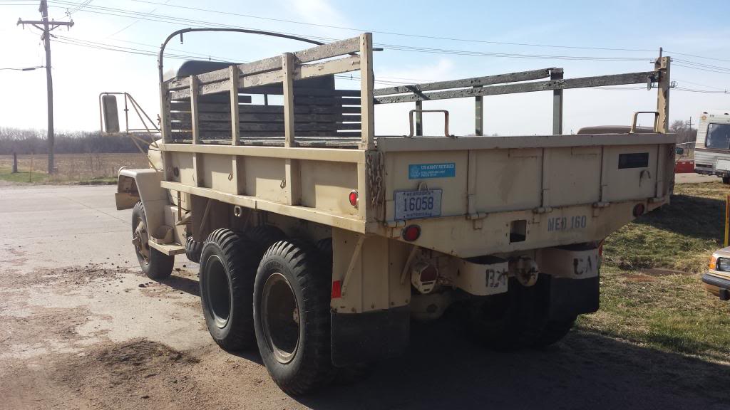

Well an opportunity arose this weekend; either God gave me a sign, or my guardian angle really wanted to ride in a deuce and a half. I've driven past this place with a whole bunch of army trucks for the past 5 years on the way home and finally stopped last Thursday. I decided to save my Easter Jeep Safari trip money and invest in something else. I am now the proud owner of a 1969 Kaiser-Jeep M35A2 multi-fuel 6x6. I also finished the Toyota steering column/power steering swap, and words can't fathom how awesome it is! Unfortunately, after a weekend in the 80's, it dropped into the 20's and began to blizzard on Sunday before I could really test drive it.
