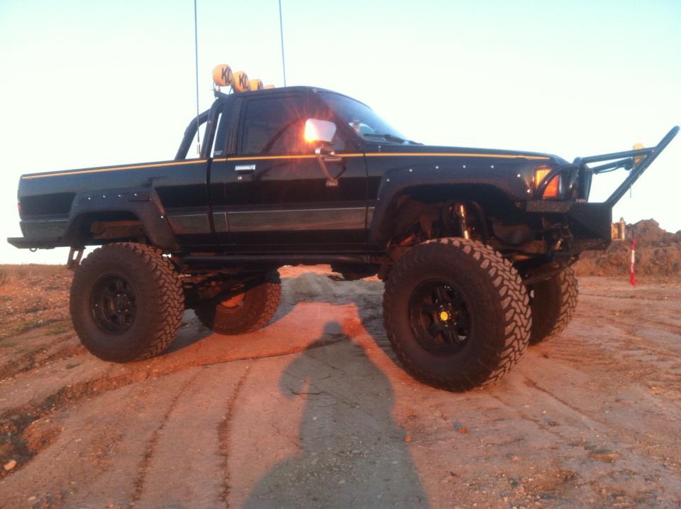

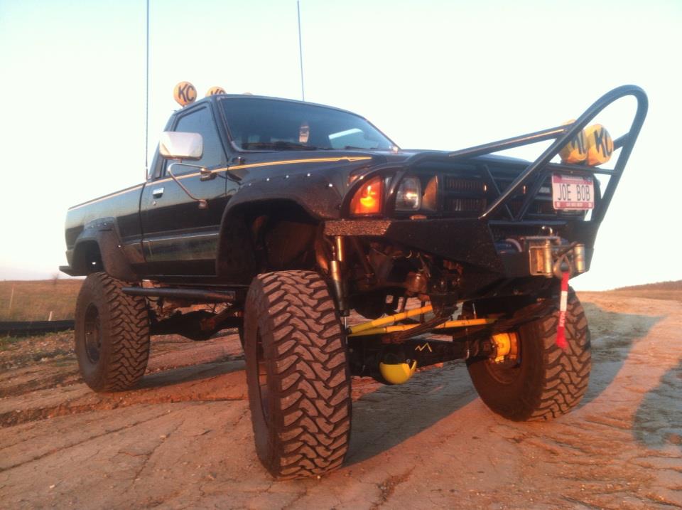

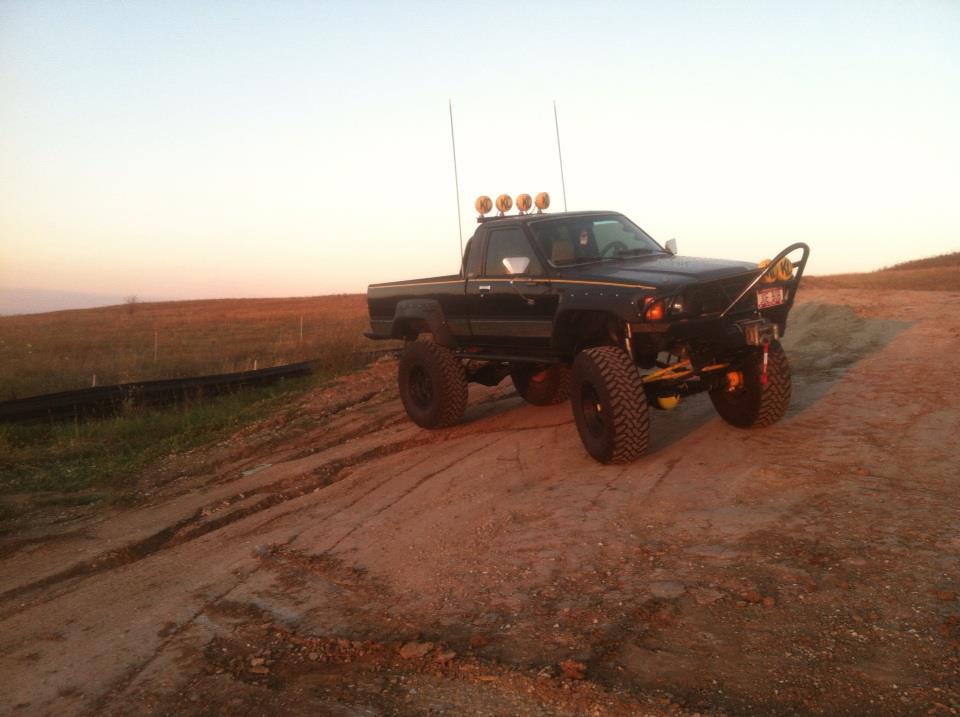

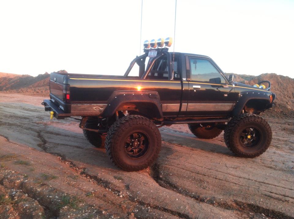

Waiting for a good sunset to get my finished project pics taken. Met up with PowerstrokeJoe last weekend. It's AMAZING how different 2 of the same trucks with same motors can be. His is quiet, no black smoke, good mpg, really fast. Mine = slow, loud, medium mpg (21.5mpg in 4th gear going 55-60mph from KC to Manhattan), and rollin coal. I'll be re-timing the engine when time and weather permit. Sorry Joe but I gotta share this.... 2 guys named Joe, with yota's, with OM617's... and then this....
Creepily ironic... I should say I'm missing a shackle because my boss lost it before he gave me them.
To update on the truck's overall performance:
The rear diff has siphoned the gear lube out through the ARB air line 3 times now. ARB has new o-rings in the mail for me to try to fix it. I'll be ripping the 3rd member out next week and replacing the o-rings as well as inspecting the breather port an inspecting the R&P for damage.
I have yet to install my Line-Lock brake. The idea hit me tonight to leave the stock cable e-brake in and use it as a idle control since it clicks and holds position, with 17 total clicks, that would give me a lot of RPM range. Then I can start it in the winter and high idle it till it's warmed up, high idle for winching, etc.
Got all my lights aimed. Sure makes a big difference having 8 correctly positioned lights.
I'm avoiding the use of 5th gear till I have a solid replacement tranny ready. 5th is the weak gear and it's what destroyed my G54. I tooth chipped off and caused a domino failure effect. I'm sure after re-timing and using 5th gear I'll hit my 25mpg goal.
When I get time to take pics of everything, I'll post a big update with them all.
