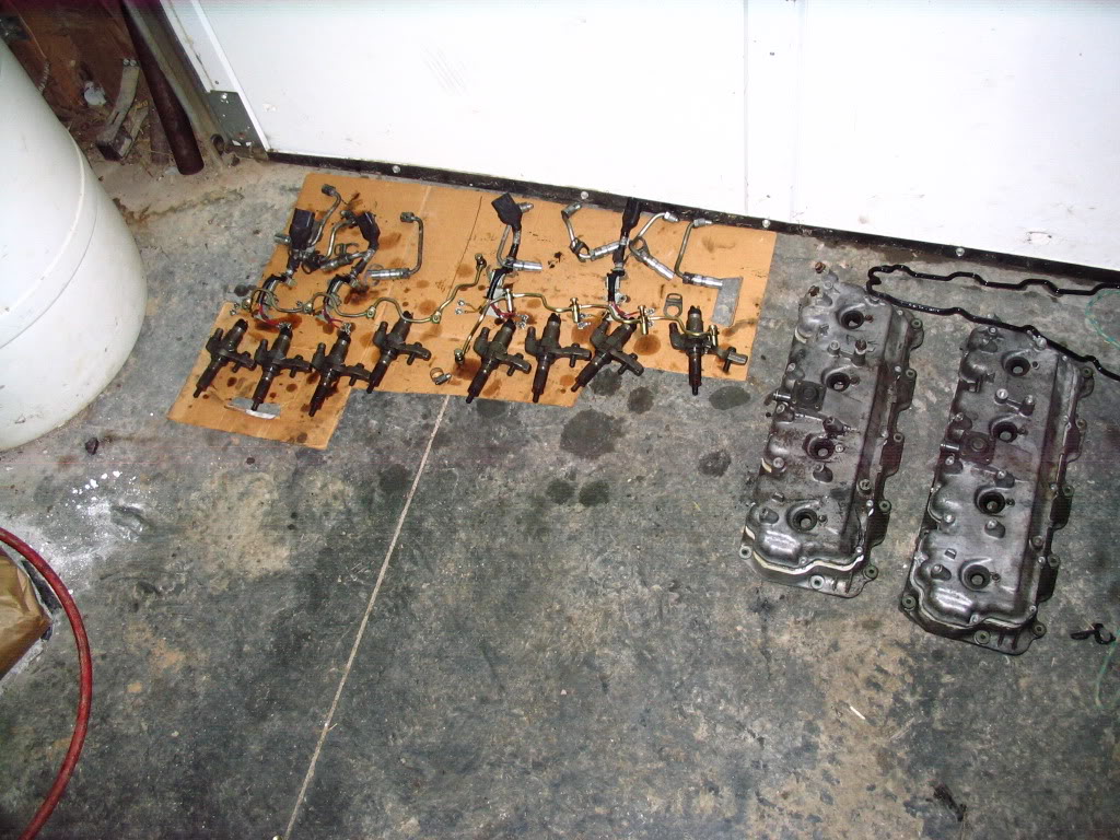

Derailment alert. Joe I thought you might like this.
That's what in injector and CP3 job on an Lb7 takes.

YOWZA! Thank the Lord for external injectors on newer D-max's!

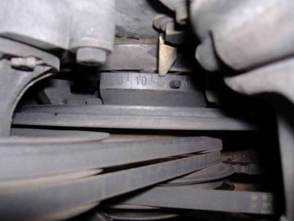

Okay, so before I remove the head, I wanted to get a timing chain stretch reading, and what I got by lining up the 2 marks (one on cam tower and one on thrust washer) was the arrow pointing to the pin that comes up and out of the Degrees wheel (the one to the right of the arrow in this picture. I borrowed this picture because I'm at work right now.) I'm wondering what that means about my timing chain

No arrow visible... don't know what the cost factor is but if you're in doubt about the chain why not replace it now before you put the engine in just in case?

I'm not sure on your readings honestly as my new block has a good chain in it. Here is a link on everything you should need to know. http://www.peachparts.com/Wikka/OM617TimingChainStretch

Okay, I'm replacing the timing chain anyways so I'll forget about it. I took the head off today. Reassemblys gonna be a biotch. PowerJoe what are you doing about the water pump and the injectors? Water pump looks to be about $60. Injectors are $60, $66, or $100 (Bosch). I'm going to try to find out about getting them rebuilt and I'll let you know what they say. My buddy just sent his VW injectors to a reputable place in Oregon and they work great.

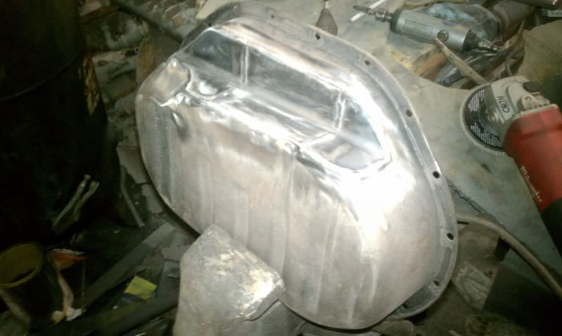

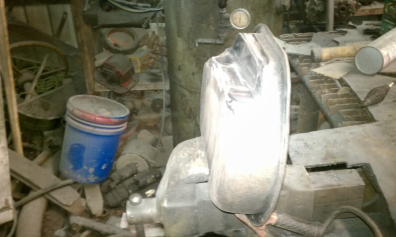

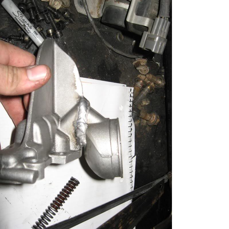

As far as oil pan mod's, I've seen just a simple cut and piece of angle iron welded in, and I've seen such extensive cuts that they've taken the oil pick up and cut and rotated and rewelded it so it would slant down towards the front to suck up oil. I'm going to wait and do the sas and engine swap at the same time so I can know for sure where I can relocate my steering box to if I need to move it forward at all.
here's the angle iron, i'll try to find the rewelded oil pick up later

Hey Pyro I think that's pretty much what the guy I was talking about did except he used a piece of pipe to get a nice curved profile as opposed to the square angle iron one you have. Looks good.

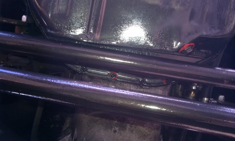

I'm not worried about changing the pan, I'm worried about protecting it. Any idea's on some good protection for an oil pan that sits in front of everything? I'm thinking maybe a bolt on frame cross member/skid plate with a hole for draining oil if needed. And with the welds, make sure you get some good hot burns and have no holes. We just tested our welds in lab at school this week and even something that can hold water can still let oil leak through... I'll post pics up on my build thread later
And as promised here's the other pictures and heres the link to the build if you want to read it
http://www.superturbodiesel.com/std/...d.php?tid=1961

It looks like the guy in the linky had an SAS with a high steer set-up if you're running IFS you may not need to have as aggressive a cut out. good link though
