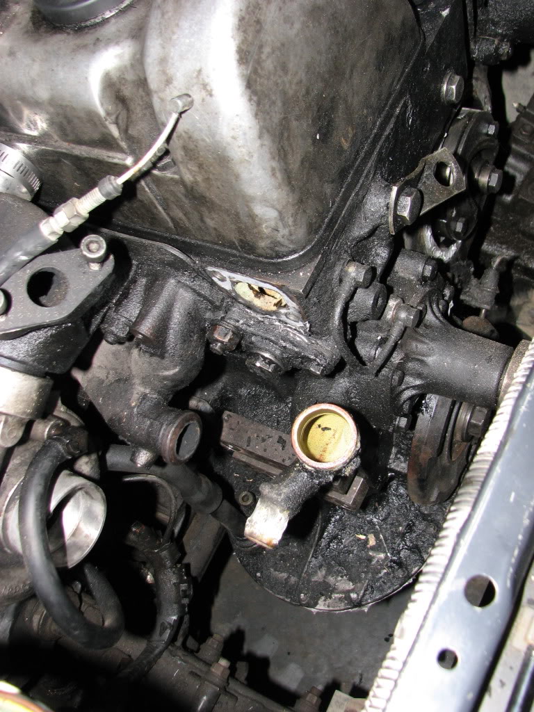

Edit: Joe or Dmarsh, can you tell me how to get the alternator bracket off? I got the 4 17mm nuts off the side. Looks like there may be one more behind the crank pulley? Do I need to take that pulley off to get to it? And is there anything special to do to take that pulley off?

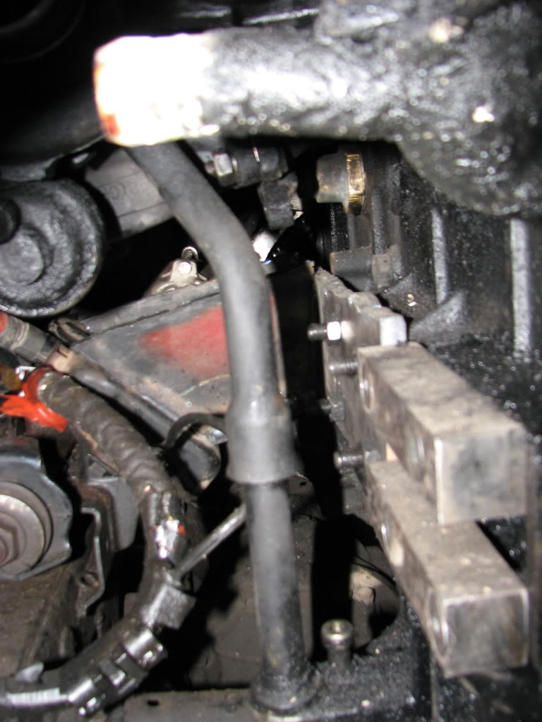

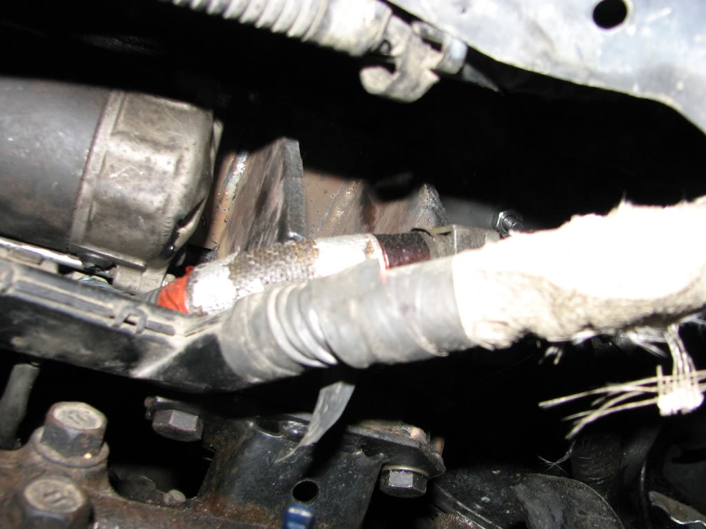

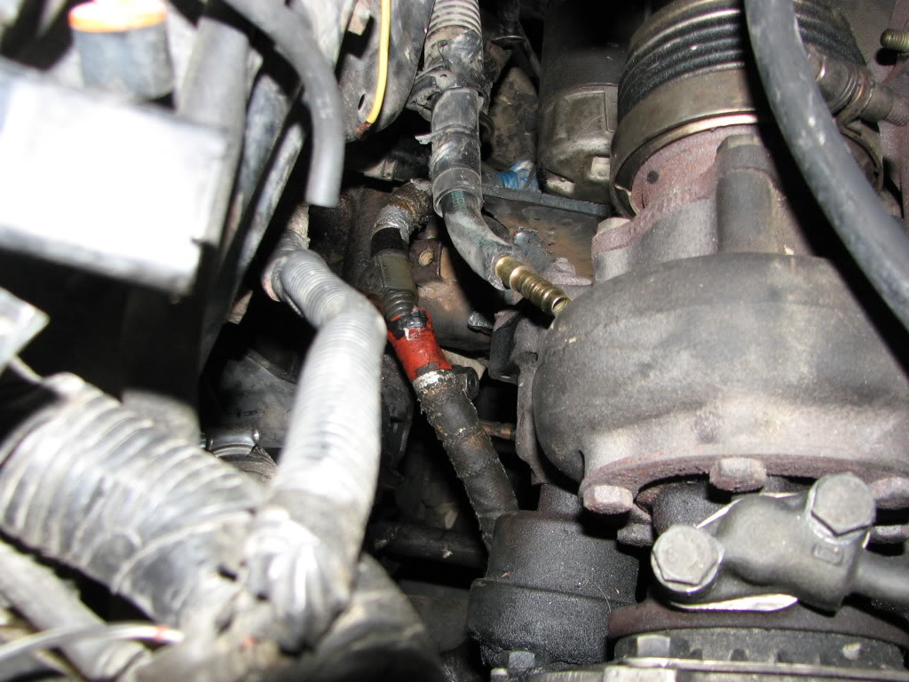

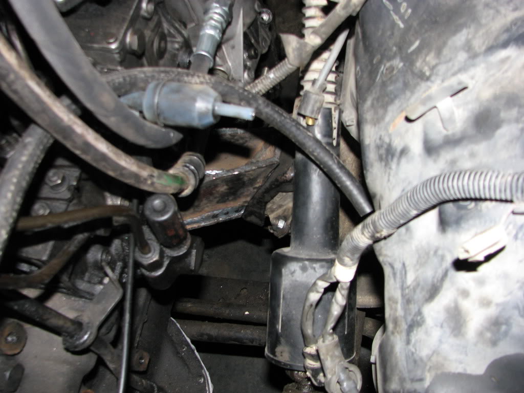

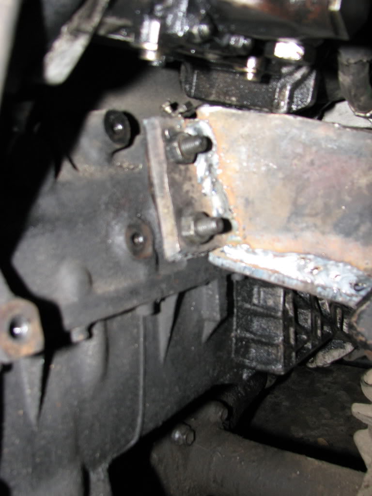

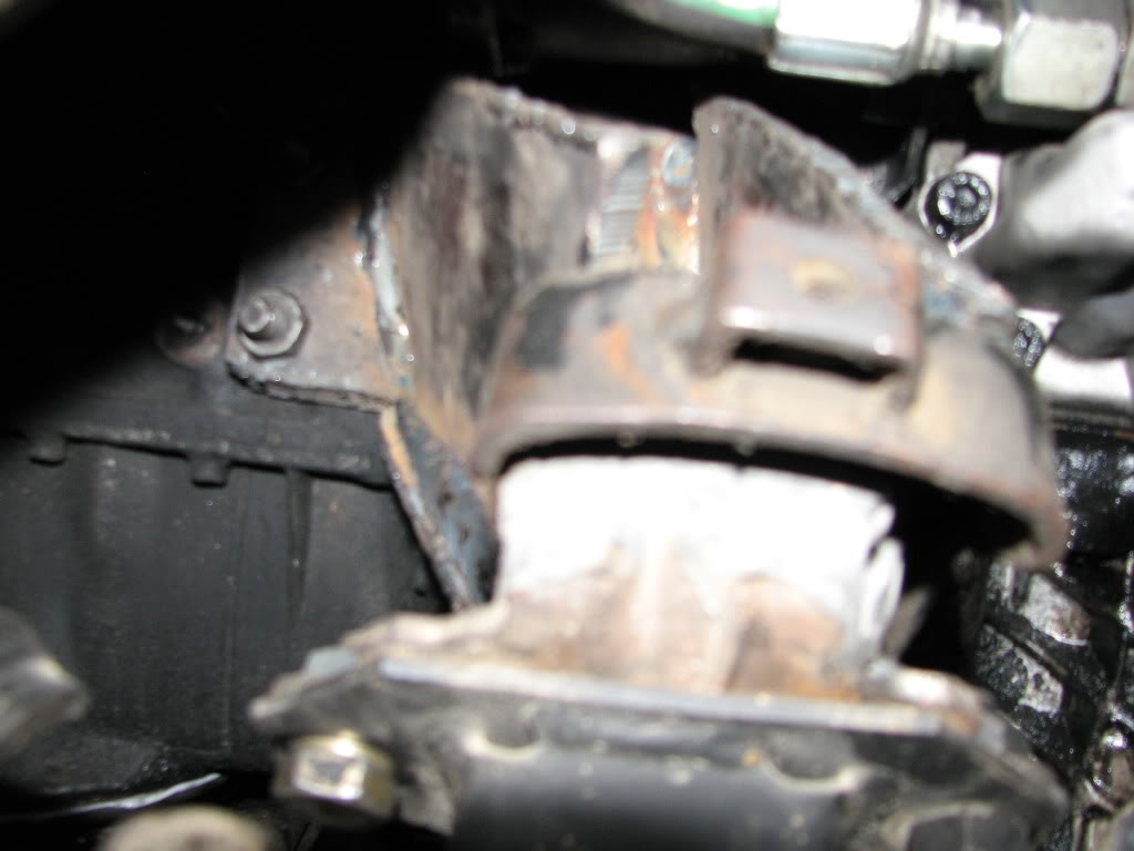

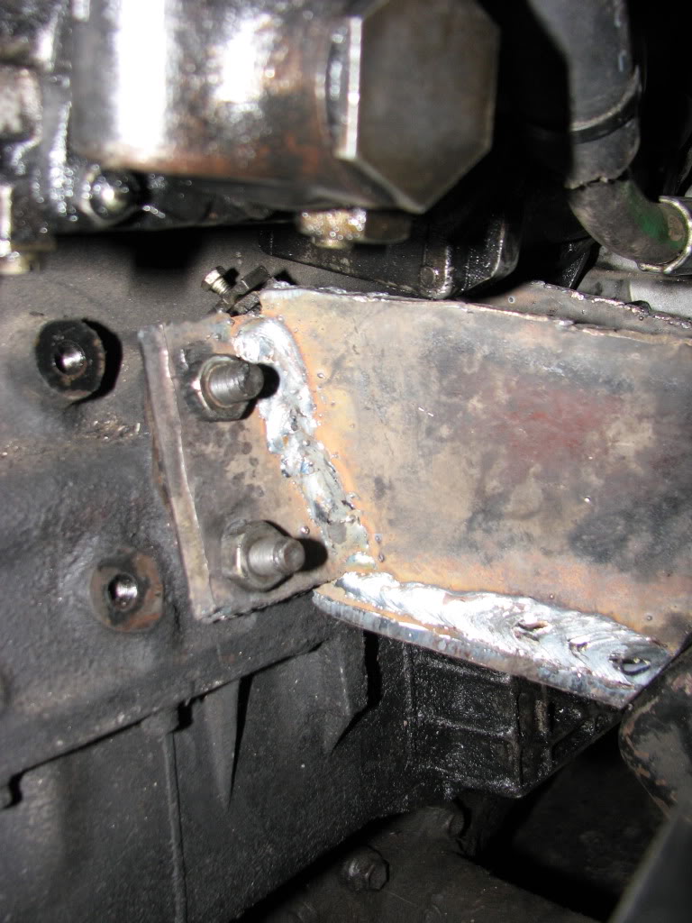

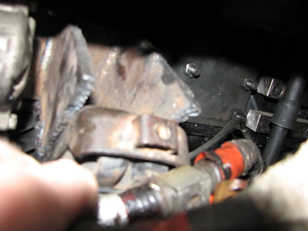

Mountain goat- here are some pictures of my mounts. They aren't the best as its hard to get a good picture in there with the engine in the truck. The mounts are ugly but I believe they will hold. The end plates are 1/2 inch and the rest is 5/16.
Passenger side.
Driver's Side
Honestly I stewed about those mounts for 4 or 5 days. I finally went out there and put the motor where I wanted it on a jack and went to town with cardboard and scissors and knocked em out in a few hours. If you need more pics I'll try and get some better ones in the daylight.

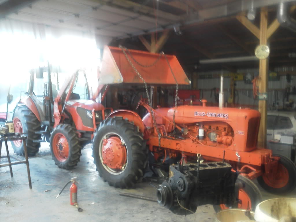

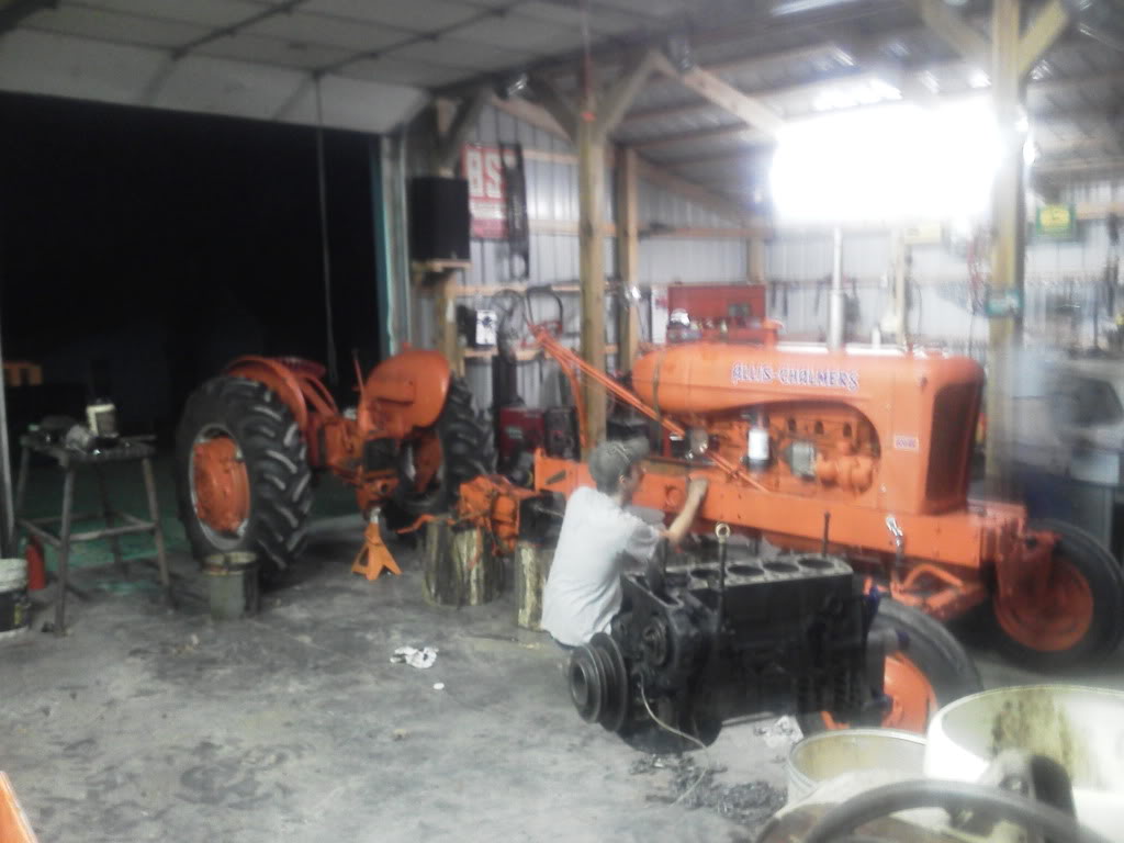

Now for a progress update. I had a little delay this weekend. I helped a good friend put an input shaft seal in their tractor.

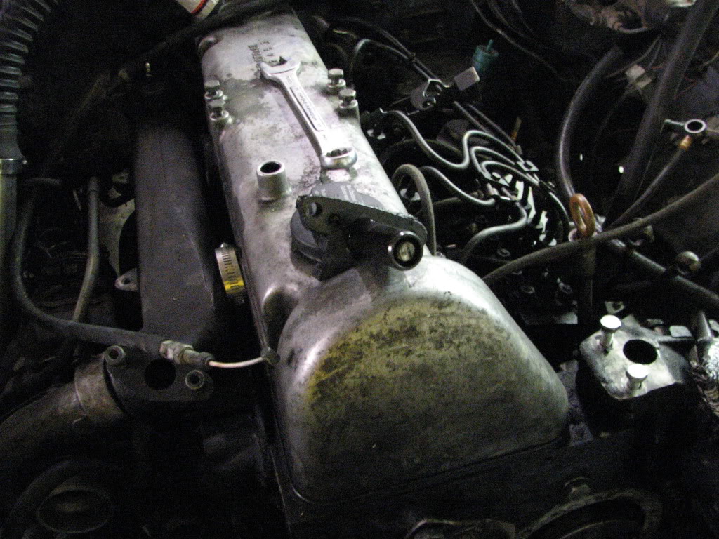

It was nice to have a simple job for a while I was starting to get burned out on the truck. I have discovered the little annoying things take time. I had to order a special fitting to adapt my oil pressure sender to the housing. I am going to have to drill out the thermostat housing to fit my temp gauge sensor as well as my fan temp sensor. I got most of the way through plumbing the radiator and ran out of hose. I am using the existing 3.0 rad for now. I am next to positive I will have to go bigger. I want to see though. Here are some pics of the mount for the radiator. It is no where near done and needs a lot of clean up work and paint but it works for mock up.

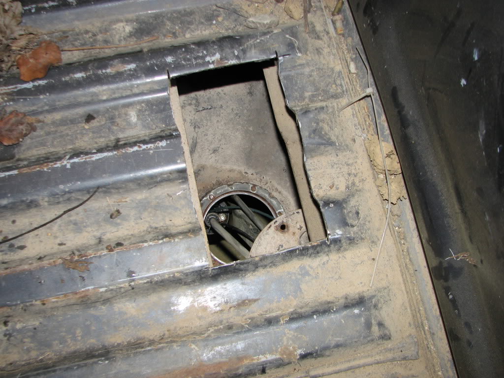

By a miracle I cut that hole directly above the fuel pump so now I don't have to drop the tank lol.

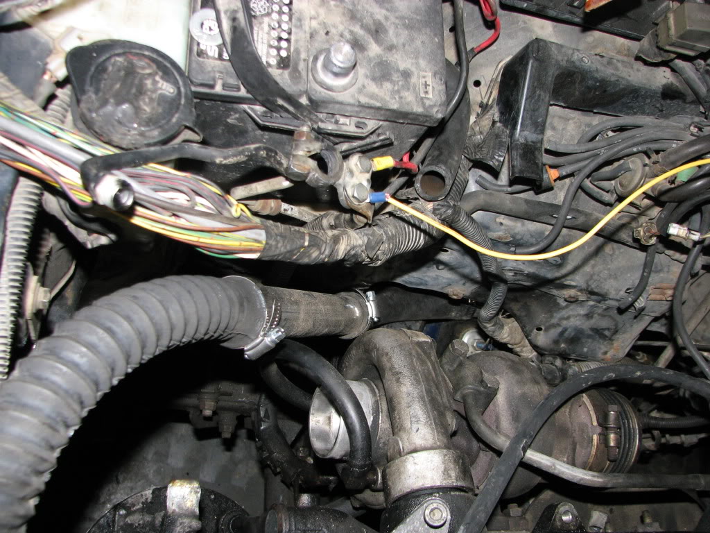

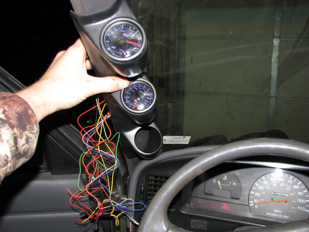

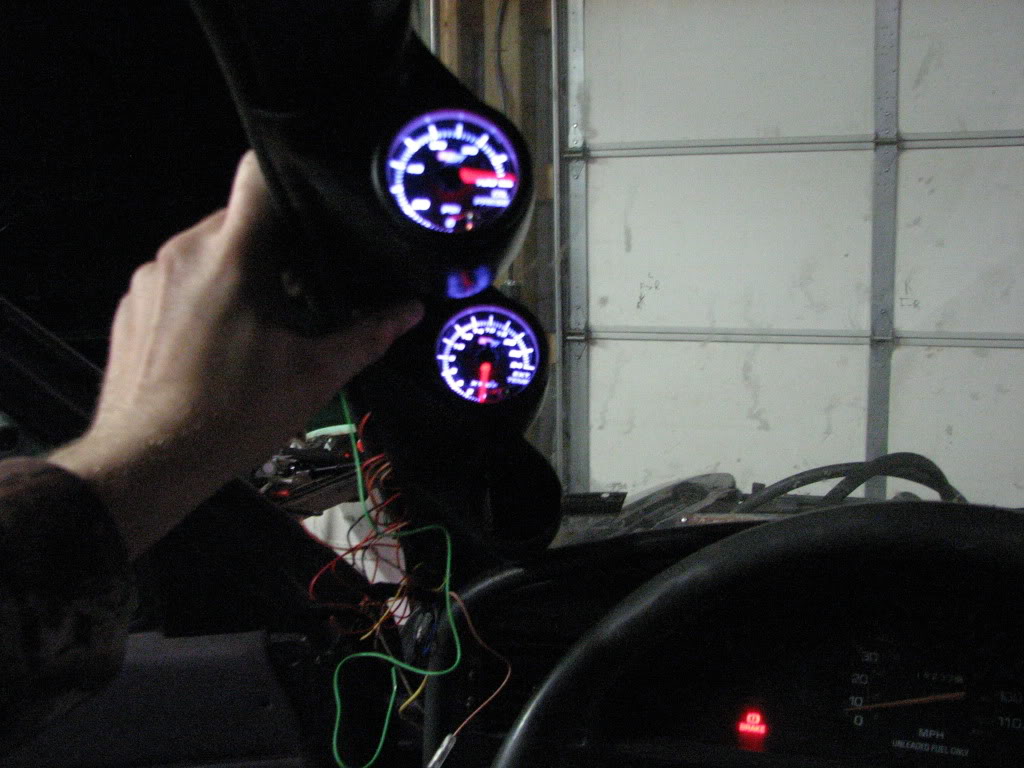

I also got my gauges wired in. I really like them. I have a water temp gauge that is mechanical and it will go in the dash by the clutch cancel switch.
Ignore the mess of wires I left them long for now until I know for sure where the sensor wires are going to have to run. I managed to drop my boost gauge on the floor and it quit working. I called Glowshift and told them what happened and the guy said that he would get it replaced. I know a lot of people don't like them but their customer support is awesome and honestly I prefer the look of them to other gauges.
I don't have much left before I fire it up. I am going to have to pull the t-chain tensioner as I forgot it was a ratchet style and I forgot to reset it. I am hoping someone will chime in and help me with the glow plug wiring. I have a push button in the cab and a Ford starter solenoid. I am just not sure exactly how to wire it. Well I have homework to do.... Yotatech is becoming worse than Facebook to me lol.

Those gauges look better lit up then they do dark joe lol...

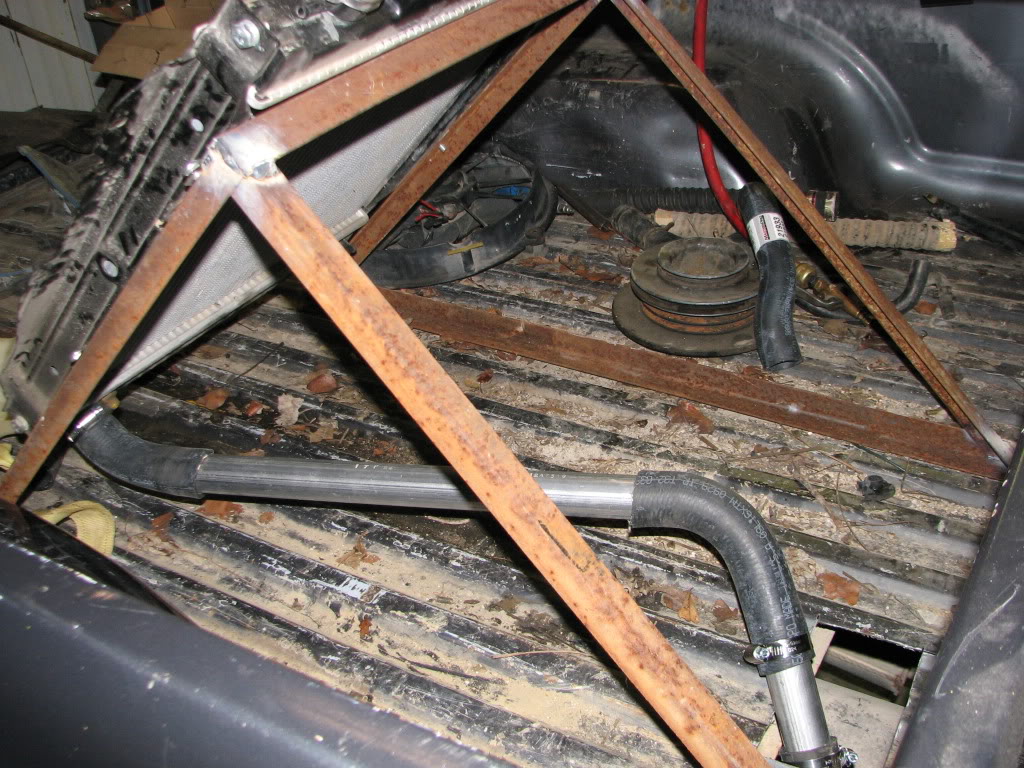

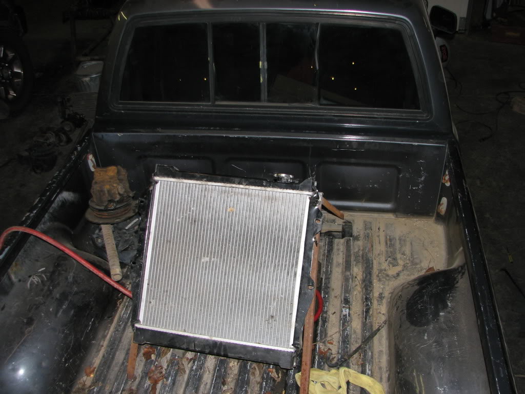

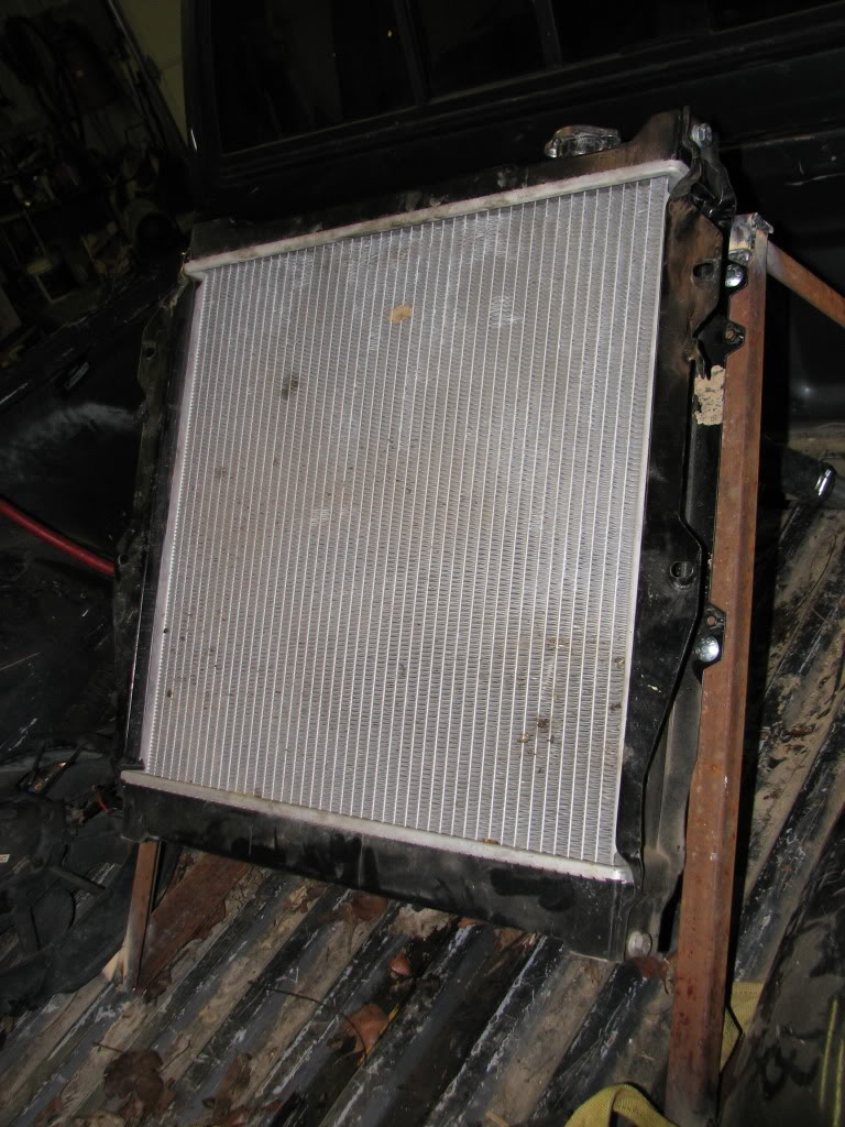

Well I finally got some time being that its Friday. I got my radiator mounted an got one of the lines run to the radiator before I ran out of hose clamps. For those of you that have been wondering here are some pictures of the coolant set up that I have now.
I still have to clean up/paint the radiator support and install my fan but its getting there.

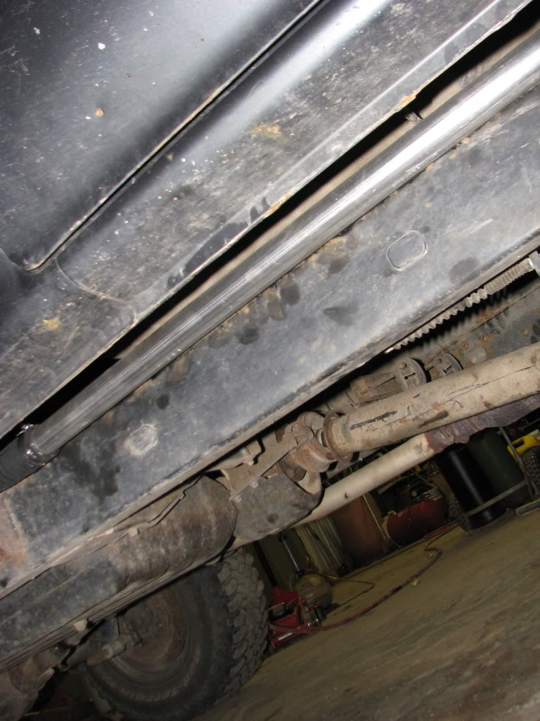

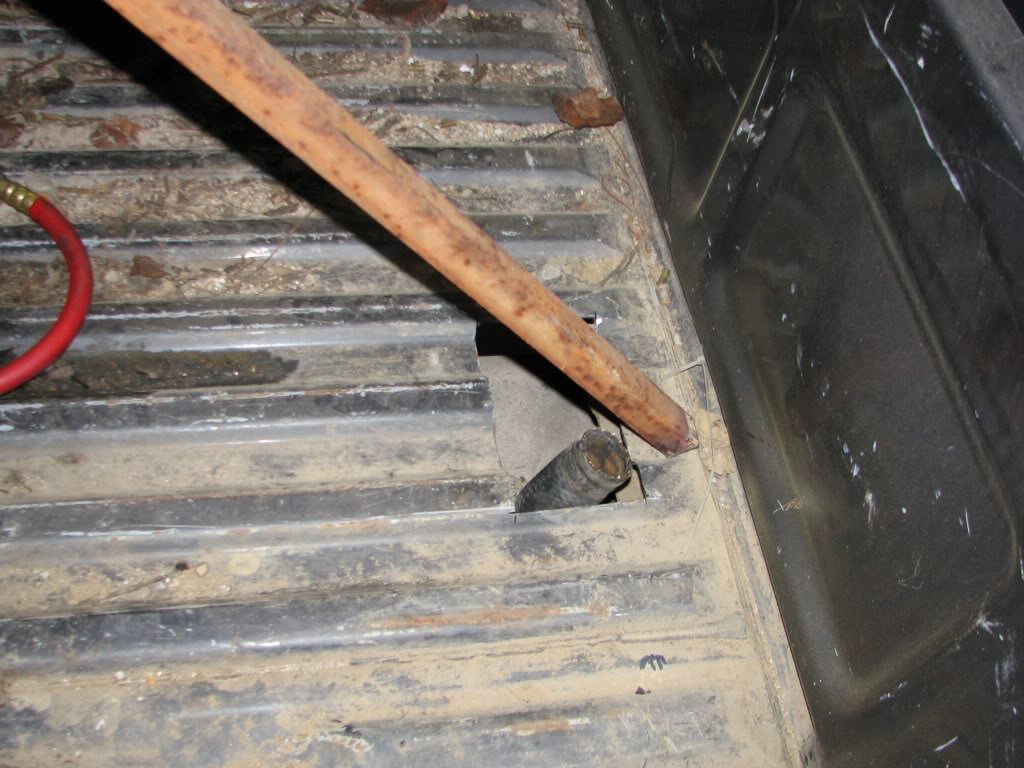

I also removed the stock fuel pump from the tank and put a rubber line in its place.
