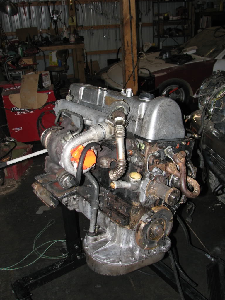

Well the weekend update is here. I ran a compression test and it went as follows.
1. 150
2. 200
3.110
4.120
5.115
Gee wonder what my problem is. So after that I yanked the engine. Took me and a buddy all of about an hour and 15 minutes lol. I didn't get any pictures cause it was spur of the moment thing and I didn't run down to the house to get my camera. I got the engine on the stand and washed it. Pop had some crazy wicked degreaser that he had me use on the engine and all I can say is wow. That crap is crazy! So here it is as of now. I am giving myself a 2 week deadline to have it back in the truck assuming that I get parts in a reasonable time. Here is the engine on the stand after the wash. I feel so much better about working on it thus way!.
Im going to try to get some better pics of the adapter parts too. I still have to track down that dumb fuel bracket for the tank as well!

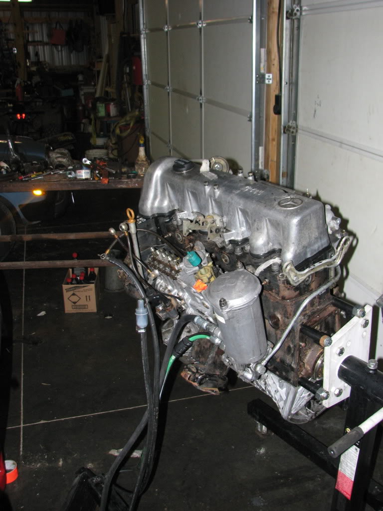

Joe- I am not sure what it is. Pop dug it out of the back corner of the shed, handed it to me and said this ought to fix it. lol
Mountaingoat- I am not sure of the rear in my truck but I know that at 70 the 3vze was running 2750 on 31's. I plan to do some suspension mods and re-gearing later on. I really appreciate the information as I am sure others do as well. That is what this thread is all about! Rest assured the engine will be no funny colors. I have some neat plans for it!.
Dan- In reference to the 2.4. Are you referring to the OM616? Or the 2L toyota? If you are going the turbo benz route why not just add a turbo to your 617. I know I will probably get flamed for saying that but IMO as long as you keep your boost under 10 psi and watch your egts you should be fine! If you want to sell it try i sell and craigslist. Those seem to be the best. Like I said you are welcome to come see mine if you want!
Aviator- I plan to paint it the grey and black just like it was I really like that color combo plus when I pop the hood I want no mistaking that its a benz.
I hope to be taking the engine apart tonight! Pics will follow!

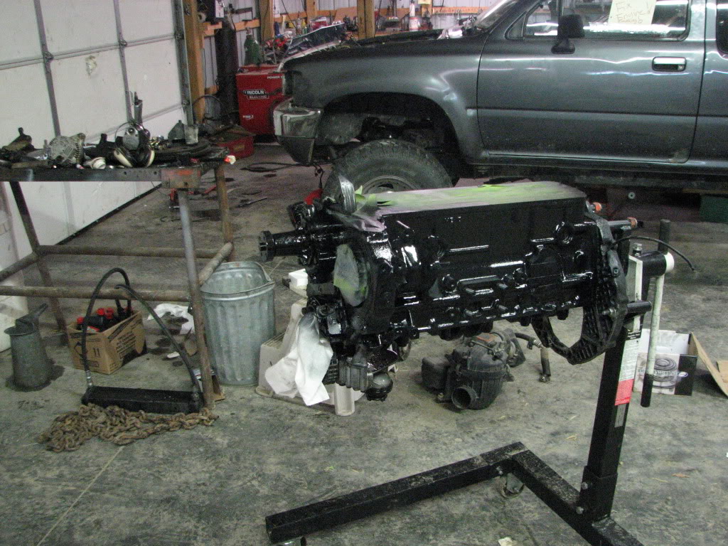

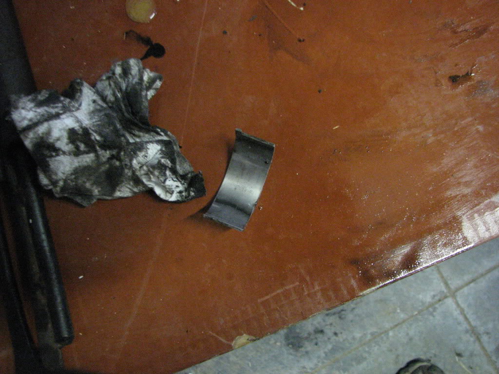

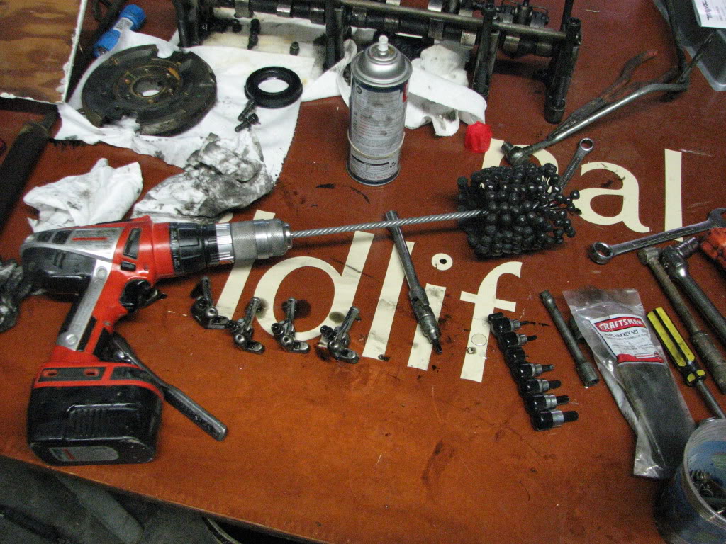

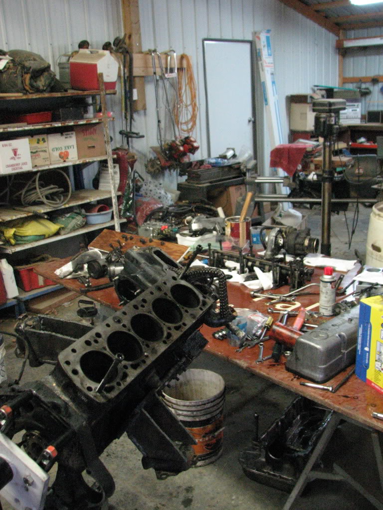

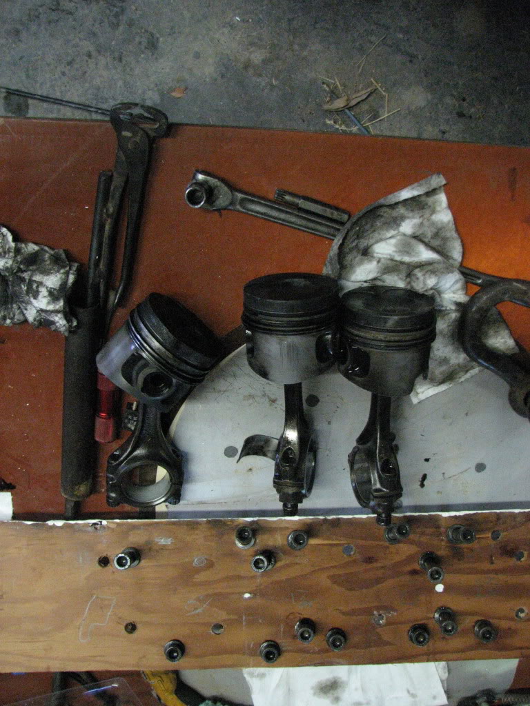

UPDATE- The engine is completely disassembled and I have it all laid out.
The head is at the machine shop right now. I am hoping for it to be done next week some time. I miked the crank and bores and both were within spec. The bores have no taper or elliptical wear to speak of. If anyone would like those specs I will be glad to post them for reference. You can see from the pics the rod bearings were pretty well shot. I'm glad I took this thing down. One thing to note on this engine. The tolerances for the cylinder bore maximum diameter is literally less than .001 It isn't much. That being said I elected to break out the ball hone. Unfortunately I didn't have one on hand for this bore size but the local tool shop had one. I don't use them that often but for close tolerance work I prefer them to to the stone hone.

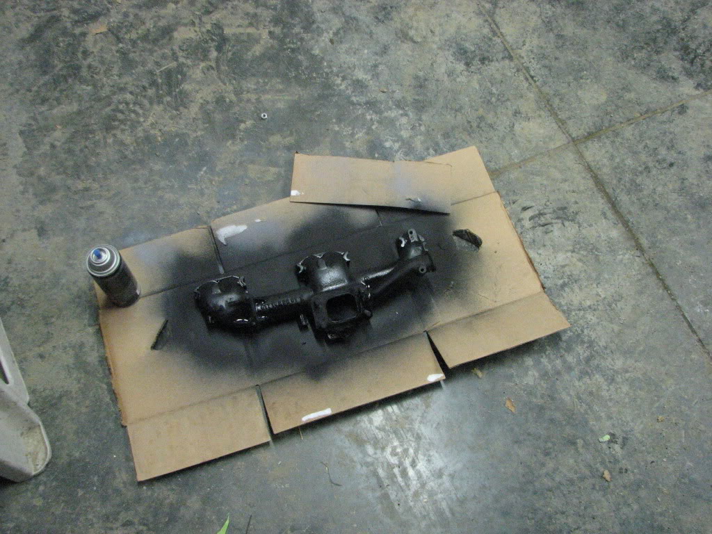

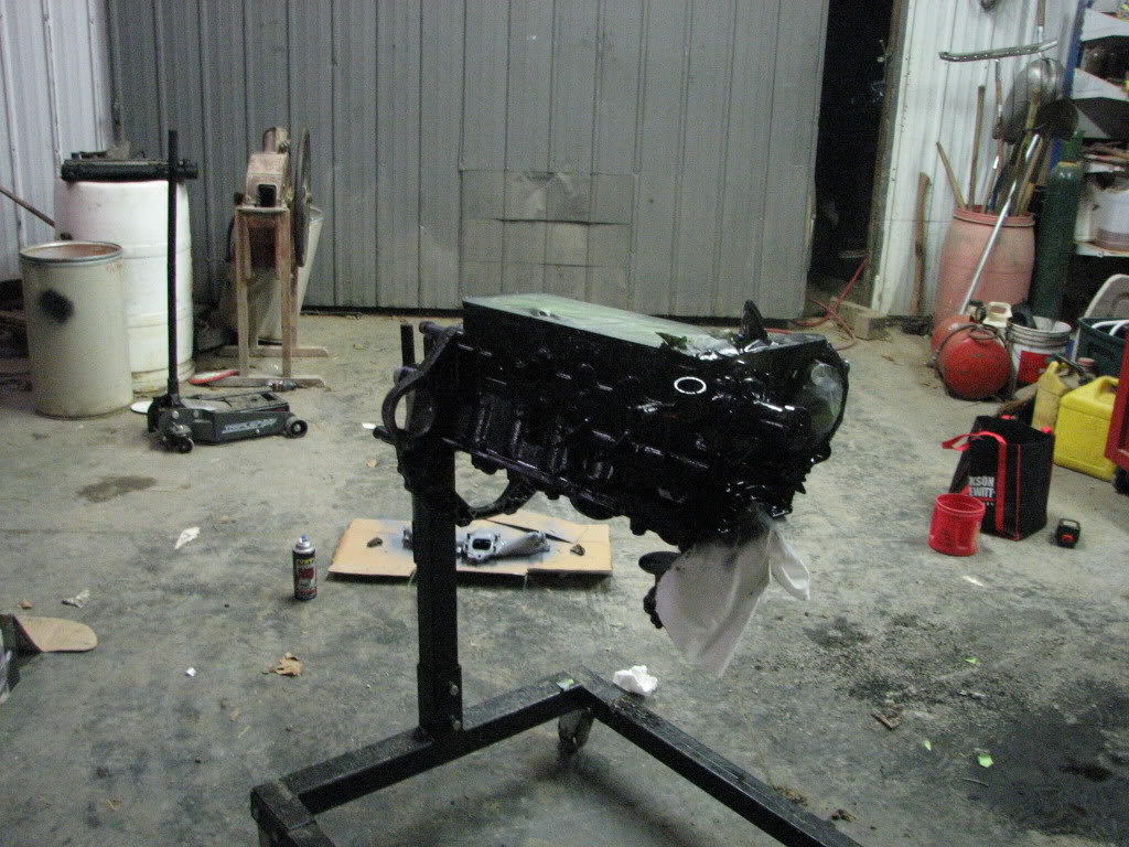

Ill get some pics of the cylinder walls tomorrow. So tonight while waiting for parts to get here I masked the block off and started working on getting it cleaned up. I primed it and hit it with a few coats of paint. I'm going to let it dry and hit it again tomorrow.
I also started on the exhaust manifold and the intake as well.
I am going to hit things pretty hard tomorrow as I only have one class at school. I'll be sure to keep you all posted.
