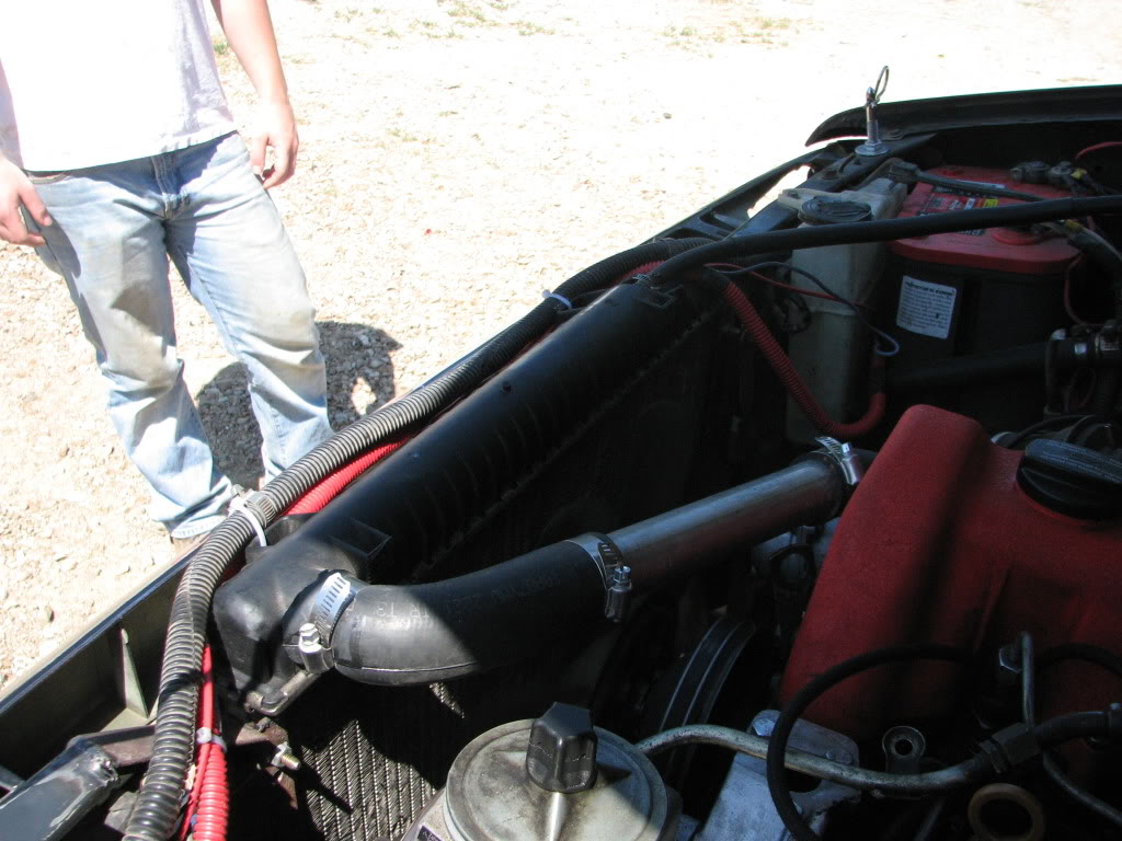

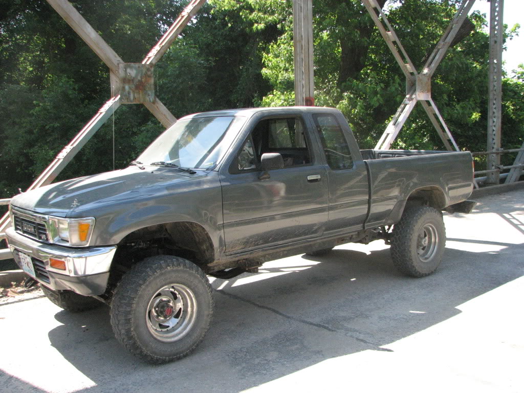

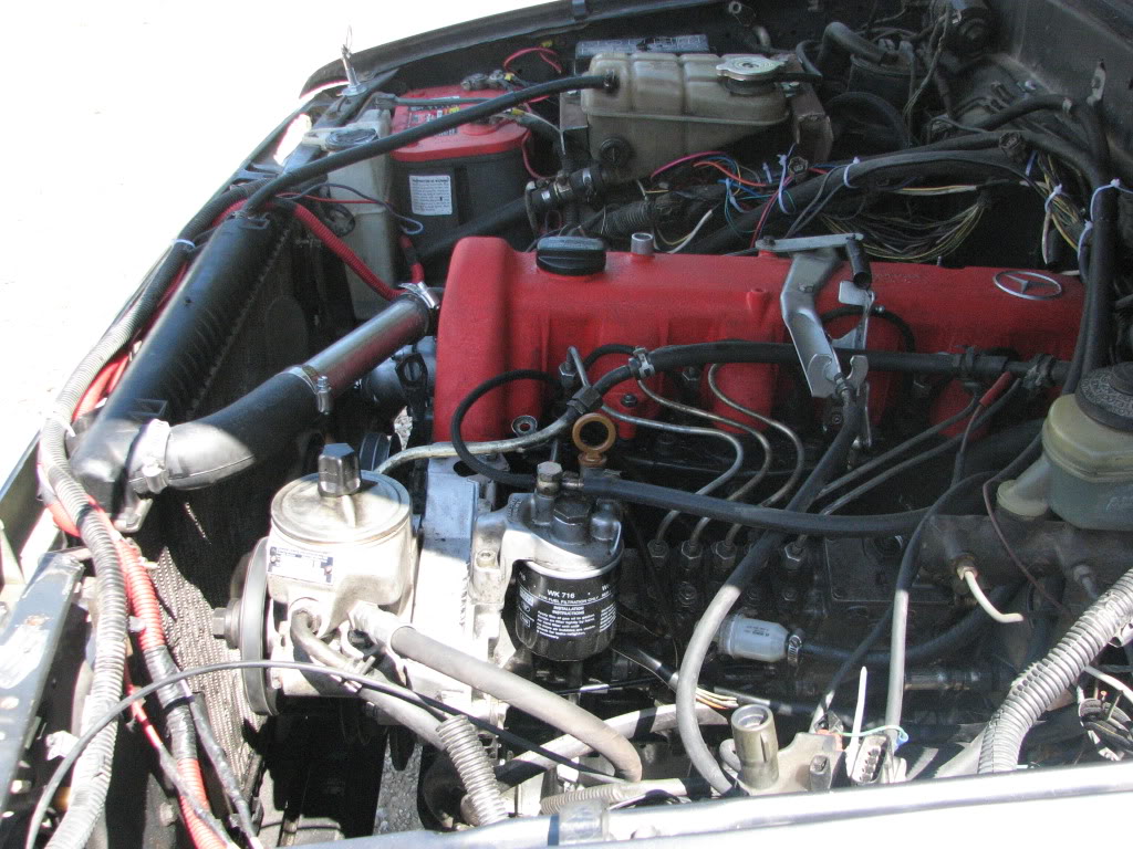

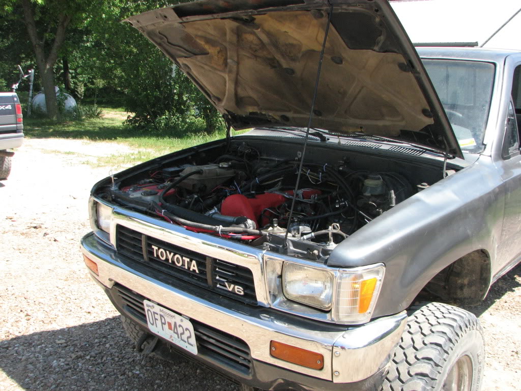

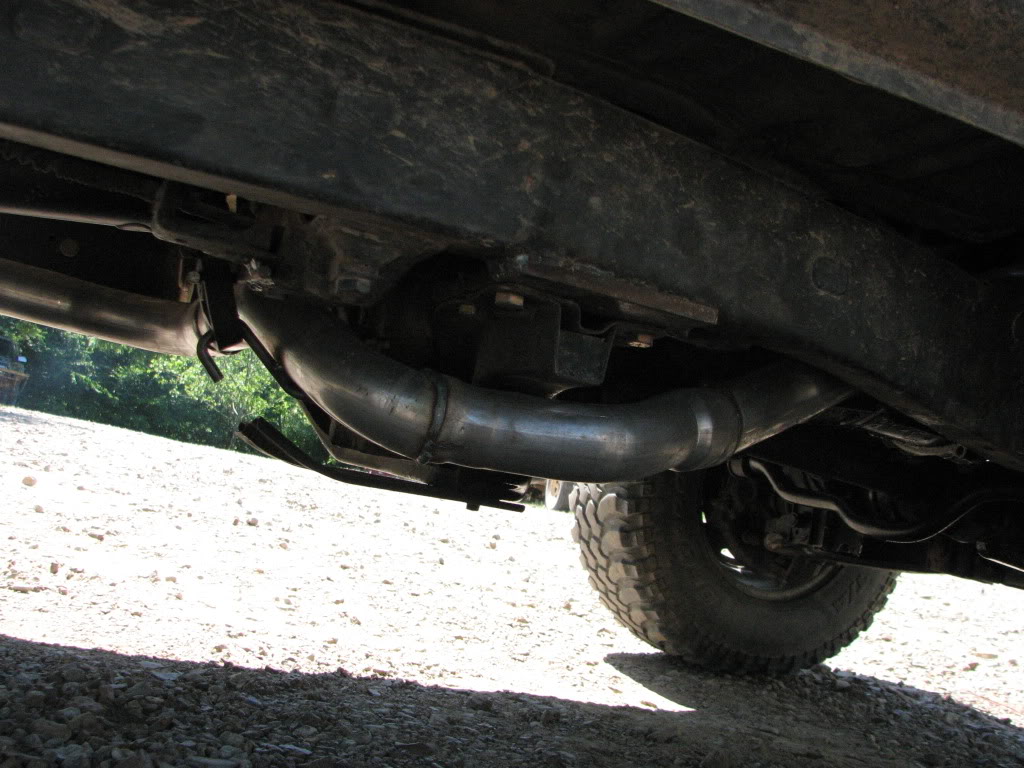

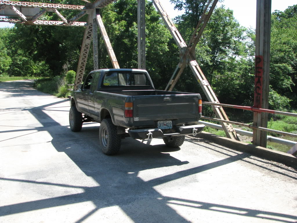

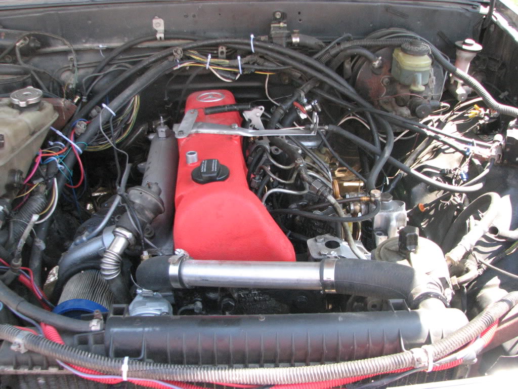

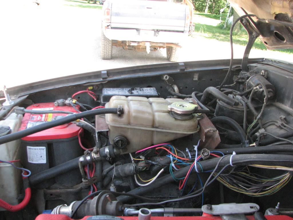

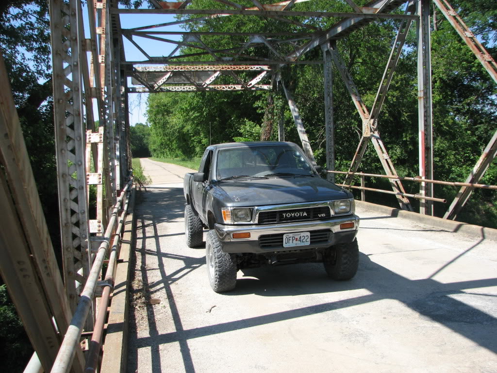

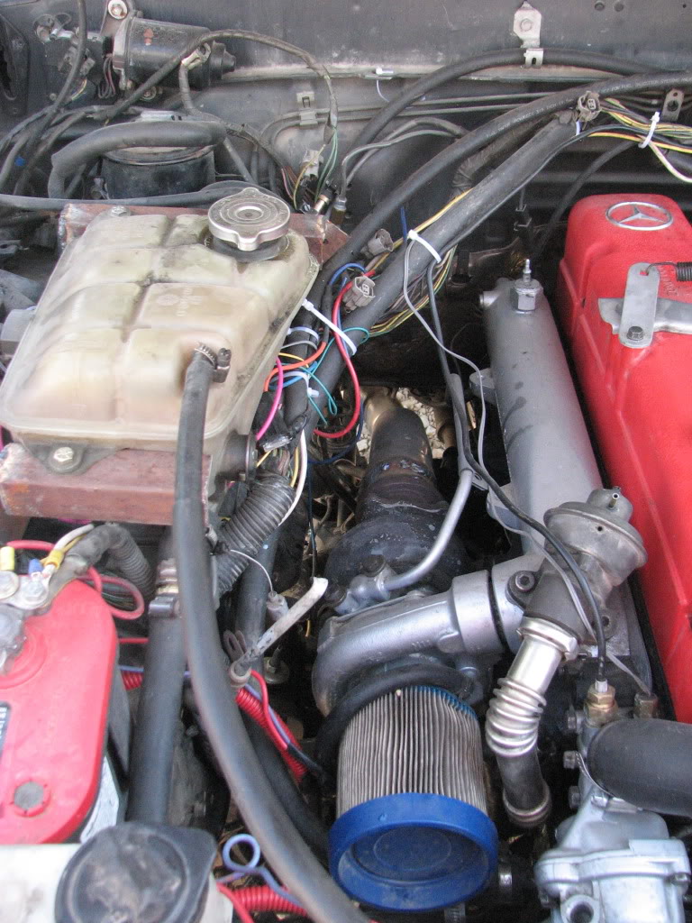

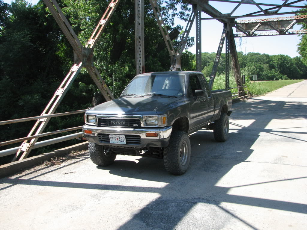

I finally got a chance to get everything buttoned up on the truck today and it seems much better even with the timing a little off. I drove it about 100 miles. It will run 65-70 fairly comfortably, you just have to shift at different points than the gasser to keep it in the boost. I also got around to taking some better detailed pictures. If there are anymore pictures anyone wants please let me know.

I still have a lot of cleaning up to do under the hood but its drivable for now.

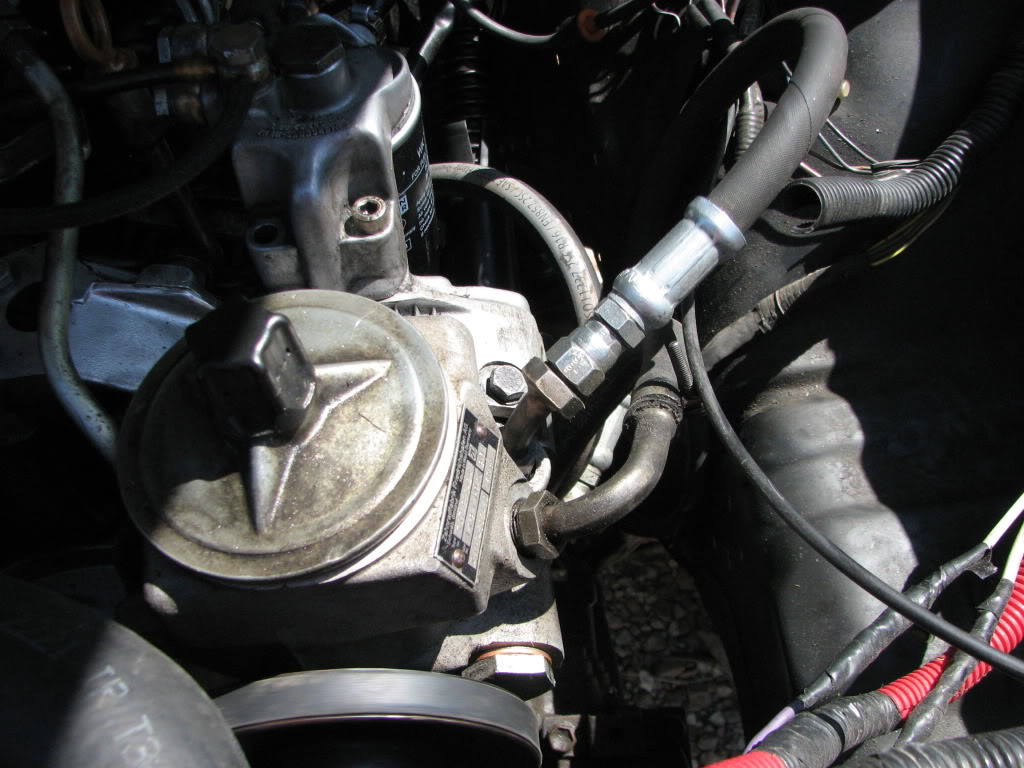

Looks great. Mercedes PS pump works fine? Did you keep the alt in the stock location?

Whaer did u put the oil cooler?

Gbrunner- Yep actually the Mercedes pump works fantastic. I have a rebuild write up in this thread. I would recommend doing that while you have it out as its cheap insurance. Also you are probably going to have to run power steering fluid in it as that's the only thing that wont leak out of mine. The alternator is in the stock Mercedes location. I clearanced the Merc lower bracket to fit it and used the upper bracket off the Toyota. Name:  Toyota074.jpg
2003mikemThe oilcooler is mounted directly below the radiator between the tow hooks. If you look at it in the head on shot you can just see it. Honestly its the only place I had room for it. It gets good airflow there too. I've had the truck in the field a lot for hay and crop season thus far and haven't even come near to hitting it on anything, but if one planned to offroad it hard core it would be toast I have a feeling.

Thanks. Anyone know what the sensor is on the intake manifold on the top towards the rear? Ive removed my egr and want to Plug that if it isn't needed. Thanks.

Its some sensor for the egr. You can do away with it, or leave it which I did. The banjo bolt on the back of the intake is a great place to tap into for a boost line.

Its a boost sensor
