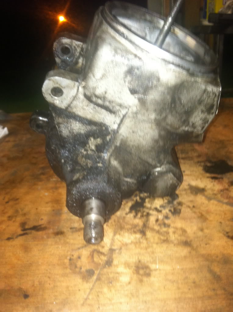

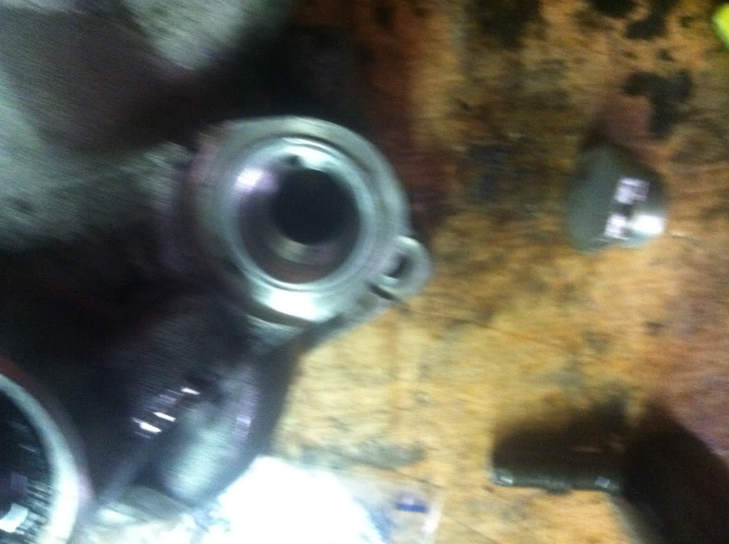

Well I finally got a little time to work on the truck. I resealed the power steering pump as it was leaking like a sieve. I guess it decided it was jealous since it was the only thing that didn't get re worked. I figured I'd post a mini write up on how to do it as its sort of a pain and for those who use the pump the new ATF will make it leak and leak bad.
I ordered the seal kit from peach parts as well as the filter and the front seal. Depending on which pump you have you will determine the front seal size. I was unsure so I ordered both. So first pop the pump of its mounting bracket and drain all the fluid out. You can see here just how bad mine was leaking.
Next remove the pulley. I have found that using an impact to remove the nut is easiest. Be sure to take the woodruff key out and put it someplace safe.

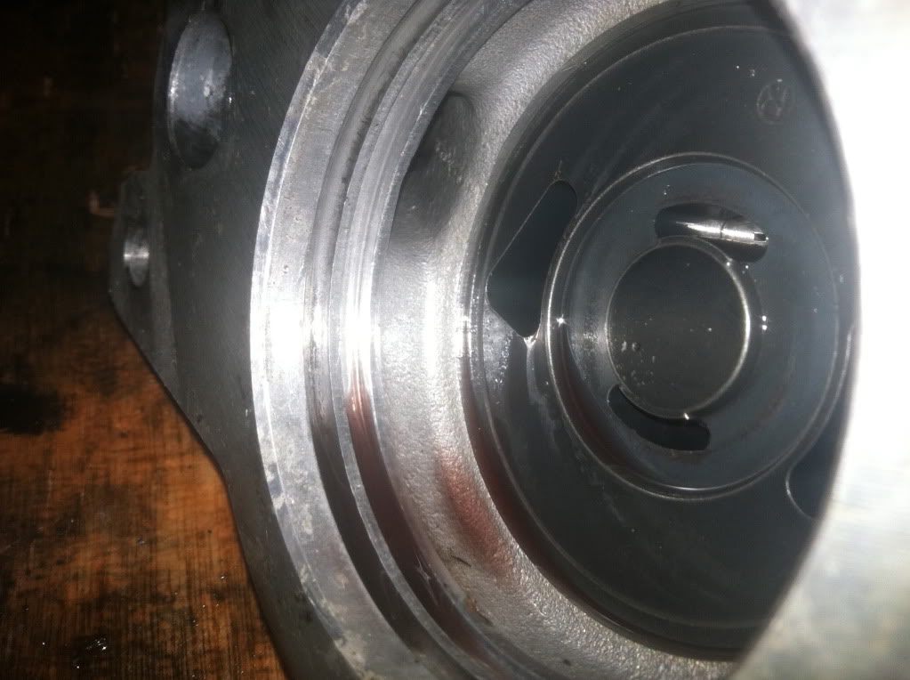

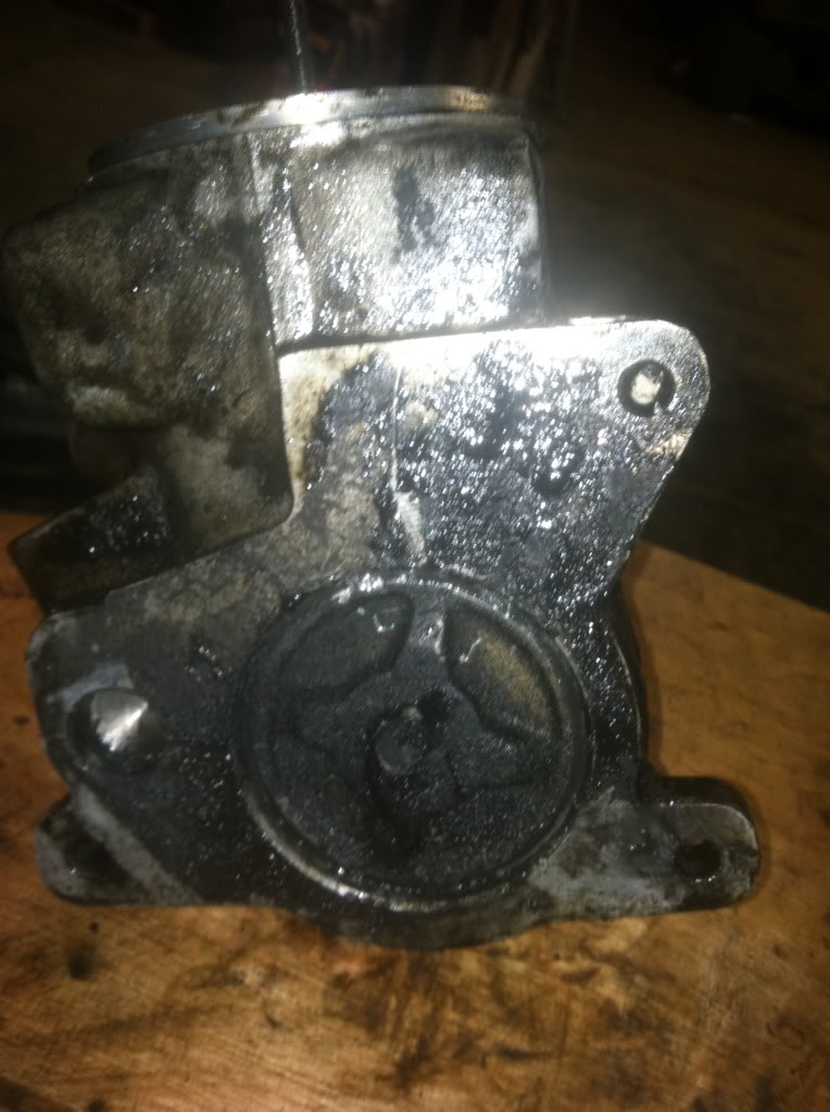

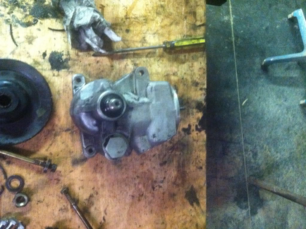

Next use a C-clamp to compress the back of the pump to remove the snap ring holding the back on. Once the ring is removed you can release the clamp and remove the back. Mine was a pain and I had to use a huge set of channel locks to remove mine. This is what you will get.
I then at this point took the opportunity to soak the pump in diesel and clean it all up.

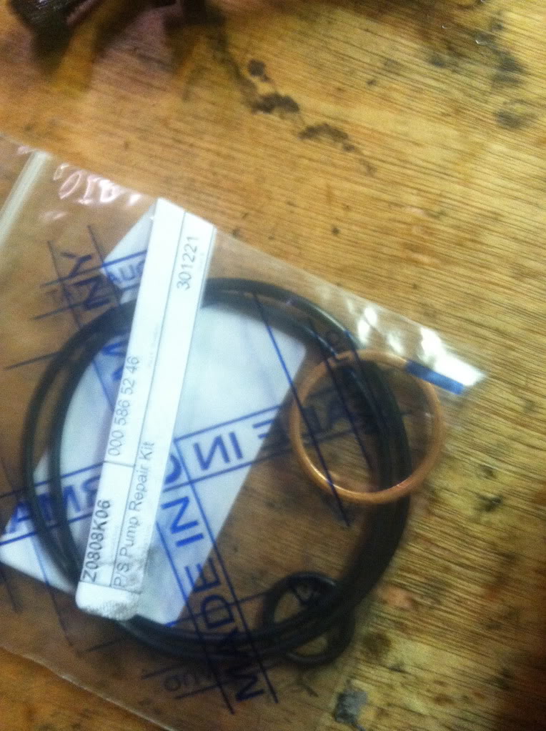

Now its time to start with the new parts. Here is the seal kit.

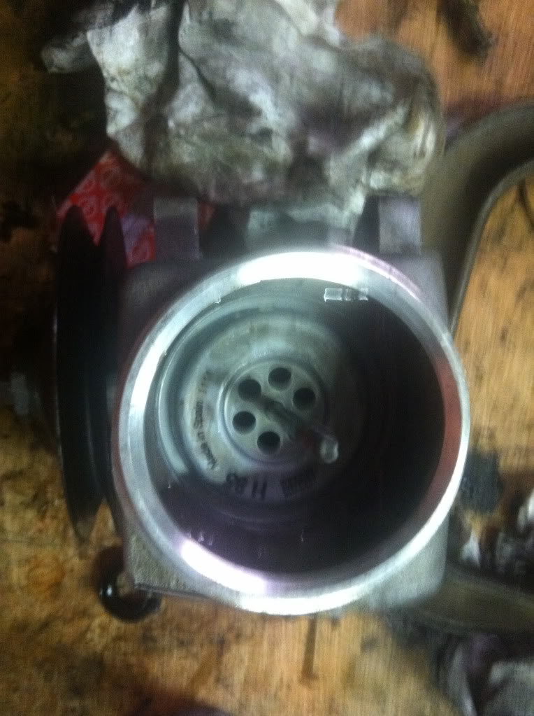

This is the back of the pump where the Big O-ring goes. It sits in the lower groove towards the front of the pump.
You can now put the spring in and put the back of the pump together. Be sure to lubricate the o ring really good.

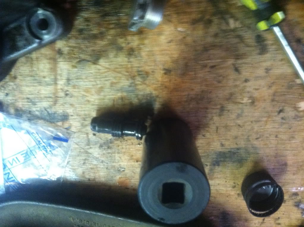

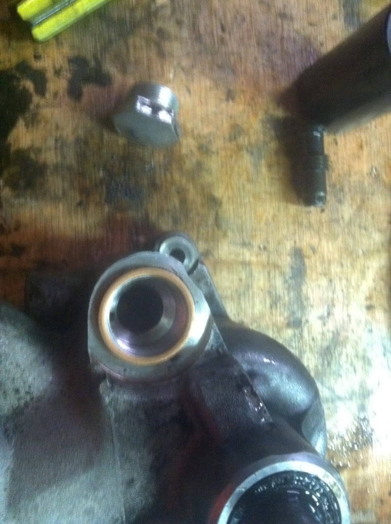

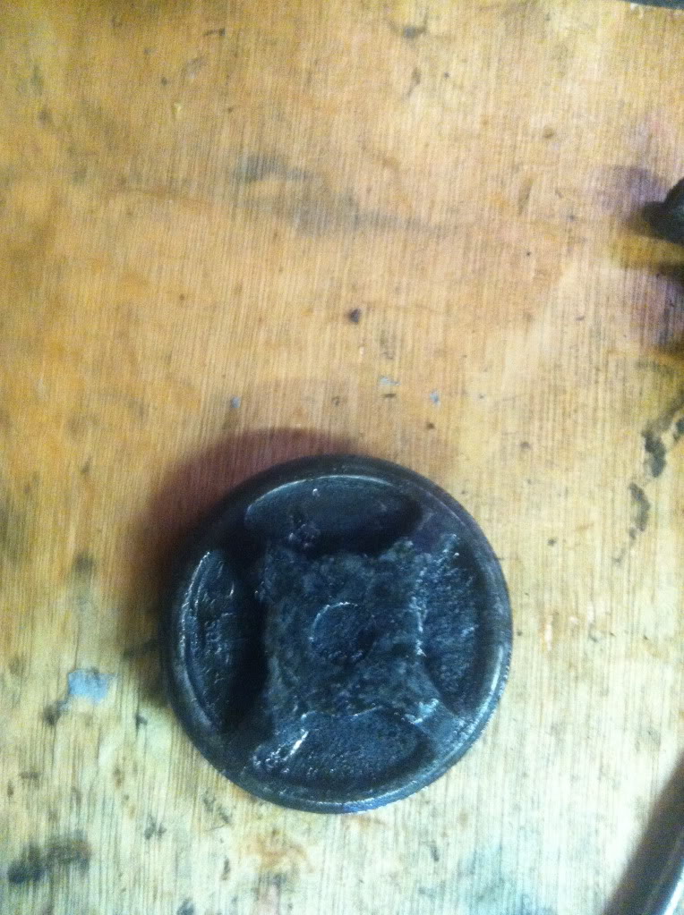

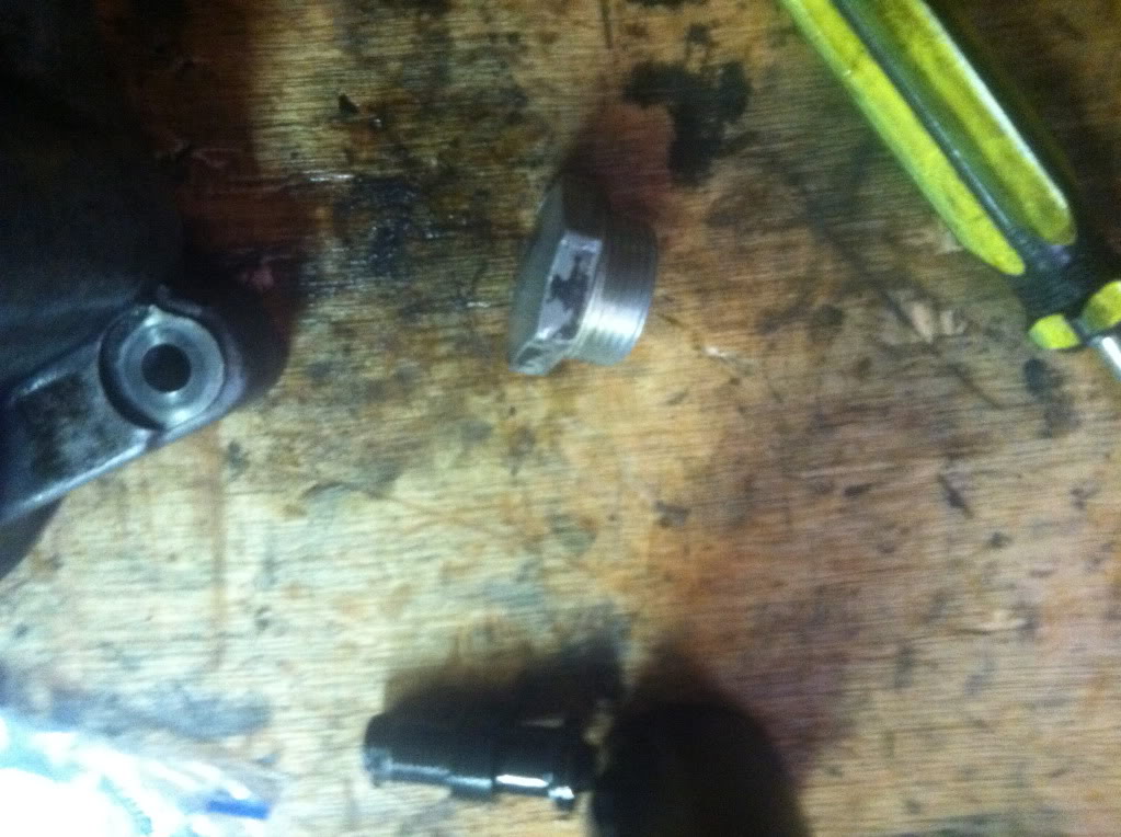

next take the cap off the relief valve on the front of the pump and put a new copper crush washer on it. While you have it apart clean out the little screen in there.
The relief valve disassembled.
New crush washer.

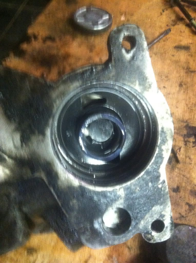

Now on to the front seal. I didn't get a good picture but take a screw driver and carefully pull the seal without damaging the housing. I then used a deep impact socket the same diameter as the seal to drive it on.

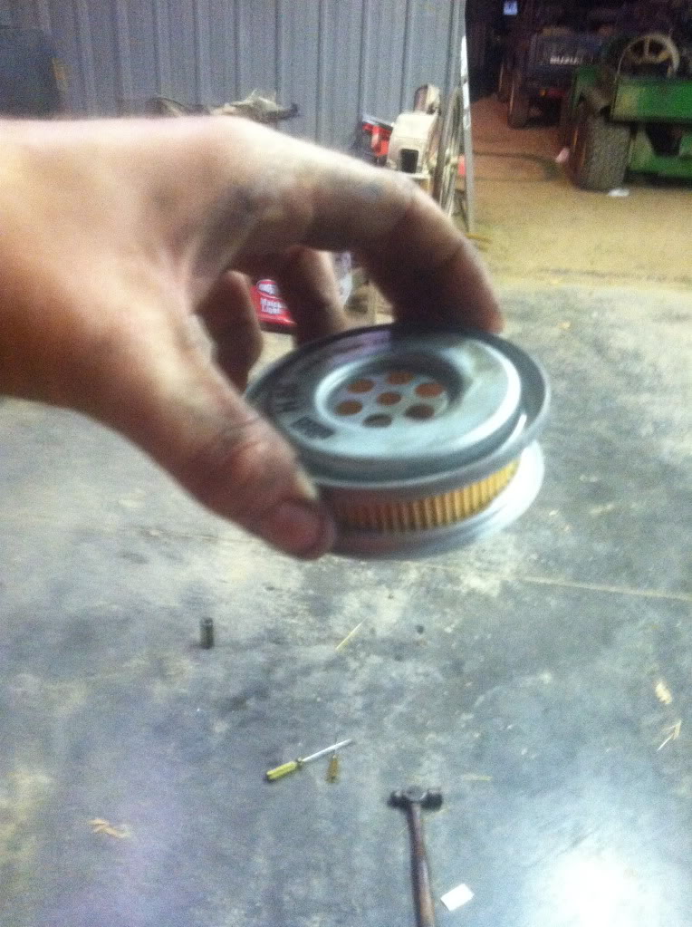

So the last thing to do is put the pulley back on and install the new filter into the bottom of the pump.
It's not that hard to do it is just a little tedious.
New crush washer.
