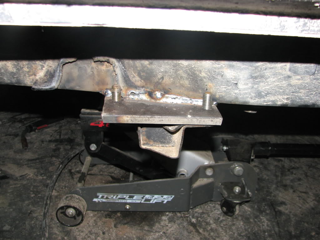

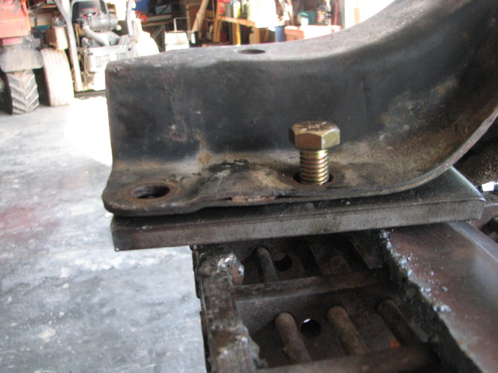

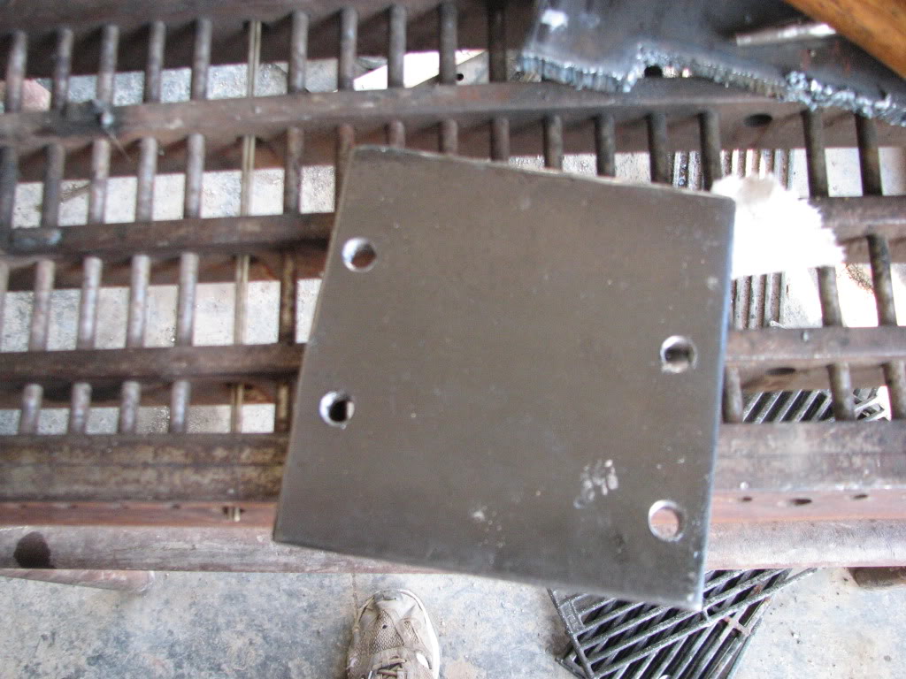

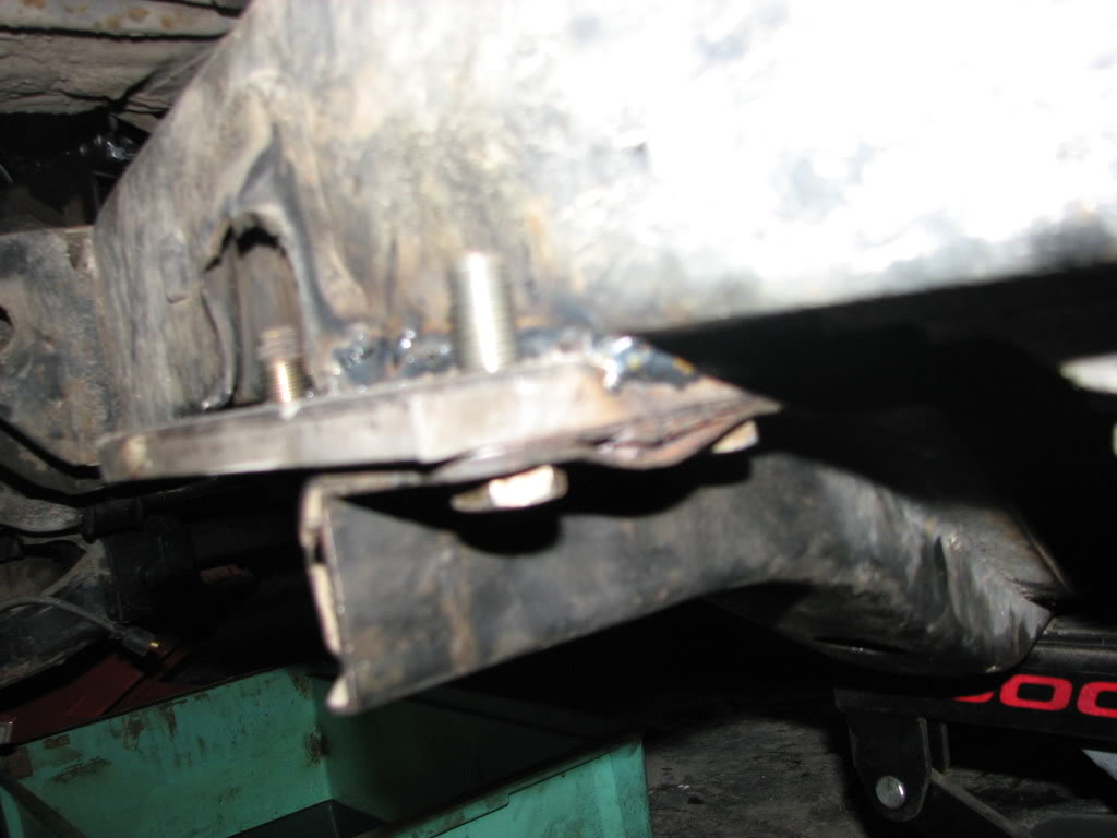

Today I hit this think as soon as I got out of school. One of my friends came over and helped me out a ton. Basically what I did was removed the cross member and made 1/2 inch plate mounts that bolt to the crossmember under the transfer case mount. Then we moved the whole lot back 2 1/2in and centered it all up. I then welded the plate mounts to the frame. All that is left is to finish welding the crossmember mounts to the frame, make new engine mounts, mount the radiator, and shorten the driveshaft. I had to cut out all of the core support where the radiator will go so I am going to have to use hood pins. Oh, and I am 99% sure the mechanical fan will fit. Anyhow here are the pictures.

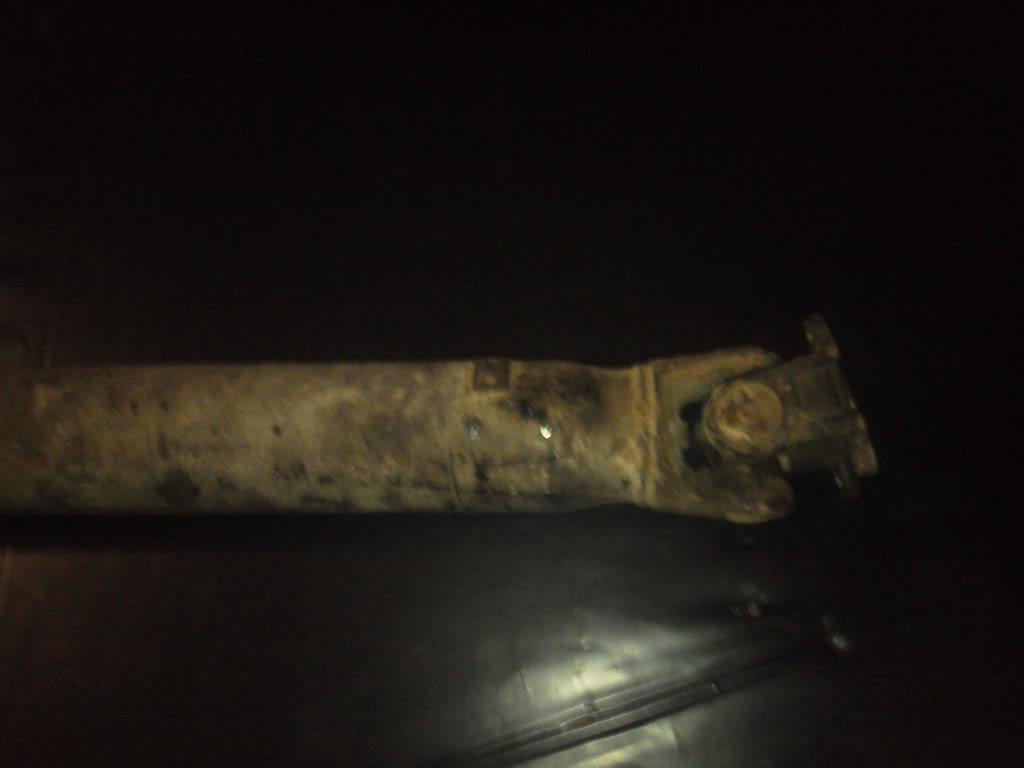

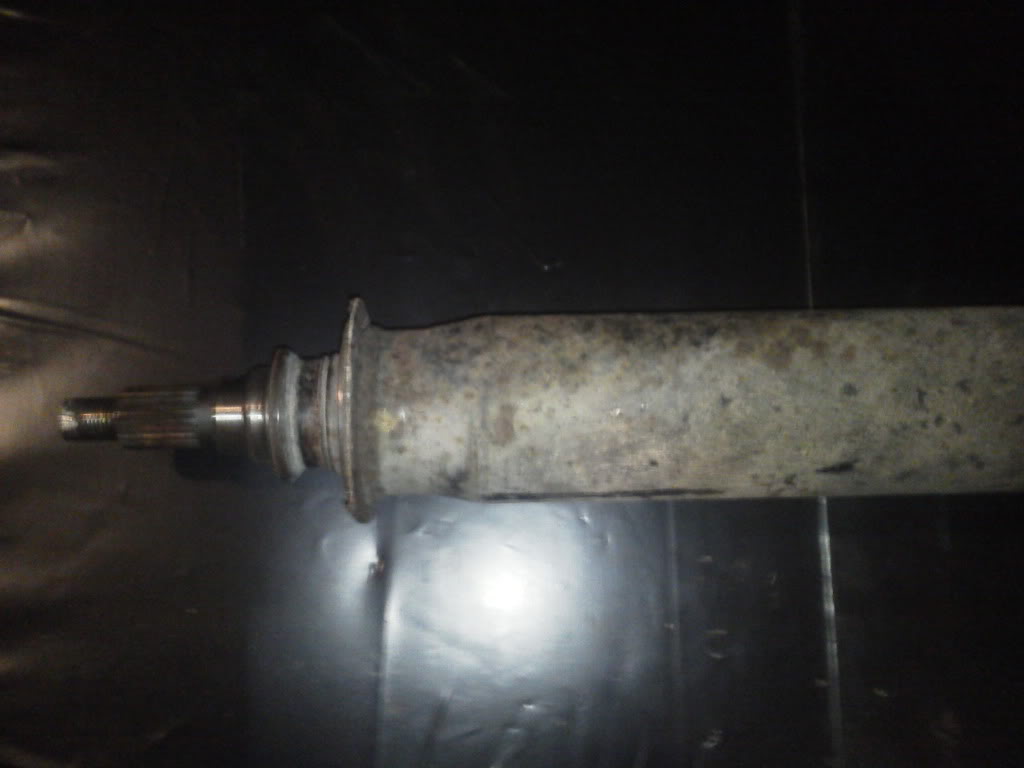

Well I just got back from the machine shop and apparently my driveshaft can't be shortened. I am calling B.S. What I am wanting to do is take 3 3/4 inches from the front half of the two piece setup. I may break down eventually and buy a one piece but I was wondering if you guys had any ideas. The guy quoted me 7-900 for a custom shaft.... well there is a snowballs chance in hell of me ever doing that. I am tempted to split the thing in the middle and weld it back. I know its not ideal but I'v done it on PTO shafts in the past with success. I am not sure what to do as this hurdle I hadn't seen.

Most places I have dealt with charge around $125 to shorten a shaft and up to $250 to retube one to make it longer

Yup thats what my guy up here charges. 900 is a rip off. post up some picks of your drive shaft doses it neck down at both sides?

As I recall the mid section has a taper on the rear side which is probably why they said no... a good shop should be able to cut out a section and weld her up proper for you...

Yeah the problem is I have the 2 piece and it necked down at both ends. The only way I can see to shorten it is to find a yoke that will fit the 3 inch shaft. I am heavily leaning toward ordering a one piece. Any how here are the pictures. Thanks so much for the help.

what i'd do is cut your flange off, cut 3 and whatever " off the tube, then stick a smaller diameter tube inside the d-shaft and weld it so it sticks out enough for you to weld back to your flange. You'll have to get a pretty thick gauge tube, but it'd be really cheap. I definitely wouldn't cut it in the middle. I'm pretty sure the heat stress will cause your d-shaft to fail very quickly, especially now with the diesel's torque

Grandpa and I were just discussing that. I'll have to see what kind of pipe I can get in the morning. If I were to cut it in the middle It would be sleeved when I put it back together, but it would not balance so that's a no go. I did sleeve a power shaft on one of out brush hogs a few years back and knock on wood it's still running. I just don't wanna chance it with the truck.

What you need to find Joe is a driveshaft specialty shop... a place that has the equipment to balance a 'shaft... they can set up what you need no worries... there's a shop in town here but the shipping cost would be prohibitive... why not ask around your "local" technical schools/colleges... I'm sure one of them could help you... maybe even make it a class project... heck even ask the local HS auto shop teacher he/she might be able to hook you up... might even be way cheaper than going to a commercial shop... and the kids would learn something...
shortening/lengthening a shaft is'int rocket science it's just a matter of good even clean string welds and a balancer... [and a tech who knows what they're doing]... I had to get the rear shaft on my unmoded 87 long box balanced... it was eating pinion seals on my 3rd... they thru it on the machine and a few welded fender washers later... I had me a balanced shaft that went 180000kms before I sold the truck... and a smooth vibration free cadilac-esque ride the whole time... [except for the stiffness from RS5000 on all corners that is lol]
try also the class 8 truck shops and or tractor shops... I'm sure one of them will know where to find a 'shaft shop cheap... other than the crooks you were talking to earlier
