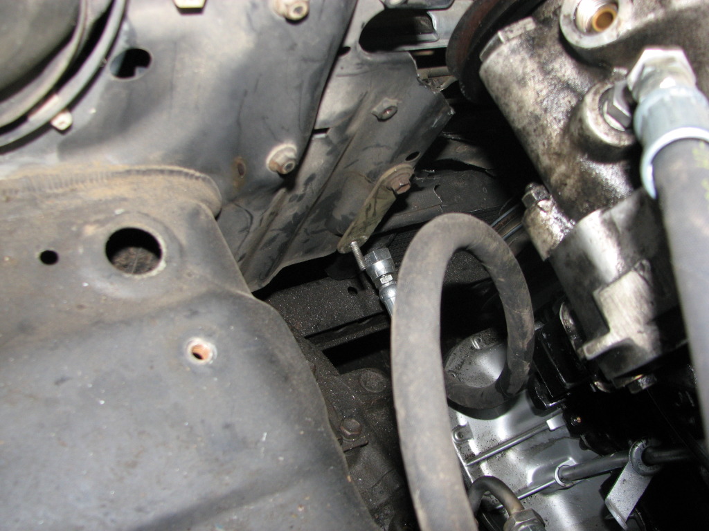

Joe, when you get the chance, a pic of your tie-rod oil pan clearance would be a big help. No rush though. Family first. Hope your Grandfather is back at it.

Mountaingoat- I will grab some pictures for you tomorrow or the next day. I really should have made my notch deeper but it works I just have a hair's clearance.

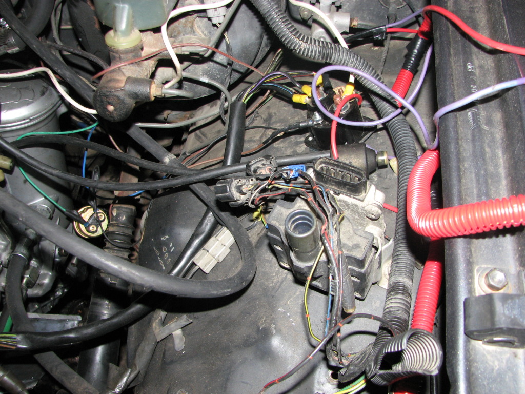

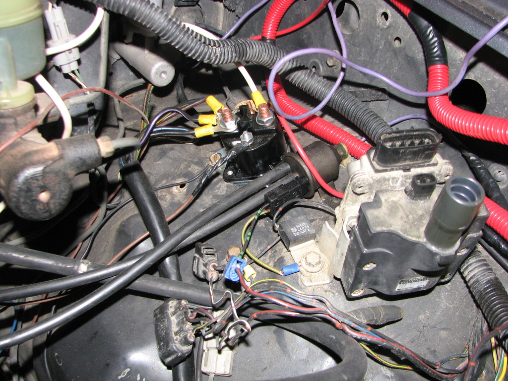

This is the starter solenoid that runs my glow plugs. I used the key on power from the clock wires to activate it via the push button in the cab.
You can see the VSV in this picture. I did as 89lc stated and used the ignitor power wire. Take note if you are going to use the overboost valve from the car you must step on the brakes before turning the key back on to vent the vacuum. I am going to use another solenoid off the 3.0 that vents to the atmosphere.

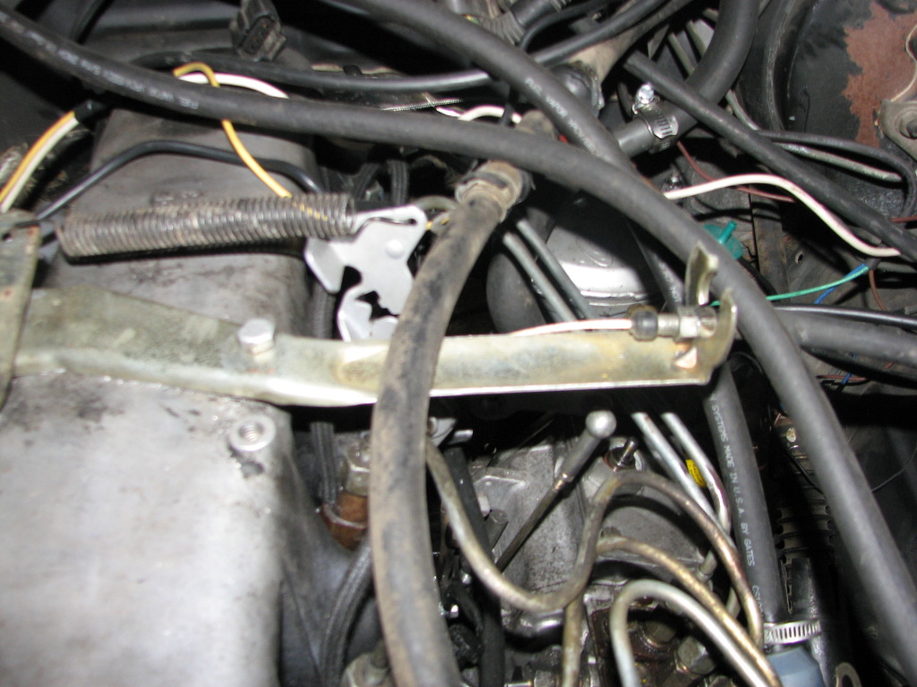

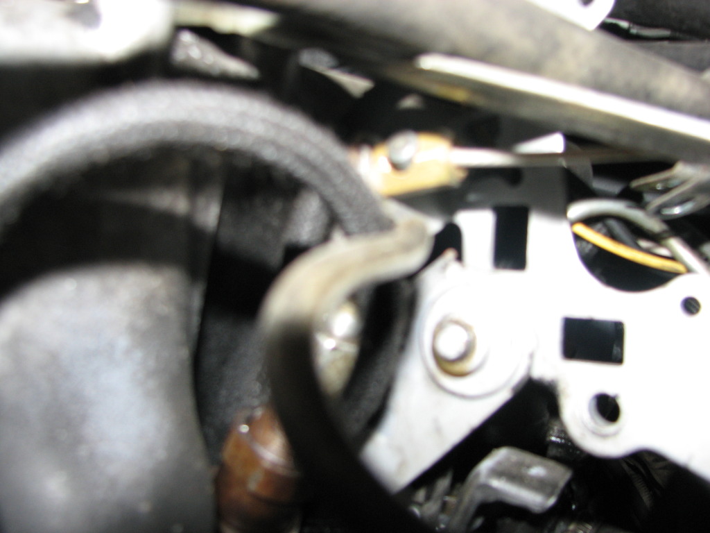

The throttle linkage was made from the old fuel pump bracket. Grandpa came up with that idea.
He also made the adapter to bolt the cable to the stop lever. He made it out of a brass fitting left over from my boost gauge. Single handedly one of the coolest things I've ever seen anyone do.

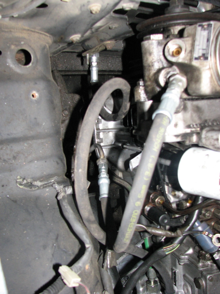

Here is the distance between the core support and the engine.... not much wiggle room.
I silver soldered my old power steering ends to standard fittings and then used hydraulic hose to make the high pressure line.
You can also see the oilcooler mounting location in this pic. I haven't secured the lines yet but that's where its going.

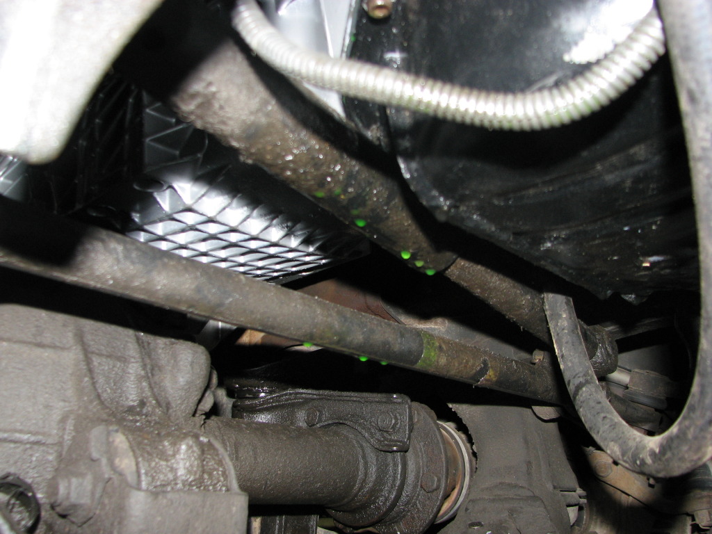

Mountaingoat here is the oil pan clearance. My engine could go up even more yet. It only has about 1/2 inch clearance. The coolant is from bleeding the air out of the system earlier. If you need any more pictures I'd be glad to get them for you.

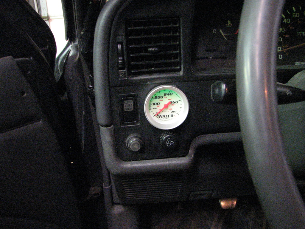

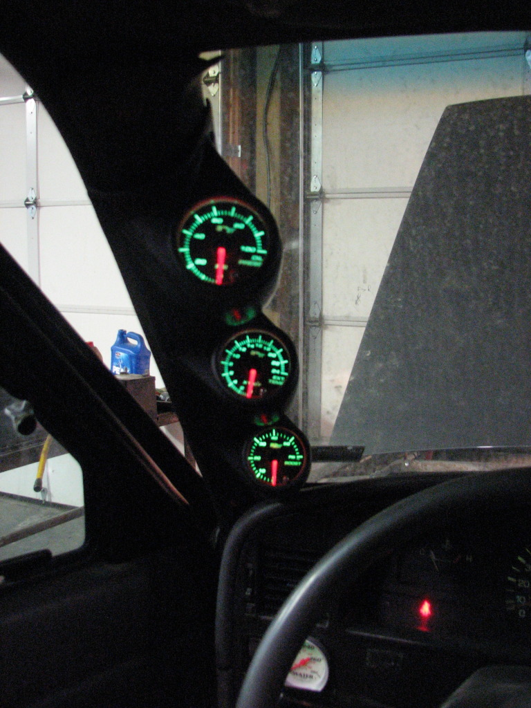

This is how I mounted my extra gauges and glow plug switch. Overall I am very happy with how the interior turned out.

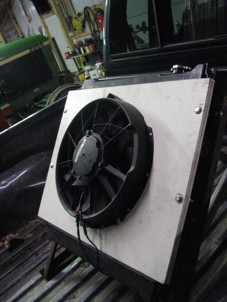

I made a fan shroud for my rad out of marine grade plywood and it worked surprisingly well, but I am going to get a bigger rad. I believe I am going to follow Truckman1966's route and get a gm k20 rad.
