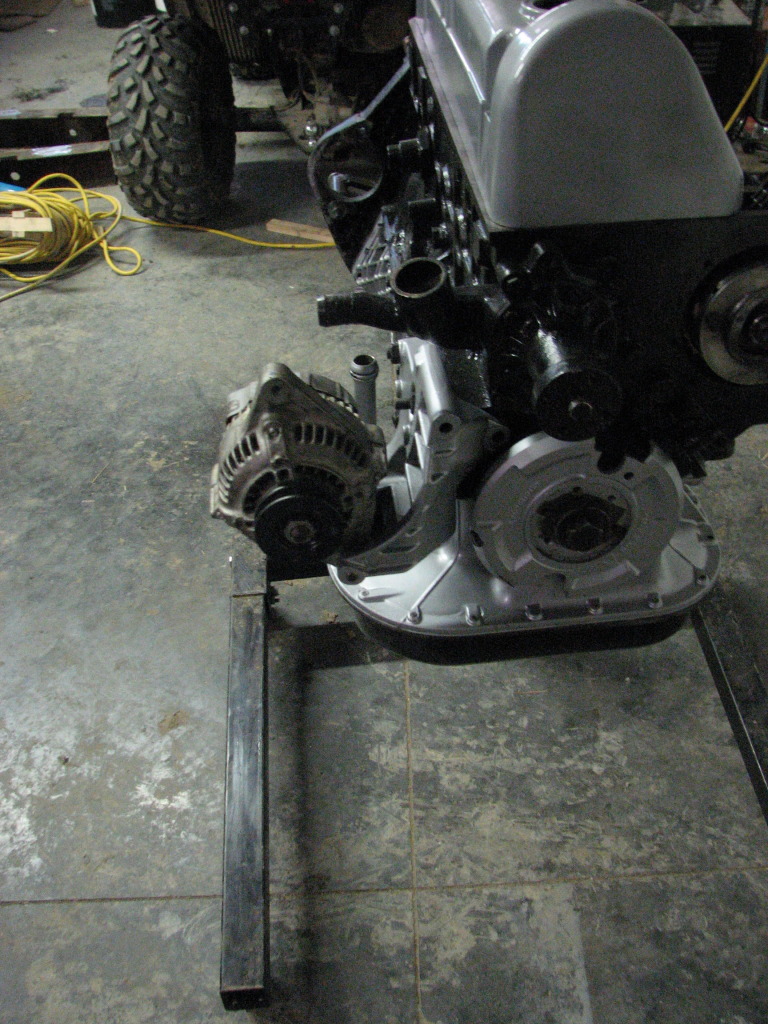

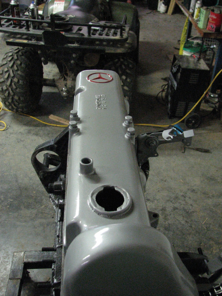

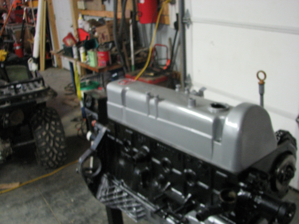

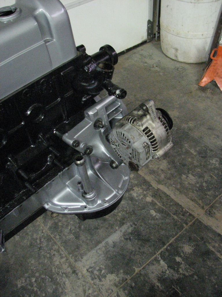

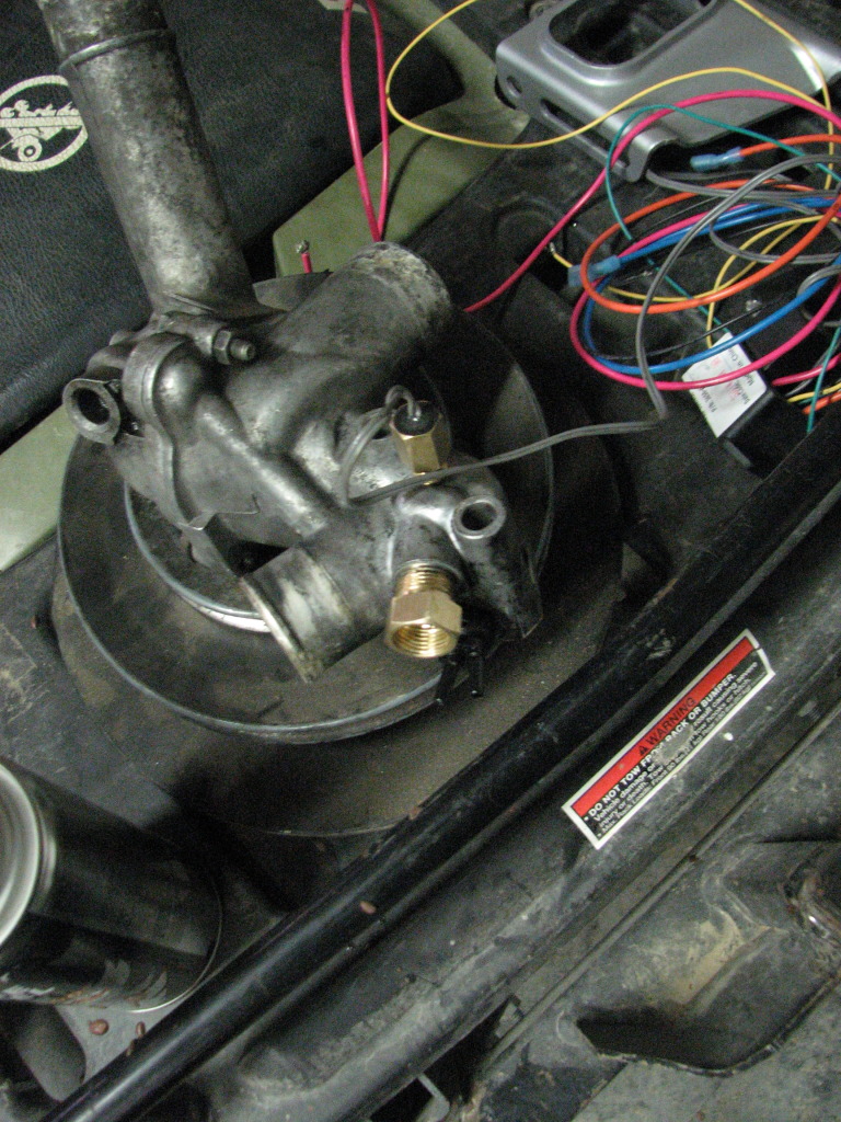

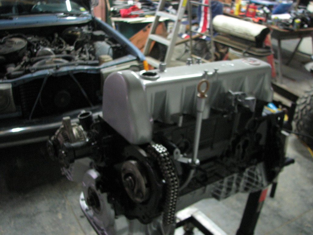

Well I figured I'd post an update for you guys. My new valve guide should be here tomorrow and I am hoping to get the head back then I'll have to wait and see. In the mean time I have been buttoning up all the loose ends I can. I got the alternator bracket on and I am going to have to fab up a top bracket for the alternator as the stock MB one is much too short. Here are some pics of the progress.
Here is some pics of the valve cover I finished.
Here is some more painted parts.
Lastly here is the water neck drilled and tapped for my fan controller and mechanical temp gauge. It will get painted tomorrow.

Wow, wish my engine looked that good lol. Nice work!
