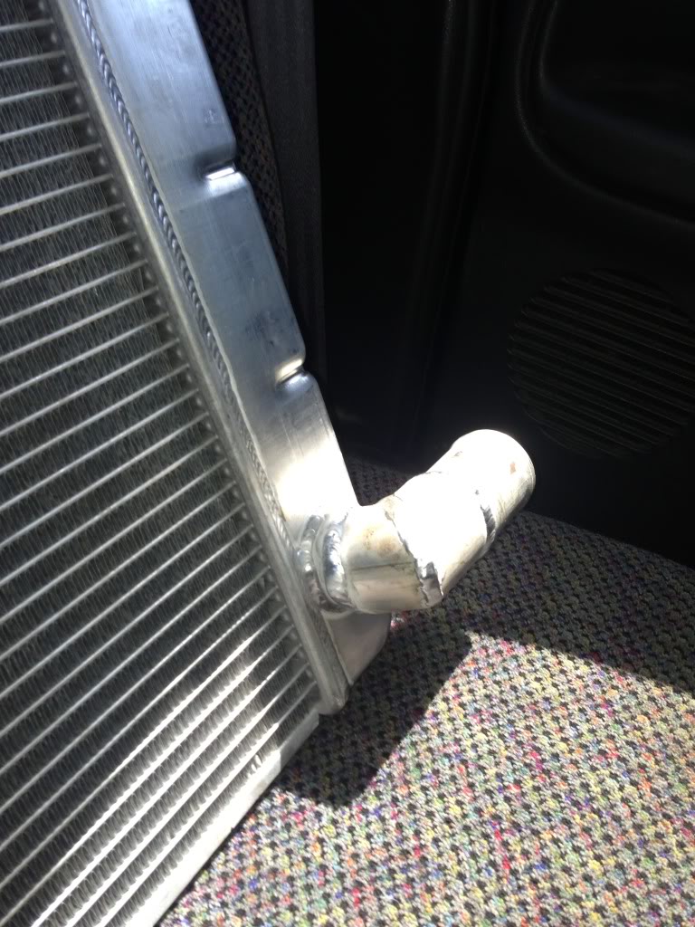

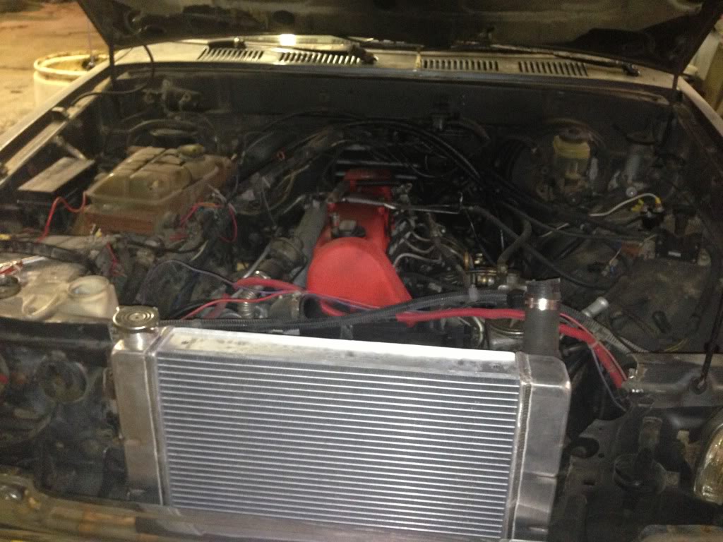

technojunkie- She's fine. I was on the way to the machine shop and I started smelling coolant a mile or so out. I just limped it on there . The temp never went over 180. I'm going to order an aluminum radiator when I get some money together.

I finally have a radiator on order for my truck. Hopefully it will be back on the road next week. I miss having it. I ordered a little bigger radiator so hopefully it will cool a little better. Im debating on playing with the pump a little more while I'm in there, but I'm pretty happy with how it is for now. I guess I'll see how much time I have next week.
