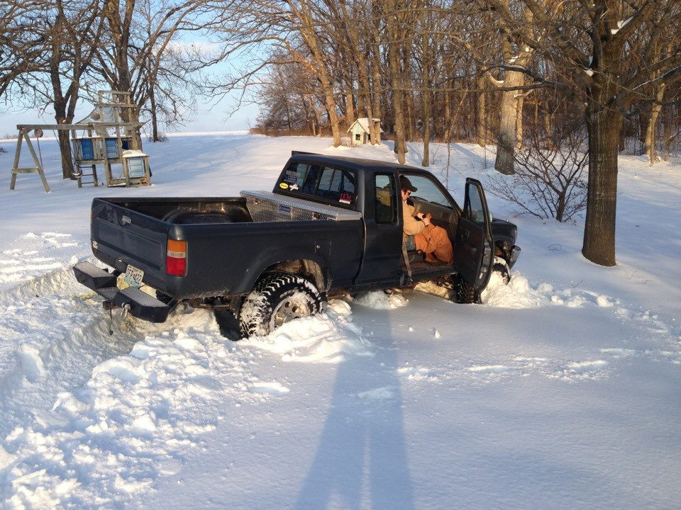

Life around here has been pretty busy as of late. We got a pretty decent amount of snow a few weeks ago. I managed to bury my poor yota in the front yard pretty bad.
What that picture doesn't show is its high centered on a drift. It was floorboard deep on the other side. The shop has been pretty busy and I actually got another Yota in for a rear end rebuild.
