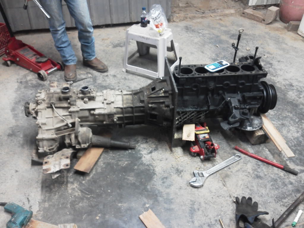

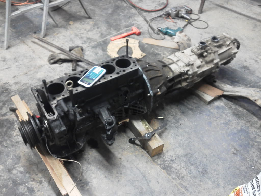

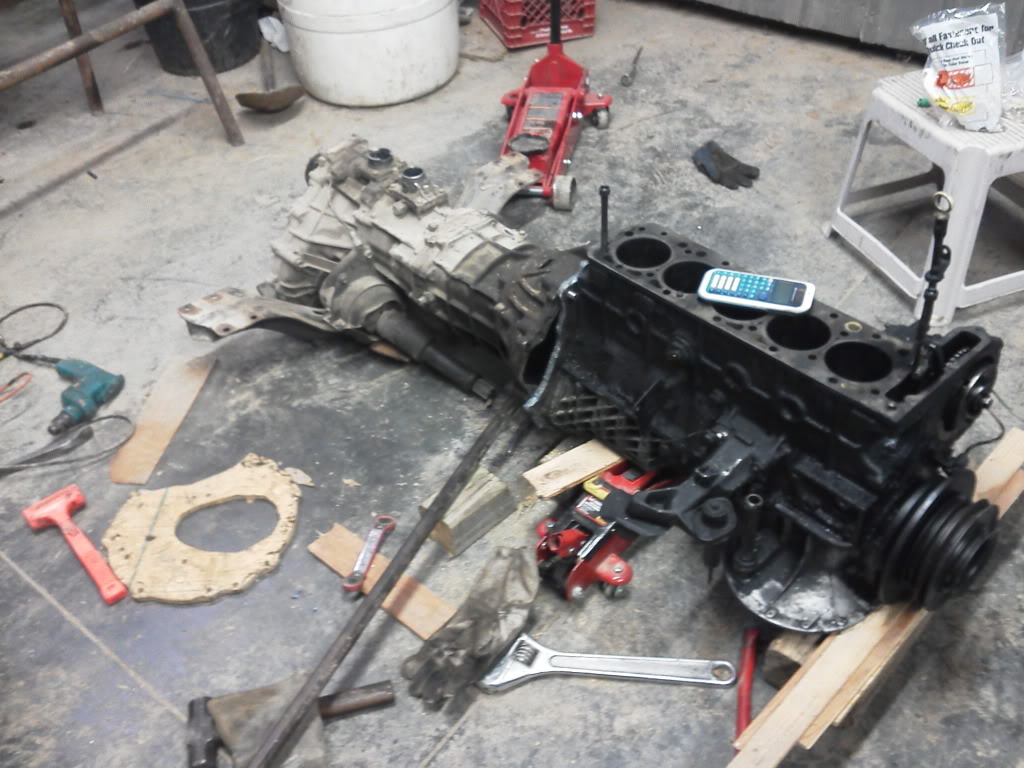

hey powerstroke do you have any pictures of the trans bolted up to the engine?

Hybridgix- I have a few but they aren't good. When life slows a bit I'll grab some in the truck. Name:  IMG_20111222_192209.jpg
