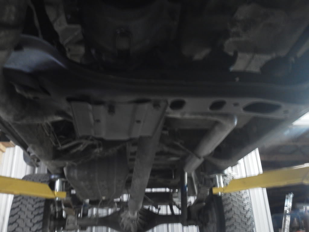

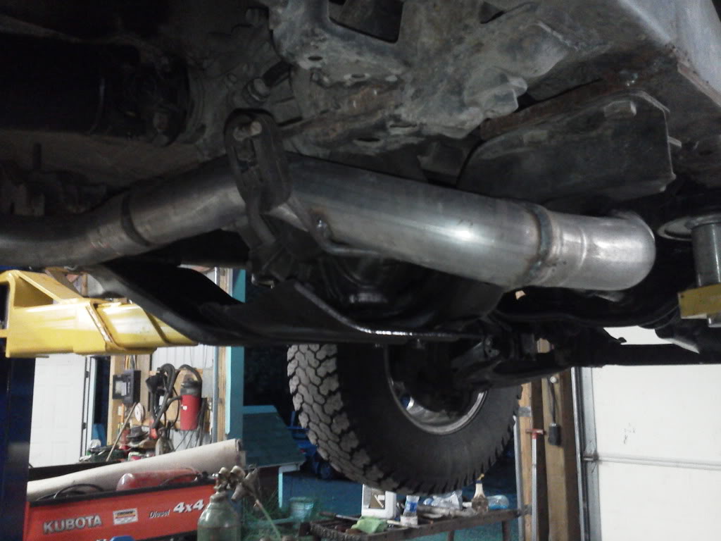

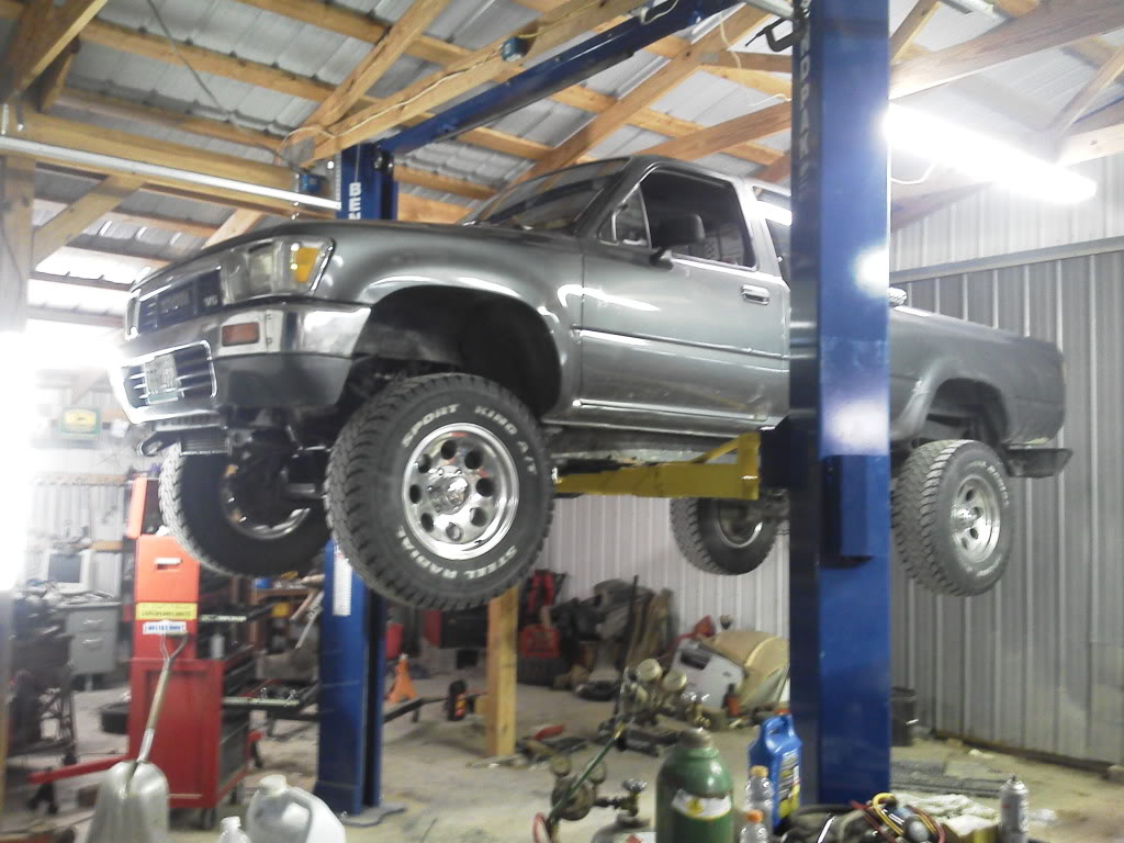

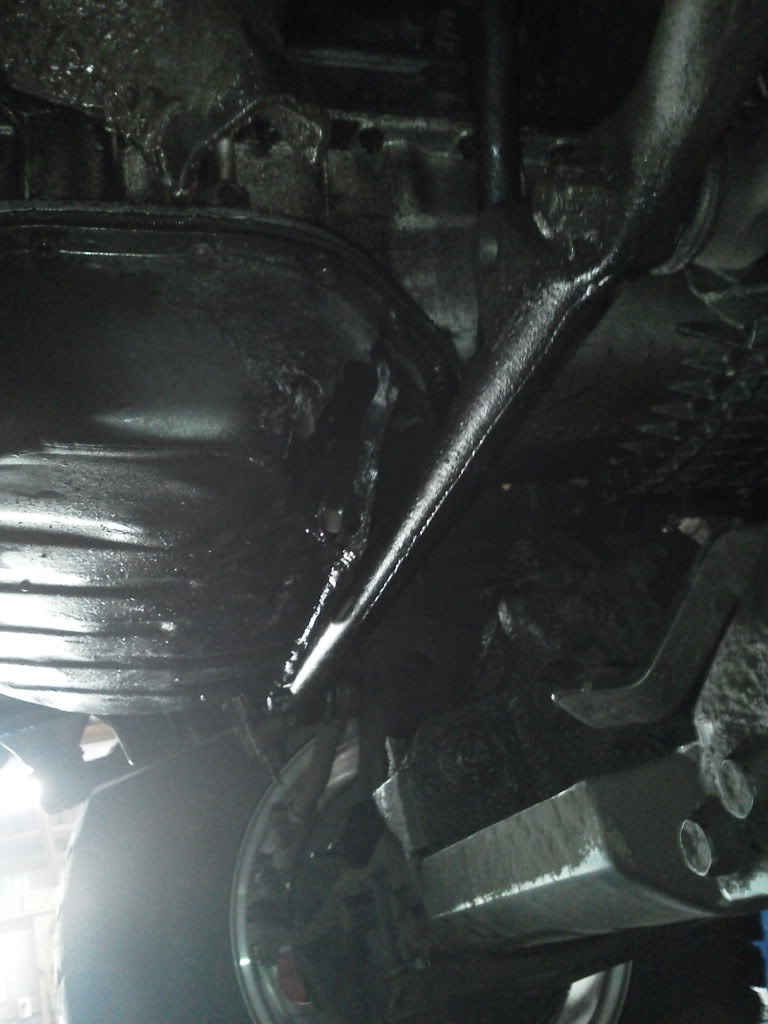

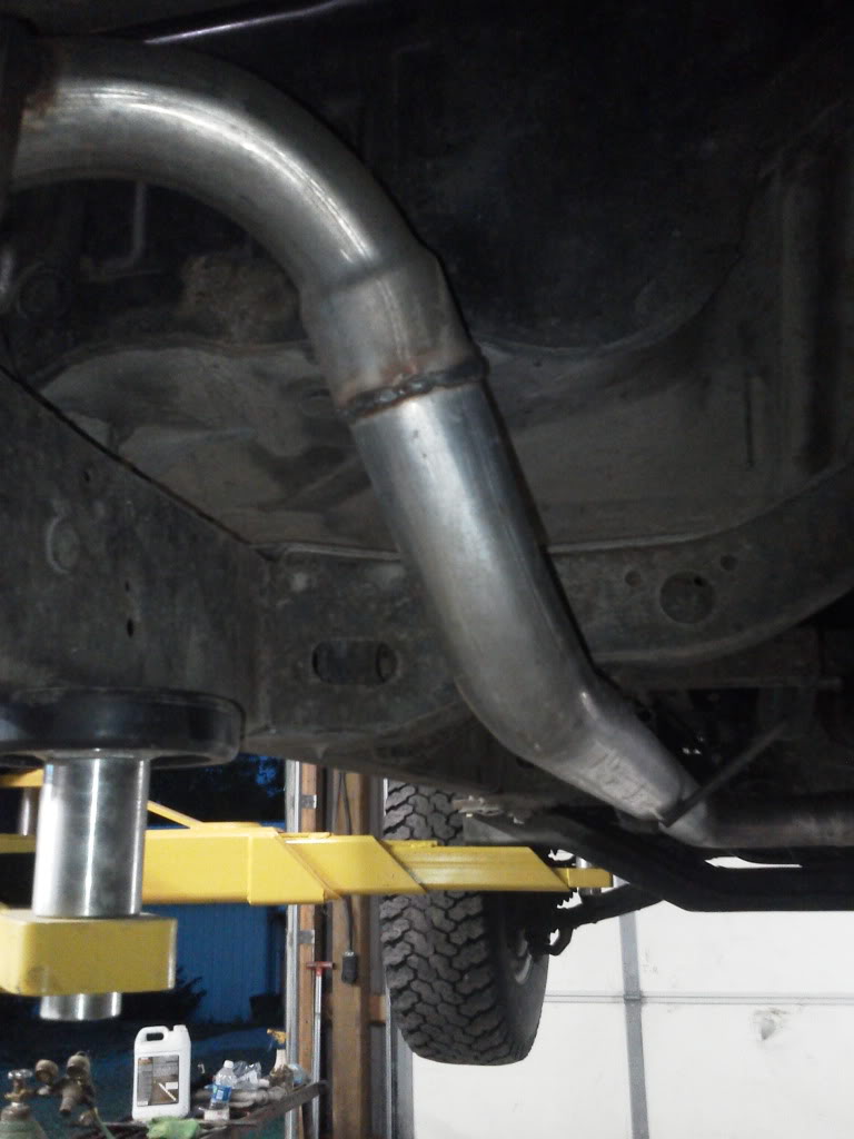

Well I figured I'd post a little update. The truck is still running great. The only issue so far has been the speedometer cable which broke about a month ago and I still haven't fixed. I have ordered an extension from Marlin and am trying to track down the stock replacement cable as well. I've also had a few return lines come off the injectors which makes a royal mess. I guess I got a bad batch of line because the rubber portion seemed to crack. I replaced most of them again and it seemed to correct the problem. On another interesting note the truck made a small appearance in Diesel Power magazine which I thought was kind of cool. Name:  IMG_20120825_232904.jpg
I got a new toy for the shop a few weeks ago......Name:  IMG_20120809_203636.jpg
so I finally got some good shots of the oil pan clearance and exhaust.
Oil pan clearance complete with the aftermath of a loose return line.
