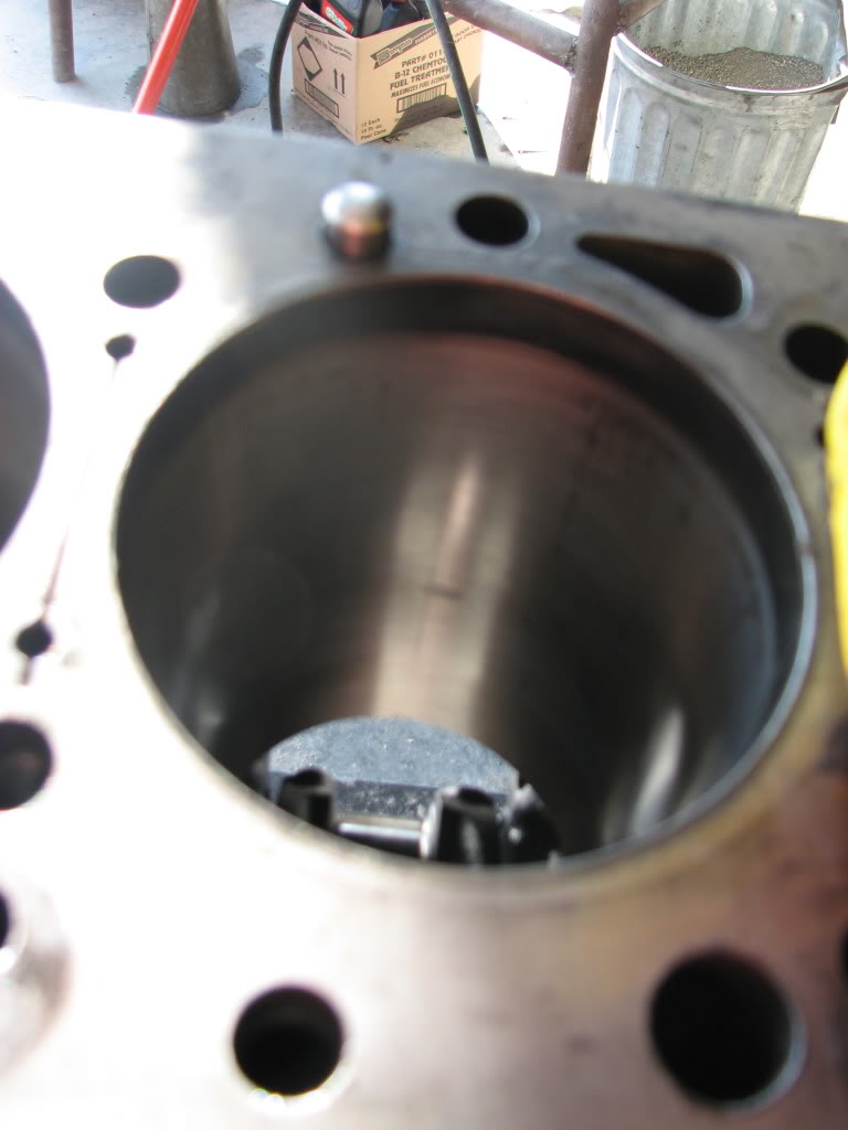

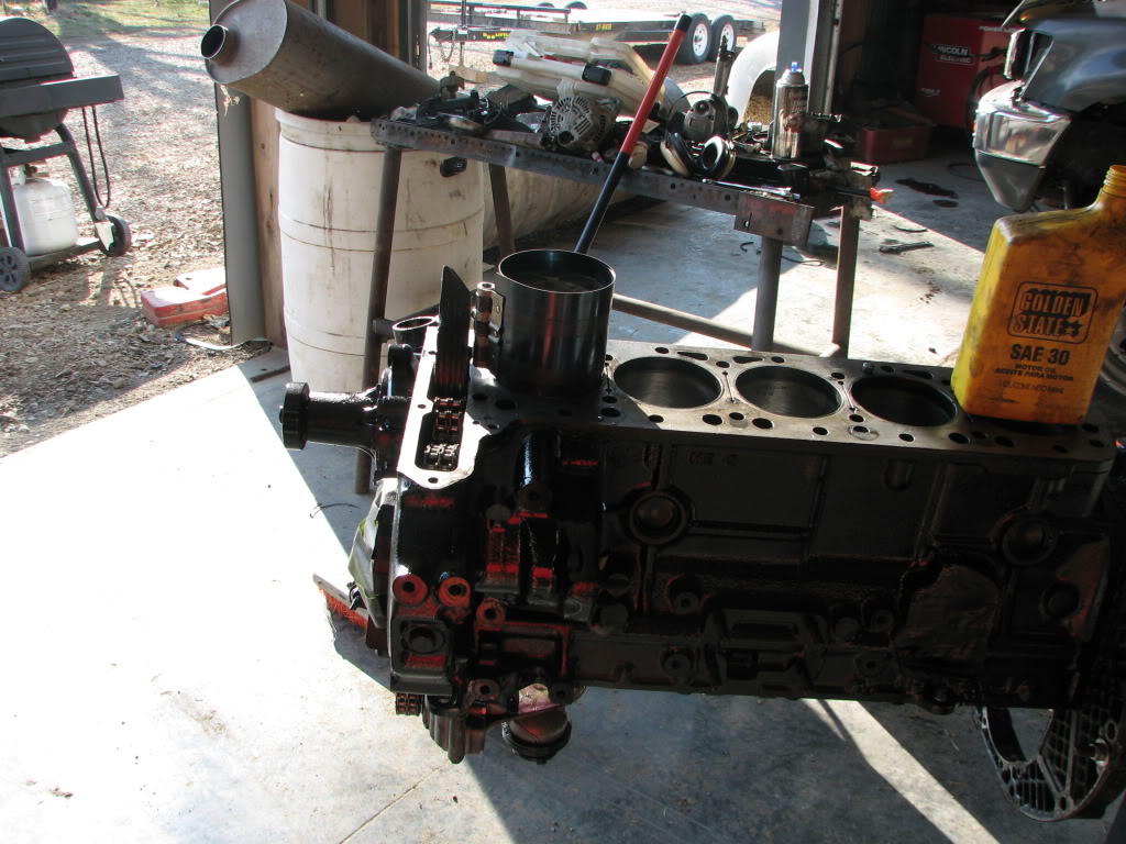

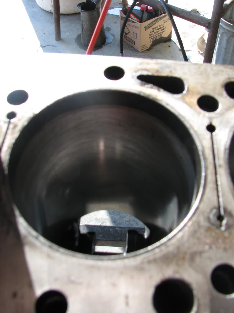

Well I have all the pistons in the block and the rotating assembly is put together. I plastigauged all of the journals and I have around.0025 clearance. Max spec is .0032 I believe. I am going to hopefully get the pan painted tonight an start putting it back together. Here are the pics I have as of now.

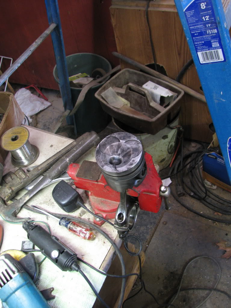

Here is a piston before it went in.
Putting a piston in the block.

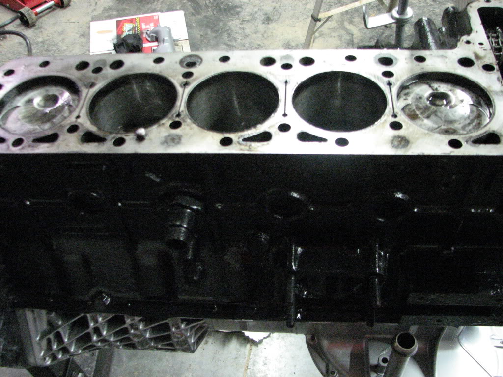

And a couple pictures of the bores.

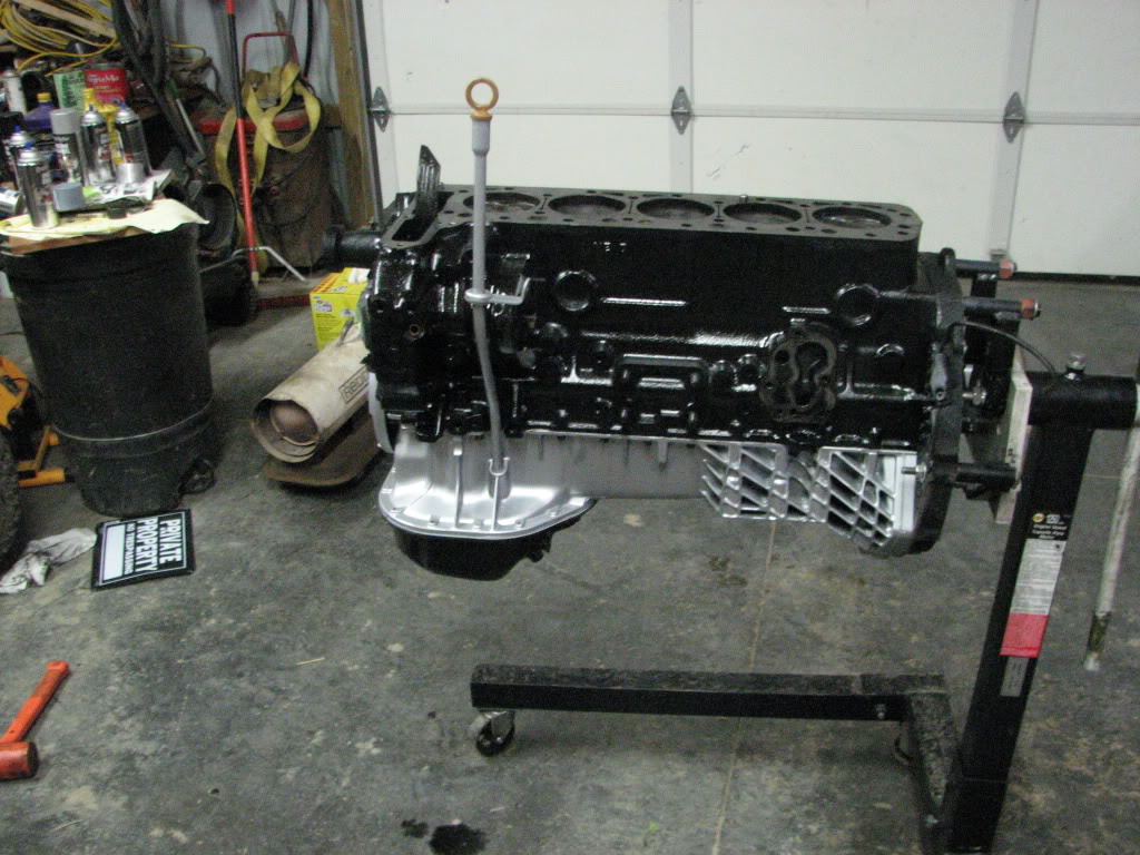

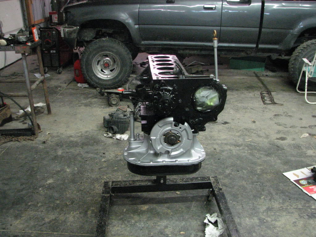

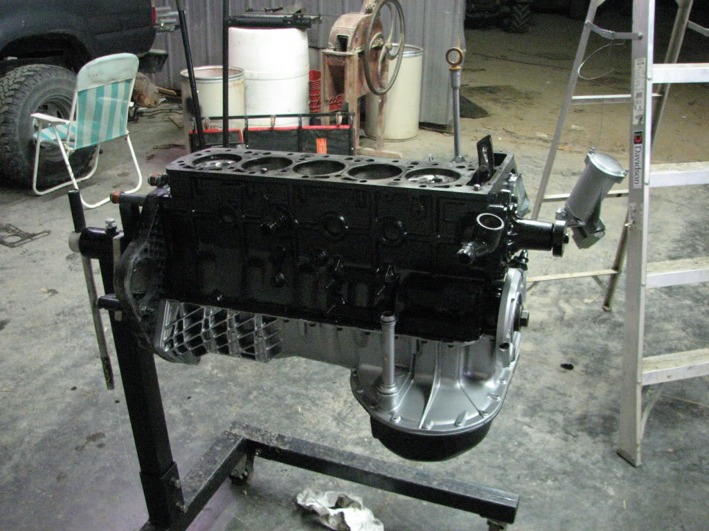

Well I have the rotating assembly finished and I just got the oil pans put on and put the harmonic balancer on. I also did a ton of painting. Here are the pictures.

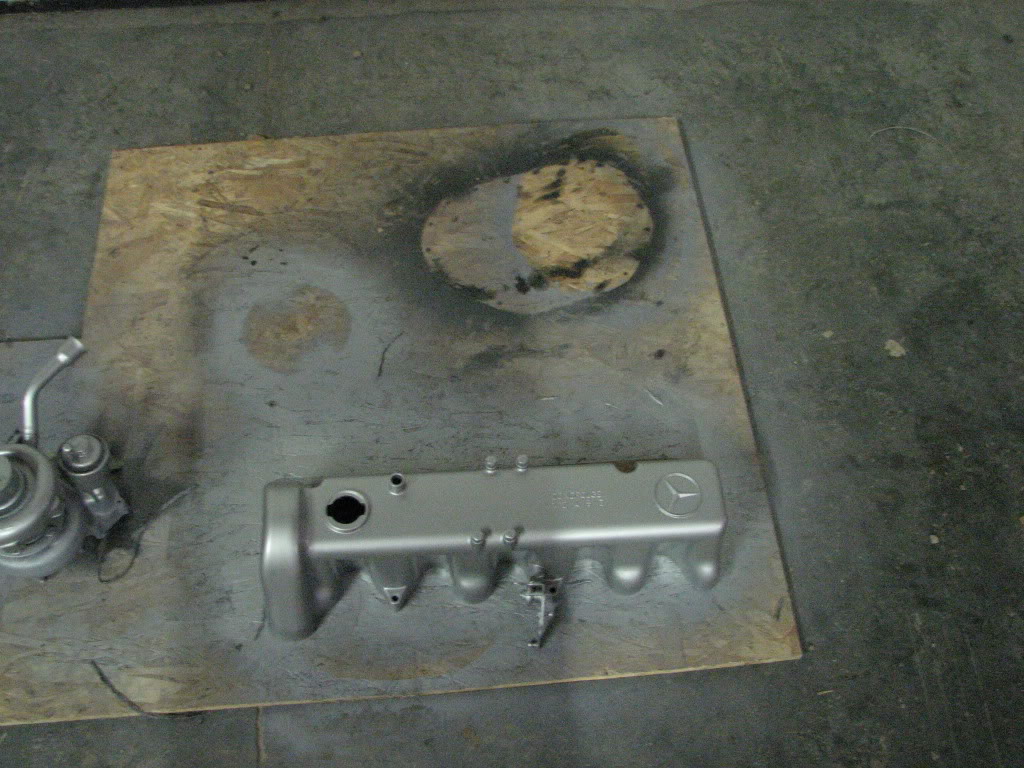

I am going to paint the star on the valve cover. I haven't decided on what color yet. I am debating between red and black. I'm not real sure. If any of you following this have any ideas throw em out here. Well that's all I have for today. I had a long day at school I think I'm gonna crash.

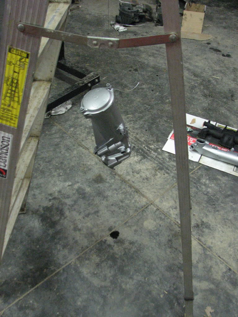

Maybe go with black to match the engine...

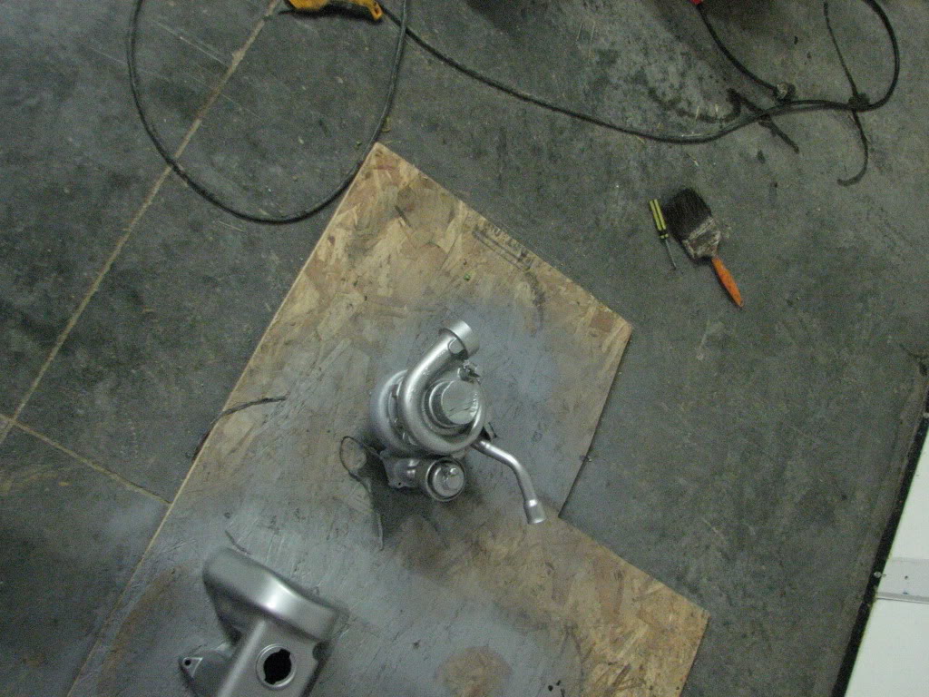

Hope you used high heat paint on that turbo... be prepared for some smellyness for the first few days as it bakes on... lol
have you hand spun it a few times yet?

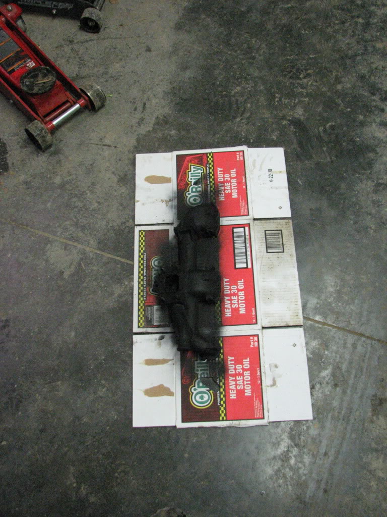

Aviator- I think thats what I am going to do. The whole engine is primed in extreme heat paint I believe its good to 1500. The manifold and hot side of the turbo are painted with the same stuff. The rest is engine paint good to like 500. On a side note. My cousin had a grill/ smoker he built that burned in a shop fire that they had recently. I helped him clean it up. It was a pretty sad ordeal lost like 27 classic tractors a Ford Model A and 2 model T's and a bunch of stuff. Thank God no one was in it. The fire marshall said it was the hottest fire he had ever seen. It was a steel framed building and you can see what happened. Anything other than steel was either gone or a puddle on the floor.

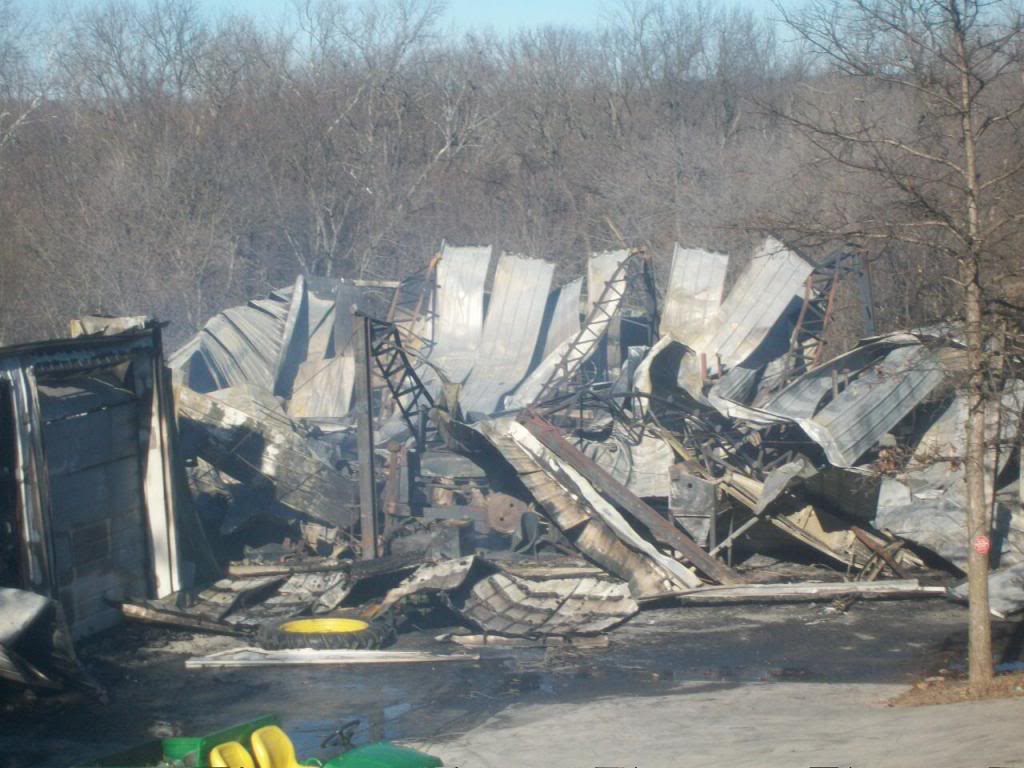

Oh man... so sorry to hear about your cousin's loss... those classics are irreplaceable and their loss is a sad sad event... glad to hear no one was hurt...
So the grill was good to go after getting all the fire fighting goop out of it? that maybe something...

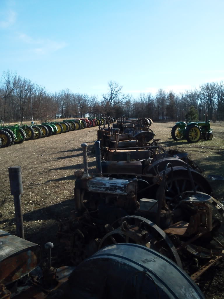

Yeah they had some real rare stuff in there. There was a fully restored 1940 Ford coupe and a couple experimental John Deere's from the 1920's. As well. What the real blessing was that he had some friends over the night before and they were going to sleep in there but decided not to. The grill was fine it just warped the frame it was on. As far as the tractors they are hit and miss. The ones that had antifreeze in them seem to be ok. The ones that didn't there is nothing left. The radiator cores that had no antifreeze in them all melted as well as all of the magnetos melted some of which are irreplaceable. The tractor you can see in the picture has over an inch of sag in the main frame from the heat. It was in the shop where the fire began. If it tells you anything there was a 45 minute gun safe in the shop as well and all that was left was the shell. It burned from the inside out it seemed. Here is a picture of the tractors we drug out last week. The painted ones came from a different shed.
It's a pretty bad deal but they are rebuild as I write this and plan to fix the repairable tractors.

Damn that's quite a collection your cousin has there... good about his buddies but on the other hand if they had been in there maybe the fire would have been caught sooner...
the 1940 ford is probably replaceable there are enough of them left around and the after market supports them so well you could probably build a whole new one...
the experimental JDs not so much... don't give up on the other ones though... the rads can probably be custom fab-ed by a good rad shop and the mags? hmmm... you might try a look at some aircraft magnetos... the technology in some of them is really old school and you might be able to adapt them to the purpose... sure it would'nt be all OEM original but it would be functional...

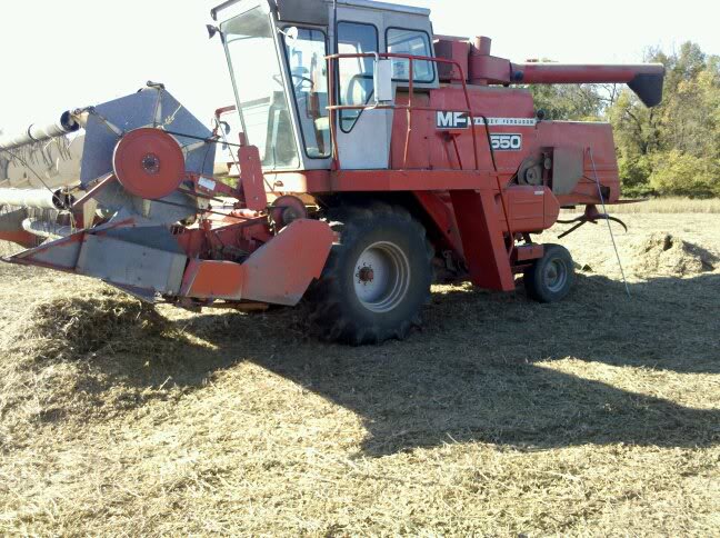

Joe I have to be honest I have run several newer Massey Ferguson tractors and I am not a huge fan. That being said We bought a new Agco/Hesston disc mower last year and it has been great. I much prefer the older simpler equipment to the newer stuff. We have an old 966 IH that is probably my favorite on the farm.
Amen to that Aviator! Thanks that combine was a true barn find. It's a 1981 and just turned 1300 hours. Those rollers are actually plastic irrigation pipe that is put over the wooden bats.It prevents the bats from knocking the soybean pods open in real dry conditions. If you happen to find some that would be awesome. I know my grandpa would get a kick out of them.

only 1300hrs original? heck it's still getting broken in... so that's a soybean combine eh?
the pipes cushion the impact of the bats and prevent premature opening of the pods eh? hmm I learned something new today... makes it a good day
I "drove" a combine once at my uncle's place in europe in '75 ...it had a grain head on it... open cab, no railings between the operator's deck and the head... I was 5... freaky to be steering the thing with the head spinning away right "there" in front of my nose...
