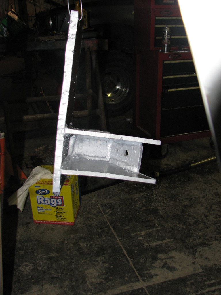

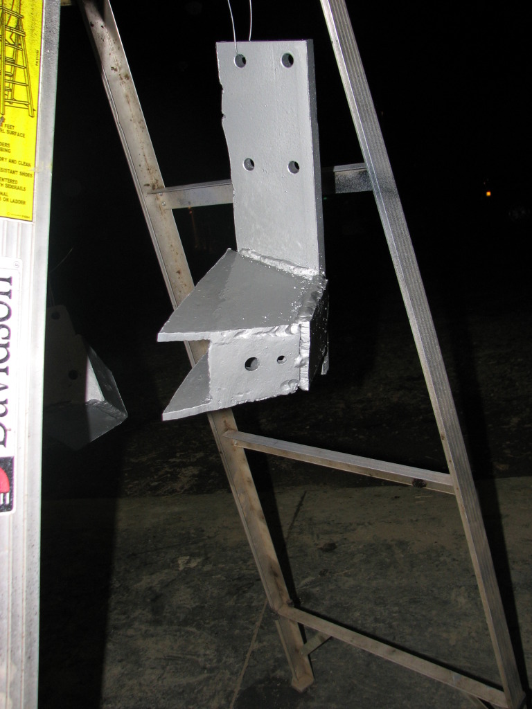

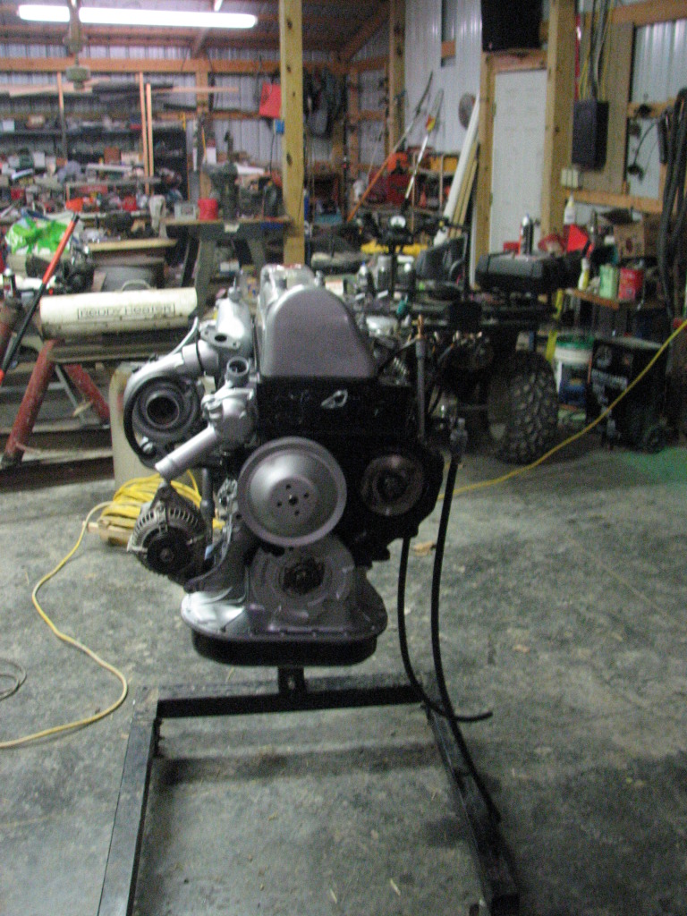

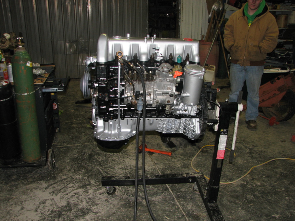

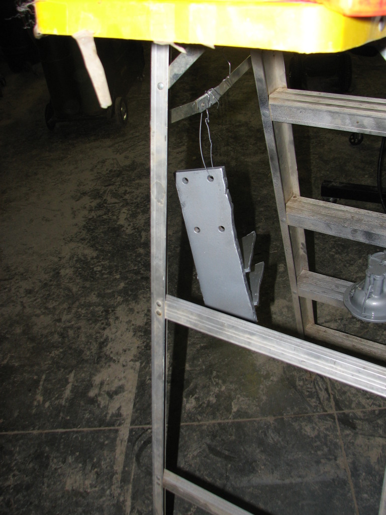

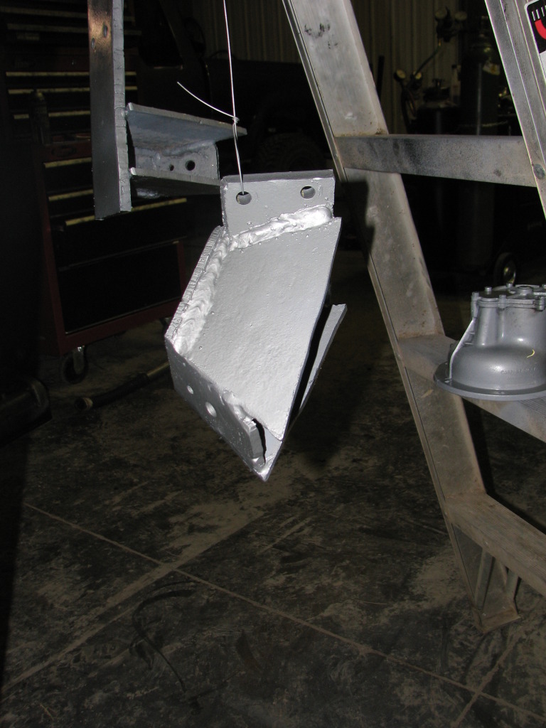

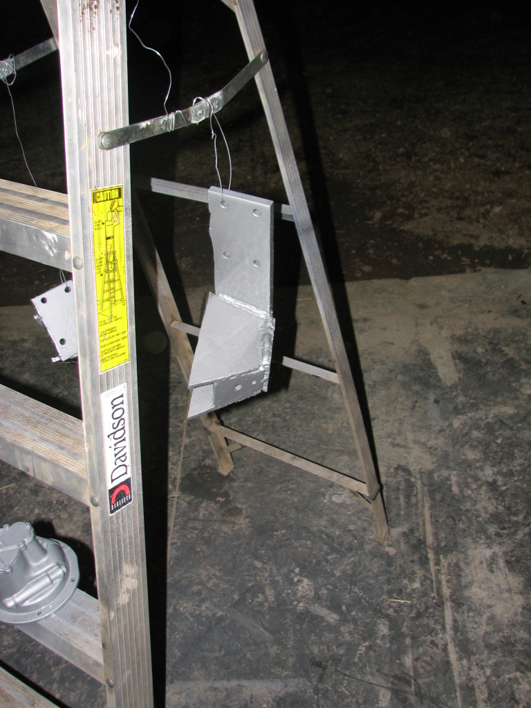

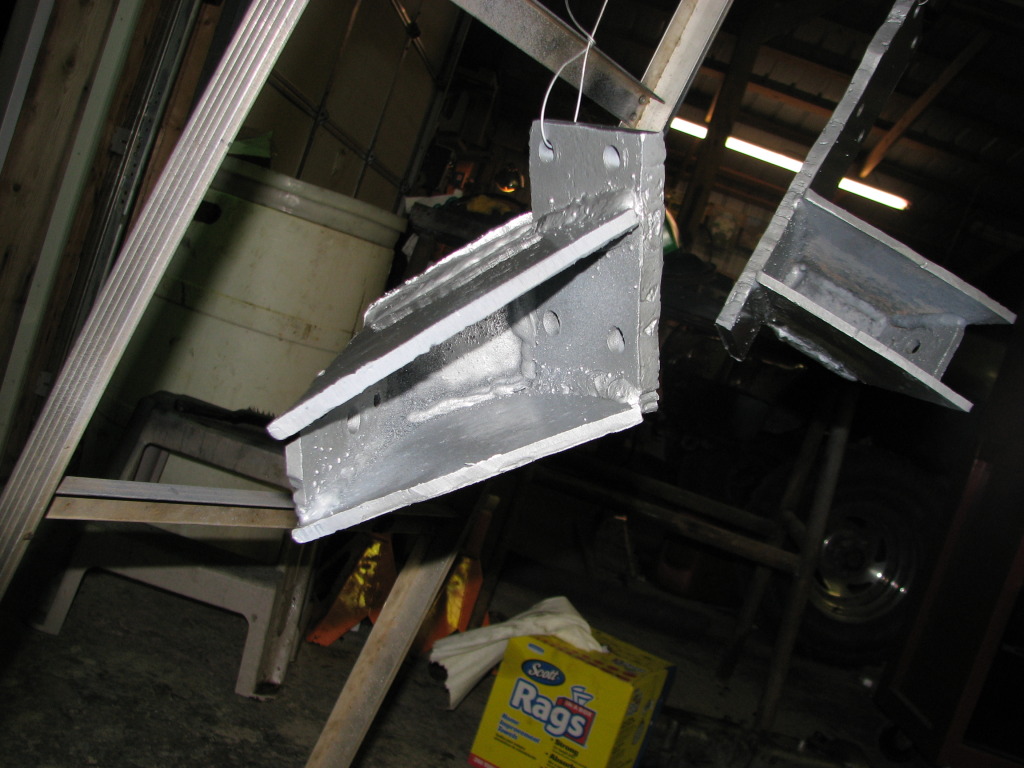

Well guys here is today's update. I have really enjoyed reading all of the discussion above. Ive learned a lot from it. I finally have my engine most of the way back together. I am going to try to fire it Thursday. Here are the pics. Name:  Toyota073.jpg

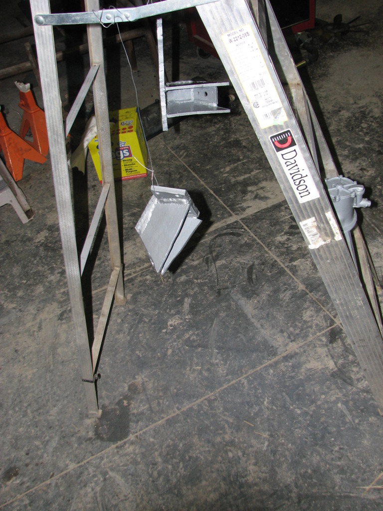

Here are the pictures of my motor mounts. They aren't pretty at all but they are sturdy.

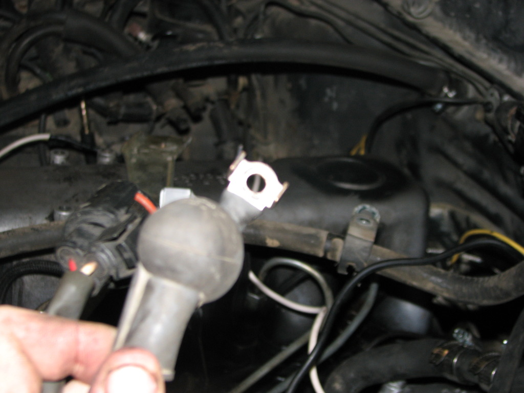

Well I have the truck pretty much rolling. Just a few wiring things and stuff like that. I still haven't gotten the shutoff figured out. Does anyone know of a key on power source that stays on during cranking. I ran my gauges off the clock but I hate to use that to power the shutoff solenoid as well as the key on for the fan. Also I have a wire that I can't figure out where it goes. Name:  004.jpg
Size:  144.6 KB Its in the driver side fender. Thats about all for now. I had to cancel my appt for the exhaust in the morning as I blew the 80 amp main fuse and no one has it.

If you haven't removed it already, grab the ignition wire to igniter for the stop solenoid.

Not sure what that wire is. I don't really have many in my '86.
And I put oil in my cylinder, but the cold compression only went from between 120-140 up to 190-200. I hope it's a valve instead of rings. And thanks for that, I forgot about not having any blow by.

nice build wire looks like 22r alternator wire
