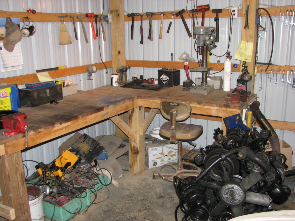

I couldn't take the mess in the shop anymore so I took this afternoon to clean the crap out of the whole place and put all my tools back. I needed to get a place to put my truck back inside too. I moved the engine back to my work bench so I would have a place to lay all of the parts out in an orderly fashion.

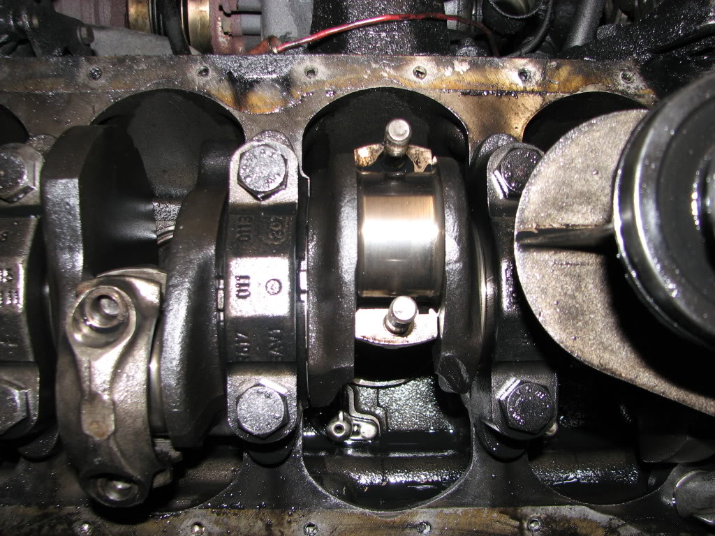

I managed to get the picture of the crank journal off my phone too.

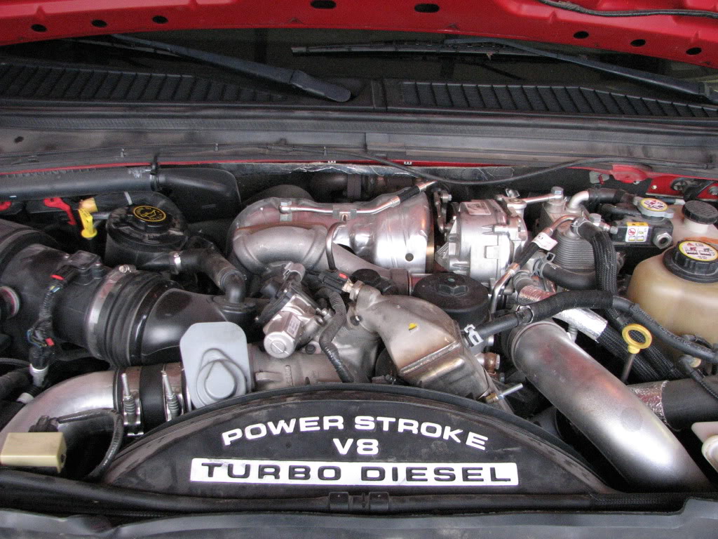

While I was on a roll I changed the oil in my Power Stroke. I hear people talk about how tight the 3VZE engine bay is...check this out..Name:  IMG_1215.jpg
