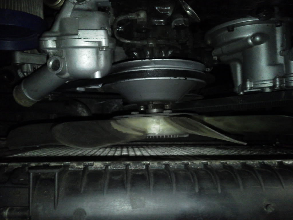

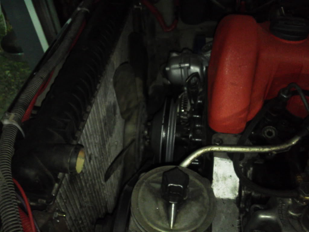

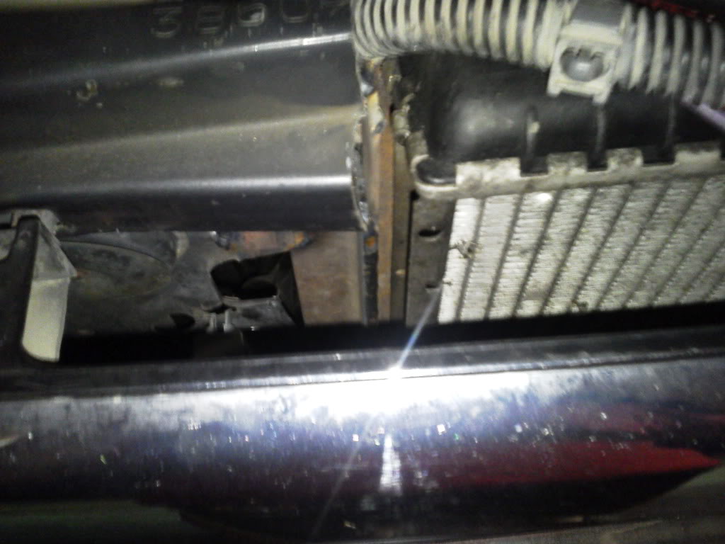

Here Is where I am at as of now. I'll let the pics speak for themselves.

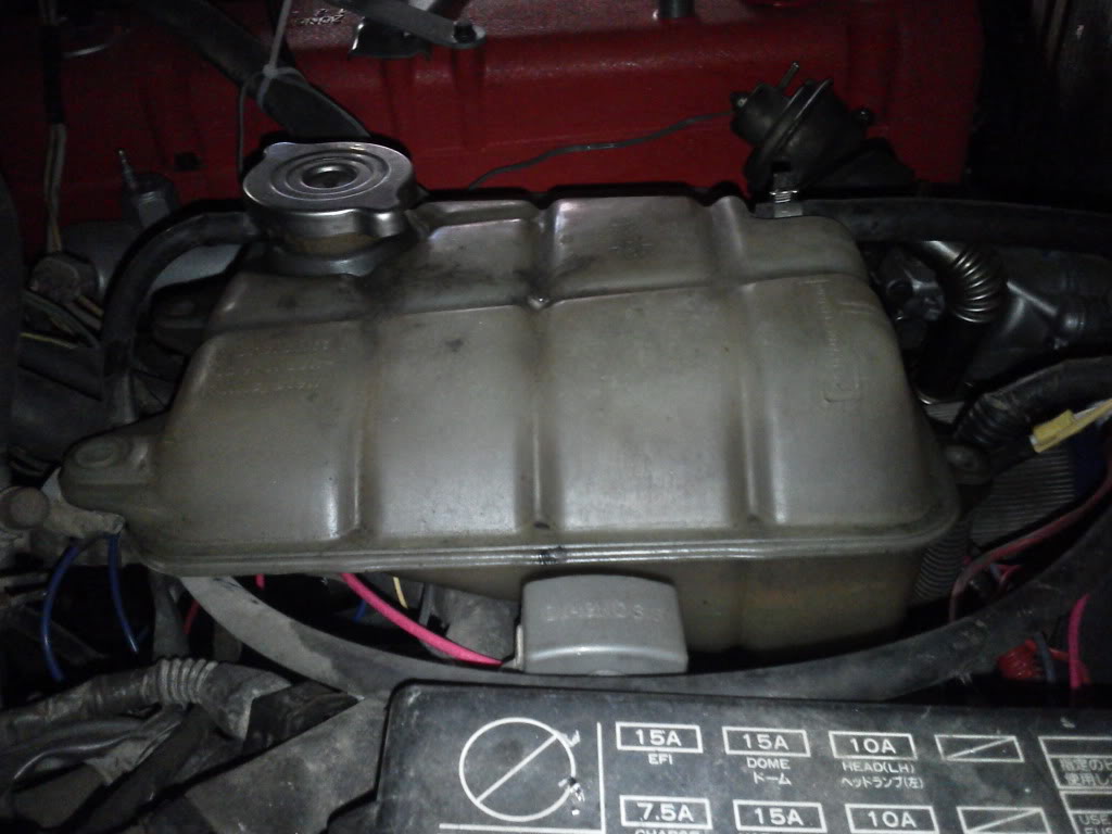

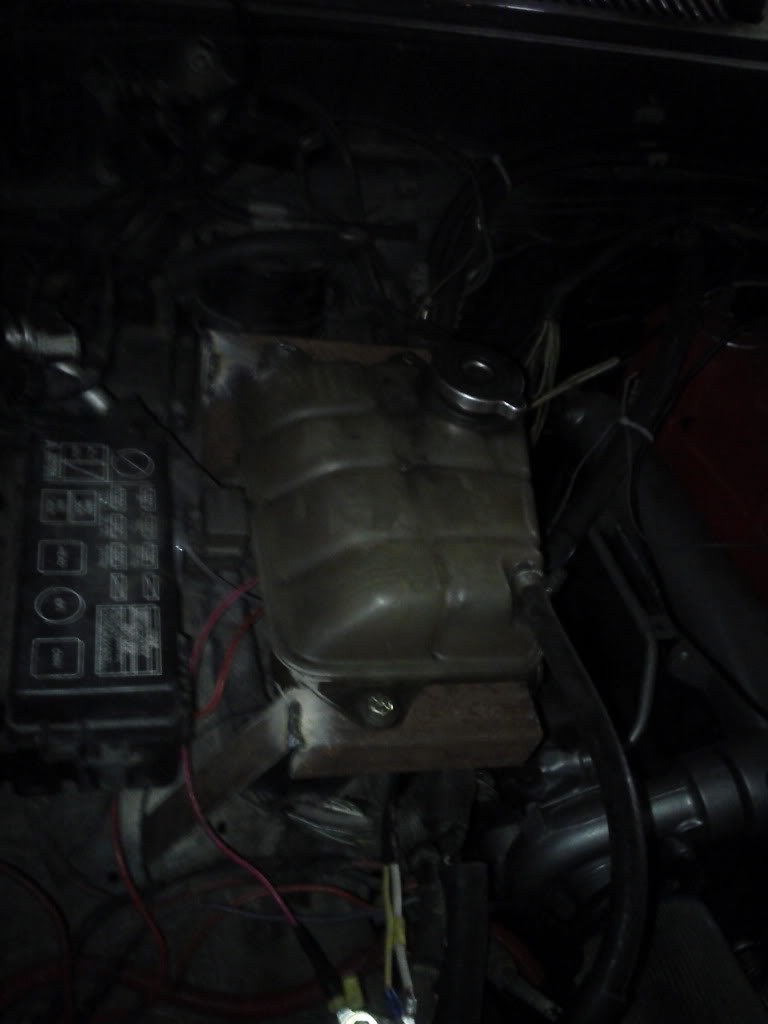

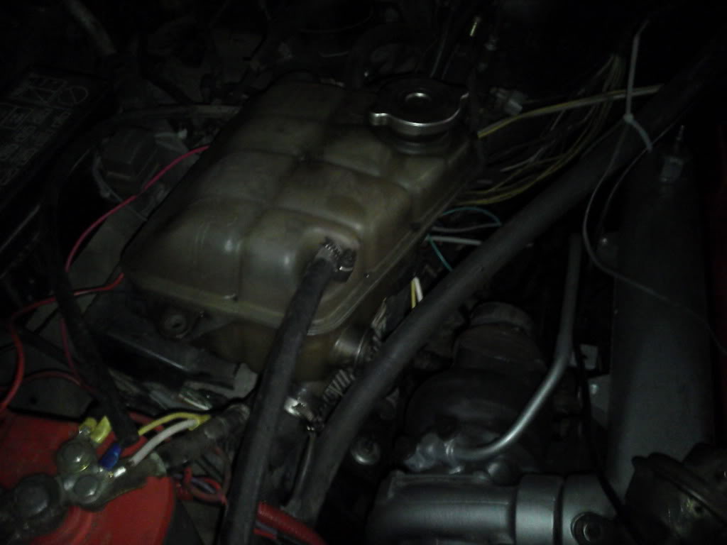

I have plans to tie the two sides of the core support together yet so not to stress the radiator. I went and pulled the Surge tank out of the parts car and I think I have a sopt that will work what do you all think?

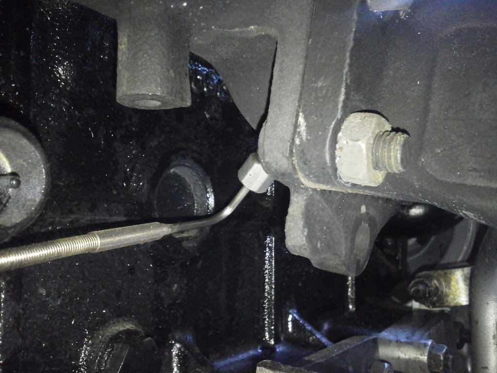

Oh and several people have asked me about my EGT thermocouple so I figured I'd post a picture of its location.

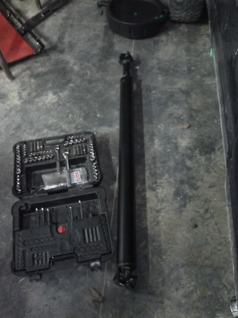

I took my driveshaft to school and the general consensus was to have another one built. They said that it could be split but it probably wouldn't work too well. I think I am going to call a few shops and see what it would cost to have one built. Tom Woods seems to be pretty highly recommended as well as High Angle Driveline. I'll have to see how that plays out.

Looks good, but I think if you motor mounts break your radiator is going to be lunch.

that's gonna be one hell of an upper radiator hose. or can you clock the t-stat housing?

Then t-stat housing goes to the lower rad hose,top just needs 2 90s.

89lc- Yeah it will be but if I break them I have a feeling the radiator will be the least of my worries lol.
irab88- The top hose runs out right behind the thermostat on the top so it will just be 2 90's like Transplanter said. The bottom one will be interesting.
I broke down and ordered a Tom Woods driveshaft tonight. It is supposed to be here Monday. It was almost $400 so I hope its worth it.

My driveshaft came today! I have to give props to Tom Woods he really does some good work. I am going to have to cut the carrier bearing mounts out but thats no biggie It bolted right up.

I also got most of the mount for the surge tank done so I just need to plumb it in and finish up the rad hosing as well as the exhaust where I cut it.

lookin' good joe... is the shaft yoke greaseable?

Yep both of the joints are greasable as well as the slip joint.

Figured I'd post an update as things have been really crazy with school and the farm both picking up. I did get a chance to get everything plumbed back in and I ran it for about an hour. The temp never got over 170. All that is left is to mount the oil cooler and re do my exhaust. Heaven knows when I'll get that done at this rate.
