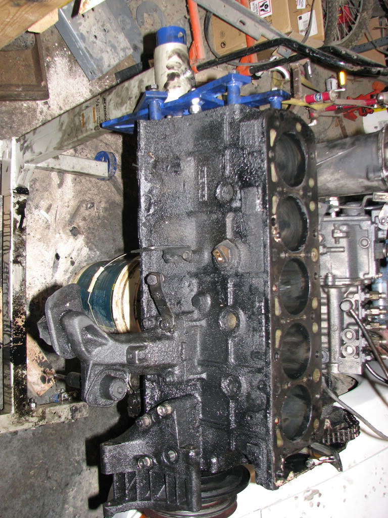

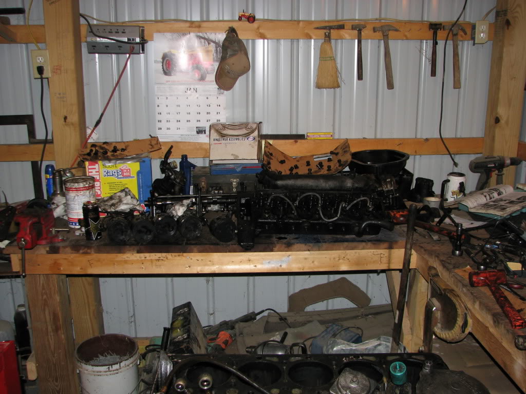

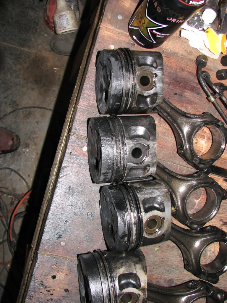

Well I have major issues at this point ... check this out.

Yep I had to tear it down. I found some metal chunks in the old oil and upon inspection i saw some scoring in one of the bores. Well bottom line Cylinders 1,2,3 need re sleeved and I need 5 new pistons. I am going to try to locate a nother engine or I may re build this one but either way I have a ways to go. I did get the pilot bearing adapter made. I'll get more pictures tomorrow but here are a few of my grandpa and a buddy working on measuring for it.

Is it that bad? what about just honing the cylinders and installing new rings?
I see the cyl. tops look a little beaten up... or have they got actual holes blown through them?

Aviator- The pistons are done. The ring grooves are worn way out of spec and the pistons are out of round. Pistons are $300 a piece. I have a line on a couple of engines yet. I am glad I got the car for the extra parts.
PhatFJ- It is sleeved but it would be cheaper just to bore it out oversize as its a dry sleeve and even the new sleeves have to be bored and honed. Thank you for your kind words!
Blake- see my explanation to PhatFJ. Parts for the turbo engine are no longer made and they have to be imported.

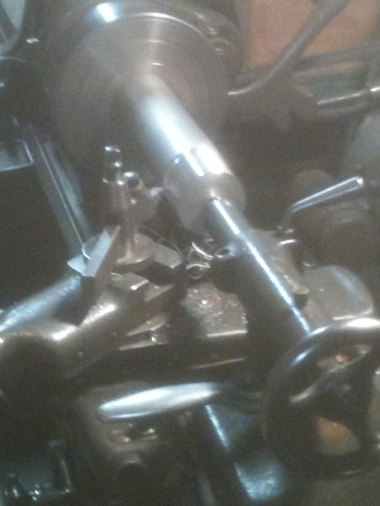

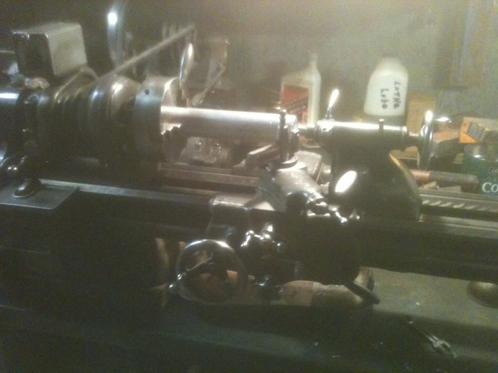

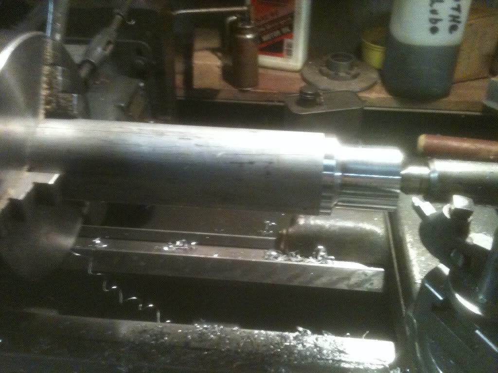

Well I really don't have much news. I figured I'd post up the pilot bearing adapter machining process. I left my camera behind on accident so I had a buddy take them on his iphone.

I'll grab some pics of the finished product later on as Grandpa has it right now because he is working on my flywheel and getting it drilled. I plan to make a trip to the city this weekend and scour every junkyard I can find for an engine. I'll keep y'all updated.
