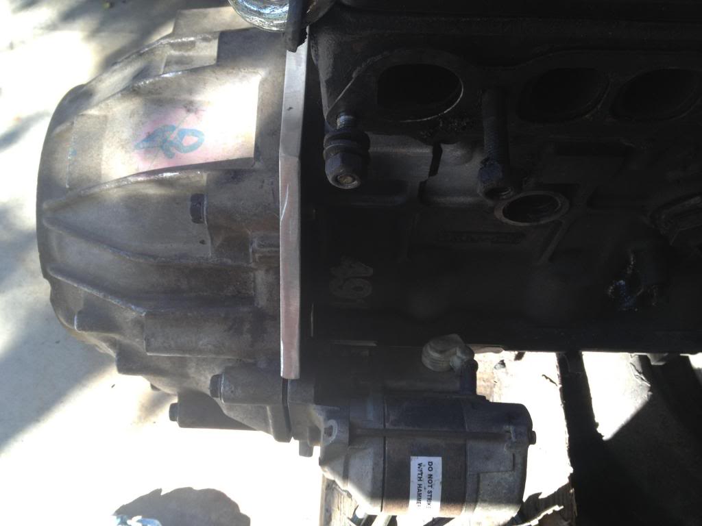

Originally Posted by flatspeed
And..bellhousing on
I had to shim the starter back by about 1/8" with a couple washers, for proper gear engagement.
Attachment 170333
Did you use the stock r150 3.4 starter? in the middle of this swap on the same year tacoma actually and was wonder how big of a battery you were running at the time as well
