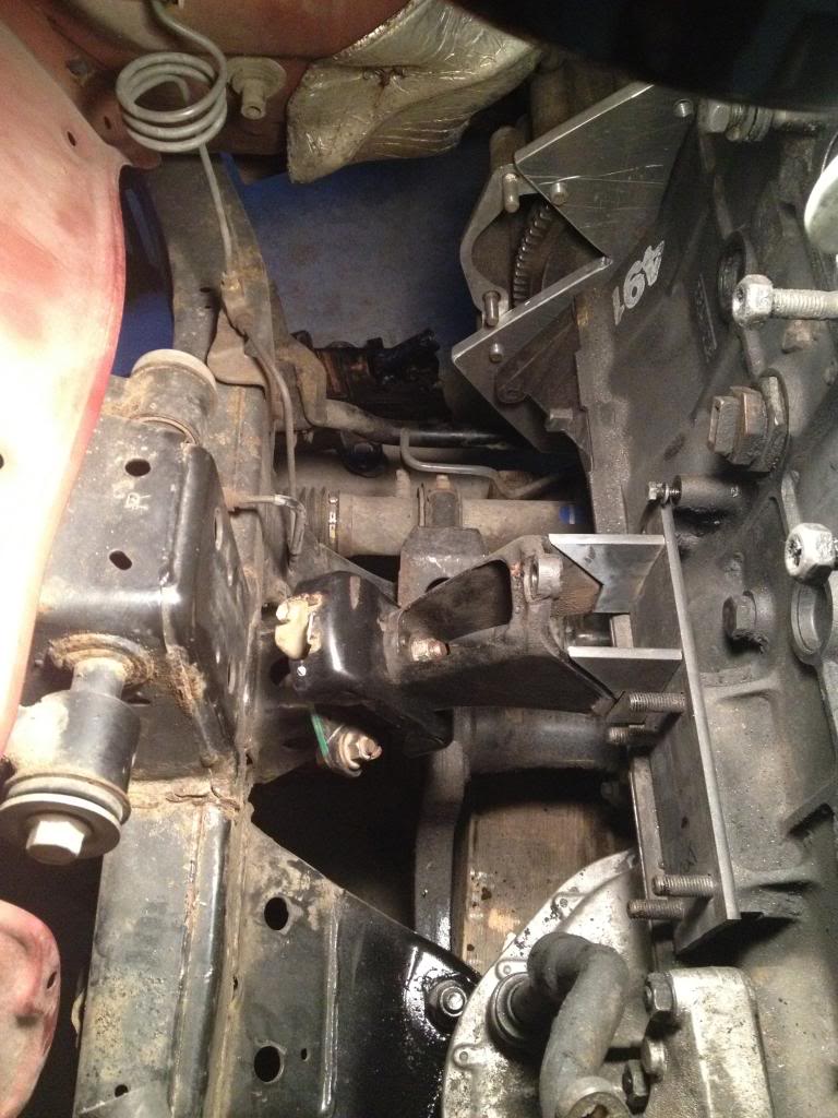

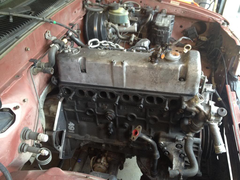

Engine back in. Sitting 3" further back now, with room in the front for a rad! I must have removed and installed that engine about 10 times by the time the swap was done. Cutting the rad support out saved alot of headaches. I ended up bolting it back in after, which will make it easy to remove the engine again if I ever have to..
#24
Finally! I've been prepping for this exact swap for nearly a year, I'm gonna bug the crap outta you with questions.
could you have left the drive train and crossmember alone if you angled the motor/tranny and bulged the hood? (just for crossmember clearance, obviously still have the radiator problem)
#25
I basically looked at every option including clocking the engine, hood scoops, modding the oil pan..etc.
Cutting the crossmember was by far the best option, and turned out to be easier than I thought.
The engine sits level, the hood closes properly, and the rad fits but not by much. Also, if you were to not move the drivetrain back, you would have huge issues with getting a rad in there. It would be in place of the grill and bumper, then you'd have to throw a pusher e-fan in front of that still. Not happening. I did 3" back, because any further would have pushed the transmission into contact with the tunnel, and you can't lower the transmission and engine TOO far, or else the bottom of the engine hits the diff.
Hope this helps.

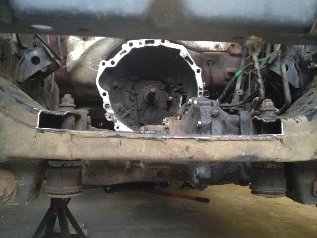

#26

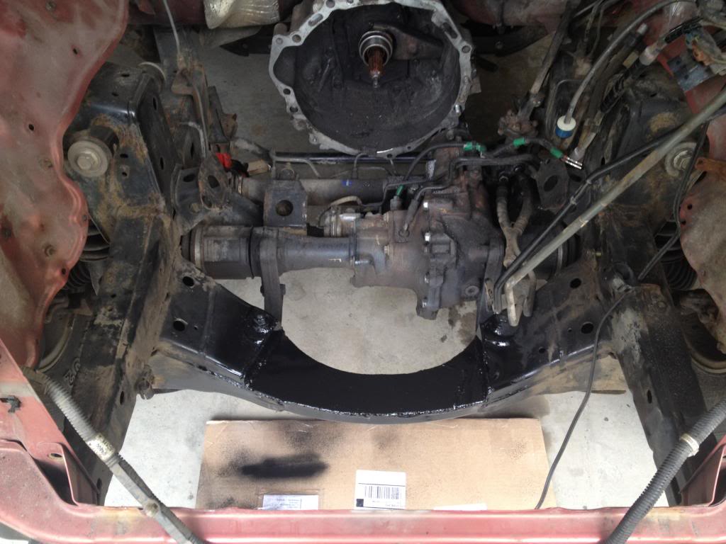

Here is the crossmember after I cut it.
I basically put the engine in with the oil pan resting on the crossmember, as centered as possible, and traced out the oil pan on the crossmember. Then I added a half inch on either side and cut it out. I would probably do a little more than half inch. 3/4" to be safe, because when you weld plates back in, you lose a bit of clearance, and I forgot to take this into account, as well as the soft engine mounts letting the engine rotate a bit under load. (once in awhile accelerating in 1st gear it contacts the side of the oil pan, so i'll have to pull the engine again at some point to cut it out wider)
#28
After the crossmember was cut, I put the motor back in, resting on some wooden shims (to take into account that the engine would settle a bit on the rubber mounts) and made the engine mounts. I reused as much toyota mount as I could. The rest is 1/4" steel plate.

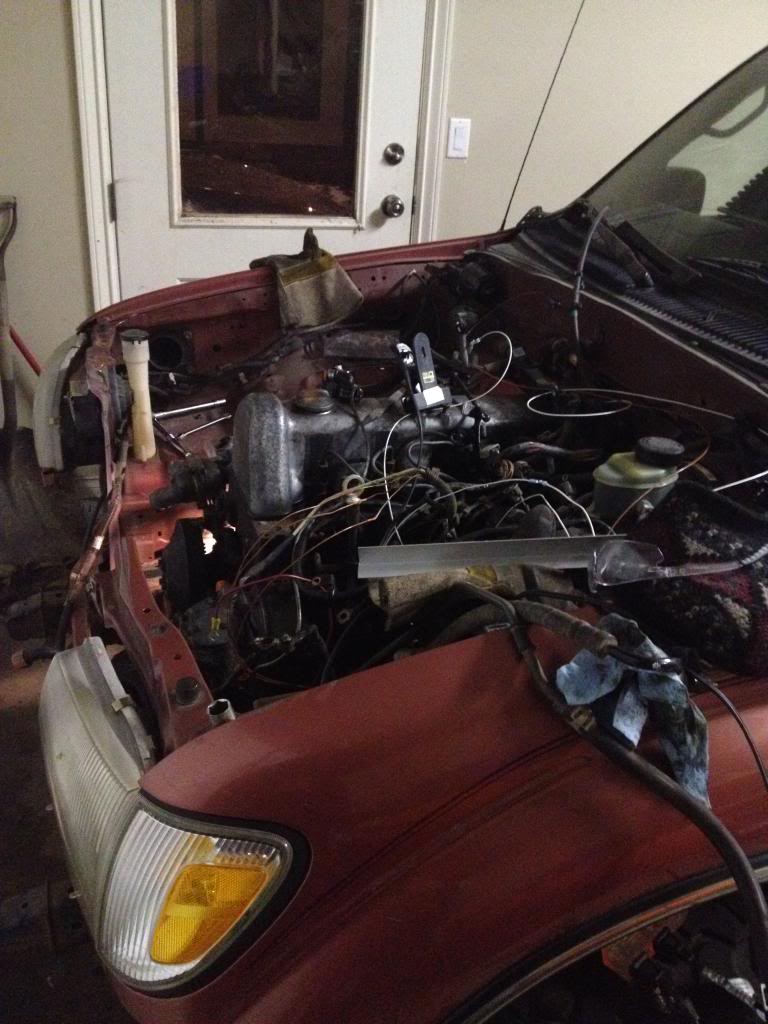

#32
I put the toyota wiring harness back in and wired in the glow plug relay. Most of the tacoma connectors are unused, and I plan on cleaning it up. someday.
I got really frustrated because sledding season was looming and I wanted to be out there shredding pow, not working on the truck. So I did the following but didn't take pictures (If anyone needs pics of what I did, i'd be happy to post some):
-Routed the throttle cable and made a bracket for it
Hooked up the vacuum system including vacuum shutoff solenoid (Toyota vsv solenoid) to a switch in the cabin
-welded up a 3" downpipe that terminates just past the starter, it sounds insane
-moved the shifter hole 3" back to accomodate the drivetrain move
-put the rad and oil cooler in, this was the biggest pain ever. I thought I had plenty of room in front of the pulley, but I ended up with only about 1" clearance after the rad was in place. No fan installed right now, but its minus temps, so i'm not worried. Will have to put a pusher e-fan in place once it starts warming up.
-oil pressure sensor hooked up, I ended up drilling and tapping a hole in the banjo fitting for the turbo oil feed line. I believe its 1/8 british pipe taper thread.
-water temp sensor hooked up, believe it or not, the mercedes and toyota probes give out the same resistance readings per degree, the graphs are spot on. so I hooked up the toyota sensor wire to the mercedes probe (lh side of the block between glow plugs) and it works great.
Things I haven't done yet:
-I would like to get the now-useless check engine light wired up to my glow relay, and use it as my glow plug indicator, but haven't figured that one out yet.
-Tach. The mercedes engine has a 2-wire sensor on the front pulley, I plan on adding two more tabs to it at 120 degree spacing, and wiring the sensor into the existing toyota tach wiring. The 5vzfe, unlike most other toyotas, gets its tach signal from the ignitors, so i'm hoping this works. Otherwise I will have to find a different speed sensor, like an abs sensor etc. but i'm not too worried about it at this point.

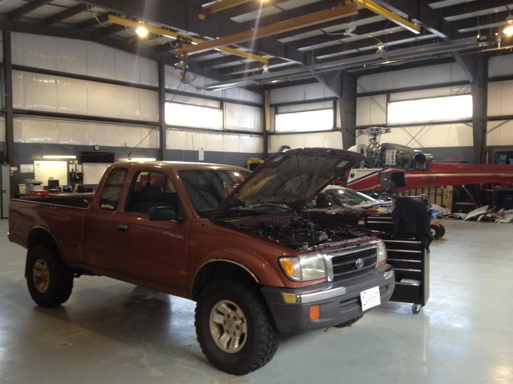

#39
I've put in about a month of daily driving, maybe more. Two tanks of diesel and i've switched over to waste jet A now (guess working on helicopters has some perks..). I'm mixing Jet A 100:1 with two stroke and it seems to like it..runs about the same.
Fuel economy, i'm getting about 25mpg, or roughly 600km to a tank (55L). Tires are 32's, stock gearing, so i'm probably getting a tad more than that, but who cares, since my old 22re truck was getting 380kms max out of 55L.
Power is about the same as the 22re. Torque is alot better. Will idle around in first/reverse no prob without touching the gas pedal. Built this thing to haul the sled around and it's great, no issues there. Only problem at this point is the lack of power off-boost. I will be doing my timing chain to address that, as suggested in that other thread, as well I might mess with the ALDA a bit.
