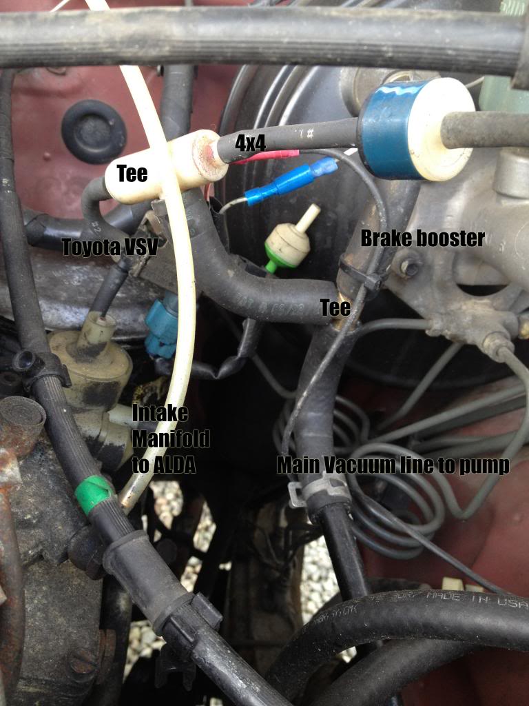

Originally Posted by ravenr106
I would like to see pics of the vacuum setup.
I will take some tomorrow

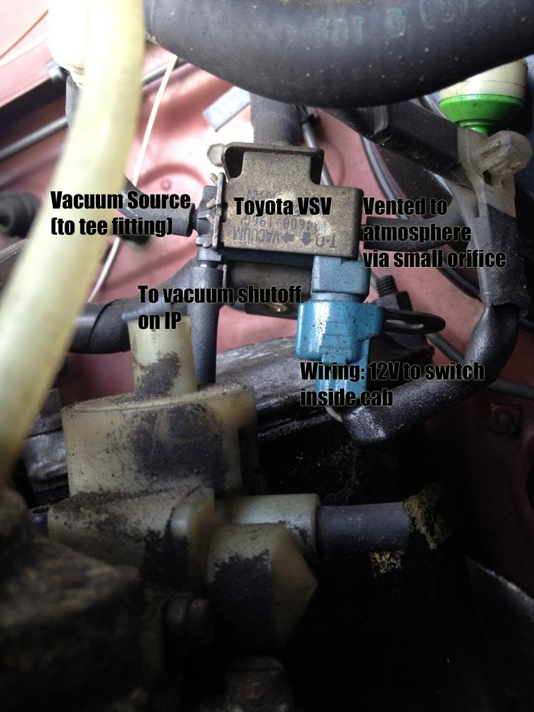

raven, here are some vacuum pics

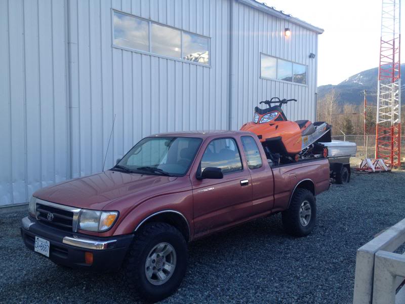

Originally Posted by flatspeed
I've put in about a month of daily driving, maybe more. Two tanks of diesel and i've switched over to waste jet A now (guess working on helicopters has some perks..). I'm mixing Jet A 100:1 with two stroke and it seems to like it..runs about the same.
Fuel economy, i'm getting about 25mpg, or roughly 600km to a tank (55L). Tires are 32's, stock gearing, so i'm probably getting a tad more than that, but who cares, since my old 22re truck was getting 380kms max out of 55L.
Power is about the same as the 22re. Torque is alot better. Will idle around in first/reverse no prob without touching the gas pedal. Built this thing to haul the sled around and it's great, no issues there. Only problem at this point is the lack of power off-boost. I will be doing my timing chain to address that, as suggested in that other thread, as well I might mess with the ALDA a bit.
More pics and vid to follow
Sweet truck!!!!!!
Hey is that a AS350 FX or twinstar in the back ground?

Originally Posted by toastyjosh
Sweet truck!!!!!!
Thanks! It's a twinstar, good eye.

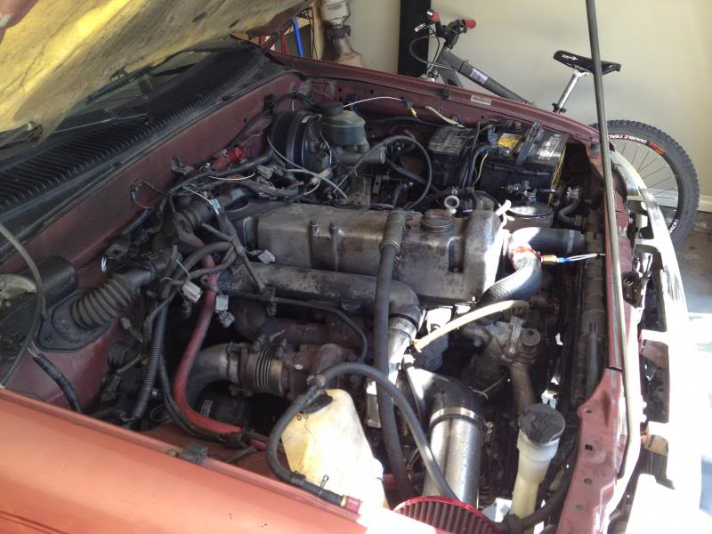

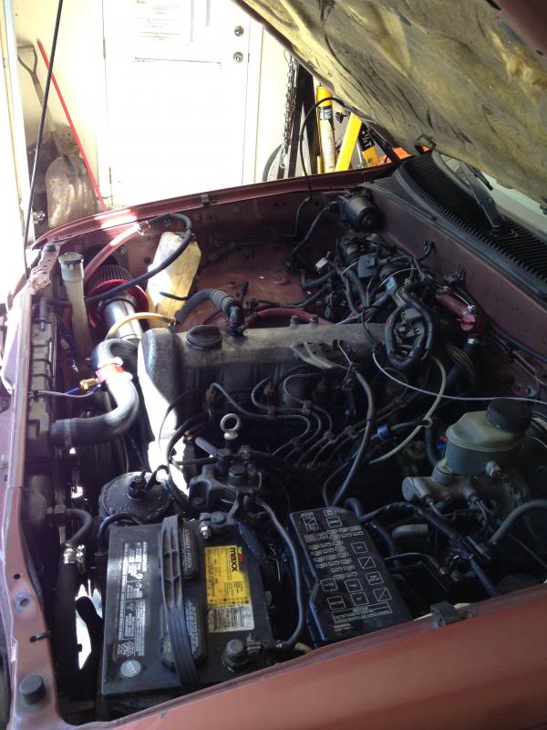

7000kms and still running great.
some engine bay pics now that i've cleaned it up a little, still have to omit the toyota wiring harness, seeing as i've only used a few wires out of it

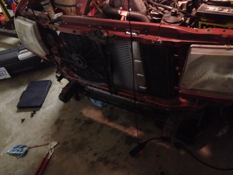

I ended up picking up a rock in the original mercedes rad. Bought this one from summit racing, it is similar in dimensions, but thicker, and aluminum. Only the top 3" is ever hot, and the fan rarely comes on now..
