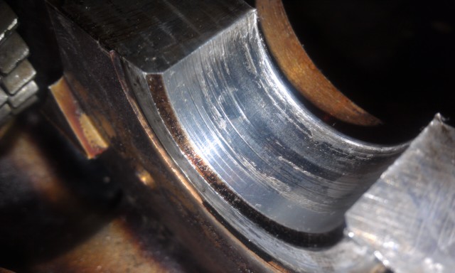

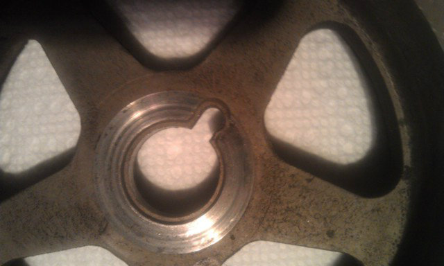

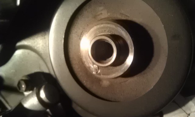

I bought this engine knowing it has a problem, and I gave almost nothing for it.. Which was a good thing. I bought it as having a bad timing belt, but instead both camshaft alignment pins where broken.

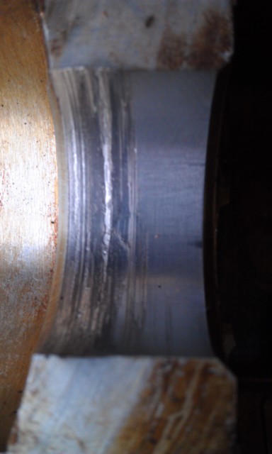

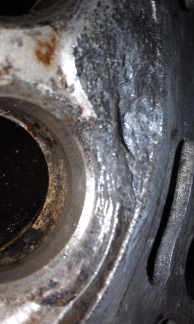

after digging a little more I found one bad intake cam journal in each head.

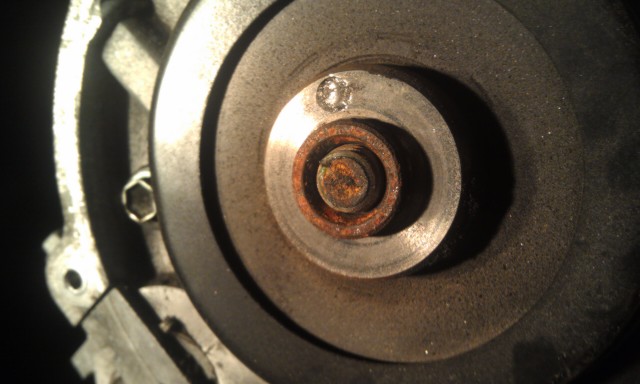

Then I found the reason for the broken alignment pins.

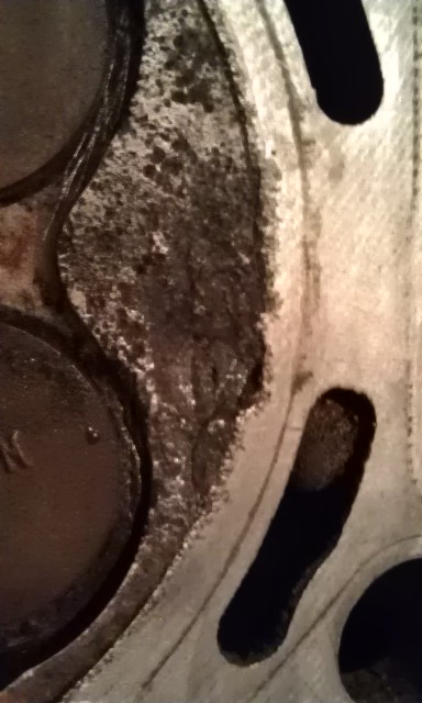

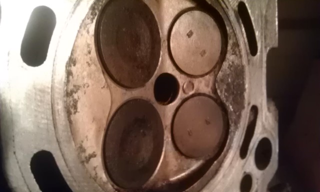

After some hunting I picked up 2 used heads from a salvage yard.
One looked pretty much brand new, the other had some issues that I found when I was cleaning.
The combustion chamber just started to crumble!

I called the salavge yard and told them what I found and with in 2 days they had another head on my door step!

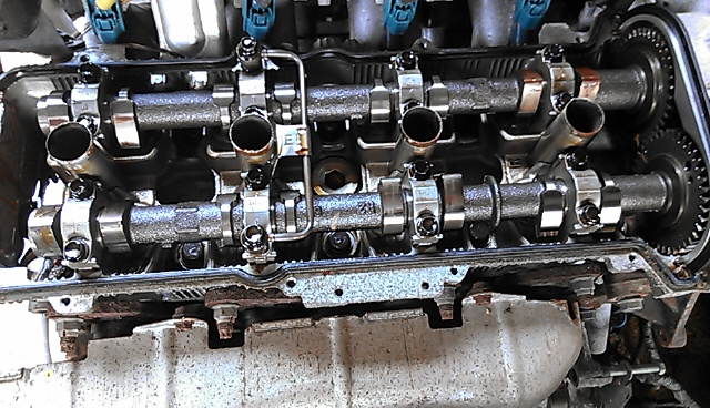

Anway, This the motor back togther with All Toyota Gaskets!
I still need to change the timing belt, and water pump along with track down a few hoses and clips.

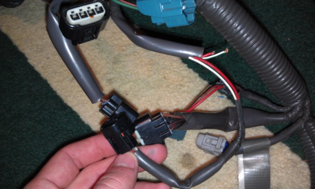

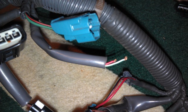

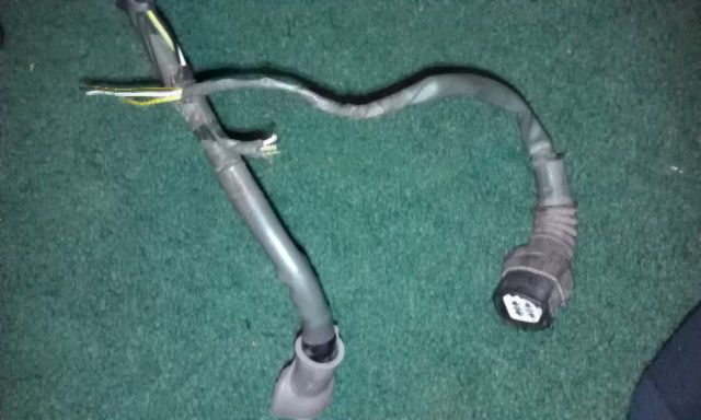

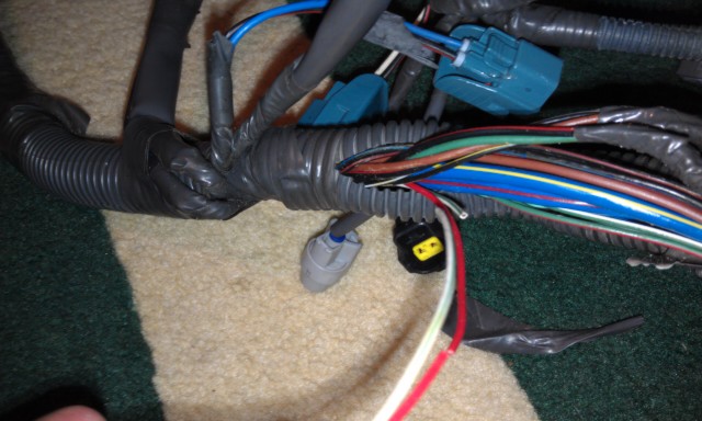

Once I got the engine back together, I fixed a few things on the harness I picked up. It was missing the EVAP plug, and the altornator plug. The engine came with a 2004 harness that was pretty well hacked up, but the two plugs I needed where on it!
Evap wire when I started.

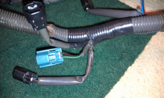

Missing Evap plug
Wiring harness opened up and the wires stagger cut so the "bump" wont be as big.

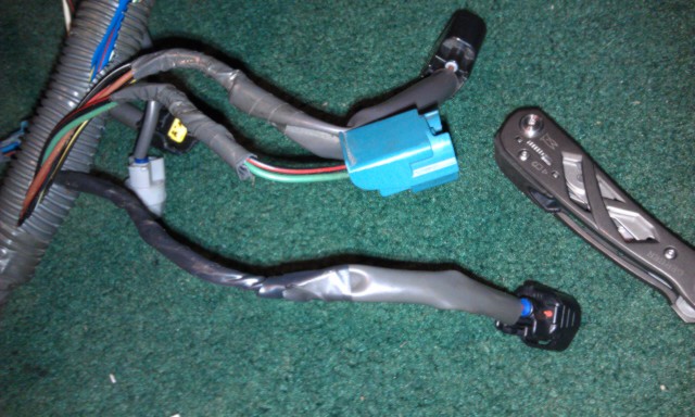

The plug soldered on and taped up. Notice there is no bump in the repaired area.
Harness tapped back up and ready. I wish the tape matched the loom.

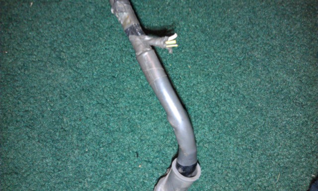

Cut alternator wires.

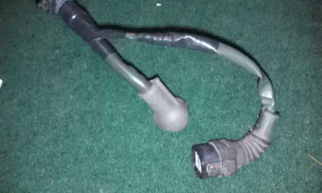

Missing alternator plug
Plug soldered to harness and tapped up ready to roll.

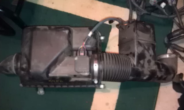

I also picked up a stock air box, intake tube, and the MAF!
