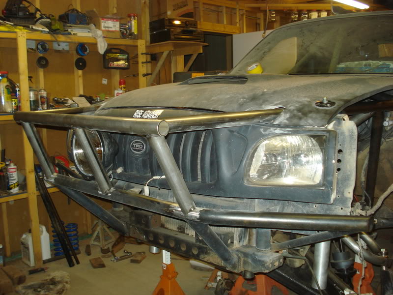

Quick spray paint job and slapped a home built bumper on it...

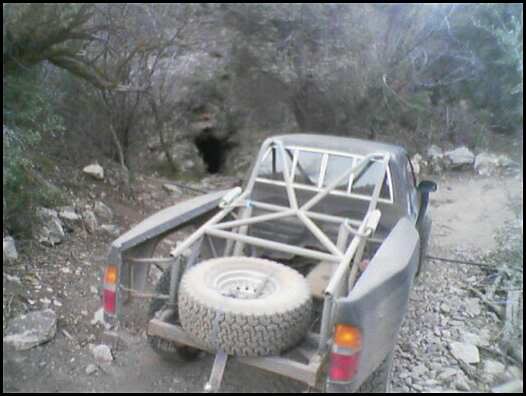

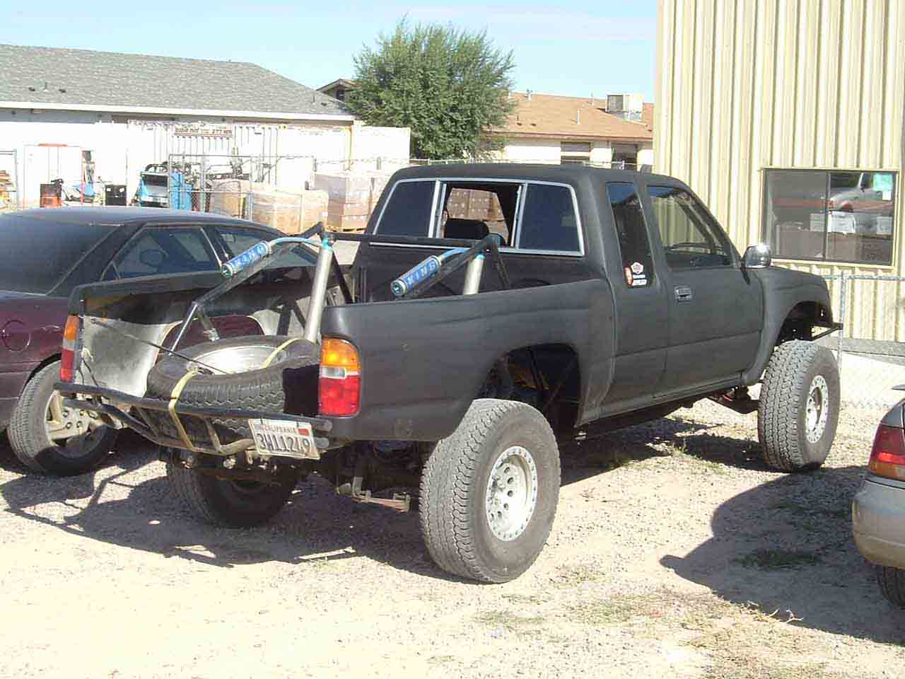

The bedcage had to go. Poorly built and was in the way of my plans!

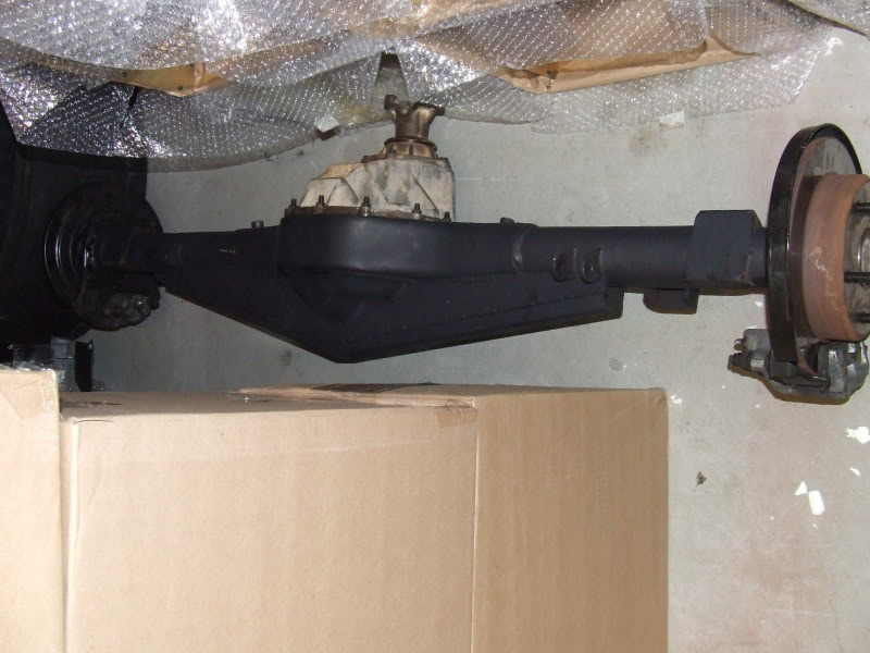

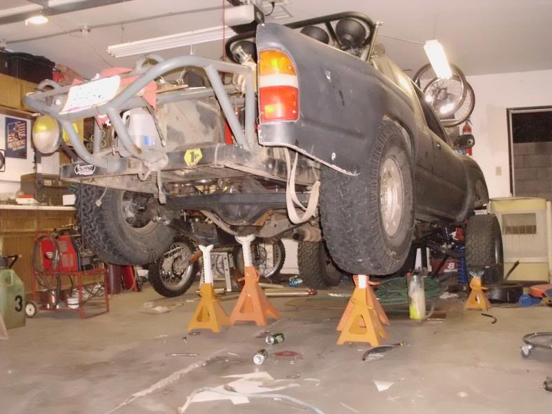

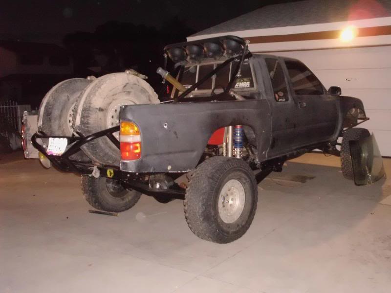

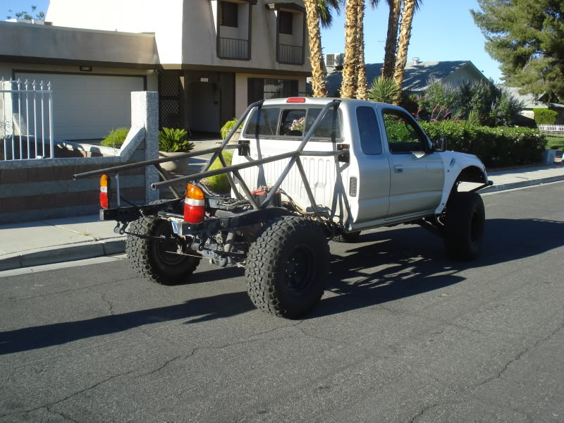

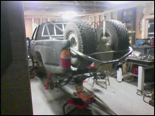

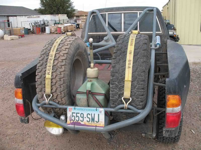

Ditched the national leaf pack on the rear, moved leaf mounts, installed 62" deavers, fuel cell and finished rear cage area with spare tire mounts.
gotta have room for dirt bike gas can too!

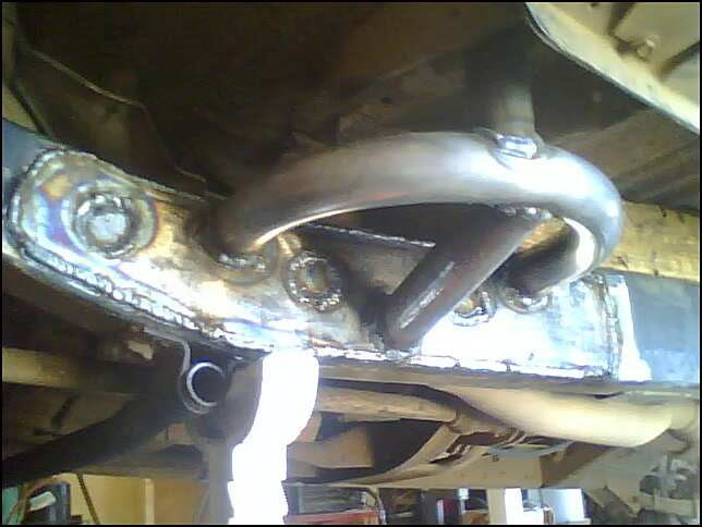

Home made chromoly shackles...

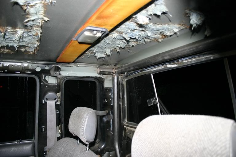

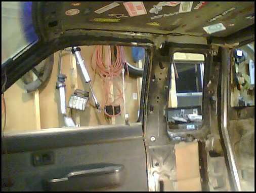

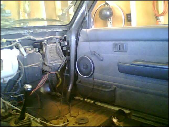

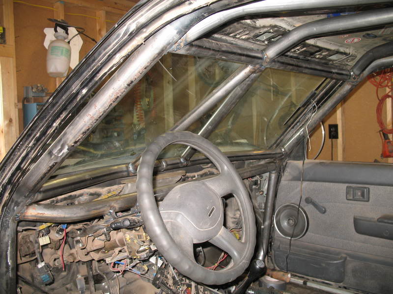

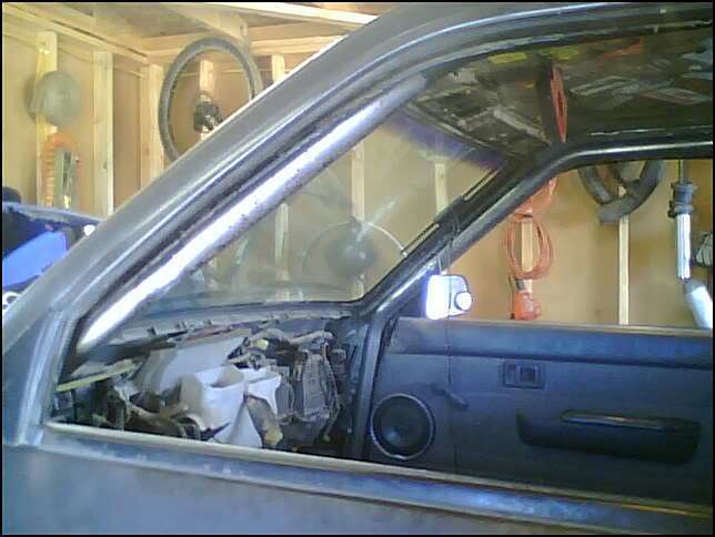

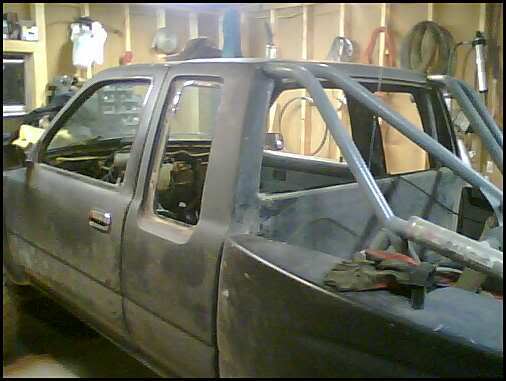

Finally figured I'd take the time and step up to a better front suspension which meant building front cage. I wanted the truck to flow cage wise and had a vision of what I wanted to do so the front suspension upgrade forced me to do the cab cage too at the same time. The truck came with a duffco front suspension that was average at best...

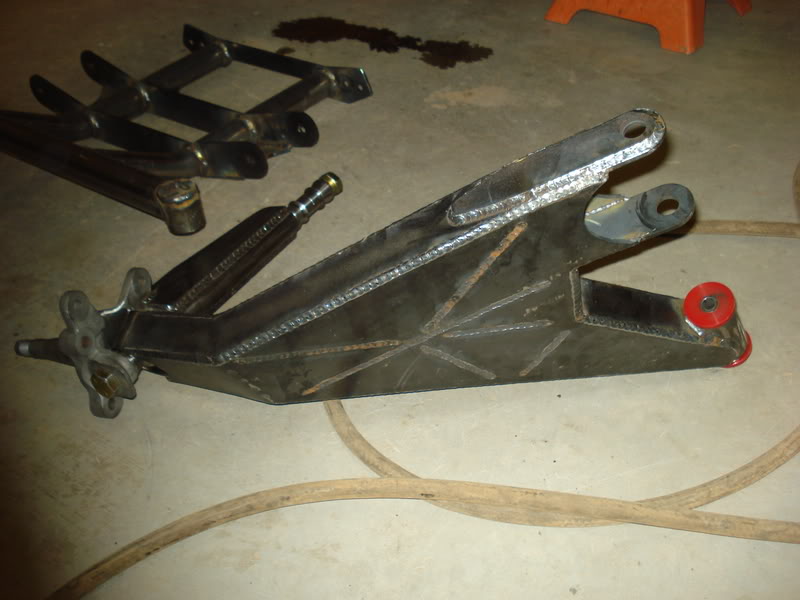

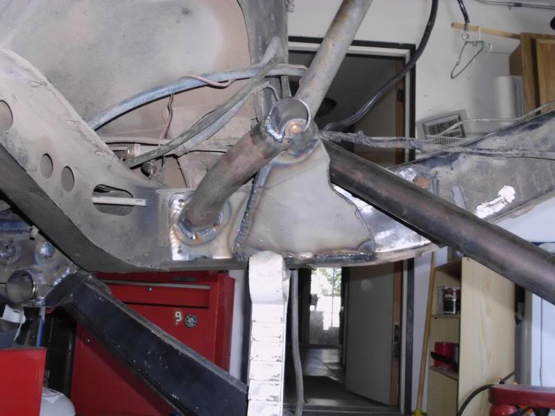

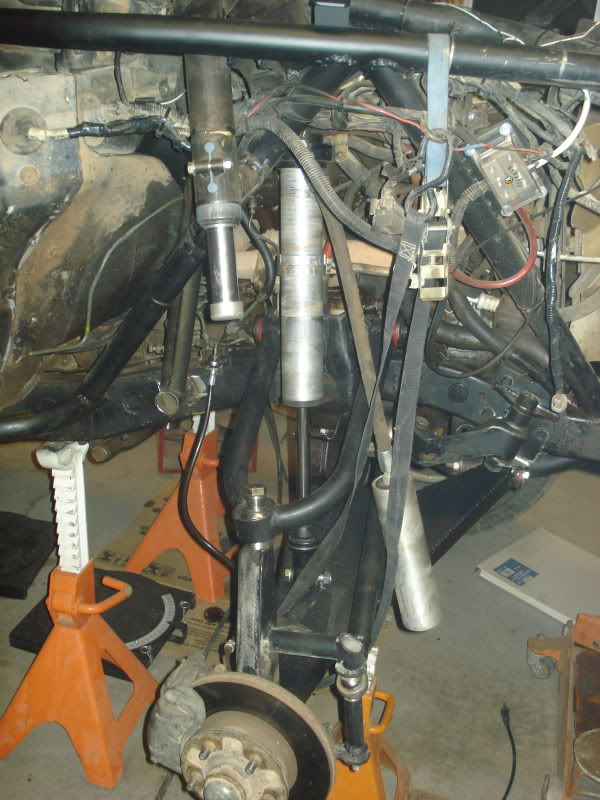

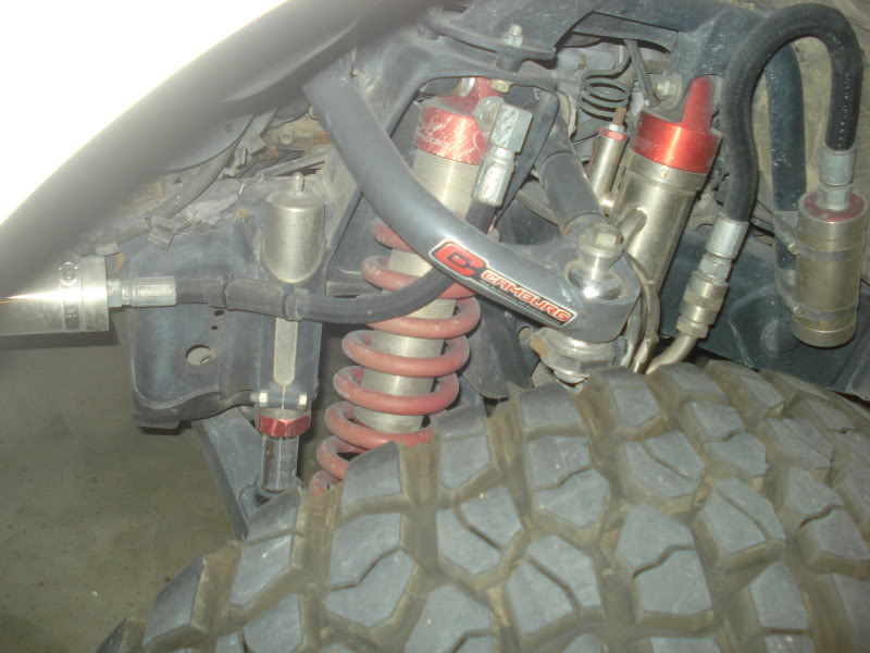

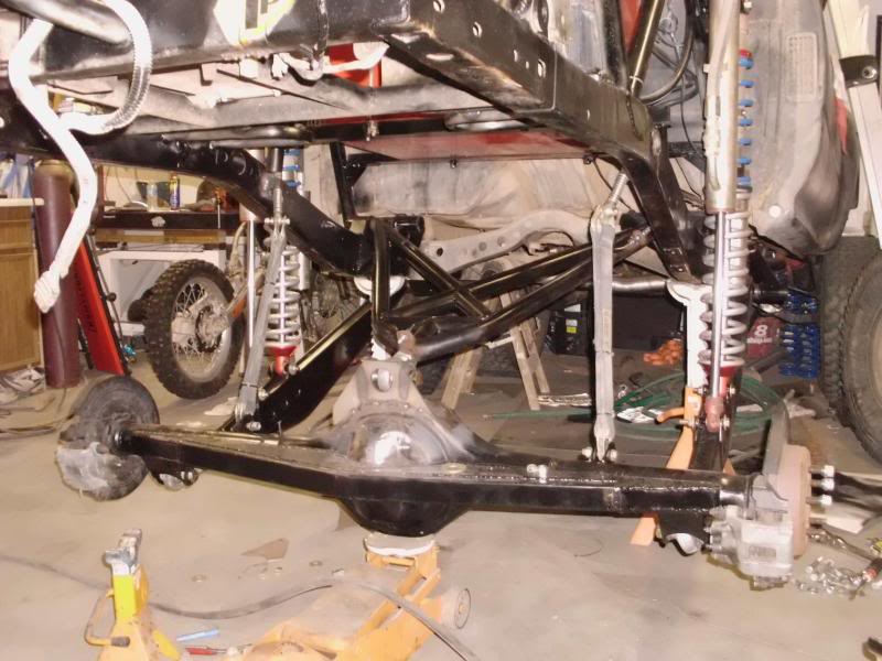

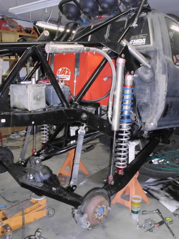

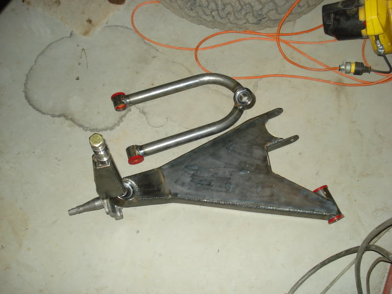

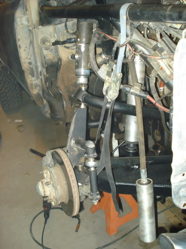

Here's the new front suspension... This is one of a handful of parts I didn't fab myself...

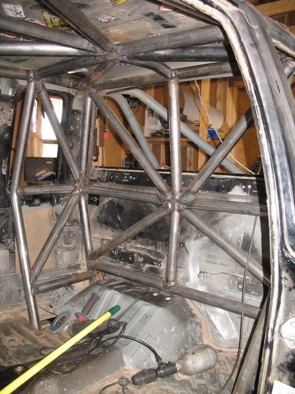

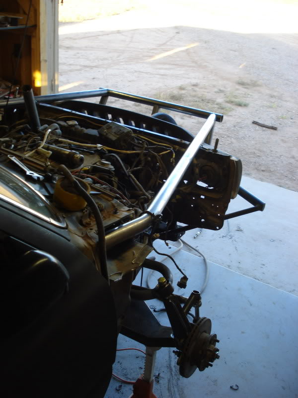

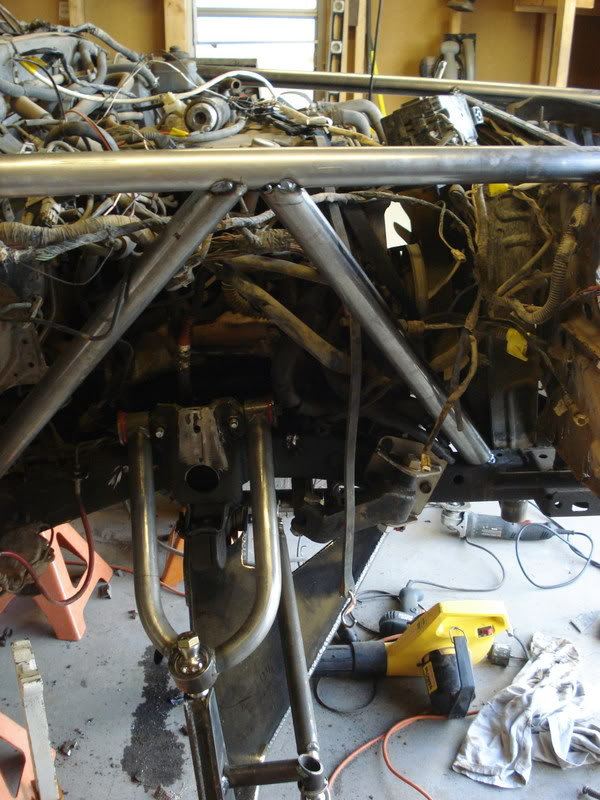

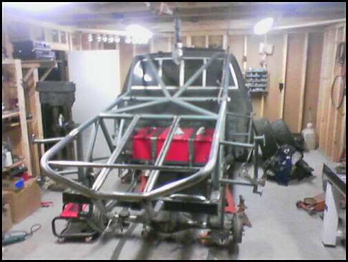

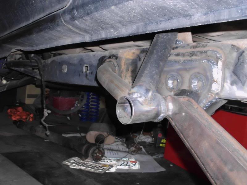

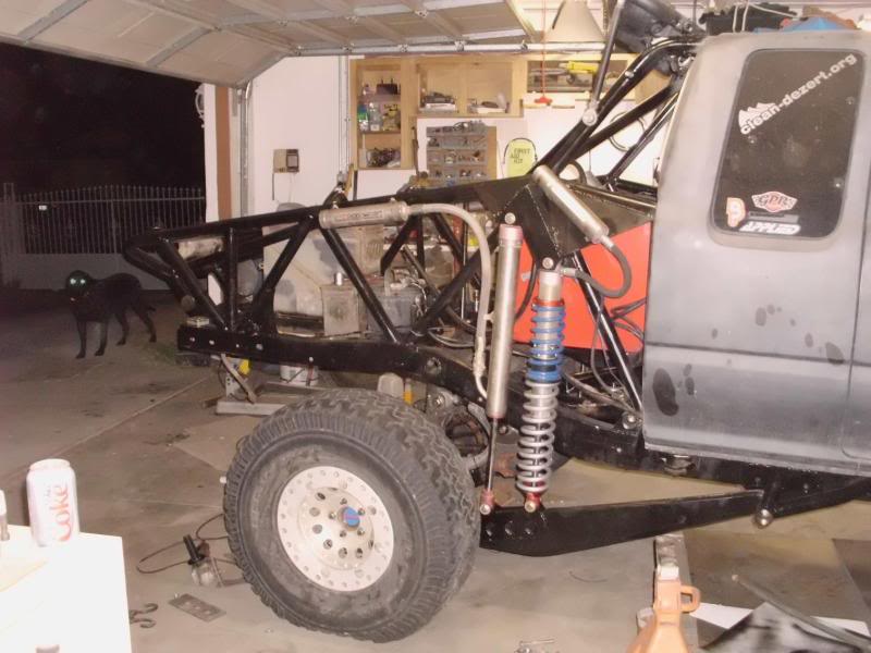

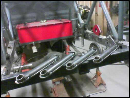

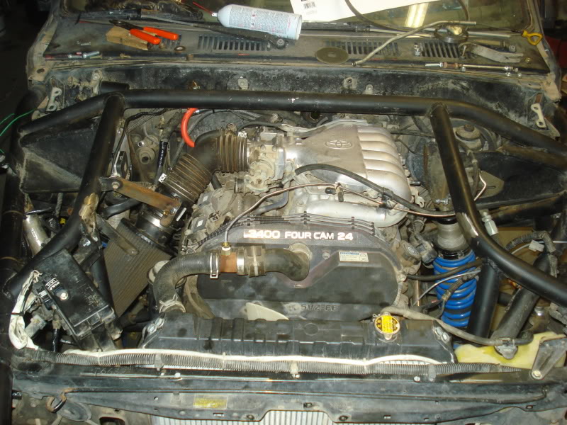

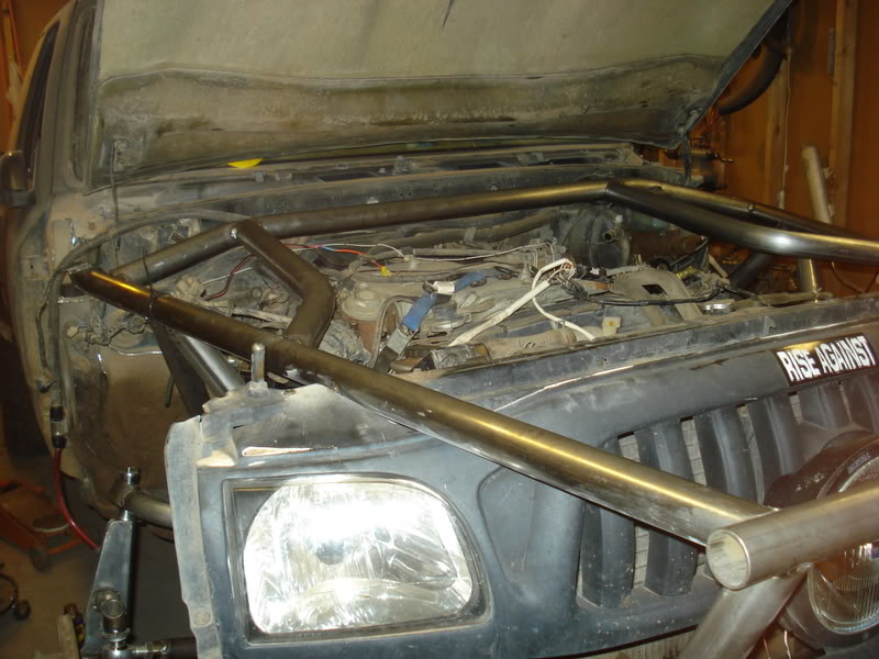

And continuation of the cab cage into the engine cage area...

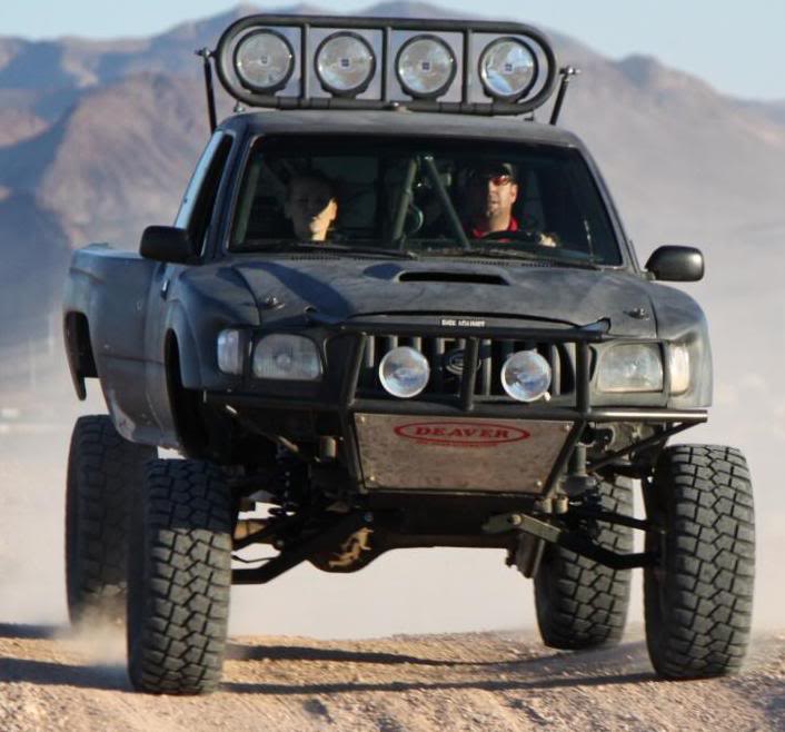

Somewhere along the way I picked up some HID's so a light rack popped on the roof line too.

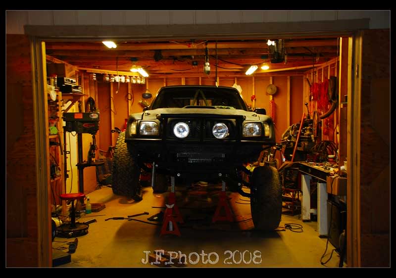

At this point, life changes happened and I moved from Az. to Nv. Housing and work space issues put the project on pause for awhile so I ran it as you see above for a bit. The stock 3.0 V6 was pushing 250K, leaked oil and spewed power steering fluid. I bought a house with a garage and was able to get back in the game. I picked up an old race motor from Dan Vance who might ring a name to some of you and did the 3.4 swap.

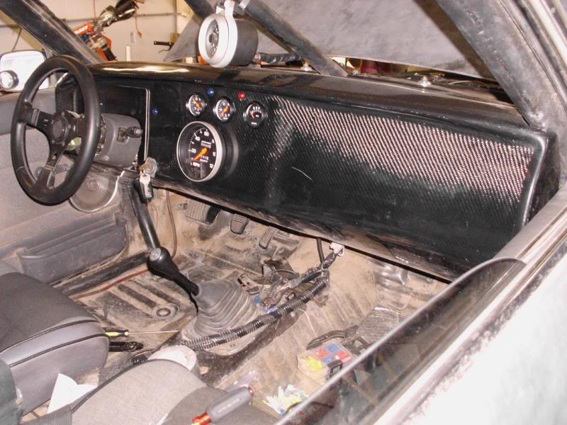

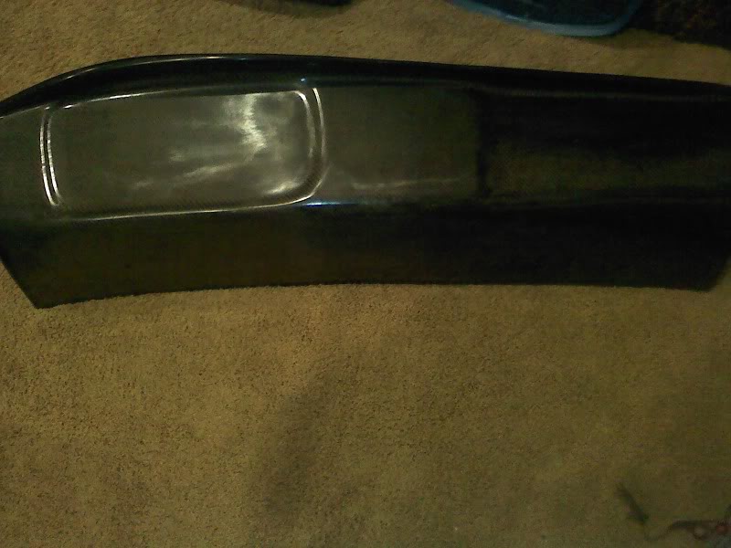

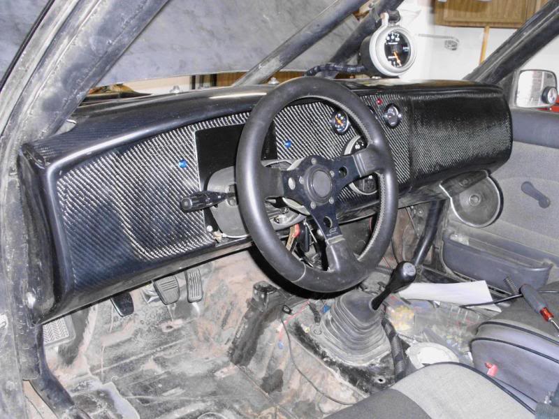

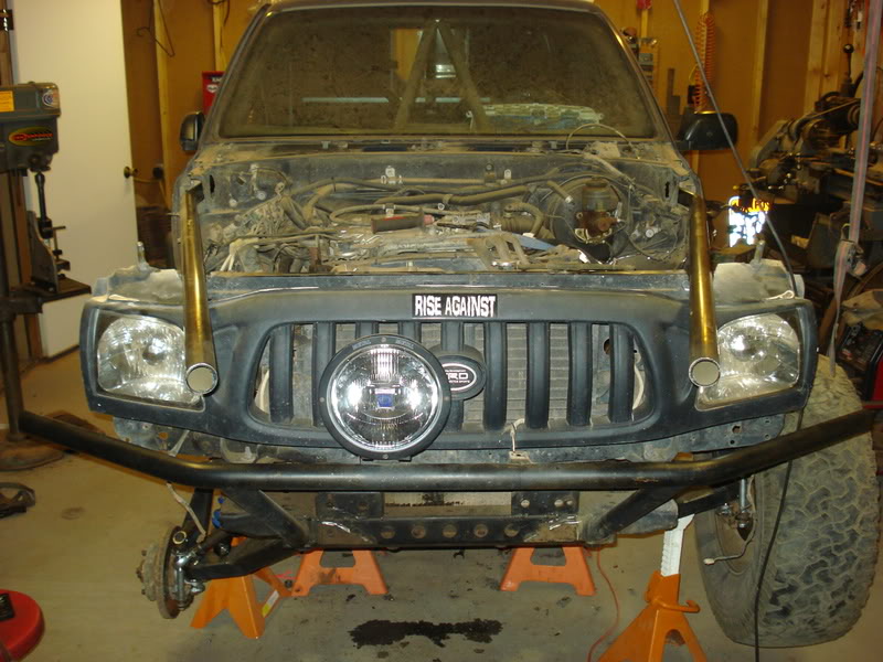

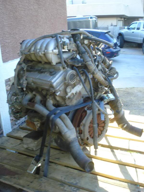

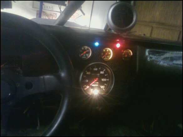

That's not a finished picture but you get the idea... I put about 50 miles on the motor swap and stumbled on a dash deal I couldn't pass up. It had been a few years of motoring with no dash and just the nastiness of what was behind it so I jumped on it. I had ripped out all heater and A/C during the motor swap so I'm pretty minimal. Future plans include a mojave heater in the extended cab area for the colder months and a spray bottle with water and windows down for the summer.

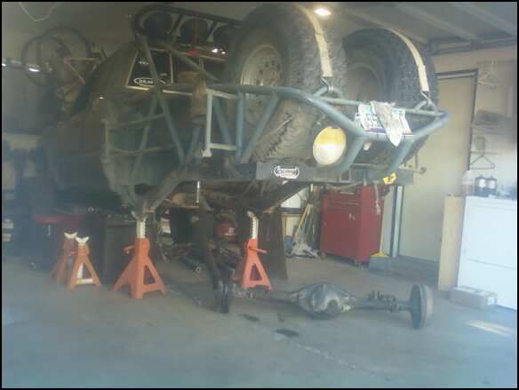

As the toyota gods would have it, rather then enjoying the nice dash and the motor swap that's 50 miles old... I stumbled on some lower links that were too cheap to pass up. I happened to have some 14" coilovers laying around already and I'd picked up a built ford 9" axles years earlier that was rusting away in my sideyard to swap in eventually. The time was right so I figured screw engine testing, let's keep building...

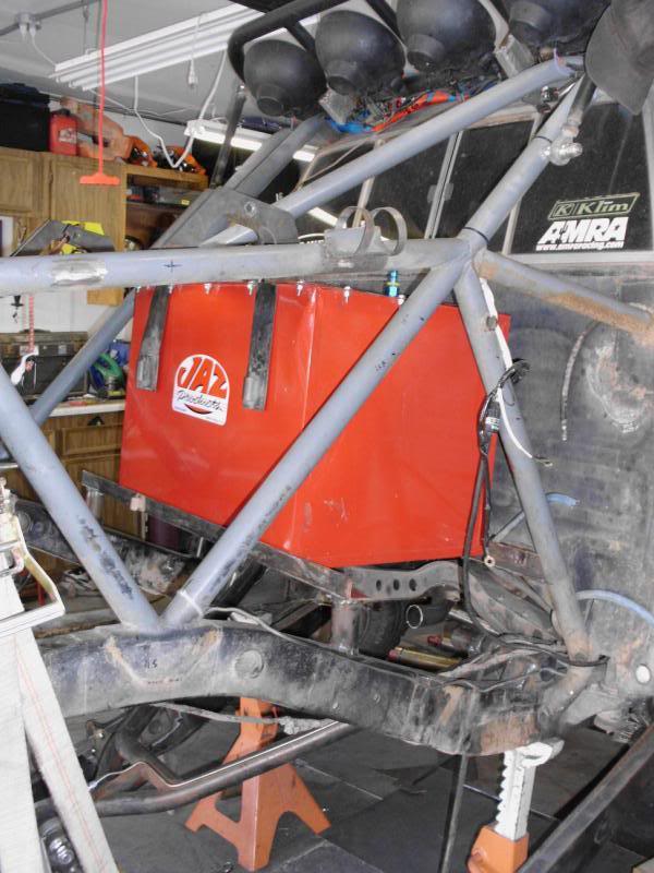

Long story but left over from a friends project I ended up with a new 32 gallon cell for all of $100 so I bumped up from the 22gallon that I already had.

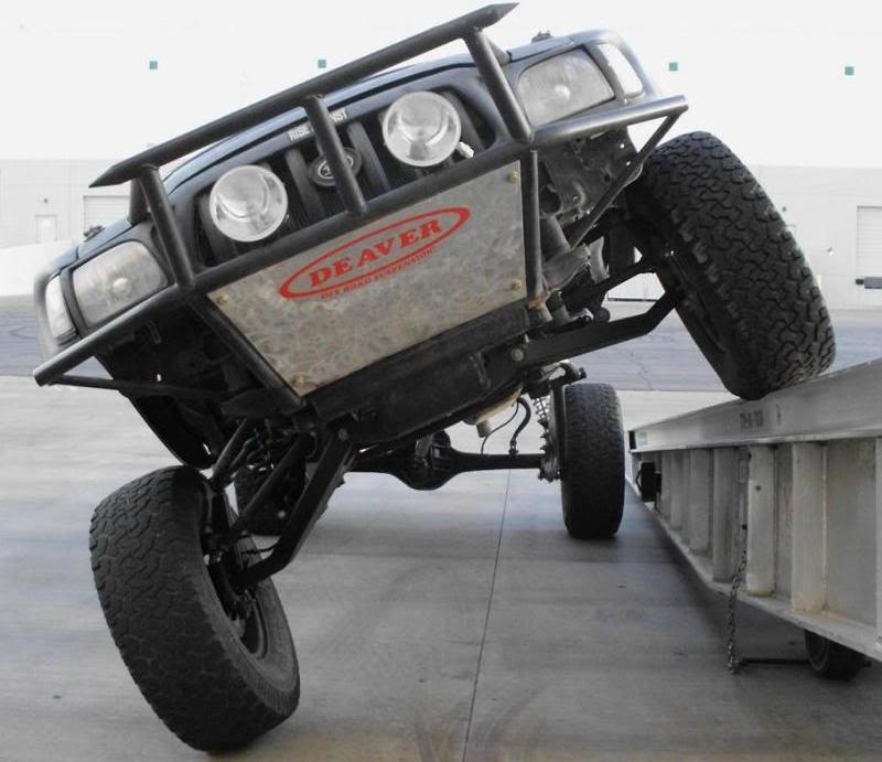

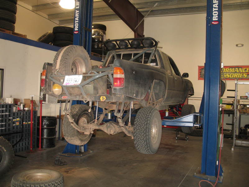

Here's screwing around with the highlift. I've got a 4x4 on the foot lifting it and I still can't get the tires off the ground front or rear. LOL
So basically, it's a 1989 frame, cab, and transmission. Custom front end 6" wider per side pulling 18" of travel on coilovers with hydro bumps. Full chromoly steering including pitman arm and idler arm. Fully caged bumper to bumper, 3.4L ex race motor from Vance with headers computer tune and other mild tweaks, 3 linked in the rear, trussed ford 9" with a spool, 5.04 gears, currie built 9+ third and currie axles using explorer disc brakes.
Mostly self built... hope you enjoyed... I've got a tacoma build coming over the next year that is a race venture I'm involved in so that should be pretty fun too! My truck is just a toy, this one will be more legit!

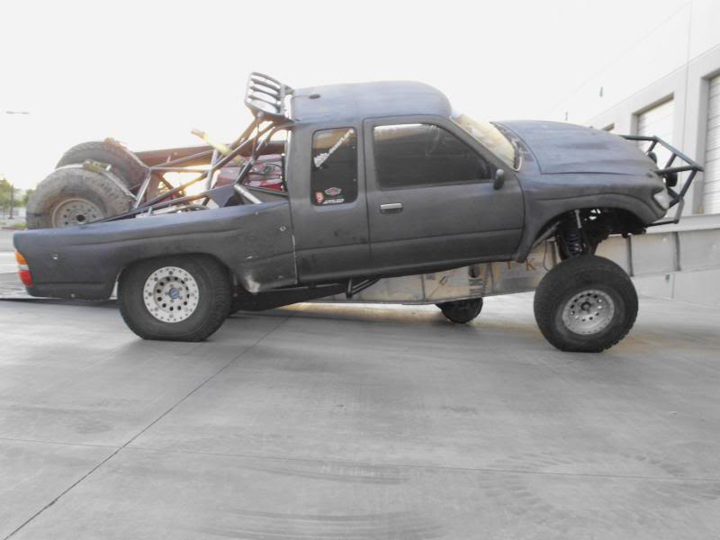

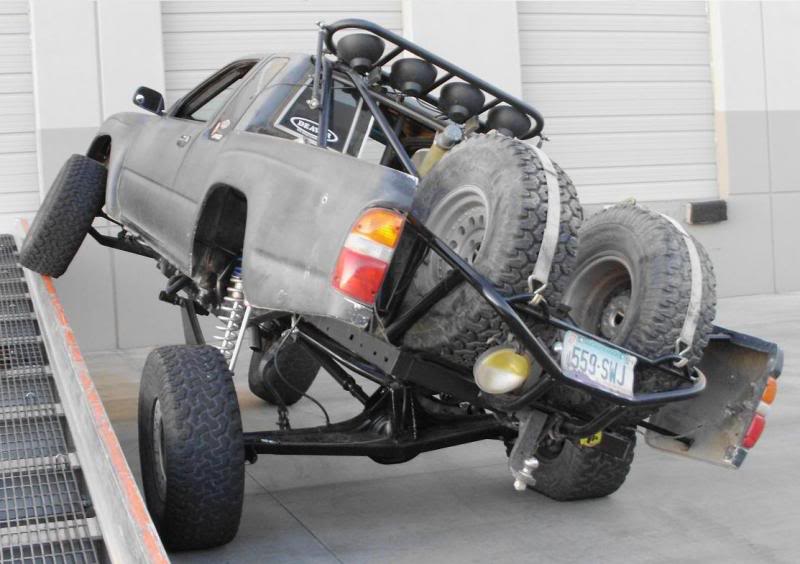

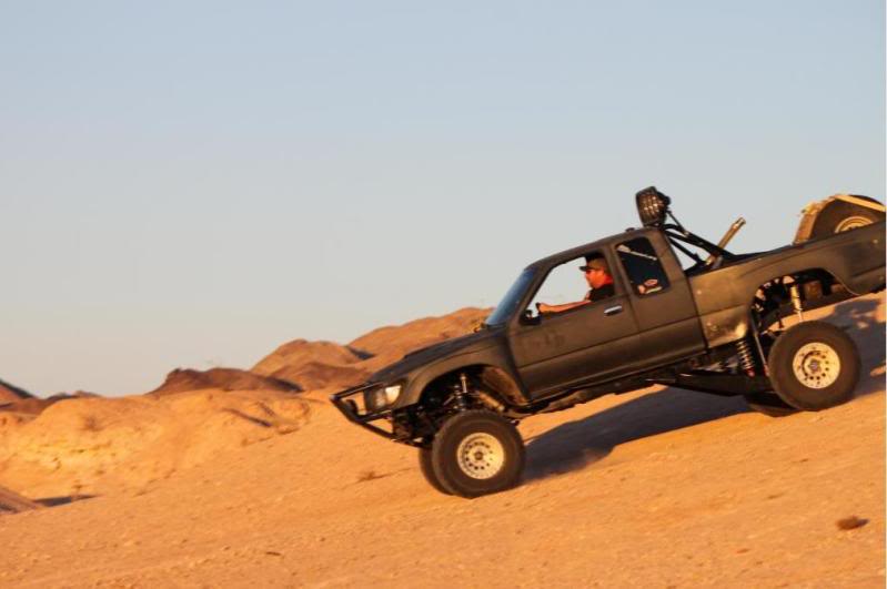

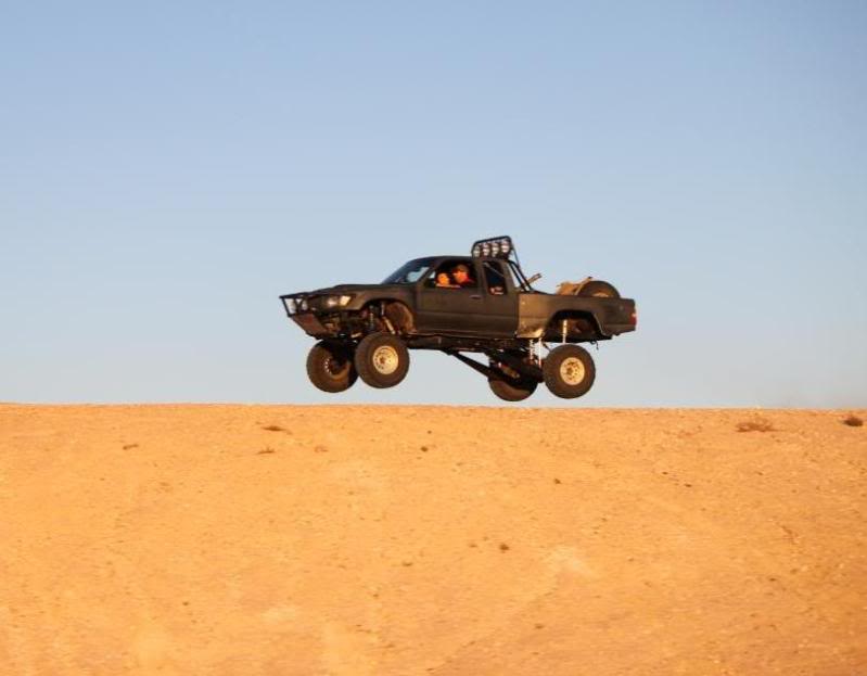

My best impression of a 4wd screwing around on a loading ramp behind my work. Remember though, I've got a spool in the rear axle and with 5.04 gears my 1st gear crawls decent. Momentum bumps the front end up a lot of obstacles too so you'd probably be surprised where I can get this thing. I'm not dumb though, I know the front tires not pulling will limit me. That's why I have a jeep on 35's in the garage too! :p
Not sure why this one is 90 degrees off. I've rotated it in my editor and it shows it correct but when I link it here it's off...

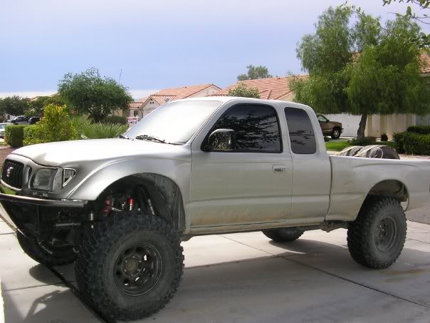

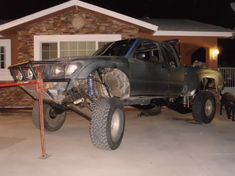

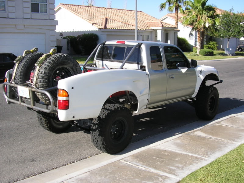

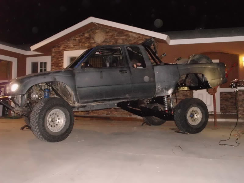

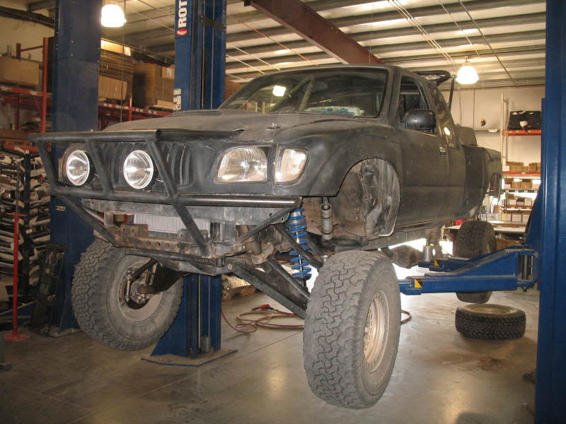

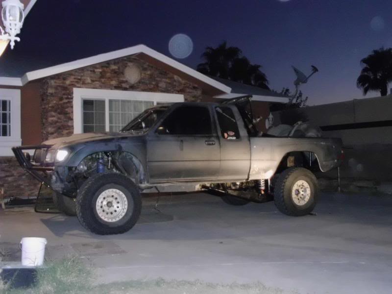

Here's the truck as he bought it...

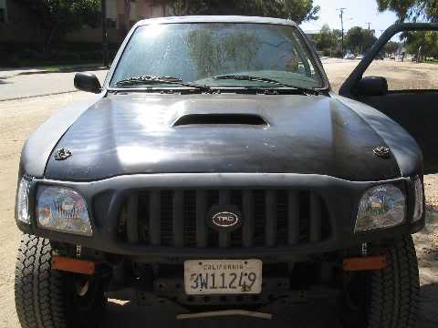

Tundra conversion clip and we built a bumper for it. (he wanted to change the look of the truck from how he bought it so that it was more "his" truck then what he bought. Hence the tundra conversion clip and TT bedsides pictured below.)

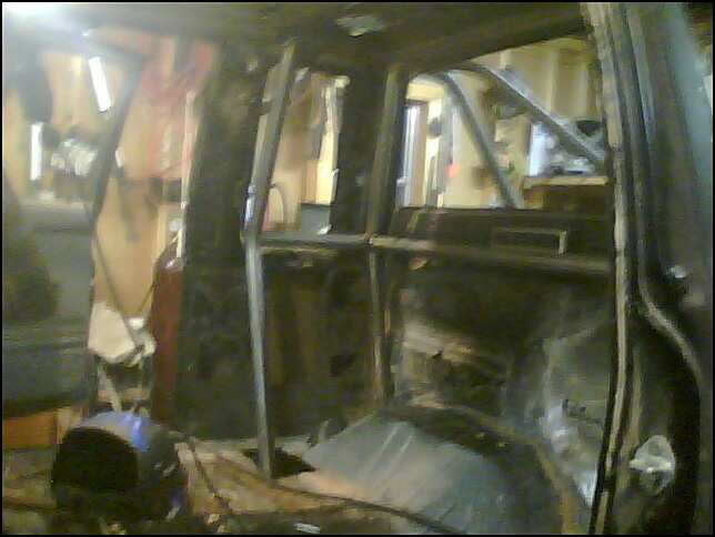

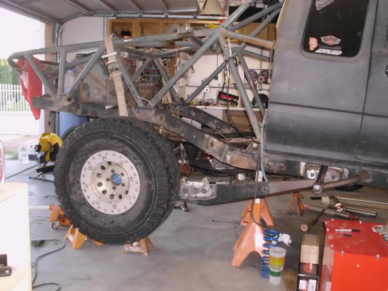

Cut off the rear bedcage that was in it, ditched the bed and CUT HOLES in the cab! LOL, no turning back now!!!

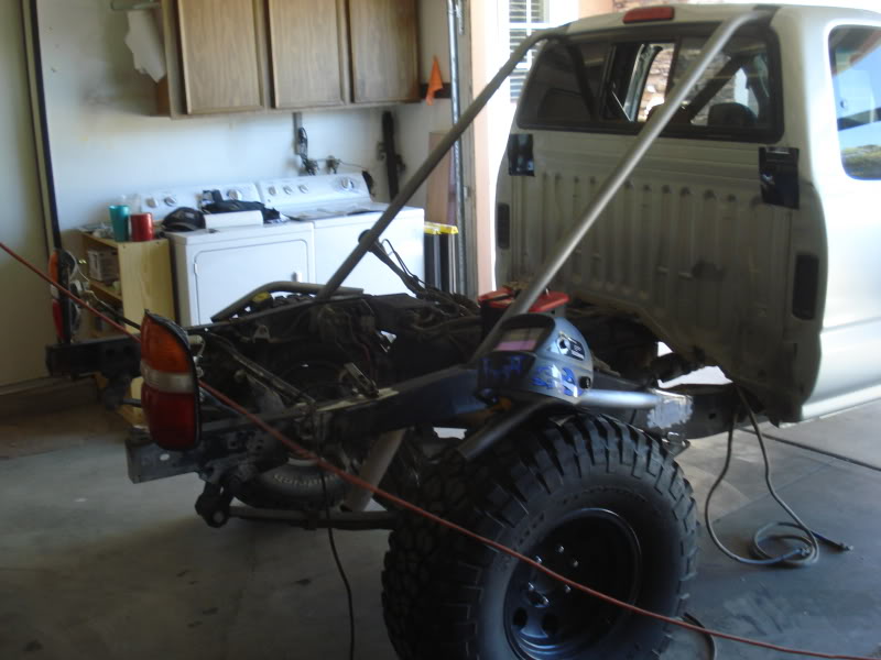

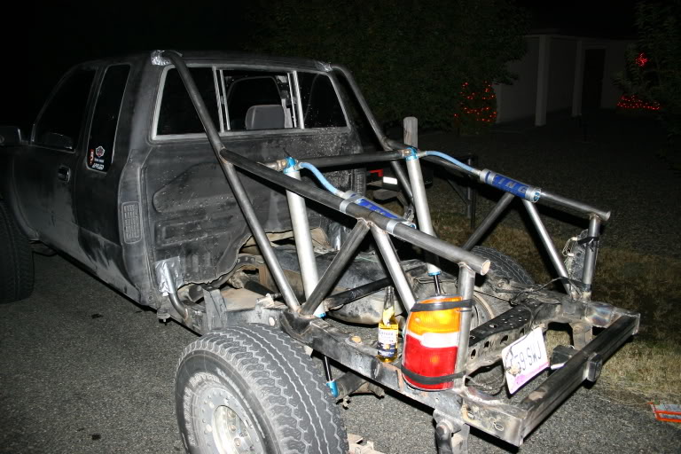

A little more... In the works here is rear cage from B-pillar to rear bumper, fuel cell, 62" all-pro race leaf springs, 16" king bypass shocks and TT bedsides.

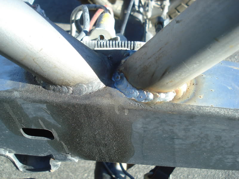

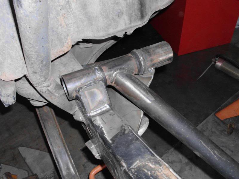

I'm no professional welder... Here's a close up of my "average" weld. Some are better, some are worse... I won't lie! LOL

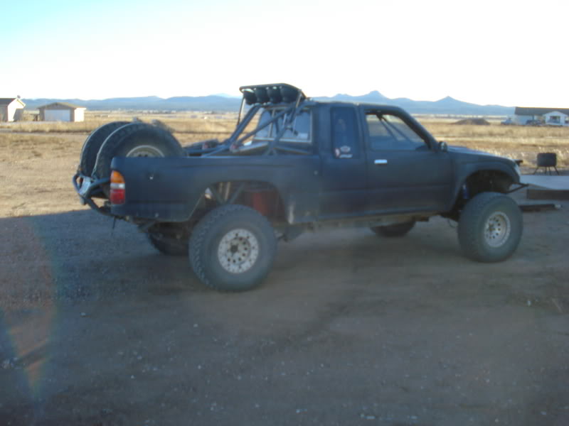

As it sits now or well how it sat when it went away to my friends shop for him to give it some love in the front suspension area!

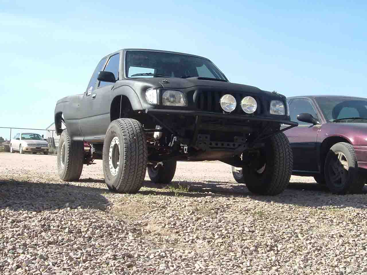

It had a camburg kit on it but that wasn't good enough for what we expect to do with the truck. All of this suspension is off the truck though now. The arms have already been sold but we still have the shocks. If anyone is looking for coilovers or bypass shocks to slap on their ride he'd probably let these go for a pretty good price.

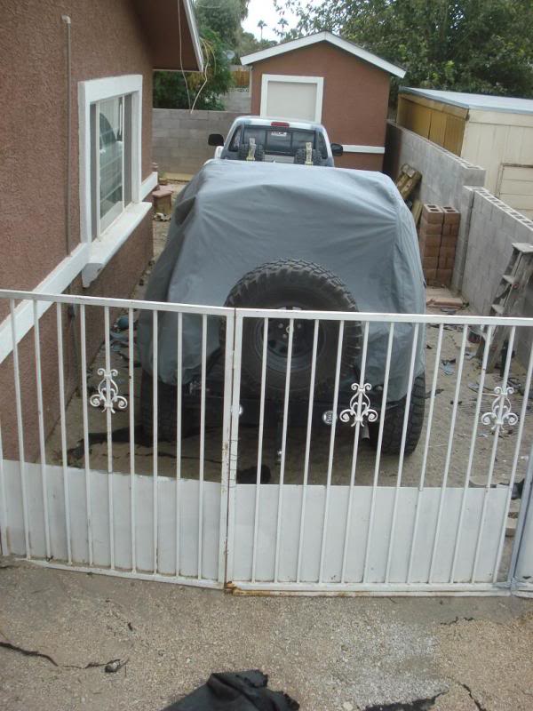

LOL, my sideyard with it stuffed in behind my jeep! You can kind of see that the holes in the cab have been patched up. This is just before I dropped it off to the shop it's at now. Before it's all said and done the entire roof of the truck will end up being cut off.

They happen to be in the trunk of my car right now. LOL
2.5" diameter sway-a-way, 8" travel, 22.5" eye to eye extended (eyeballed with tape measure), 600 lb rate springs

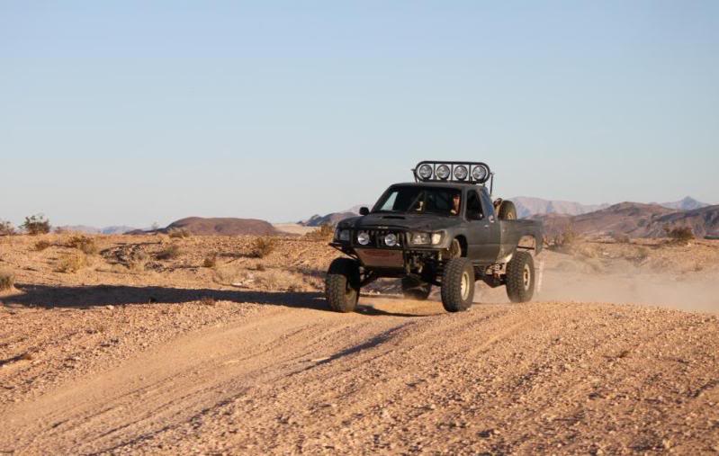

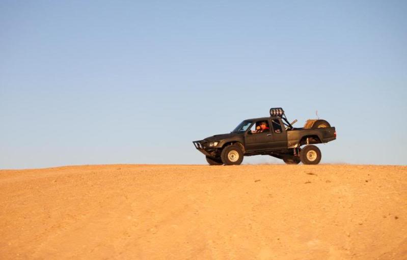

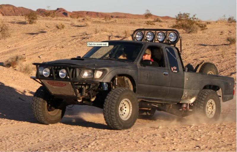

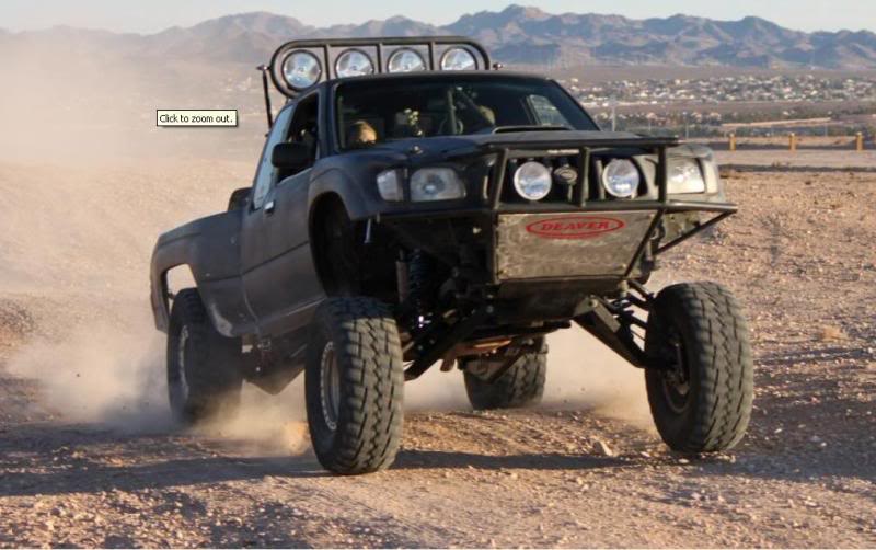

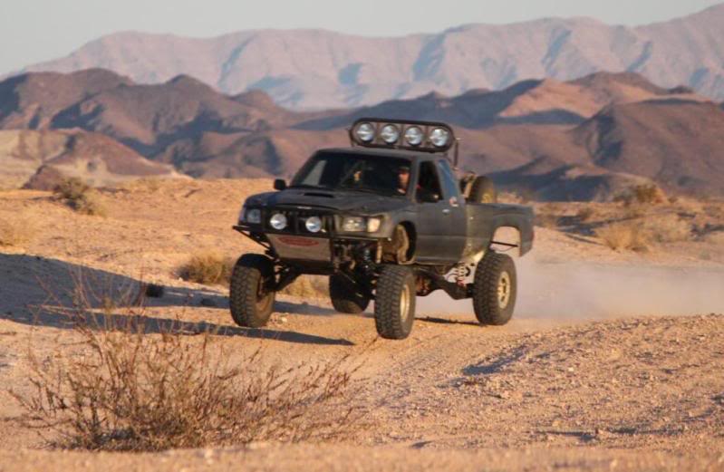

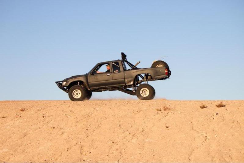

Eh, how about a pic and a video from the other day?
This is right out of the box, no shock tuning or any work dialing it in. It'll get smoother and faster still for sure!
http://www.youtube.com/watch?v=4L0xxAuSyVA
