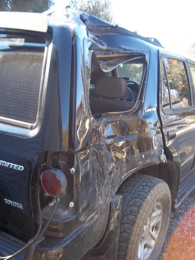

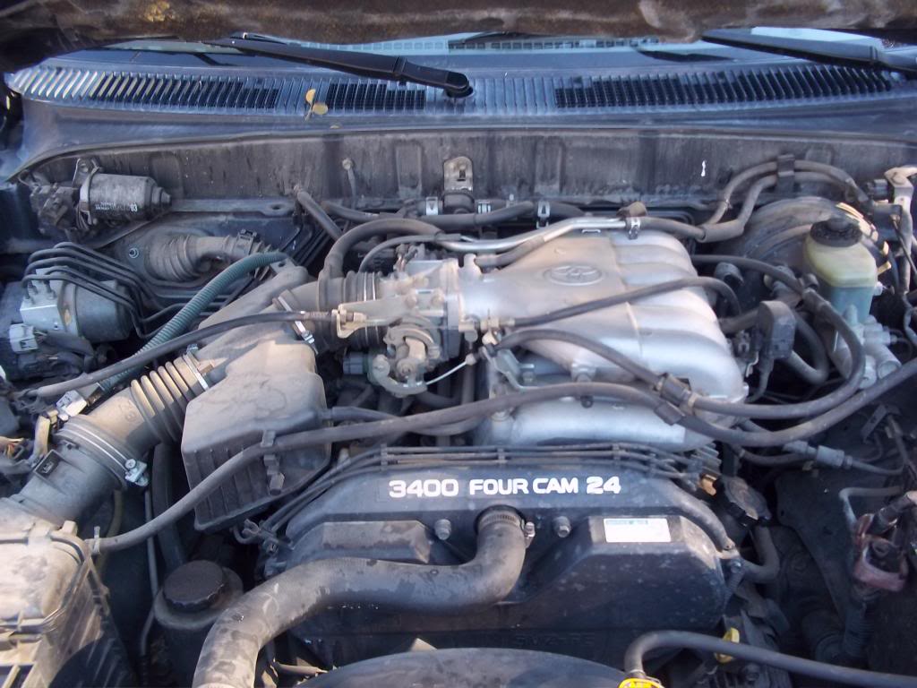

After a few years of following YotaTech and desiring a 3.4 swap after learning that 3.0 was not the motor to have chosen, I have began the process.

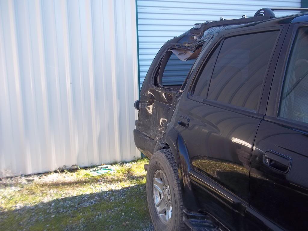

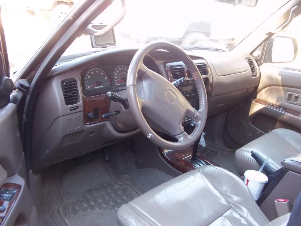

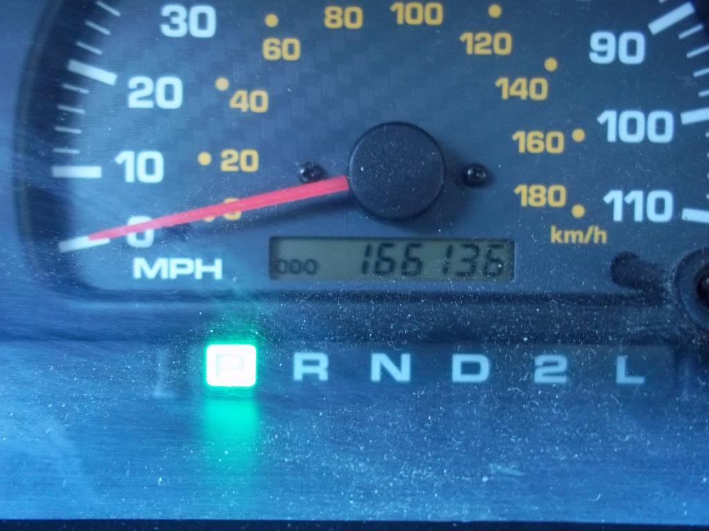

Last night, I left home around 5:30, drove about 3.5 hours to Tehachapi, with my brother riding shotgun, to pick up a beautiful donor truck, and then drove it all the way back home, returning around 1:00 this morning.
My swap is probably going to very slow to begin as I am in school and working full time as well raising my son, but I have made the initial purcahse.
1999 Toyota 4Runner Limited 3.4 A/T 2x4

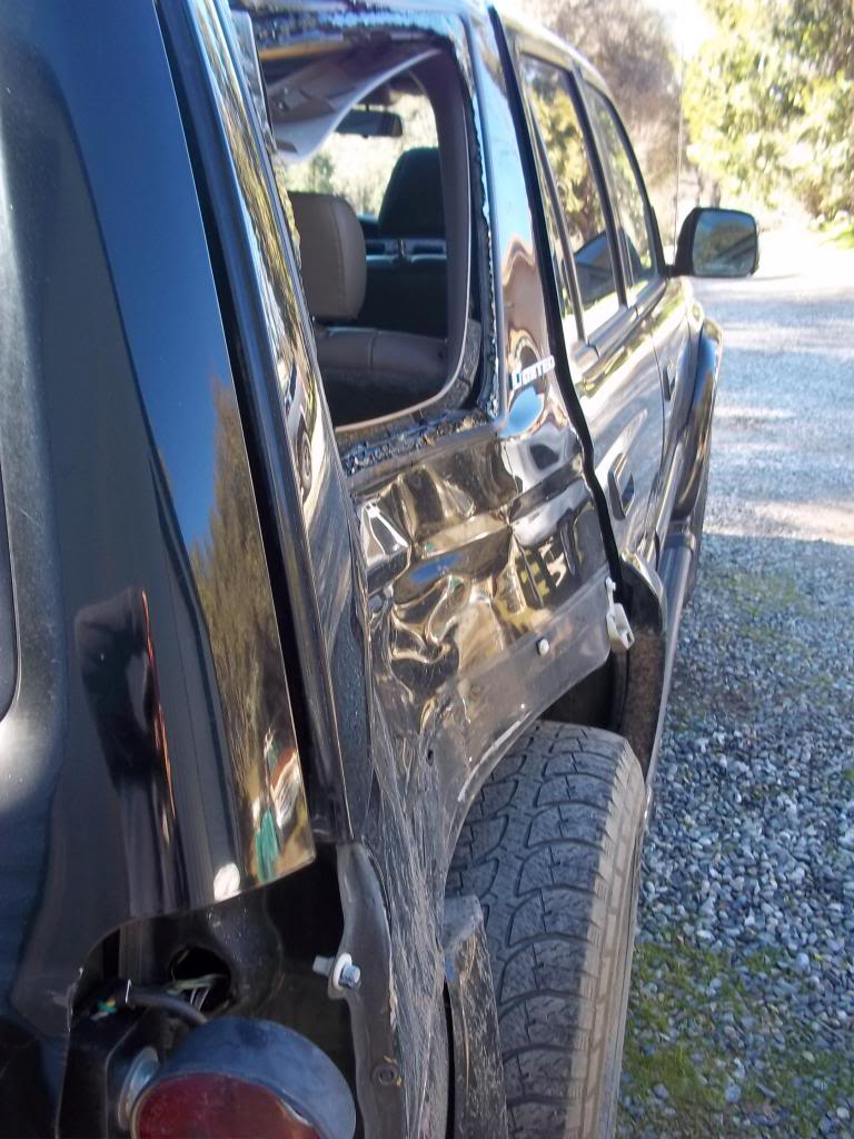

I bought it for $1200. I spent exactly $100 on gas for the entire trip, including my brother's V6 Explorer (which averaged 21 MPG) and the 4Runner (which I only had to put $20 in because it has almost a full tank when I picked it up).

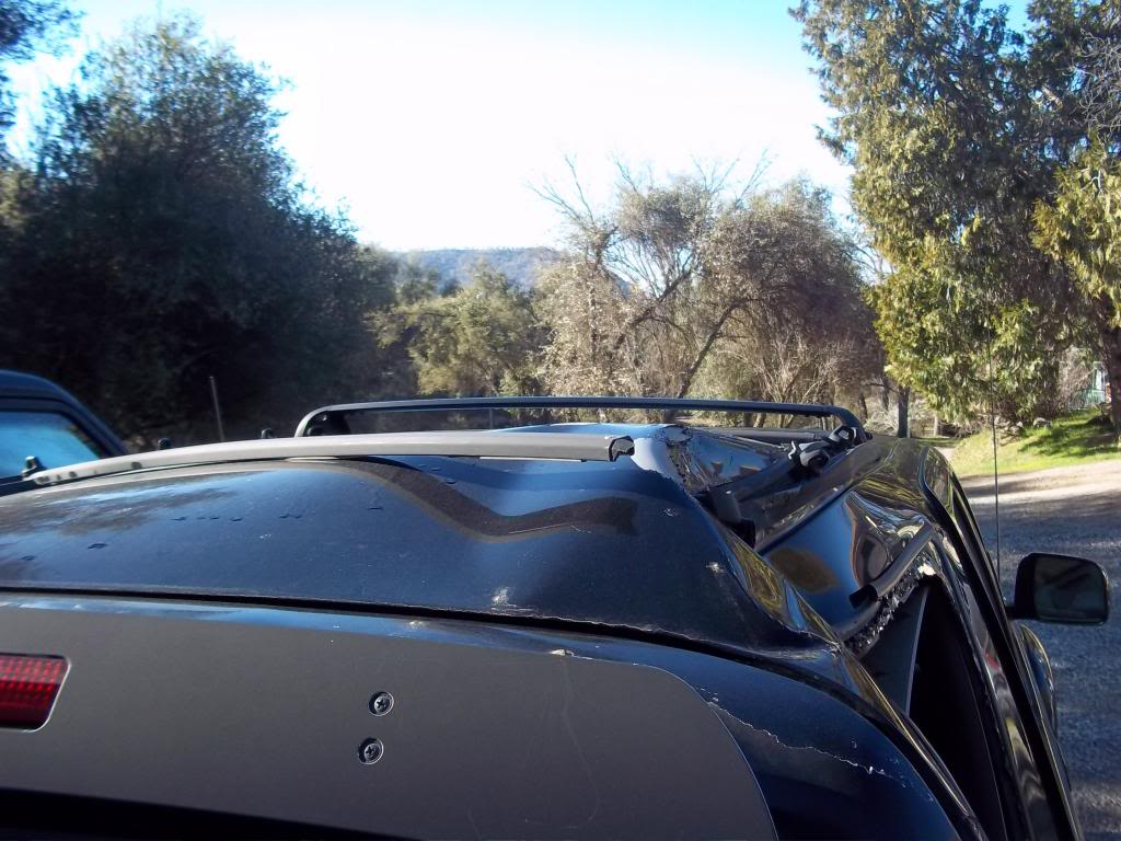

The lady I bought it from was very nice and generous. She herself once had an 88 4Runner 22RE, and hated to see this car go. She is going to be following the build to see how her baby is going going to good use.
She had hit black ice and spun off the road, slamming the rear end into a telephone pole. In fact, after her ordeal and my 200+ mile trip home, there is still wood from the phone pole stuck to the side of the truck.

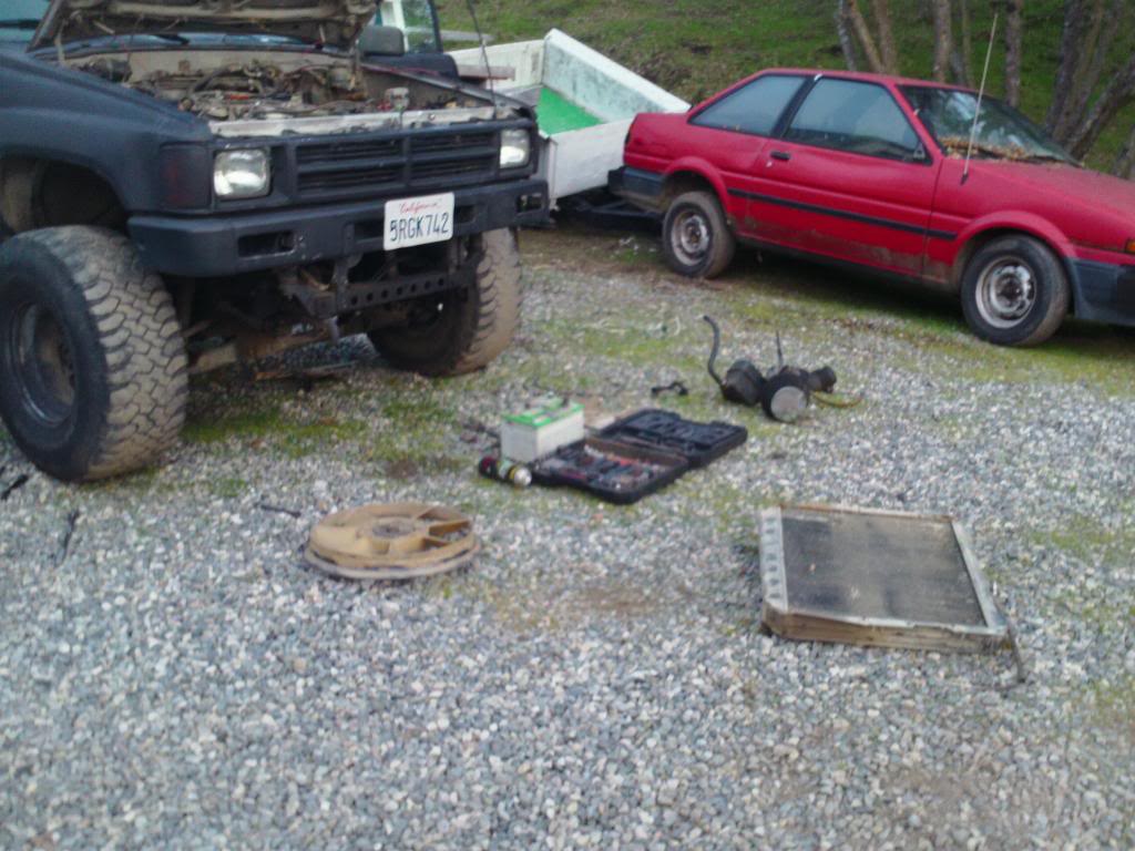

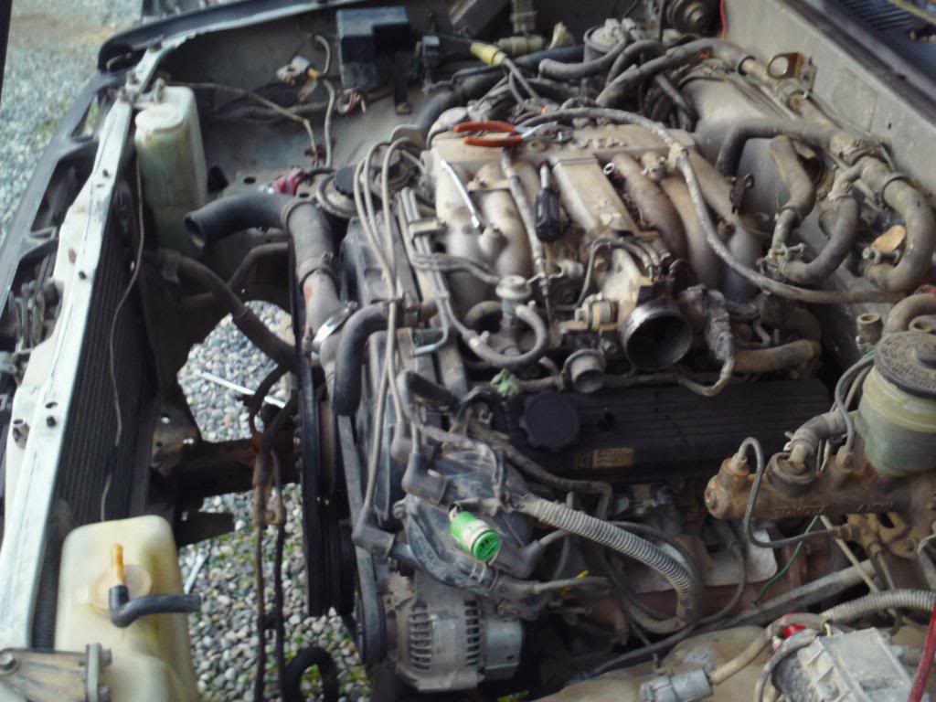

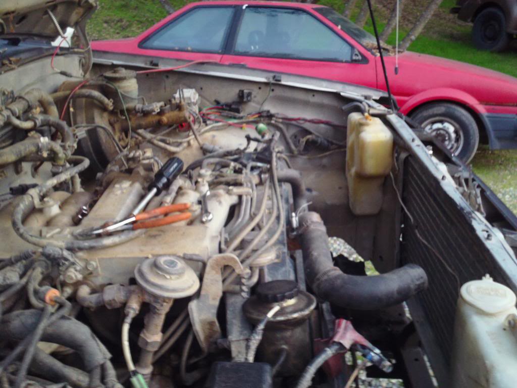

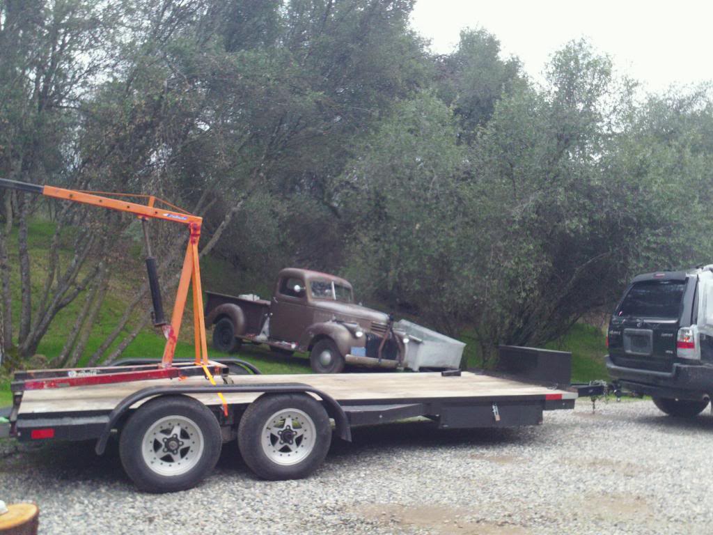

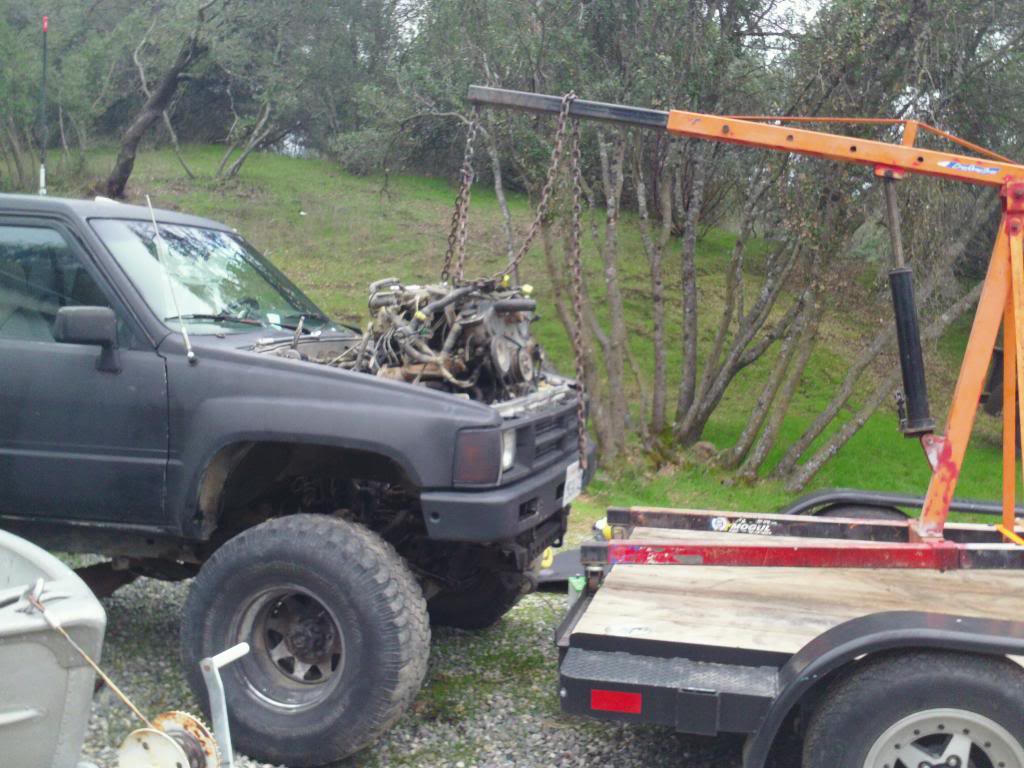

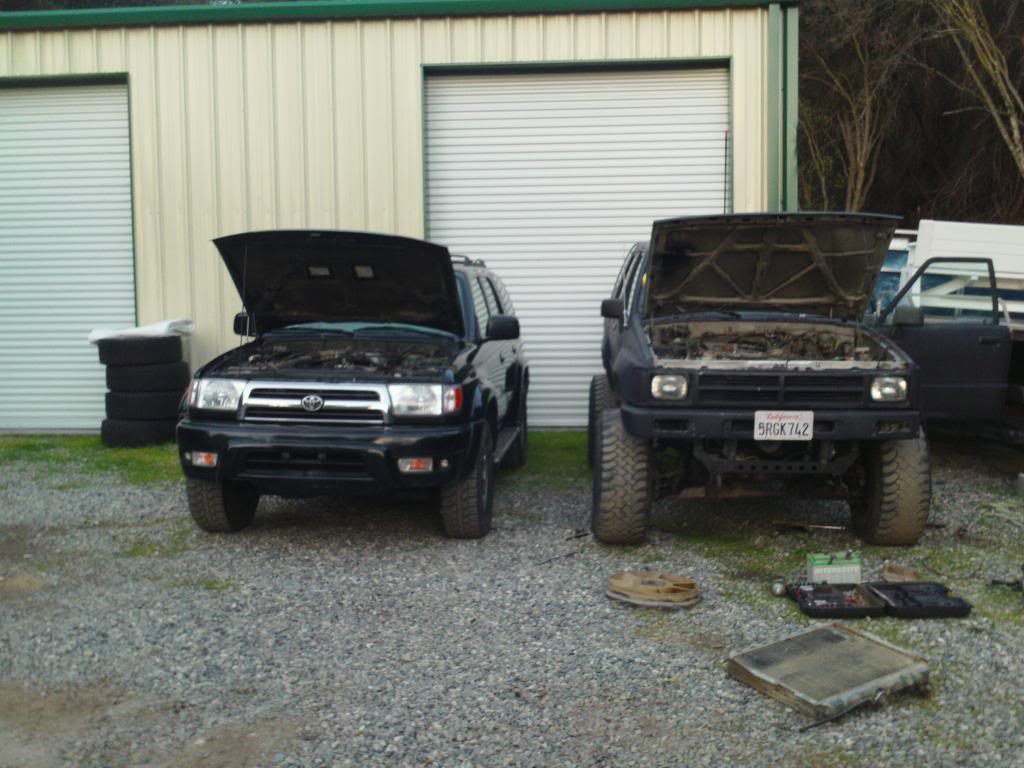

I made the ever so slightest bit of progress today. Put my son down for his afternoon nap and got to work.
While he was asleep, I managed to get the battery, radiator, fan, and intake off and out of the 88, disconnected several body-to-engine electrical connectors, removed the exhaust from the headers back (nothing was holding it on besides the 3 bolts to the headers and the support bolted to the bell housing), and removed all 4 engine mounting bolts and most of the bell housing bolts. I got a lot done in a very short amount of time.
The project is finally underway.
Sorry for the low quality pictures. It was starting to get dark, I was using the video camera (since I couldn't find the good camera atm), and I was holding my bouncy son in my other arm.

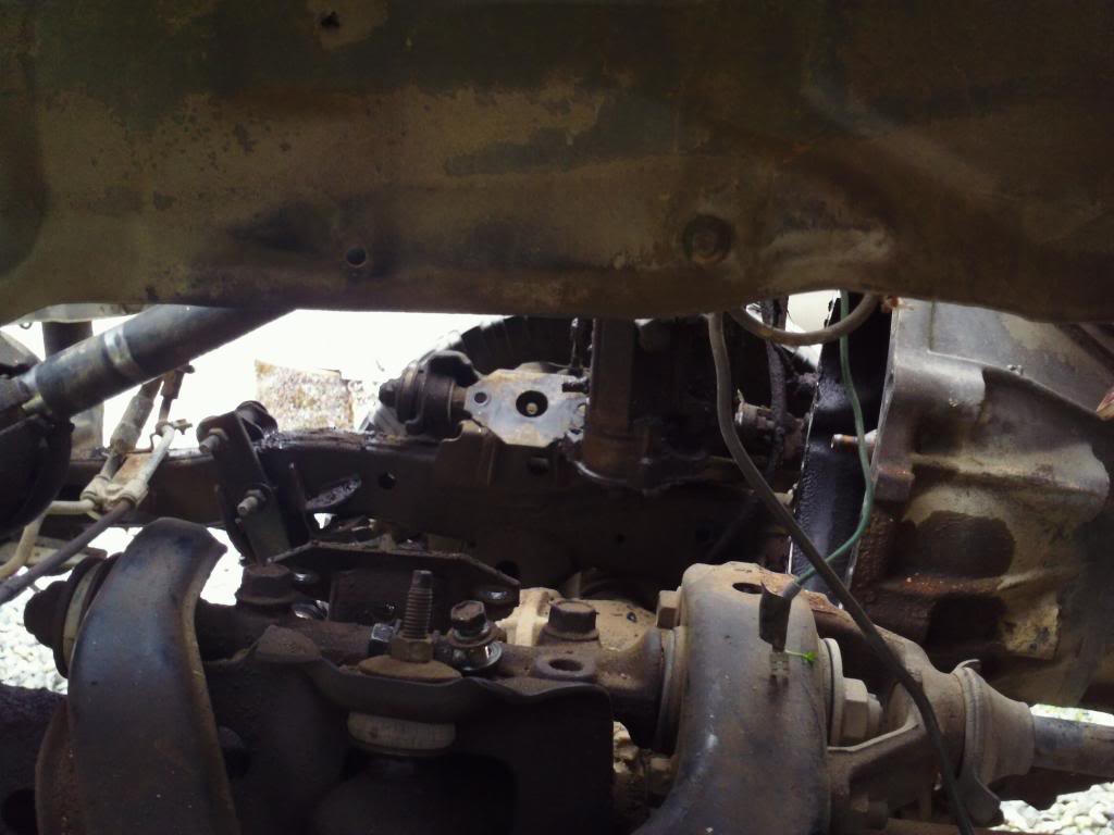

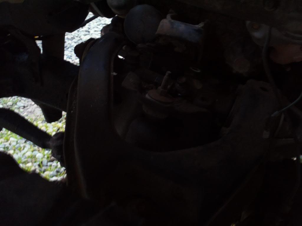

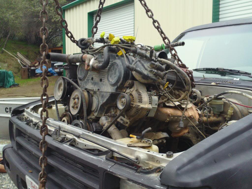

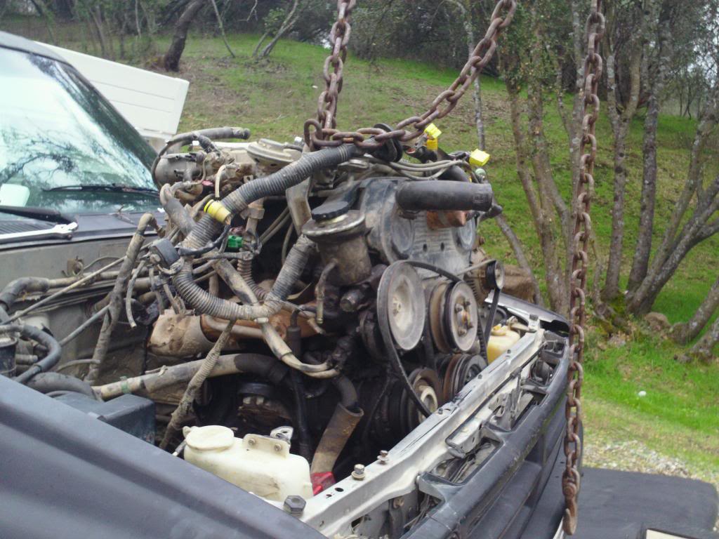

Made some progress today! So exciting. I knew when I parked my 4Runner where it is that that might be my last time driving it for a while, but the reality of that never sank in until now.
Some people are more mechanically inclined than by technology, I am more inclined by technology than I am mechanically. So I tend to go a little pic crazy and in depth with my story/experience. Oh well.
I made a few beginner/rookie/teen/unacknowledged/impatient mistakes, but I'm not too worried about them. This is how the 4Runner sits right now.
I didn't have any plywood to put on the ground, and didn't feel like taking the tires off to lower it, so I used my new car trailer and extended the boom. Was just a bit short, but worked fine.
On the driver side, I need to disconnect a ground strap, seen in the pic. On the passenger side, I need to disconnect a rubber hose going to the evap canister and the AC lines.
I had no idea (and would never have thought to check) that the slave cylinder line was mounted to the block. (My thought process would have been: master on body, slave on tranny, line not on engine.) So it's a bit mangled, but that's the only thing I have to replace so far.
The donor doesn't mind helping out while it still can.

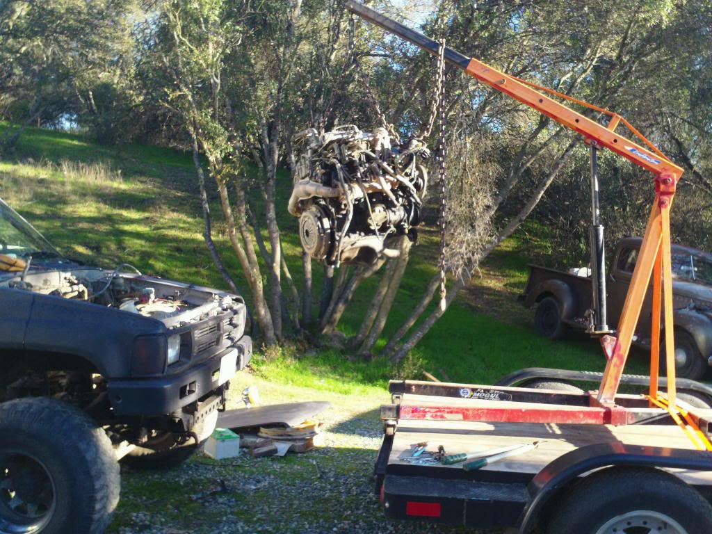

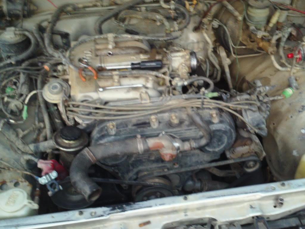

The 3.0 is Out!
After so long of longing for this day, the 3.Slow is out.

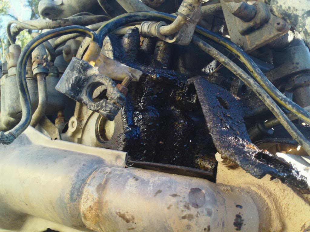

I am not completely happy with the way I resolved a few problems that were holding the removal process up. PLEASE do not flame me for what I did. They were my choices, consequences I will have to deal with, and expenses I will have to incur to mend.
As I mentioned in the last post, I accidentally mangled the clutch line because I didn't realized it was attached to the engine. I cut it. It was going to have to be replaced anyways.
The AC lines had some kind of weird coupling I couldn't figure out. I do not intend to run AC in my truck anyways because as soon as it is not to cold to take the doors and top off, they are off. I never use the AC. The lines, cut.
I actually attempted to remove the PS lines properly. When I tried to unbolt the fitting from PS pump, the nut behind the fitting turned as well. As I was out of time and my son was going to waking up from his nap soon, and I wanted the damn engine out, I cut the line. (After doing so, I realized that the rubber coating of the line was deteriorated in a spot or two and the metal mesh was showing through, so it was going to have to be replaced anyways. Maybe that explains the PS leak I had.
I'm going to be doing a 3" drive train lift to accommodate the 3" body lift. Therefore, I'm going to drop the tranny too so that it will be easily mounted to the 3.4 before it goes back in.

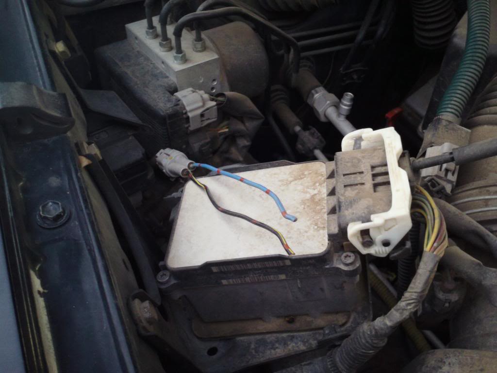

Lastly, I found this snipped plug on the 99. Does anyone by chance know where it goes to? I searched for it yet. I am not yet at the point for it to be a necessity to know, so that's why I haven't done so. Figured I'd ask though.
