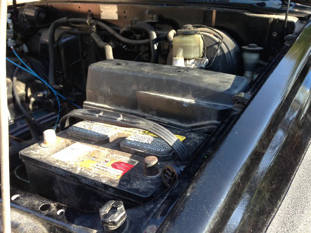

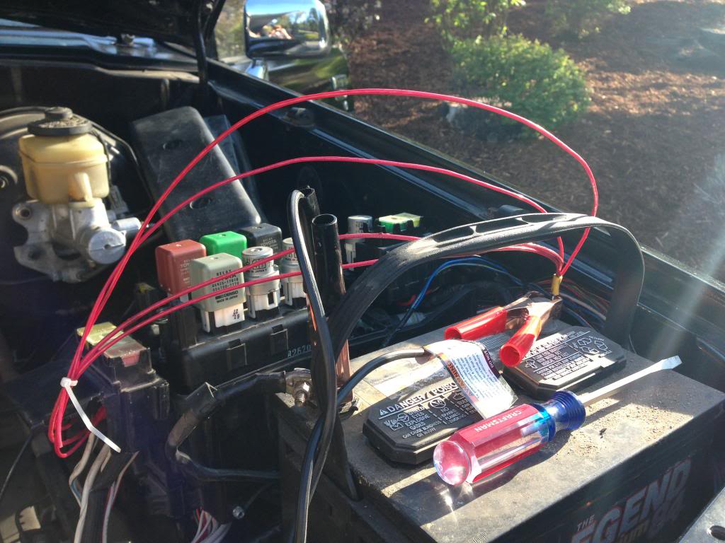

Just a little update:

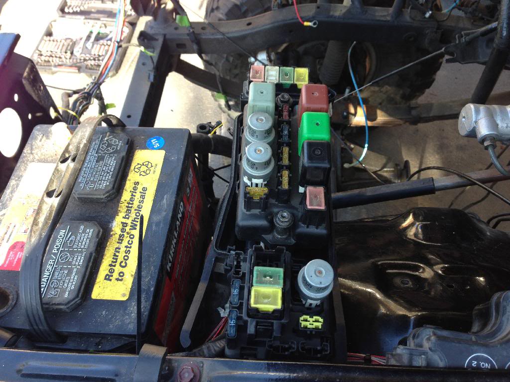

The fuse/relay box is somewhat mounts. It need to be refined a little, but it is in place and holding the contents.
With the lid, yes the hood closes:

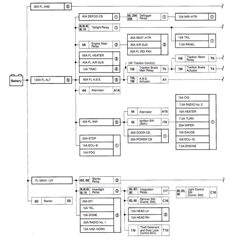

I have gone around and connected all the harness grounds to the body and then the main battery cable ground to the frame.
According to the FSM the battery + connection goes to the fusible links seen toward the very top of the first photo on the fuse box. I have created a little mini power harness to go directly from the battery to those for testing. That should get me power in my harness in most places. I have also connected the opening circuit relay that is attached to the ECU (just plugged in it hoping it would help). I've got nothing at the moment, so I must be missing something. Not even the sound of a single relay clicking.
It was quite the disappointment, but I need to get my multi-meter and see what the heck is happening. Unfortunately, it is not with me at the truck and I won't be able to further test without it.
Seems pretty straight forward, but something I'm not seeing.

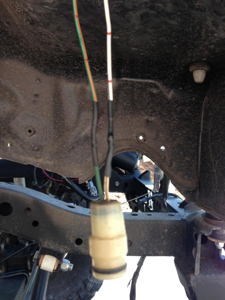

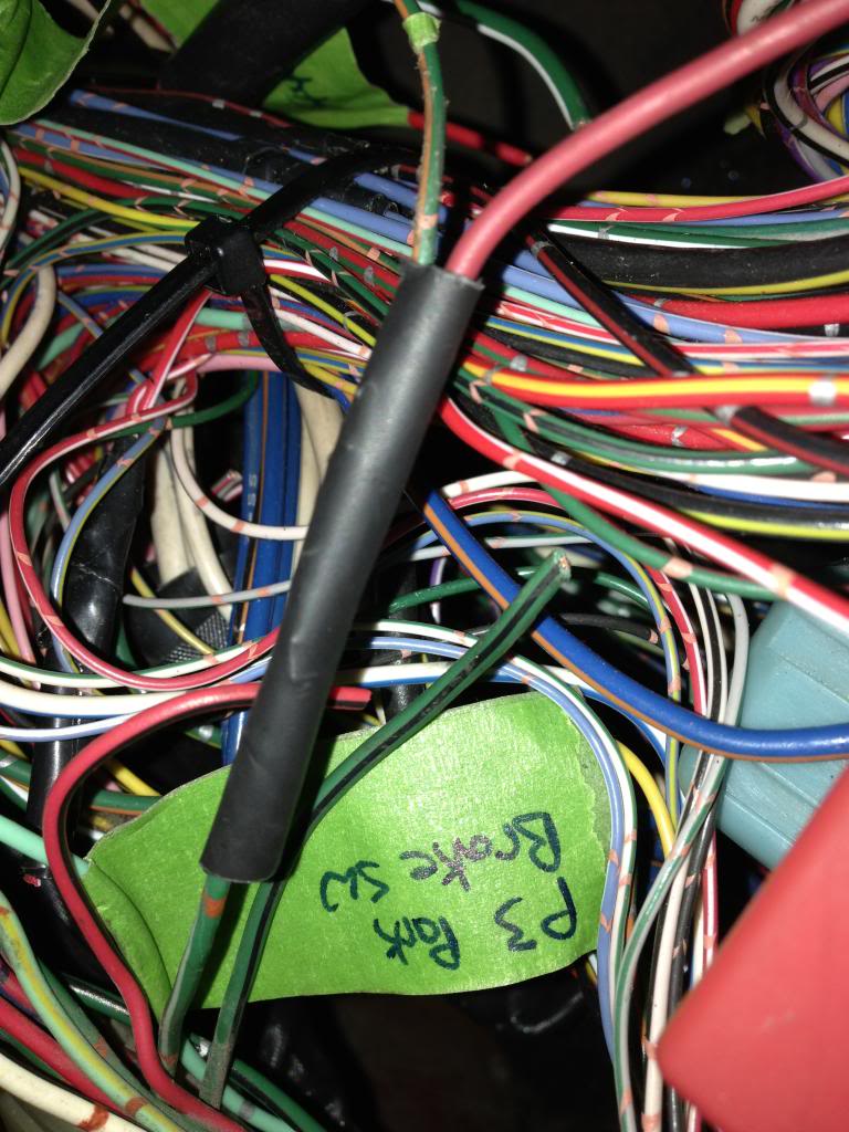

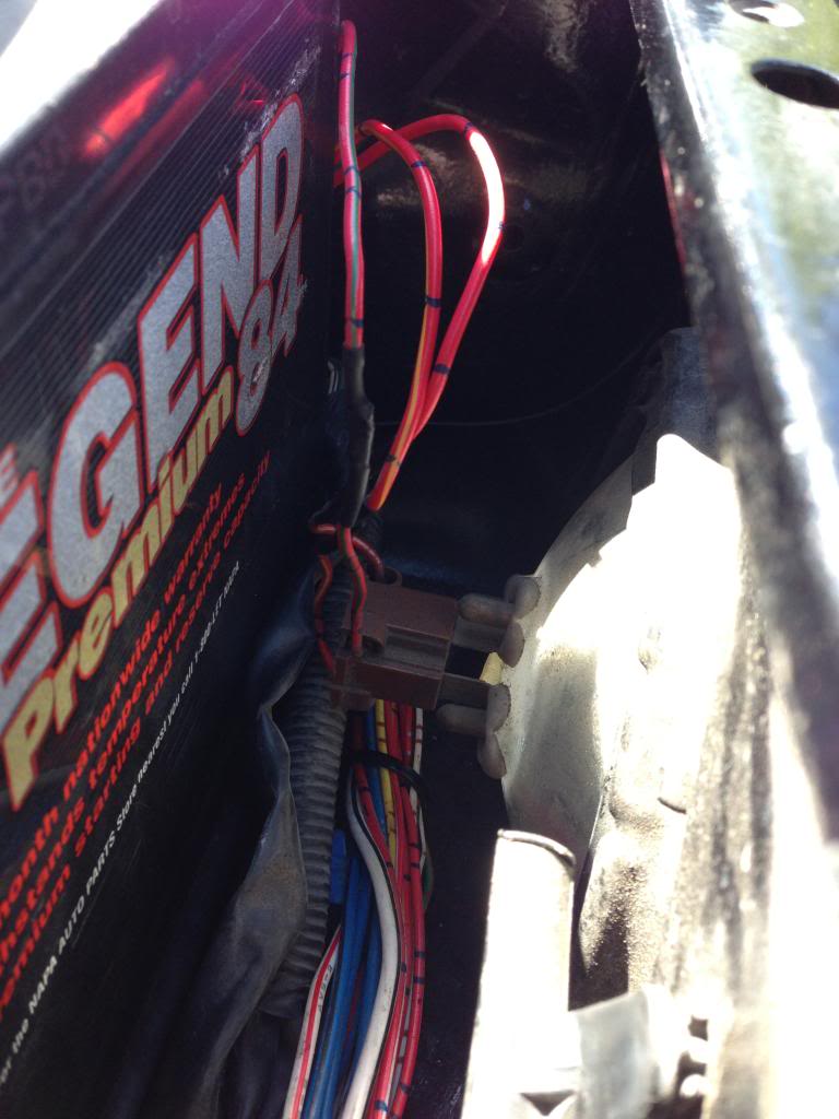

This is pretty straight forward. The headlights, front marker lights, and front blinkers have all been this way.
Toyota likes white/black for ground.
The headlights, match the two wires that are the exact same in color and then the last of the three wires splice together. I did look all this up in the wiring diagrams before doing so. The headlights work.
The front blinkers and side markers are the same. There is one wire that matches (ground: white/black). Solder that and then simply solder the other wire that is left to splice in these to components. Just one photo since they are the same on both sides and for the blinkers/sidemarkers.

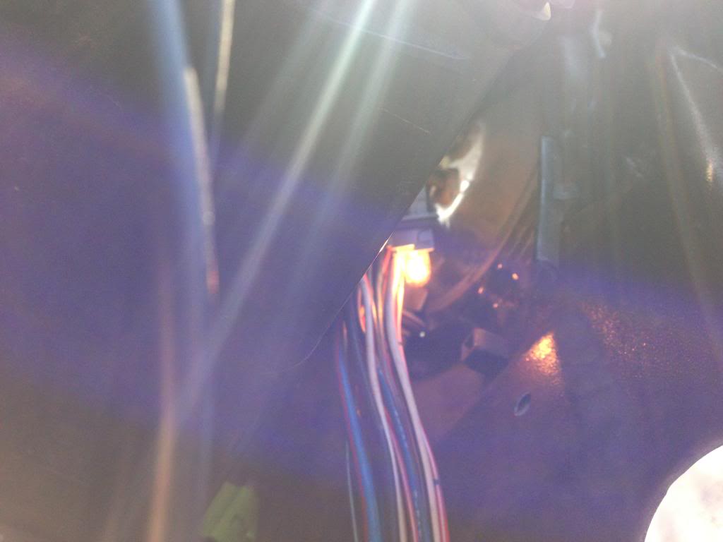

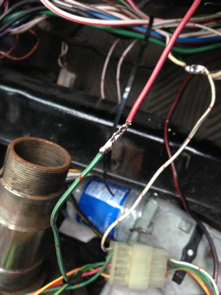

This is for the rear running lights. From the connectors that come in by the step seal/tread/trim on the toyota (whatever you want to call it), there is a couple white/black wires. I tied these together and then tied them in to the ground points by the kick panels on both sides. This should hopefully ground anything that needs it from the rear of the truck if it is not already grounded. Then there is the green/orange wire that controls the rear running lights on the lexus harness. Solder that to the green wire on the toyota harness that comes from the rear of the truck. You have to do this on both sides of the truck. The red wire you see is a jumper from the driver side to the passenger side of the vehicle. The green/orange wire does not route to the passenger side otherwise.
And a sad excuse of a solder job for the passenger side jumper wire. You should connect to the pure green wire for the runnning lights, not the green/white (i had it mixed up).
I did do the backup/reverse lights too, but must have forgotten the photo. This is a red/black wire (lexus) that goes to the same place on the toyota harness as the rear running lights and connects to a red/blue wire.
Red/black Lexus --> Red/blue toyota (have not tested this as I need to install the switch still).
And a couple photos to show the progress:

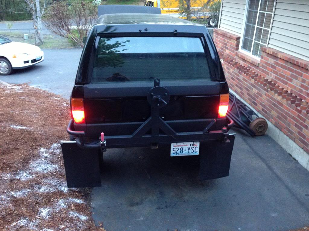

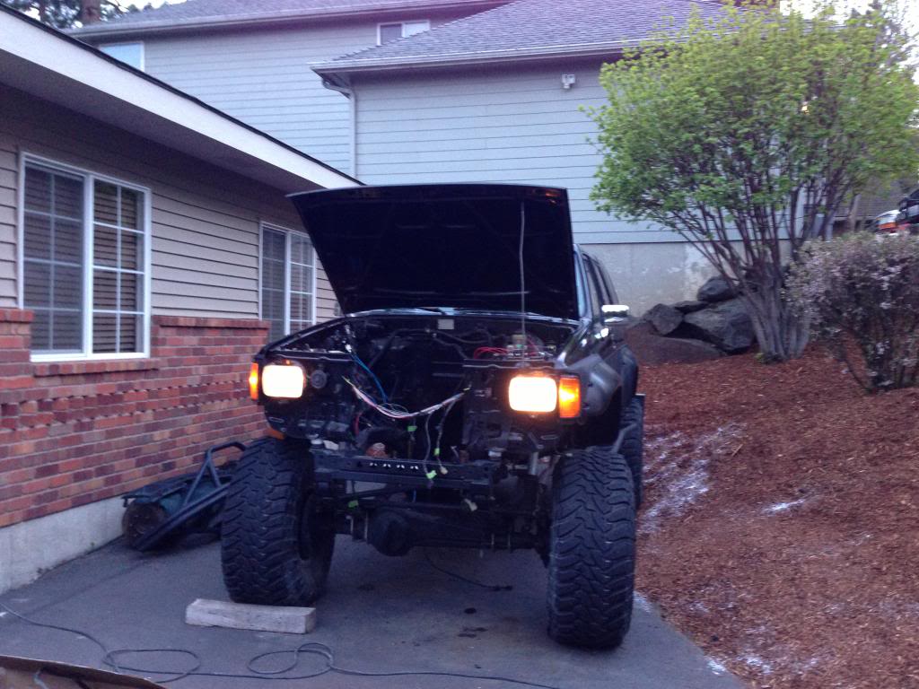

I have wired up the rear brake lights now. That was simple. Green/white on the lex harness to green white on the toyota harness. Green white on the lex harness is accessible on both driver and pass side of the harness, so it was easy.
I replaced the brake switch on the toyota with the one from the lex. It was a direct replacement. I had to extend the plug on the lexus harness to reach the location of the switch. That was very easy to do.
The rear blinkers have been hooked up and the hazards work on all corners.
I used the lexus horns, so that was plug and play. I may have to extend the wires for final placement, but they worked first try.
The reverse lights are hooked up too. red/black on the lexus harness to red/blue on the toyota harness. I have to wire in the switch to test it. I forgot the switch today, so I will try and do that tomorrow. Once I get the reverse lights hooked up then I get to move in to the interior and work on hooking up the interior ancillaries.

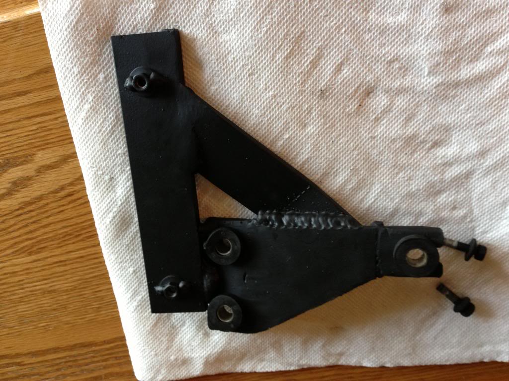

Another update. Not much as I'm trying to finish up the loom, but ran out of the split loom stuff and had to order more. I should hopefully have it saturday so I can finish over the weekend. If I can then I'll shoot a few photos of all the wiring.

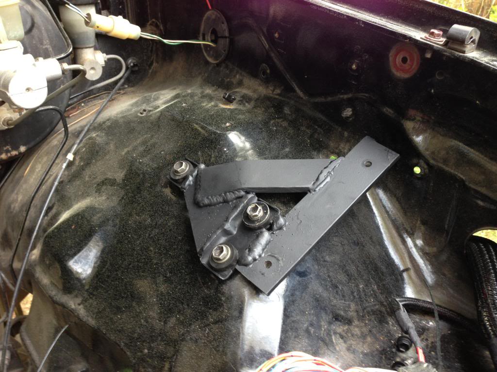

The bracket that was built to hold the lexus fuse box in the engine bay. I took the old power steering fluid reservoir and welded the base together (mounting points on the bracket) and then cut the tank off and then welded another piece on for the fuse box to bolt to. The last piece is just there for stability of the whole thing. I also welded the nuts to the back side of the mounting side so you can easily bolt the fuse box on to the bracket after bolting the bracket to the truck.
Yes, the bracket may be a little overkill, but it was what metal I had at the time that would work. It is now very sturdy, where before it was sloppily bolted on and unstable simply for fitment purposes and wiring.

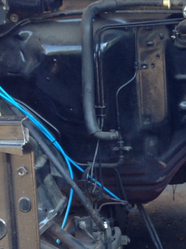

Anyone know what the interchangeability for gas tanks are in the 1st gen 4runners? I have an 84 4runner with a 22r. I want to get one from a 22re or maybe even the v6 with the in tank fuel pump. Which ones will be a direct replacement for my 84 4runner?
Models?
Years?
Truck/4runner?
2WD/4WD?
Engine?
Anything would help in finding one, if you know about the interchangeability on them.

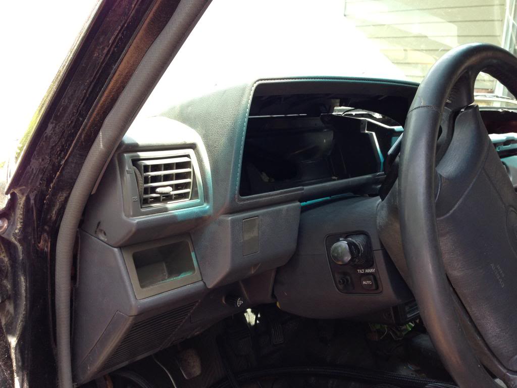

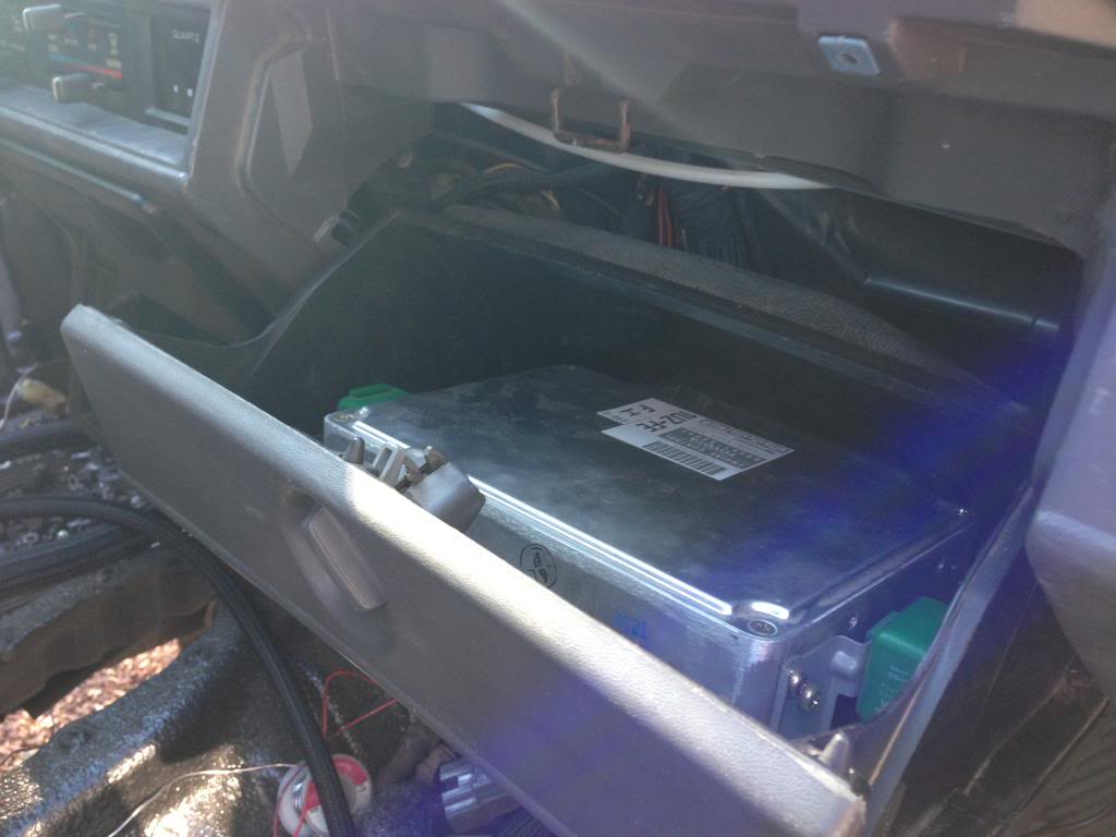

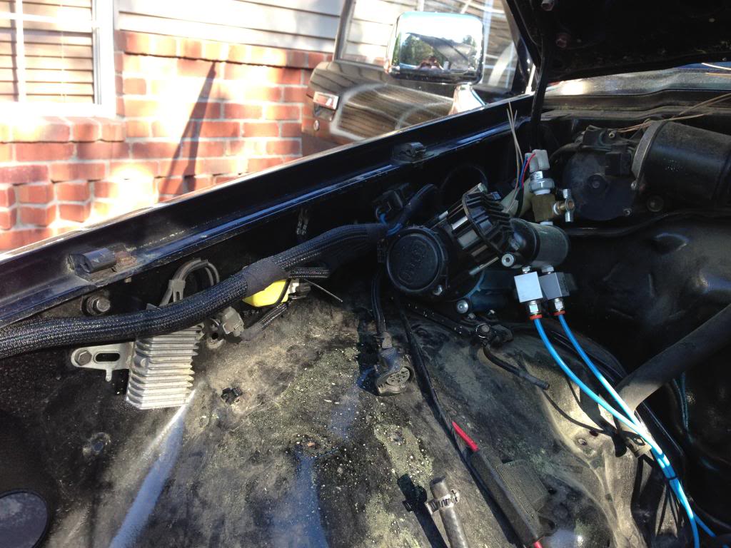

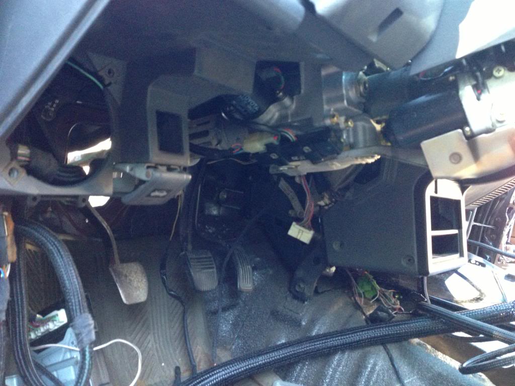

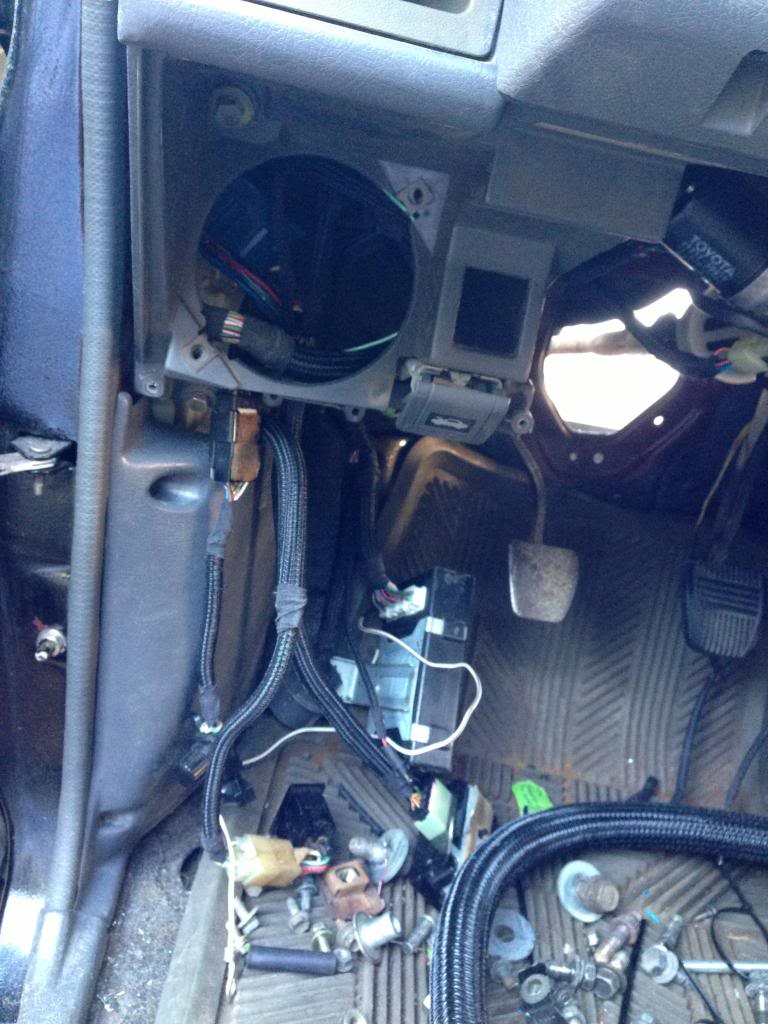

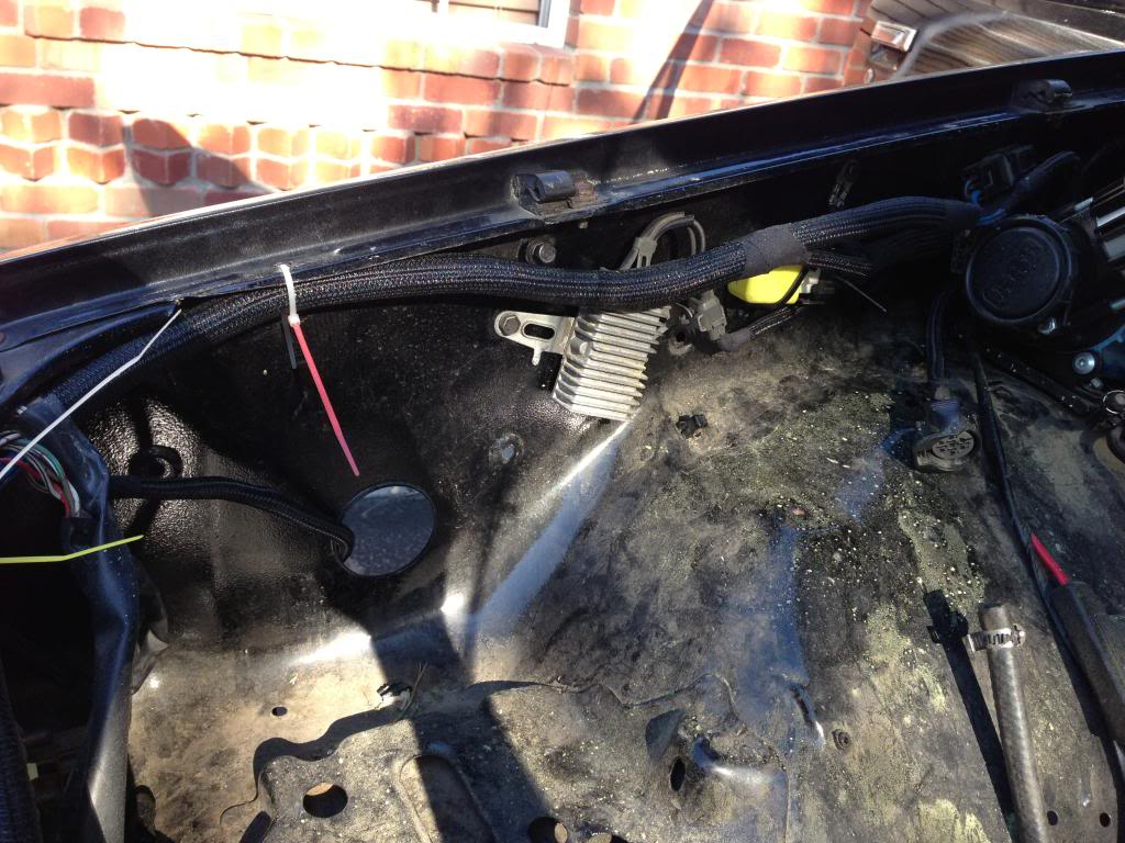

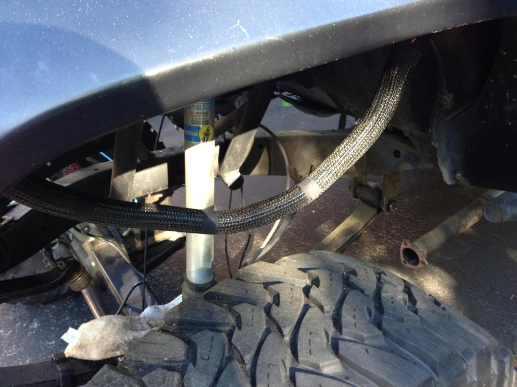

As promised, some wiring and dash pictures of the progress over the last month or so.

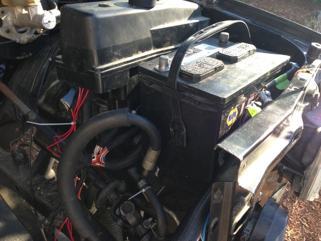

Engine bay. pass side.
This will be cleaned up a little. The red wires you see are temporarily there for testing the electrical system without the engine harness in place.

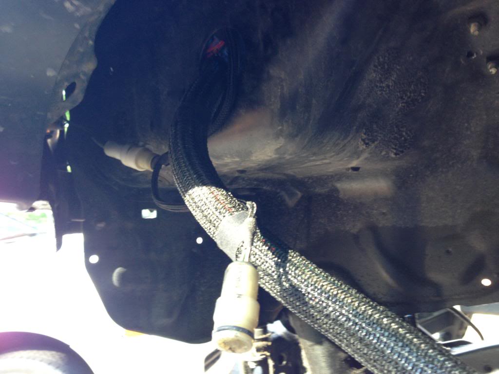

Just a pic of the driver side harness that goes from the cab to the engine bay. I still need to secure it in place, obviously.

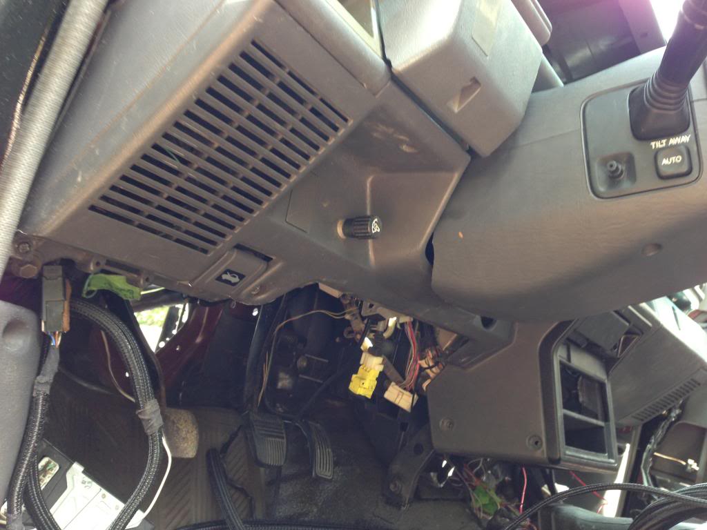

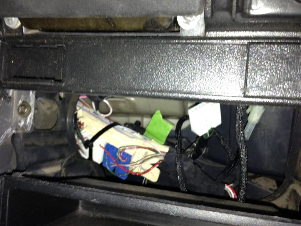

A shot of the lexus wiring and lexus fuse box behind the kick panel. It is a snug fit, but you can coax it to fit correctly. It is being held in by zip ties, which actually work extremely well and secure it very well (2 of them)
Just an under the dash shot. A few stragglers that need to be cleaned up, but mostly tucked away.
I need to clean the floor boards, but you can see the ECU related part of the harness and the part that attaches to the engine side of the harness that will come through the firewall behind the glove box. I need to tuck those behind the dash and route the appropriate plugs in to the glove box where the ECU is located right now.
A nearly perfect fit.
A shot of some wiring behind the radio area.
Blinker/marker plugs:

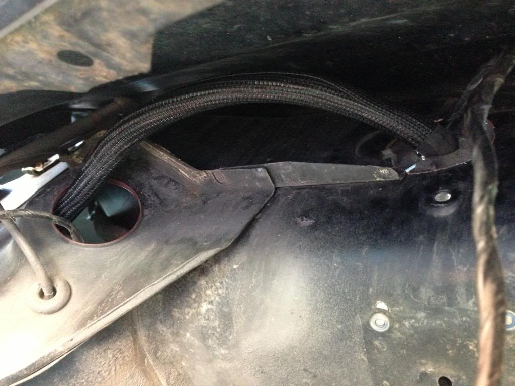

Passenger side loom from cab to engine bay, I drilled a new wire loom hole the same size as the ones already in the engine bay so I can use the same grommets that were already in use.
I ran a large portion of the wires that came from the fuse box behind the driver side kick panel over the heater core area behind the vents. The original yota harness was actually ran this way as well.
A shot of the lexus steering wheel with the garnish and appropriate dash pieces in place. It surprisingly fits very well and I had to do minimal trimming to the lexus steering column plastics and toyota dash to get full movement out of the electric steering column.
Another shot from the underside of the steering wheel. You can see where I made the cuts, but not very noticeable. The pass. side of the steering wheel required a little more cutting because of where the key/ignition placement is, but I must have forgotten to photo that. Still not bad though considering a completely different setup is in the truck.
