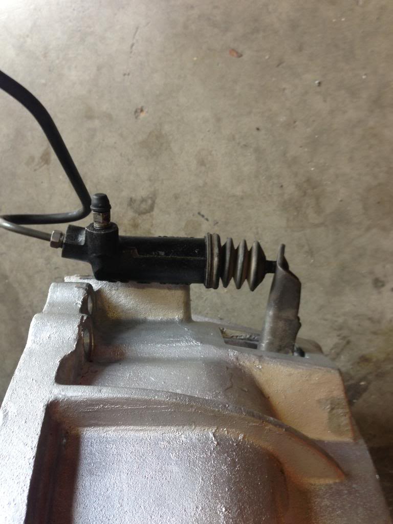

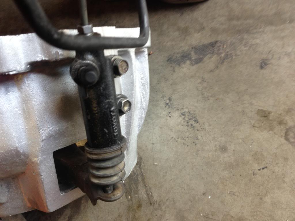

I was able to make some progress on the bell housing. This is the KS bell housing from the ebay guy from Thailand.
I trimmed 30mm off the mount. I didn't want to go more as then the slave cylinder would get in the way of the bolt that is right next to it. It seems to be near perfect.
For future people reading this. I simply used an angle grinder to cut if off after measuring 30mm. Then use a 17/64" bit and an M8x1.25 tap. Simple enough and it turned out well.

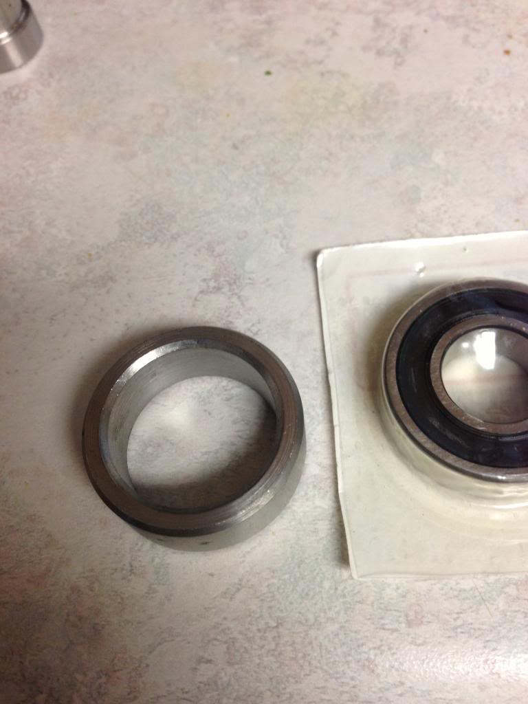

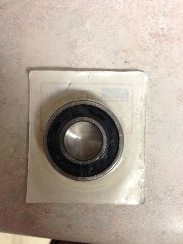

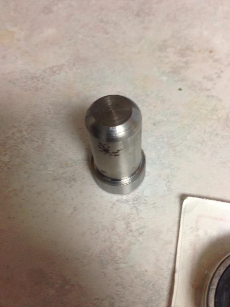

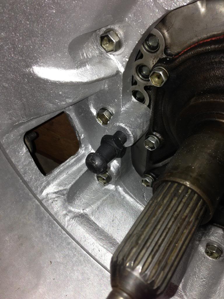

Here are some more pics:
pilot bearing included in the kit from KS racing (whatever his ebay ID is):
Apparently the R150F (3.0 Version) is just a tad to short (input shaft), so they include this adapter to put on it. Why they wouldn't just make the bellhousing a little shorter blows my mind. Maybe I'm overlooking something though.
What the hell is this spacer for? Anyone?

#124
Joined: Oct 2009
Posts: 1,044
Likes: 6
From: Centeral Willamette Valley Oregon
Only thing I can figure is that it was cheaper to use the pilot bearing they did rather then have one made. The hole for the nipple on the output shaft was too small so they used an adaptor.
What the hell is this spacer for? Anyone? I don't remember seeing that in my kit.
I told you all that I would have some questions during the swap and it seems that I have left them all for the end. I have heard of a few people putting a spacer between pivot ball for the fork and the housing to 'push' the ball out a few more MM. Anyone that has the KS housing care to chime in? or anyone that has knowledge of this.
Some have used the 3.0 throw out bearing and 4 or 5 washers stacked behind the pivot. I used the 3.4 throw out which has a longer neck. I am not using any spacers behind the pivot and it feels good. Hind sight I think I could have run 1 washer for spacing and would have been great.

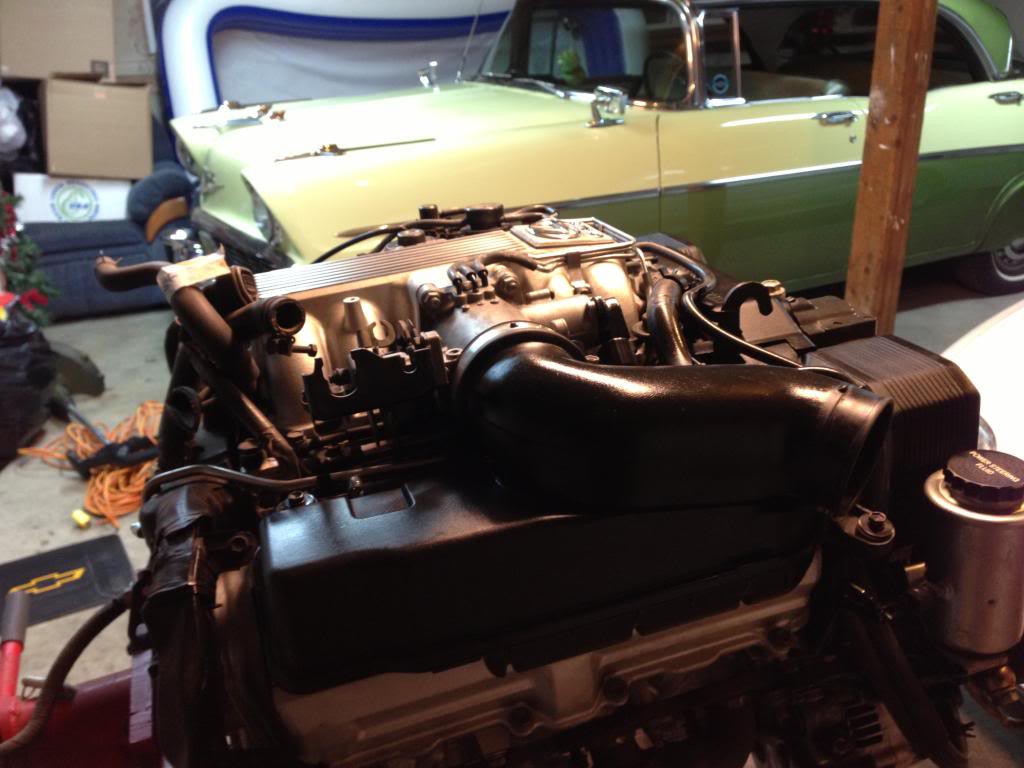

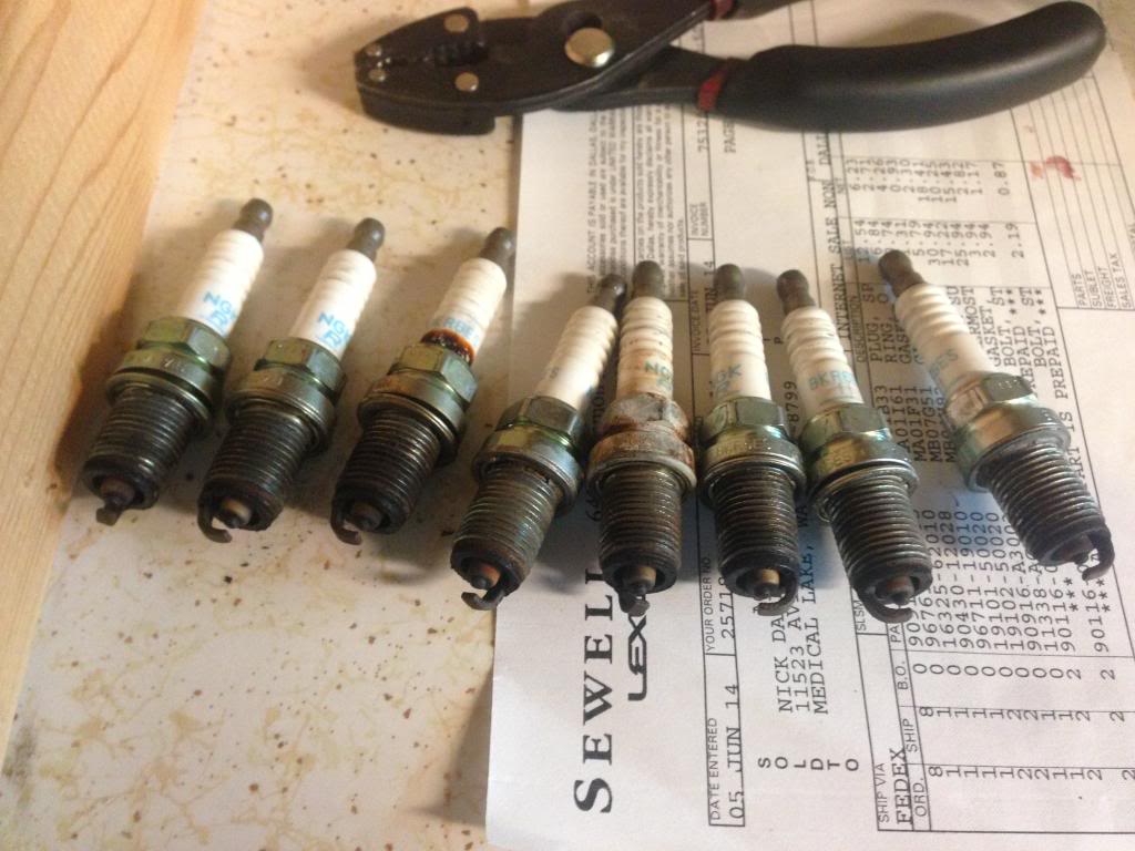

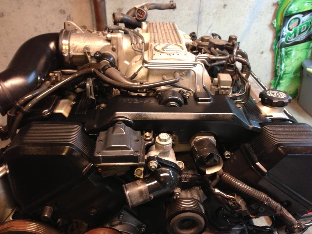

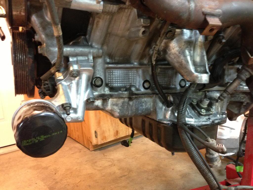

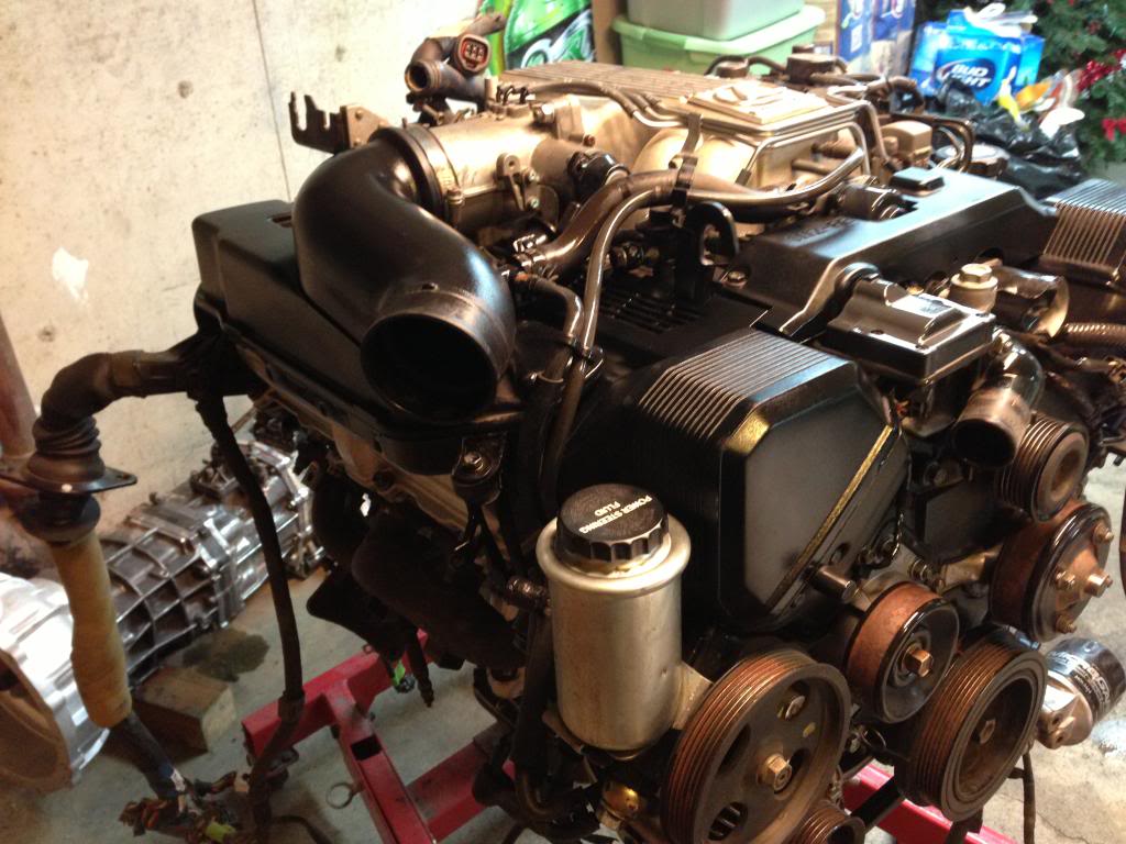

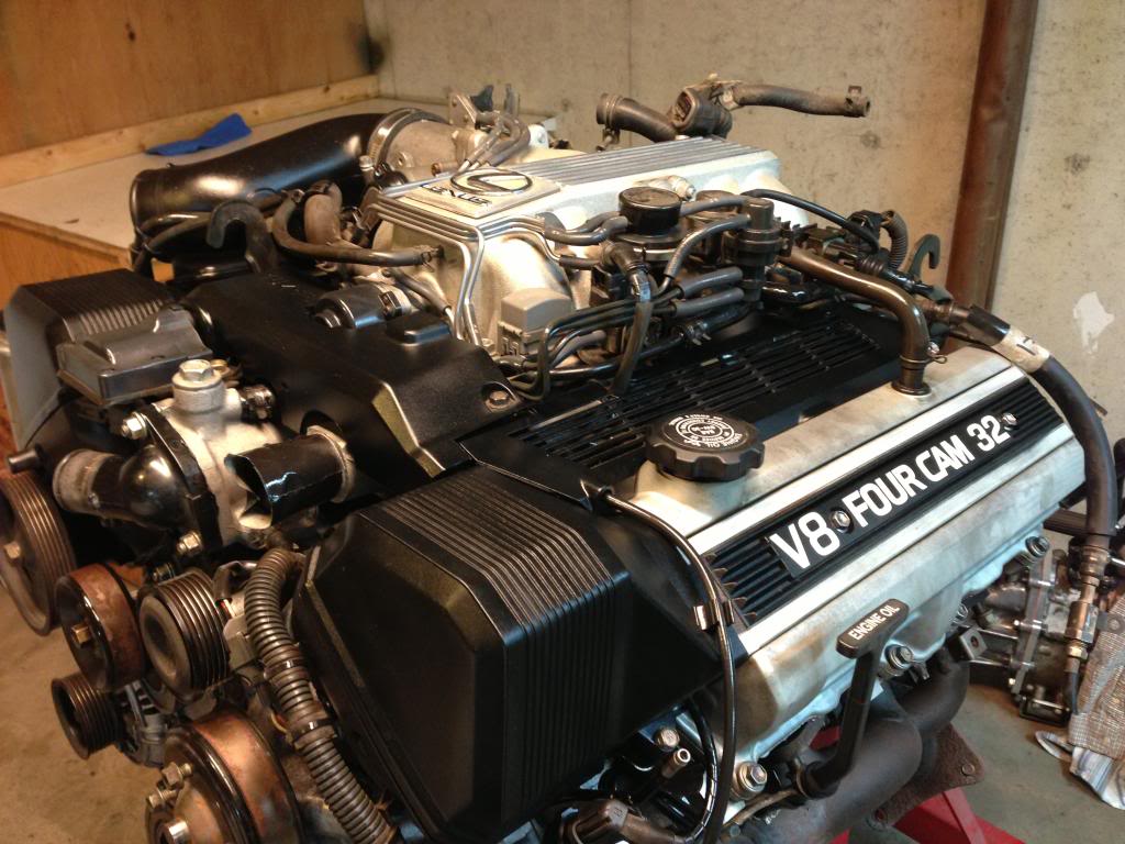

here are some shots of what I finished up over the last day or so while I've been waiting for parts.
I pulled the plugs and they looked pretty decent. They pretty much all look the exact same. Some are turned a little different in the photo and you are seeing the slightly darker side. I think since the EGR system wasn't functioning completely correct there may have been a little more a little carbon build up, but nothing serious IMO. If anything, it was running a tad rich.
A few shots of the cleaned up engine now. It is ready to go with the exception of adding the EGR tube on that rosslandtoy provided and extending a couple wires due to the sensor locations changing on the oil pan because of the switch from the LS400 version to the rear sump SC400 version.
Anyone that needs an SC400 oil dipstick, just go on sewell lexus and buy one if you can't find one at a yard. They are $35 brand new (tube and stick).
Just a shot of the SC400 oil filter, dip stick, rear sump (really more like mid). The oil pans are a PIA, but what pans aren't I guess. Again, reminder if you need to get an SC400 oil pan setup. Get both pans, oil pickup, baffle, and ALL associated bolts. You'll kick yourself if you do not.
Just another glory shot. haha.

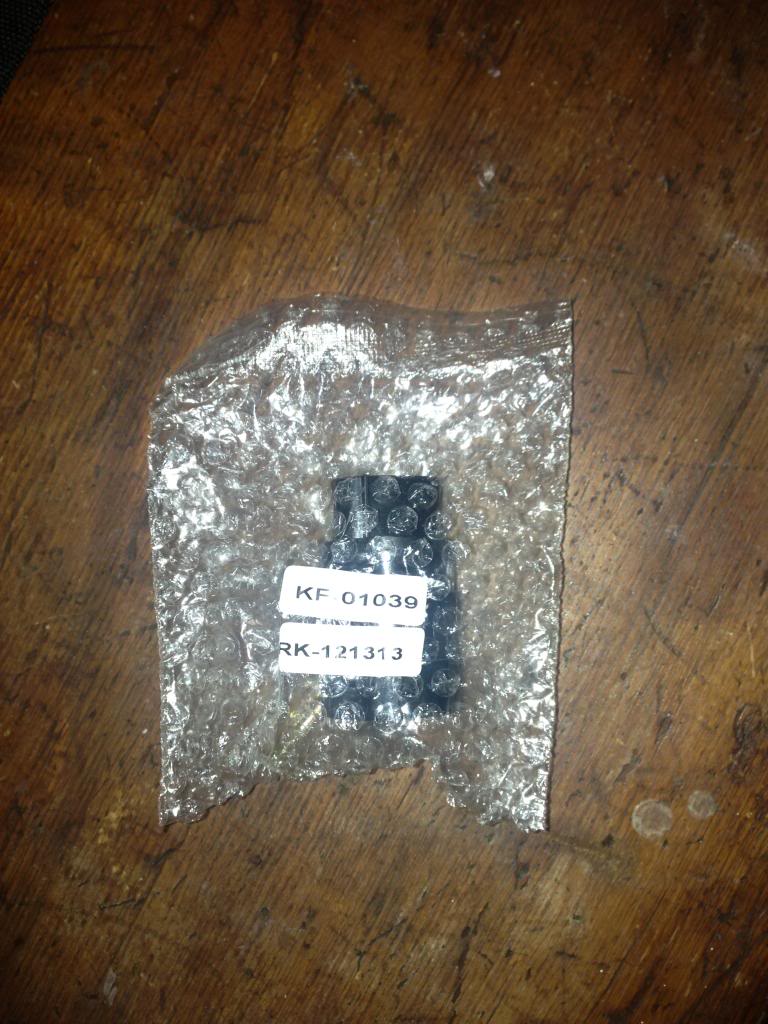

Here is the mechanical to electric speedo vss sensor that I'm using:
Ebay ID: chandlermotorsportsinc
http://www.ebay.com/itm/330484087437...84.m1439.l2649
I suppose the question now is, does anyone have any idea of what where I can get an electrical plug for the other half of this thing? What vehicle/model/etc...?
