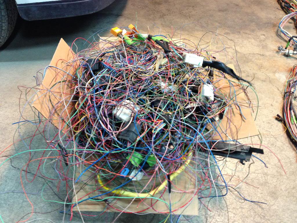

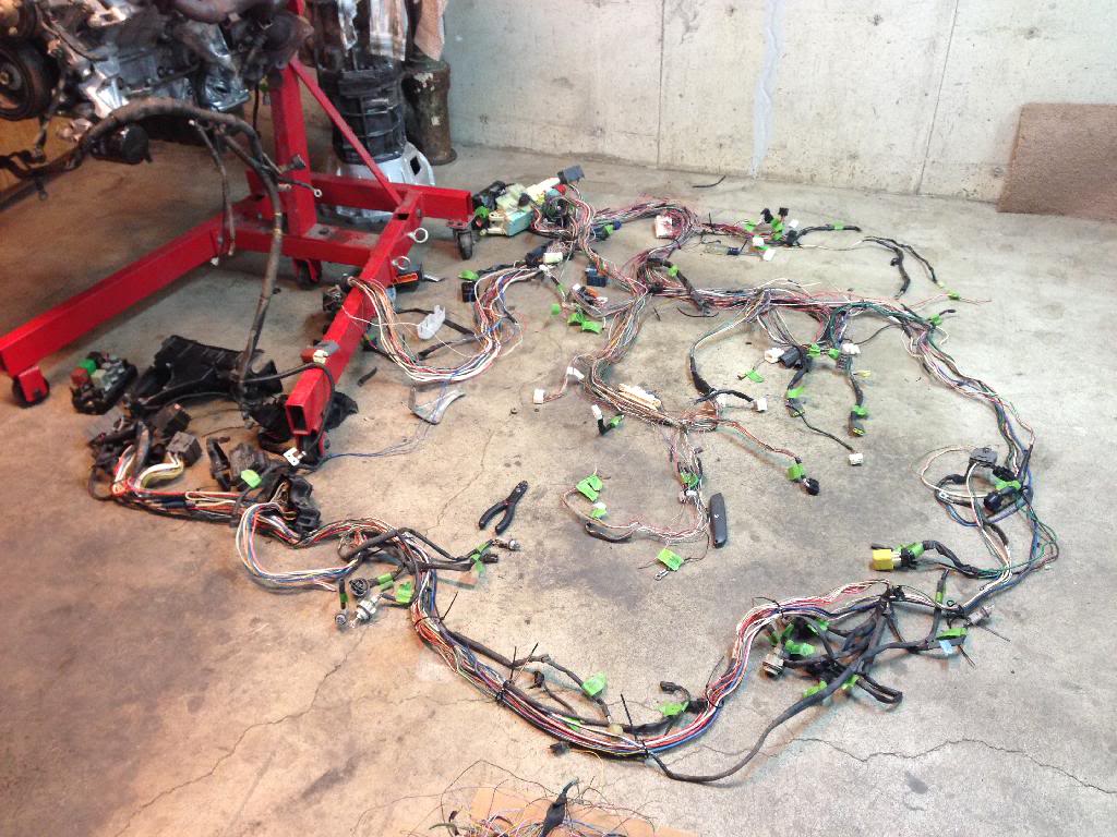

Another little update. Nothing much, but several more hours on the harness since the last update. It is nearly there! I have maybe 5 connectors that I was not able to identify that I need to go back and re-attempt to identify then either remove/keep them. I think I'll go ahead and zip tie the harness in the general shape to tidy it up then take it to the truck, fit it and start working on getting all the accessories working (lights, heater blower, brakes etc...). Once everything is working then I'll pull the harness and wrap it up with the split loom techflex. It'll give it a nice clean look and I can always add wires to it down the road if I need to. This way I won't have a 'birds nest' in my engine bay if I need/want to add wires down the road for something I accidentally may have removed that I shouldn't have or for an accessory.
Essentially once I get all the accessories working then I'll be 99% done with the wiring for the swap because the engine, cluster, steering, cruise etc.. are all plug and play. I will have to wire the fuel pump and a few other little things, but nothing too crazy or intricate.
I do still need to de-pin a few wires, but I will do that when I'm about ready to move the harness to the truck.
