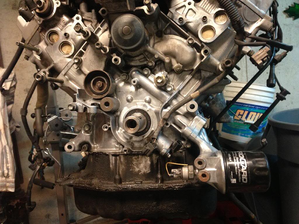

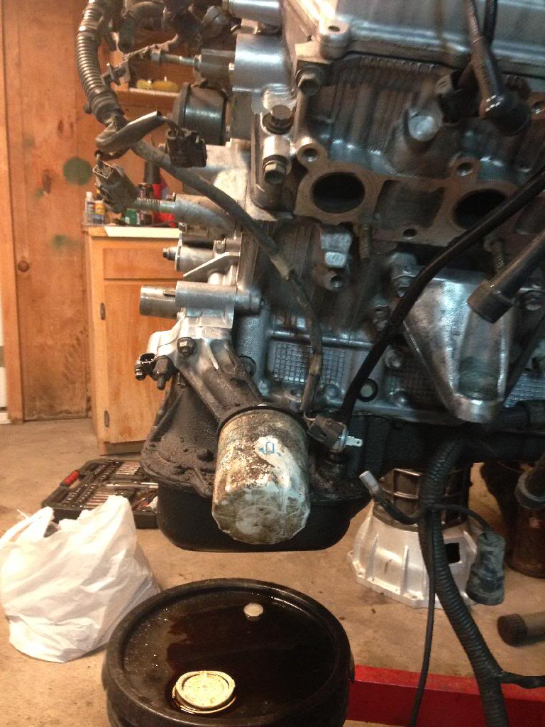

I have the engine about 90% cleaned up. I have put the SC400 oil filter housing in place of the LS400 one. I read in someone's thread that it was needed for clearance reasons in the 84-88/89 yotas. Weather it is or not, I have it and it is done.
I have the SC400 rear sump oil pan setup all ready to be installed too, just have to remove the LS400 setup, but need to grab a couple tools to install a seal and remove the timing belt tensioner bearing. Once I have those tools then I can get this thing back together and start on wiring for it.
A couple photos:

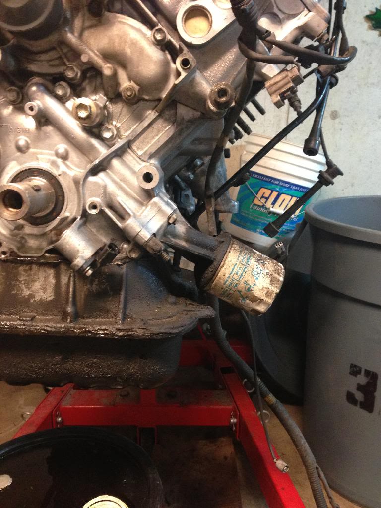

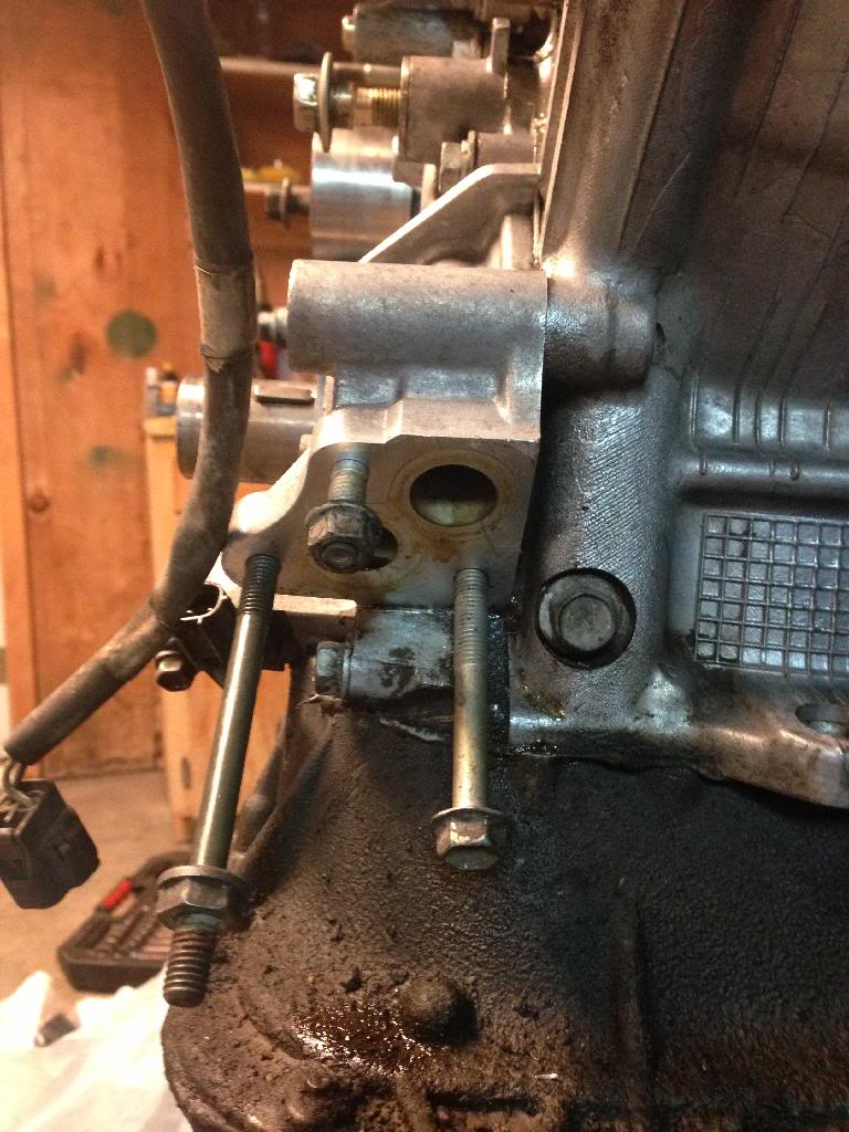

If you swap the housing, make sure you grab the bolt/stud on the left and the right. That actual stud that you see there (middle) is the only that will work with the SC400 filter housing.

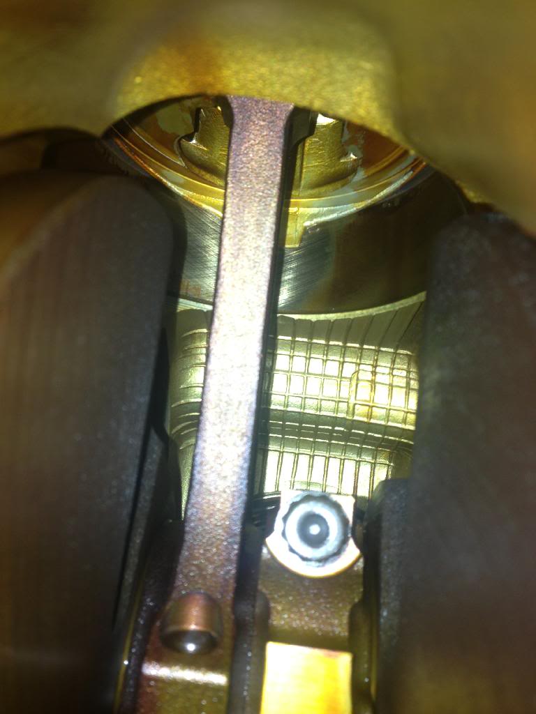

A shot of one of the cylinders. They all look like this from what I could see:

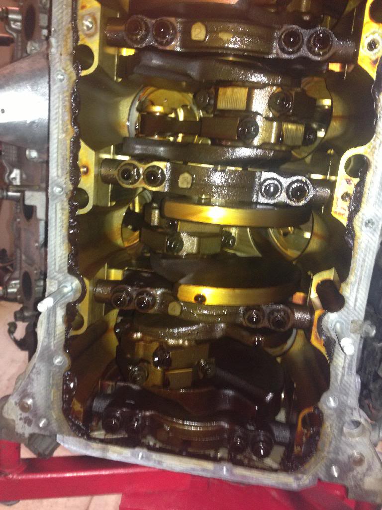

General overview of the underside

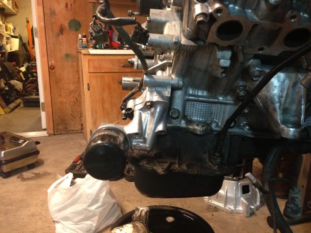

With the oil plan on with just a couple bolts while I wait for the front/rear main seals and the oil pickup/sump gasket to arrive. Somewhat essential.
As far as I can tell from going over the engine, it seems to be in pretty good condition and not a lot of buildup inside for 180k.
Note: if you get the rear sump setup, you should grab the associated bolts with it too. I think I have to change a few out. Luckily, I have box full of the Al bolts from the 1UZ and removing it from the car, so I should be able to find some that will work. If not, I have to order up a thermostat and I can get them for cheap over at sewell lexus. I'm not sure how I forgot to get the thermo.

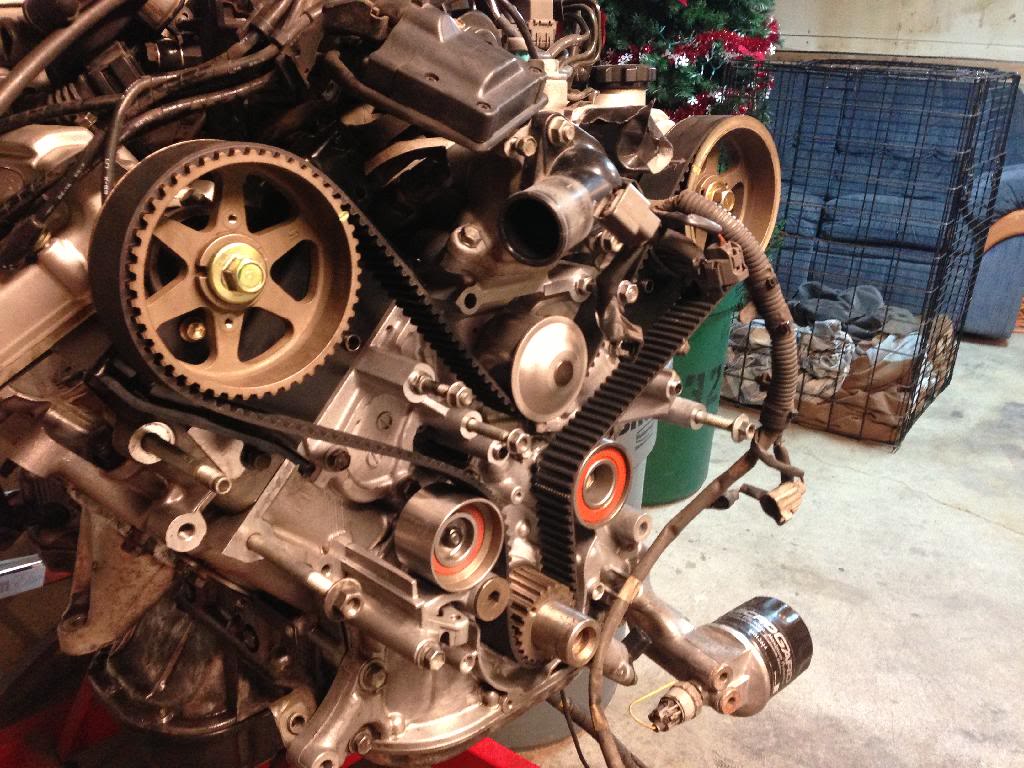

Got some more of it all assembled yesterday. The timing belt was one of the easiest and straight forward installs I have done. I will check the timing with a few full rotations to make sure all the marks continue to line up, but I'm quite confident it will be perfect. I ran out of time to continue cleaning and assembling last night. I may get around to it more today, but for sure tomorrow.

Interesting info for those that don't know. The early 1UZ engines (until 94) are non-interference. I believe, when they bumped the compression a little in 95 then it became an interference.

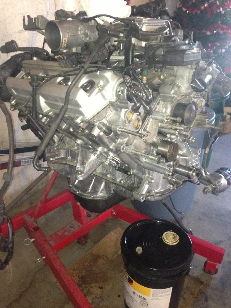

The engine is mostly wrapped up now:
Just have to do the thermostat, snag a couple little parts at the yard when an LS400 pops up, seal the oil pain and button up the valve covers. The oil pan being the largest of the jobs, but I'd say about 90% done and I have to order a few parts to finish all that up anyways, so I have a week to focus on something else. I may just start in on the wiring.

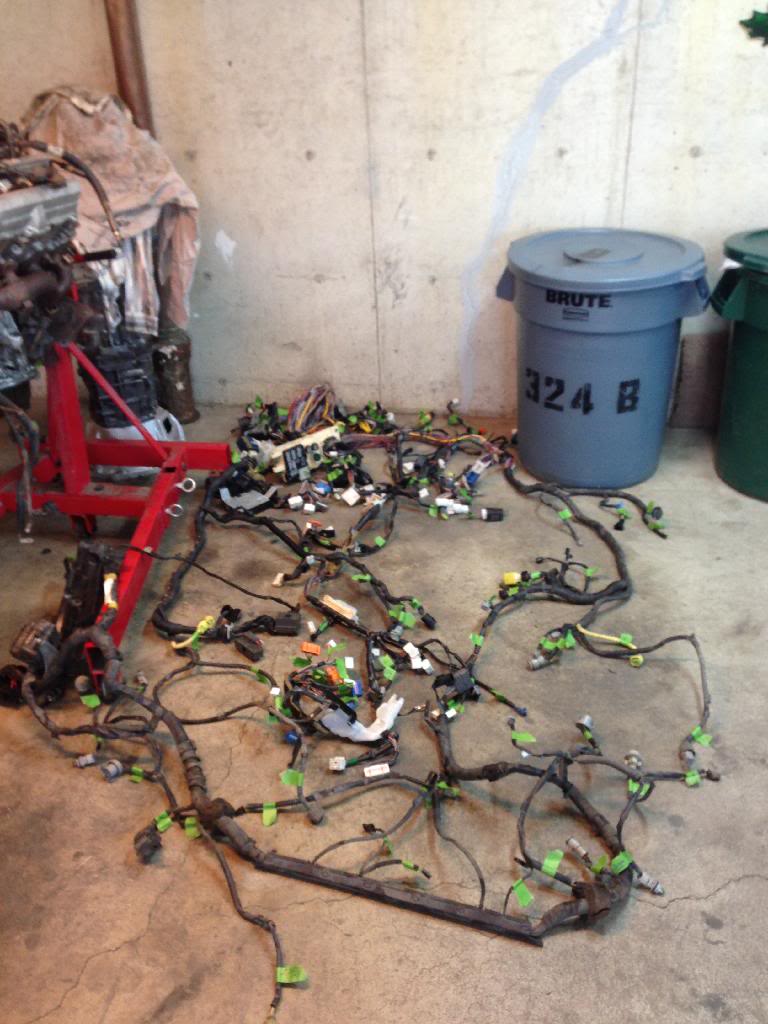

I've got the main engine and cab harness from the LS400 laid out on the garage. Seems a bit daunting, but I have a good idea on how to tackle it. The idea I have here is to keep what is needed in the harness and remove the rest. I am going to start by identify each and every plug/connector via the FSM.
I believe I have found a good way through the FSM to 100% identify most all of the connectors. I should be able to put my theory to test this week. I will label them all and put the connector code on the label and an x next to the ones I will remove and a checkmark on the ones to keep. Once they have all been Identified then I will remove them and then seal up the harness again.
The idea is to be able to completely integrate the harness with the toyota components by splicing on the appropriate plugs. Since the 1st gen 4runners/trucks honestly don't have that many electronics, this shouldn't be toooooo bad once the harness sheds its weight.
If I ever wanted to switch trucks or if I totaled this one then i could simply remove the lexus harness and place it in another truck with a plug and play setup at that point.
Once I get a little ways along with the identification then I will create a list here of what to keep and not to keep so those that have any interest in doing it this way can know what to do. I understand this is not the easiest method, but it is how I have chosen to do it. I'm also sure I'll ask for some input on certain items as well.

Labeling the wiring harness for strip down.

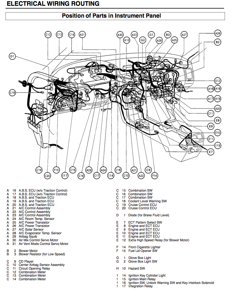

The wiring placement in the LS400 up to about 94
I will make a list of these that will be removed and those that will be kept. I'm sure I'll have some that I'm not sure about and perhaps someone more knowledgeable here on this sort of thing can chime in.

Keep in mind that I have completely removed the dash and engine harness from my 84 4runner as well and will replace it with the lexus harness.
This first list is for the interior dash. I will make a separate list in the same format for the engine bay

A little digging in the manual shows that the kick down switch is when full depressing the accelerator and then sends a signal to the ECU/ECT and shifts the tranny aggressively toward acceleration for the corresponding action with the accelerator pedal.
Long story short, kick down SW (K3) is not needed at all since I will be swapping to R150F tranny

I do have a question. I was thinking of retaining the original wiring for the electric cooling fans in the engine bay. There is also a coolant temperature switch that "trips" these fans that I could likely incorporate as well. What are your thoughts on this?
I started to strip the harness today. I didn't have much time, but was able to mostly strip the very front harness up by the radiator and includes the main relay/fuse box in the dash.
There are two plugs for the fans and I think most people end up going with a two fan setup, so It seemed that it would work out perfectly.

For ease of installation, and the fact that I wanted control over when my fan was on or off (water crossings) I choose to only include the very necessary items in my harness. Hence I am running a flex a lite fan controller item 31163, yes more expensive then the other controller but worth the difference. I wanted to be able to have ultimate control over my fan. I am running a Flex a lite slim boy 119 pusher fan and haven't had any cooling issues.
I believe that this feature was only available on SC engines which run a hydraulic fan setup. If memory serves me correctly people who have tried this have run into issues with the correct temp sense readings as your not going to be running the hydraulic fan setup are you? The ECU ran into issues reading things correctly.
