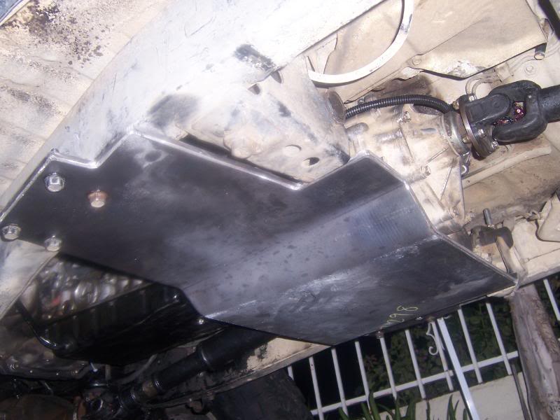

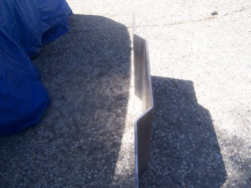

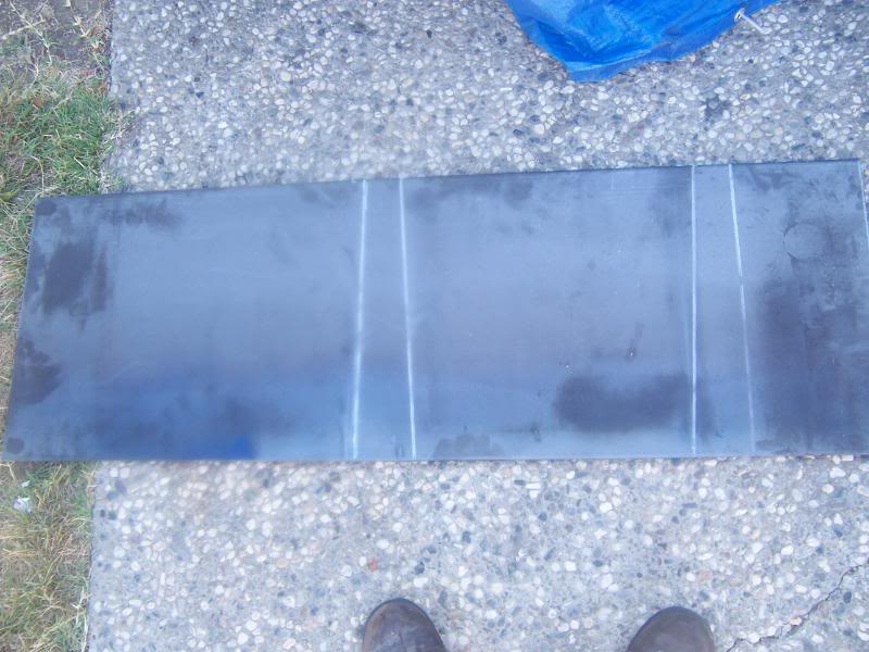

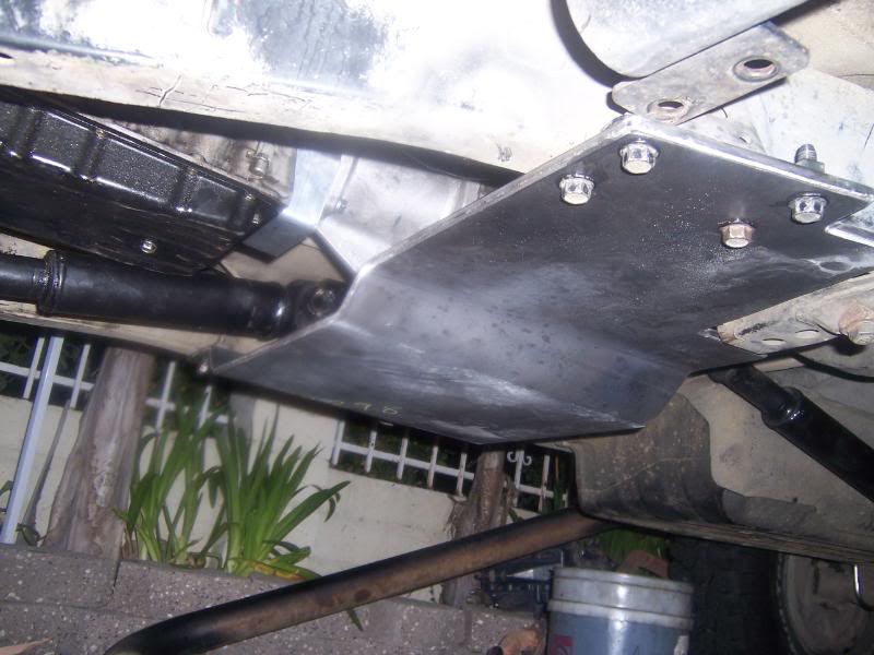

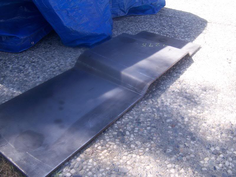

So I got a chance to take the plate steel to the shop this morning , and after $40 this is what I got .
again if your local , this is the place that I took it to.
http://www.robecks.com/
I did take some measurments and made some marks on the steel then had them bend it ..Oh but first I made the same marks on a cardboard and bent that to see what it would look like , Liked it so gave it to them.

it dips 2" at the front and 3" at the back .
Now I need to make some holes and a couple of cuts , then I can install it .

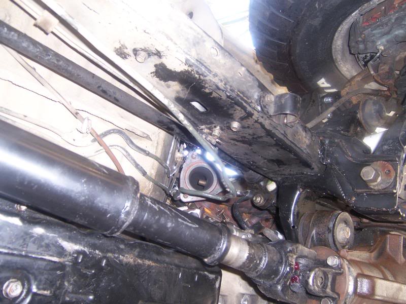

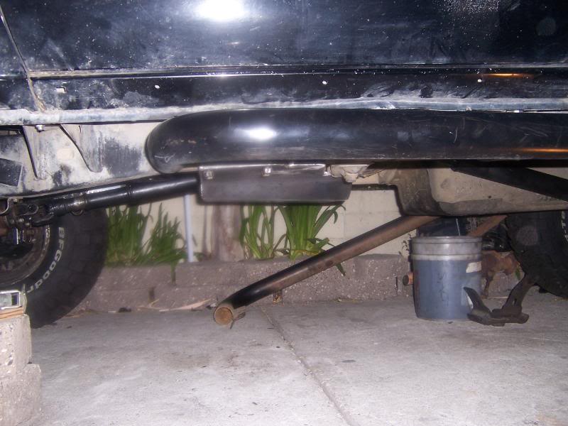

well I didnt get to finish the crossmember tonight , all I need is to make a mount and attach it to the transfer and crossmember , then paint this super heavy thing.

tranny was pretty close to stock location but the adapters move the transfer case back and yea had to modify the driveshafts.

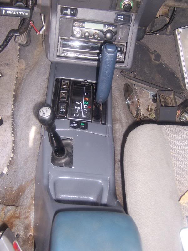

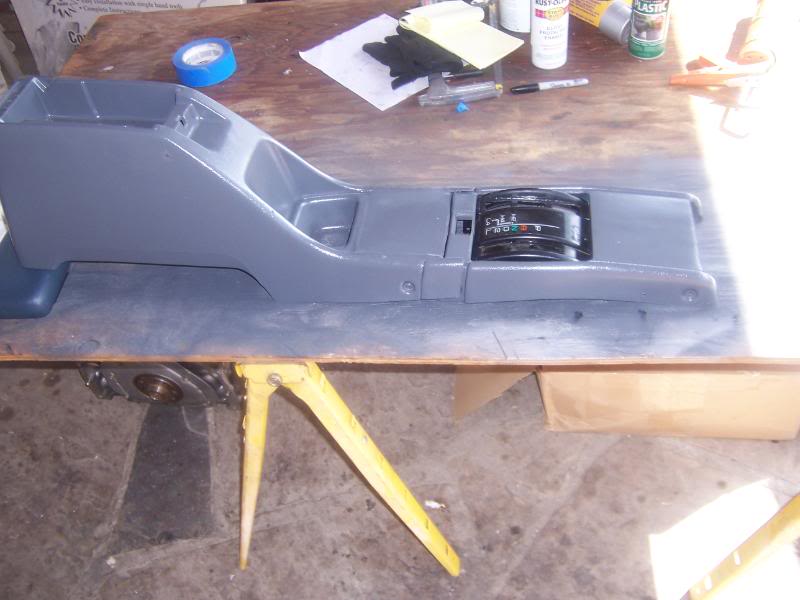

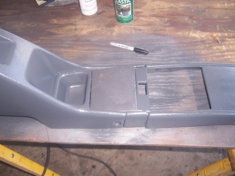

so im back to working on this after a few days of relaxation with the kids and wife.
Having the forward shift transfer case, put the shifter right on top of the shifter for the auto automatic , so I had to move the auto shifter forward 2 inches .

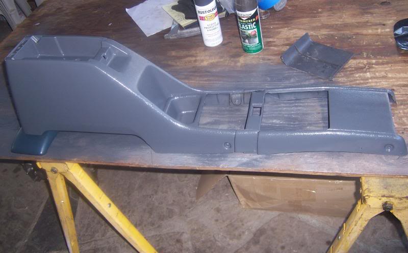

ok so Looking at the console and seeing it having a big hole (just the rubber boot ) I didnt like the idea of having a bunch of dirt and stuff just gathering there so i Hacked it up a bit.

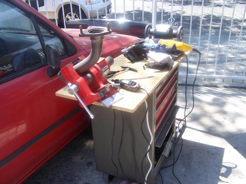

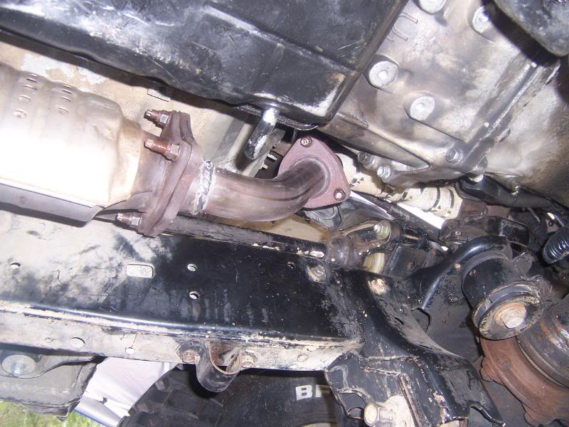

OK I picked up some tundra down pipes and modified them a bit and was able to finish the driver side exhasut from the manifolds to the cat.
Hopefully tomorrow I can finish the passanger side and then the rest of the exhaust back , then maybe drive this thing .
